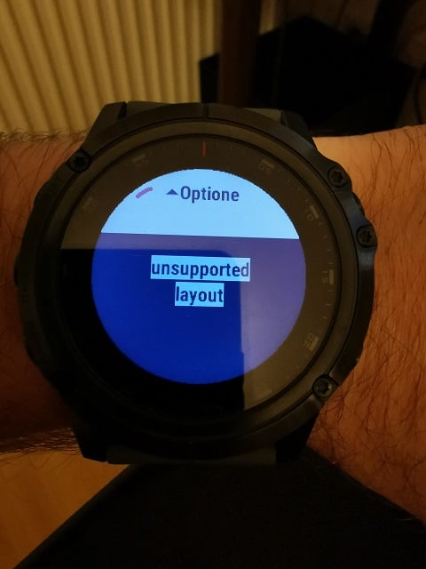

Hello, I just got my Levo on Saturday and wanted to use your Ebike Datafield (Nerd Style) on my Garmin Fenix 5x plus, but I get an "unsupported layout" error. The normal Ebikefield works.
The Watch firmware is 8.40. Any help would be appreciated.
I sorted this one out myself by changing the background color back to white! Now works as it should. Keep up the great work! Will donate to maybe see black background support ;)
