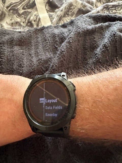

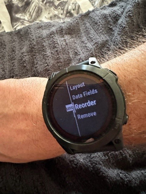

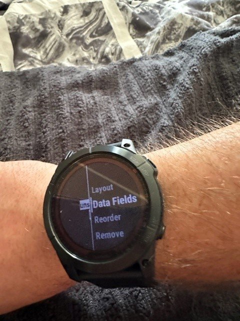

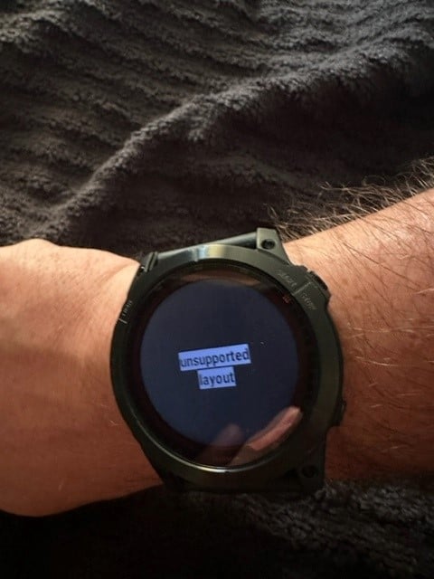

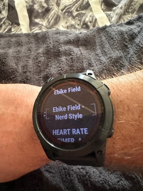

I've uploaded Ebike Field - Nerd Style to my Fenix 7X but receive the following error messages when installing. Does anyone else have this issue or a work around of some kind?
@sam.spoons Strange, It should work have worked for you with 820.
@wafu1982 Hi, it will work if you use it with "white" background. This datafield doesn't support black background in activity. If you want more universal datafield, use simpler Ebike Field (standard version).

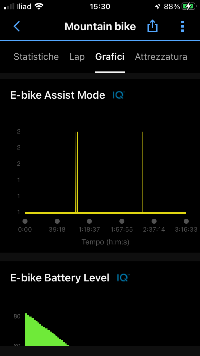

After a year using Ebike field on a Garmin Edge 530 with a Giant/Yamaha motor (datafield works very well), now I'm testing Ebike field - Nerd Style on my Fenix 6 Pro with a Shimano EP8 system.
It works nicely, I can view battery percentage, assist mode, speed, cadence, etc. as a donor I can view also also the battery percentage and assist level graphs in the activity.
Unfortunately the cadence data aren't saved in the activity, even if I can see the cadence during the ride.
There is any way to have also the cadence data in the FIT file?

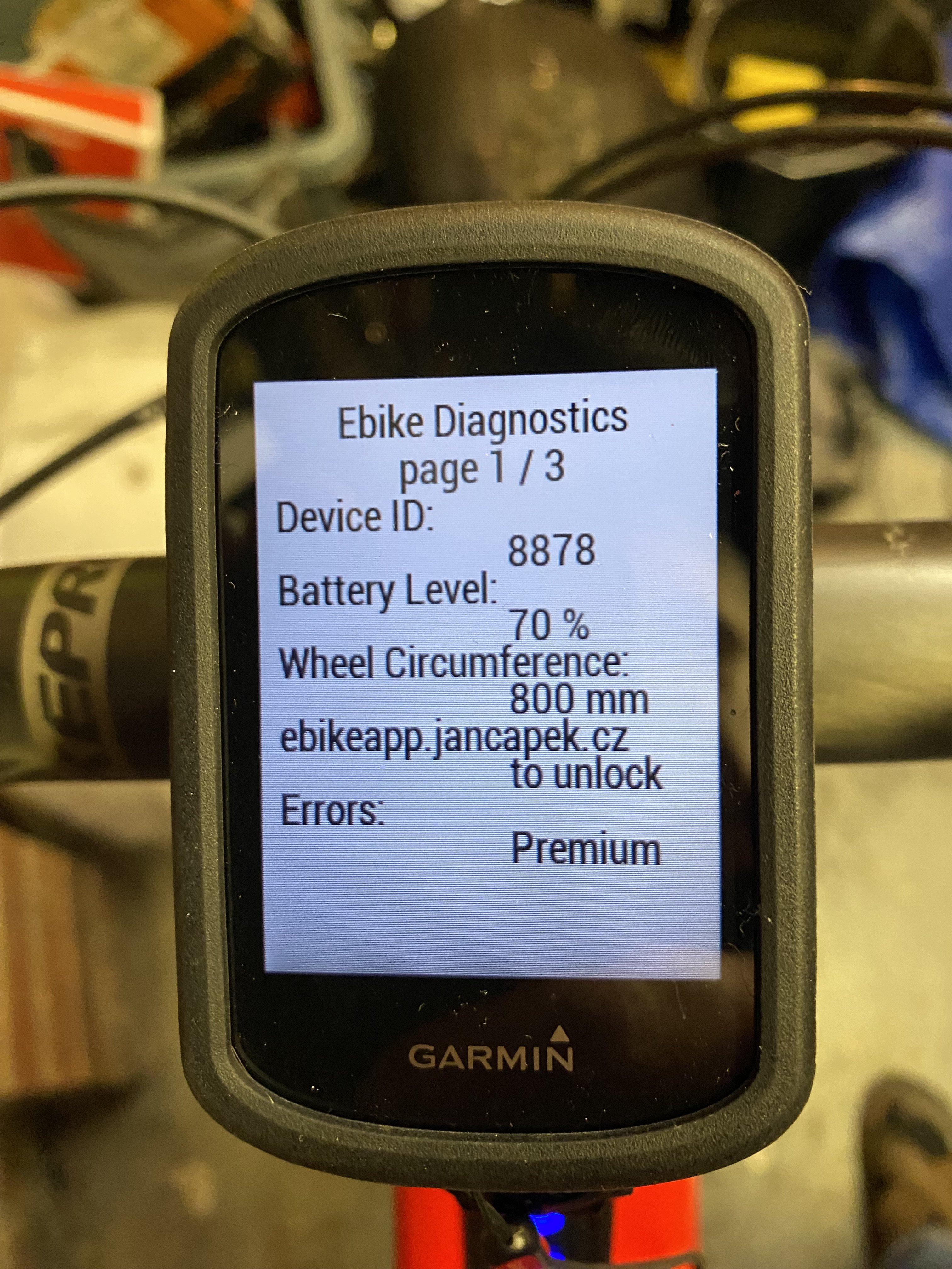

I have just replaced my edge 530 with another edge 530 and seem to have set ebike field up ok again, I did get the premium package and was just looking at ebike diagnostics and it seems my wheel size is set at 800mm? I have set it at 2300mm on the garmin, but it still reads 800mm on ebike diagnostics, my questions are: can I change it in ebike diagnostics to 2300mm? And if I can’t will it affect anything? Thanks 👍🏻

@Howz well, too little time. :) You obviously have changed wheel circumference within bike settings to overcome legal limit. You have it all setup correctly then. In Garmin, it must be real number to get correct speed readings.
Thanks Jan, @JanCapek
Ahh that makes sense, I did this on my last bike with the garmin which was a 2018 levo hardtail, I now have a 2019 FSR Levo….does ebike diagnostics not work on the 2019 FSR As I can’t change anything or see all information?
@Howz with 2019 you should be able to see most of the stuff, but can't change wheel circumference anymore - it is locked.

Unfortunately, as you know, not all Garmin devices can view Shimano EP8 data, just the Garmin EDGE devices like 530/830 or 540/840, but I need to connect my EP8 with a Garmin Fenix watch, so it would useful if your datafield can read and record also speed/cadence data.
For your reference, actually I'm testing the "Shimano step E8000 data fields" that can be used also with EP8 systems and this reads and records (with graphs) also speed and cadence data, along with mode, remaining distance (not so useful), assistance percentage and battery percentace data.
It would great if also your datafield can read same data.

Anyway, I don't know how complicated is to add the other Shimano data, but your datafields already reads Shimano Steps data and save battery percentage and assistance level in the garmin activity, only the other data that is communicated by the system is missing.
@JanCapek Would it be possible to add the following information to the "E-bike Assist mode" and "E-bike Battery Level" graphs?
  1. % of battery at the start and end of the activity. So you can understand more quickly how much battery you have used.
  2. % used for each assistance mode. E.g. 90% eco, 10% trail
