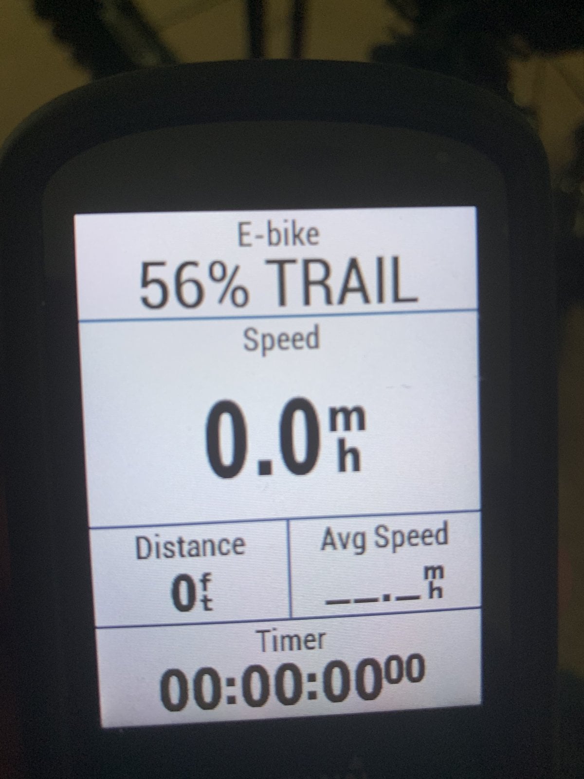

@oripaamoni Can you please send me images also when it is connected to the bike with value variants:
- Battery level + assist mode description
- Battery level + assist mode as one number (biggest font)
It will help me to report issue to Garmin.
Also please try layout variant, when Ebike Field have full width of screen to see if it will be better on edge 530. Thanks
I will grab some picture of the other configurations tomorrow.

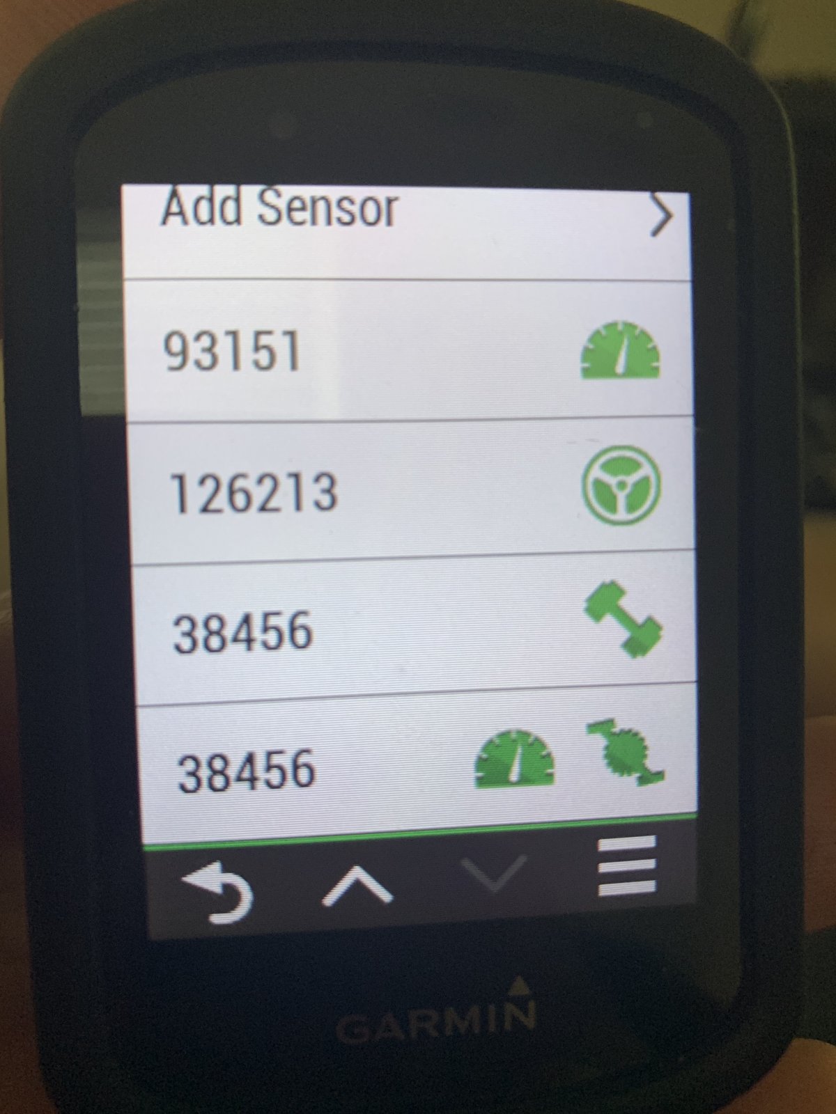

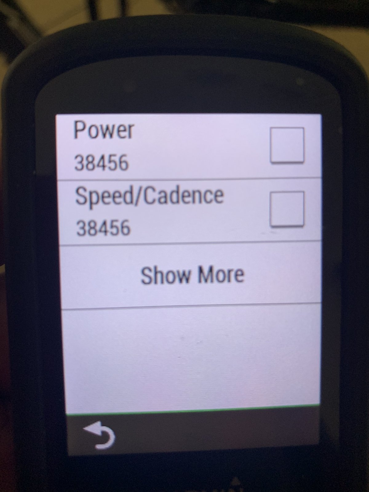

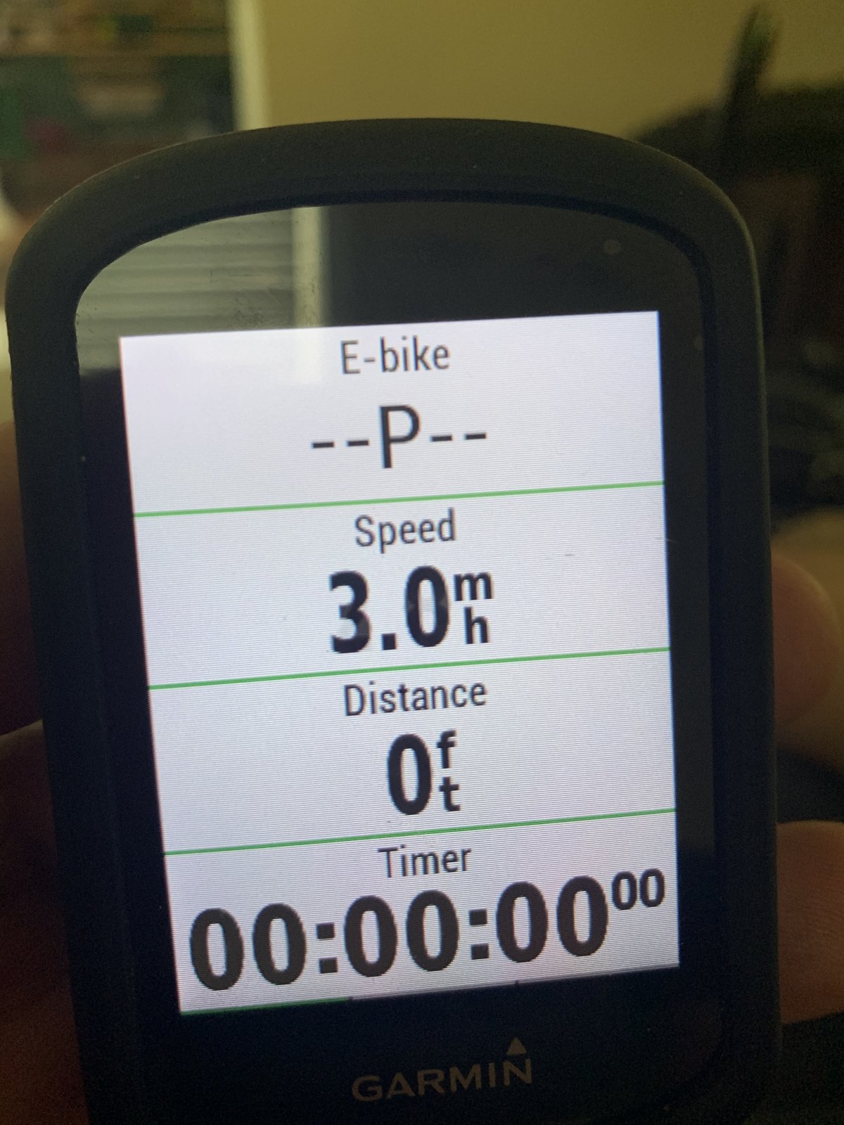

Ok I recently got an 830 and installed the app on here.
I am a little confused...I got it to work for about 5 minutes but was unhappy with how small the font was so I went to change the number of fields showing in the display and the ebike display reverted back to - - P - - . Now I can’t get it to connect back to show the battery level and assist level. Can anyone help?
I have attached photos of what I am seeing. First photo shows the sensors that were enabled. I deleted them and started over.
Second photo shows the - - P - - and the last one shows the sensors that are available to add. The first sensor with a bike icon that previously worked for 5 min is no longer showing up as an sensor.
Any ideas?
Thanks

@AML I didn't reply to your last mail because I was confident it will start working for you after next try. You can even enable again sensors for speed/cadence and power - they should not interfere with communication of ebike specific data.
@JanCapek - I should have kept quiet. Today it is back to only displaying - - P - - . I tried rebooting the bike and the Garmin several times although I didn’t restart my phone.
I am guessing I should just forget it unless you have another suggestion? I mean the Levo display shows me the info I need (just not in percentages) a few inches below it...
i have 130 and no problems. I only have it showing the battery percentage. originally had the ebike from garmin IQ and updated that and they have a new specialized specific app. Does what I need
I added the sensor for the Garmin remote after it started to work. Is that sensor preventing the Garmin from displaying the battery and assistance level properly?
