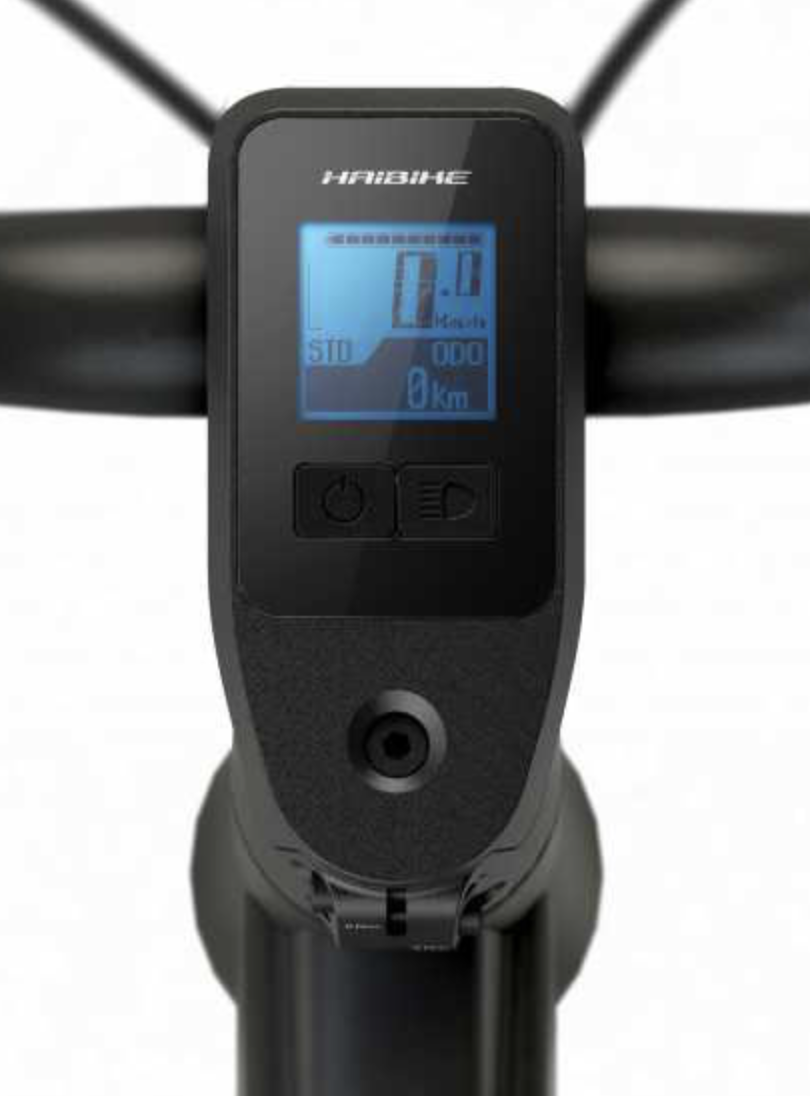

ok..too bad the New Trance E+ does not comes with display.. anyway..thanks for giving so much information.

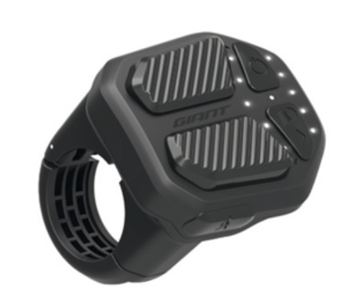

@dan3344 final feedback from me... the trance e+ 2019 should be equipped with the "giant ride control one". there should be "LED´s which indicate the remaining power and the assist mode.
There are some Yamaha displays, but they may not work due to firmware modifications made on the giant bikes.

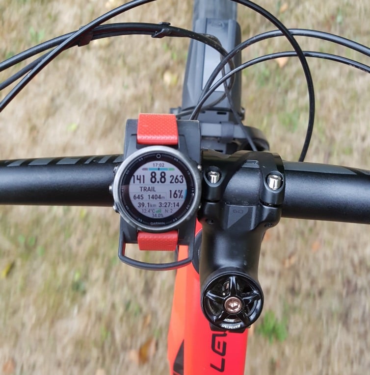

Hello,
as I also ride Turbo Levo and likes to ride with my Garmin instead of smartphone, I developed applications specifically for ebikes which communicates via ANT+ connectivity (which all Turbo Levos supports) without need to be setting up any fake-channel. So, in case somebody is interested in similar setup, here are they:
Ebike Field behave like simple datafield which you can configure to your preferred screen layout. It can show both battery level and current assist mode and it supports wide range of Garmin devices (EDGE and watches). You can even configure what and how it should be shown on screen. Additionally it support to render graphs of battery state and used assist mode during whole activity to Garmin Connect, which is perfect for evaluating your battery consumption.
Ebike Field "Nerd Style" does the same as first app but is specifically for watches and tries to maximize number of information on watch screen while remaining usable. It is even able to remind you in case you are off your preloaded route/course and you can reconfigure shown metrics on screen in app settings via Garmin Connect Mobile app.
Ebike Diagnostics is app with ability to read lots of useful information from bike and is even able to change bike wheel circumference. Unfortunately, no full support for new 2019 FSR Levo. This app is only for my donators.
More detailed description of all applications can be found under provided links on Garmin Connect IQ app store. More interesting features are on the way. Enjoy and let me know your thoughts!

Hi jan - What handlebar bracket is the watch attached to on your image at the start of this thread. Can you confirm that Ebike Field will work with my Vivo active 3 ? Cheers
@Eeh (bah gum) biker Hi, basic Ebike Field (seen running on EDGE in first post) will work without problem, you can easily check it by yourself if you have watch already.
I use this simple rubber mount. Nothing fancy, but works perfectly and there are even cheaper alternatives available.
