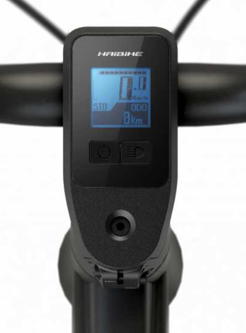

What Connect IQ apps u use to see the battery juice left?
@dan3344 good point. At the time I had the PWX it did not transmit any other data then power, cadence and speed, and that were the only ones I captured with my Garmin (without IQapp). The battery juice left was displayed as bar on the build in Yamaha display (integrated in ahead)
or you could select it to be displayed as number in die second row (instead of ODO,...)
