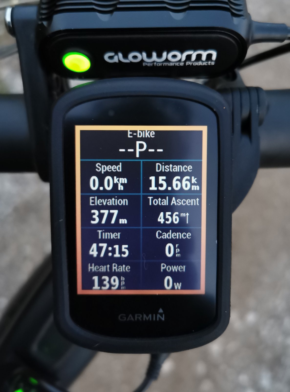

Last week or two I'm getting quite many Ebike data field 'crashes', it just stop working in the middle of the ride, it is IQ error or this --P-- like on attached photo. Anyone experience this? I use Garnin Edge 530...
Last week or two I'm getting quite many Ebike data field crashes, it just stop working in the middle of the ride, it is IQ error or this --P-- like on attachef photo. Anyone experience this? I use Garnin Edge 530...
I unfortunately had the same exact issue during my last ride. Tried restarting the bike and the garmin 530 multiple times and finally got it to work. Then mid ride it stopped again. Of course when I get it home after the ride it’s fine.
I have a Levo SL and Creo SL and use a Garmin edge 1000 with Ebike field. If the Garmin is on before the bike I get -P- for a while. Also sometimes randomly during the ride -P- comes up but after a few minutes it reconnects and all is good.
I now remember Garmin updated itself about a week or two back, maybe this is causing this issue ...
Ahh, not another Garmin firmware related issue.. :( Garmin continuously break something with their new updates. -P- is allright, it is just that app doesn't have yet, or looses connection. This can happen but app should automatically reconnect. But IQ means that Ebike Field crashed..
What FW do you have? Is there somebody experience the same thing on other Garmin models? (Please note that bug in Garmin FW is often quickly spread across more devices as Garmin reuses same code.)

@HopperMtb Thanks, but with Edge 1000 I doubt you experience it as it doesn't get new firmware updates anymore. Also, I often rides with this model and no problem so far.
