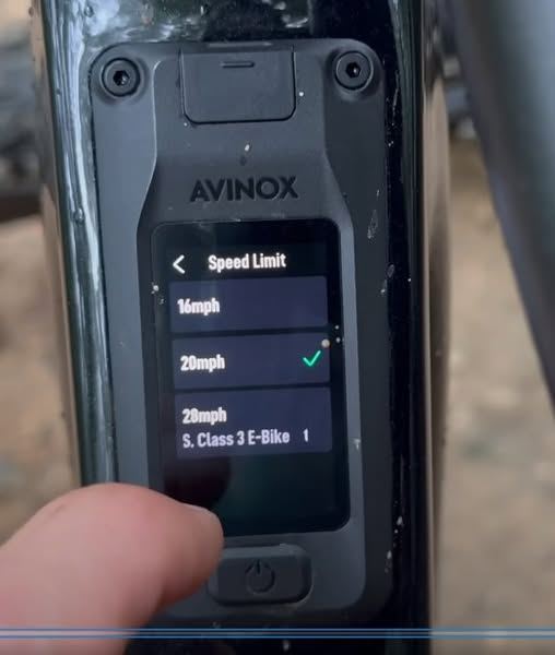

I have a Crestline with the Dji Avinox motor. And I have a class 3 (28mph) option that I can select in the display menu. The bike does reset back to its default class 1 (20mph) when you power off the bike. So we have to manually set it to class 3 everytime you power on the bike.
yeah please take some screenshots of firmware and so on. I'd like to normally ride 16mph but be table to set it to 28 sometimes. I want to ride a legal bike whenever I am on streets, but be able to ride 28 on my own property.
If you bought a bike with a Dji motor in the US and you don't see the Class 3 option and you already have the latest firmware update, then the issue is that your Dji display screen is not for the US, it's for another country.
My buddy who has a DJI Crestline here in the US doesn't have the class 3 option. He contacted Avinox support and they informed him that his display is not for the US region, hence the missing class 3 option. This applies to the DJI Amflow bikes sold here in the US.
