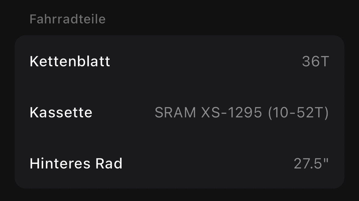

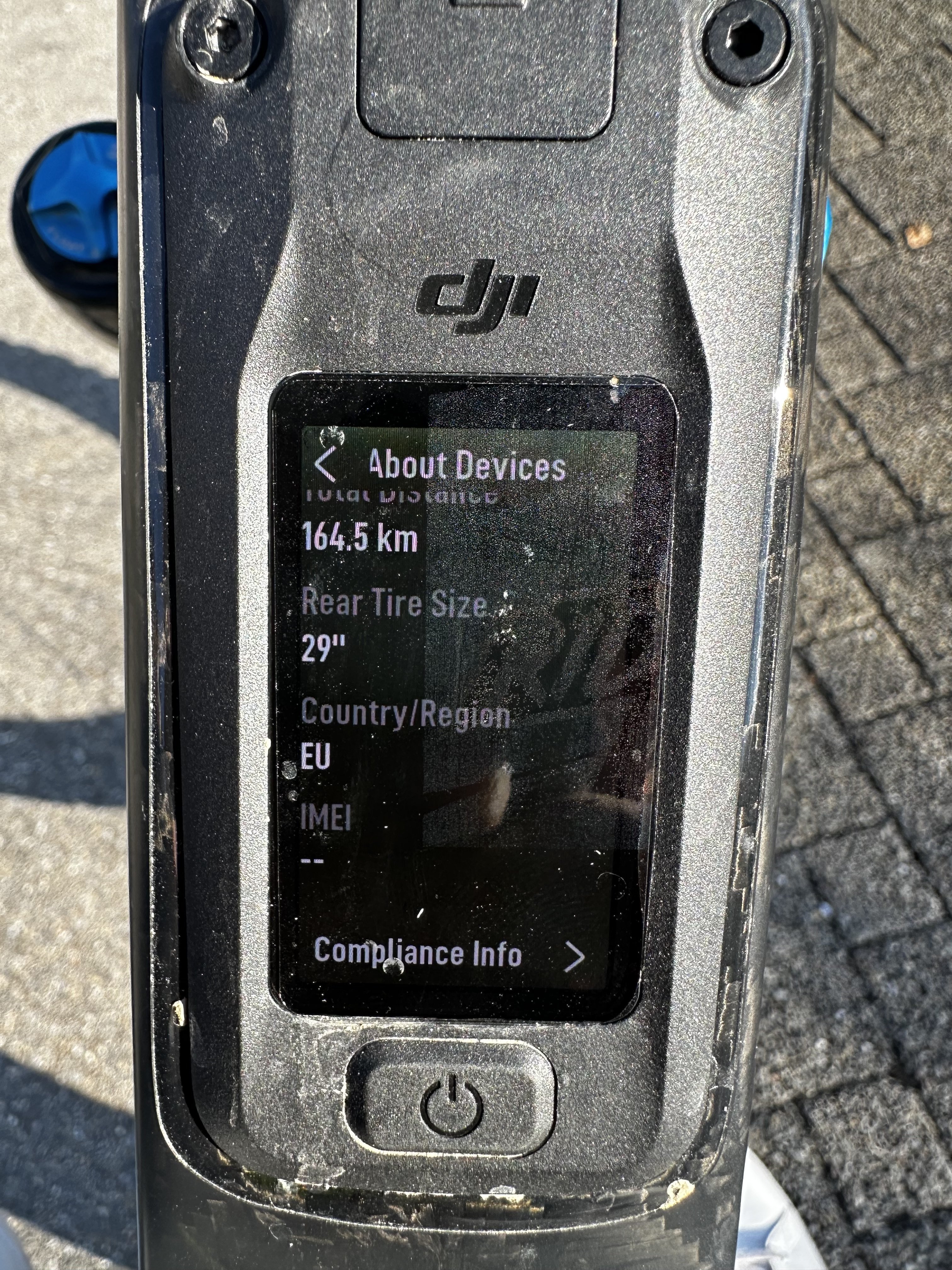

I am not sure if the EU Version does not work that way. In the app the 27.5 wheel is fix, but on the bike it says 29, which cannot be changed either.

But the weird thing is the 29" rear tire, becuase the Unno has a 27.5" rear tire... Did you check the speed shown on the display with a gps app on the phone?

No, I will do this, thanks. The app shows 27.5.
it seems the firmware is a EU Version and is limited to 25 kmph. As long as there is no hack or hardware to tune the motor, there is no possibility for tuning.

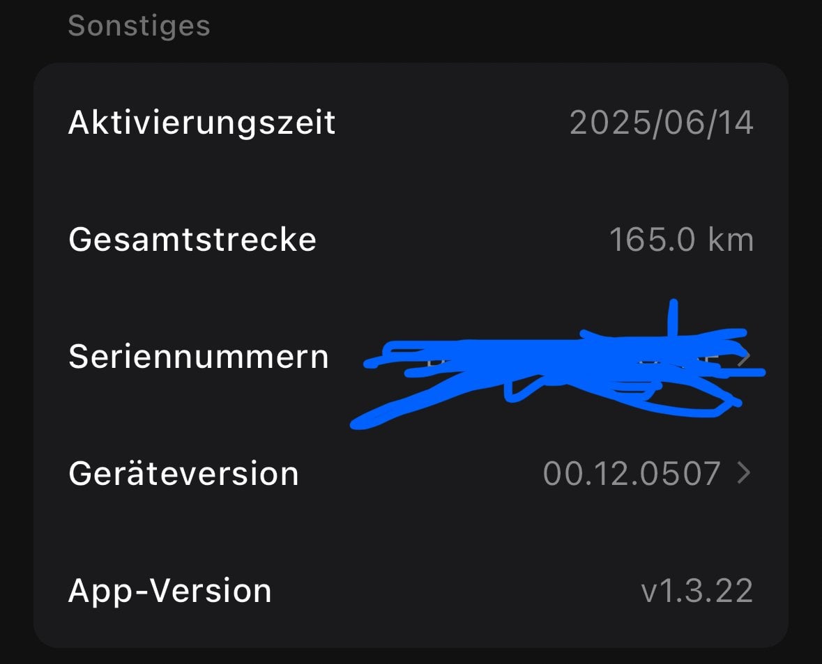

The newest version for my bike is v1.3.22, so this leads again to the different firmware theory. I tried cancelling the existing data, but without a difference.
