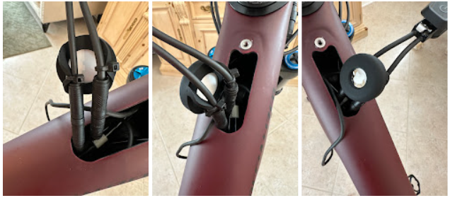

Apple tag zip tied to the TCU wires. I am using a silicone air tag holder for a small dog collar. Zip tied and fits inside the frame should prevent rattling noise while riding.

The issue, if the thief has an iphone, is the air tag sends a notification to the phone. Not to mention the beeping.
I have an air tag on my bike and my riding buddy's phone blew up with a warning.
It's an anti stalking measure.
Nice idea. If I recall correctly, this was discussed in another thread, as well as how to disable the speaker.
I slapped one onto my bike just for fun. I'm now alerted if she's not a home and we become separated. Sure, a thief with an iPhone would eventually be alerted. My thoughts are that hobo tweakers are more likely to have Androids rather than expensive iPhones. Even if they are alerted, it's going to take quite a bit of effort to disassemble the bike and find the AirTag. Do hobo tweakers even carry small torx and allen wrenches?
I also slapped an AirTag on an expensive item that is kept at a remote location. It generally gets "located" about once a day, which is comforting.

And hobo tweakers are a big part of the problem. They are actually recruited and paid to steal e-bikes for organized theft rings. Will an air tag transmit from inside a metal frame?

I removed the speaker from mine and gorilla taped it to the frame under the tcu.
Have you tested the the signal attenuation? I found the carbon/aluminum frames reduce the range to 1M or so. The back of the motor and bash gaurd don’t as they are plastic. But they are lower.

I have the Airtag glued under TCU and Bikfinder in the handlebar with the insurance.
