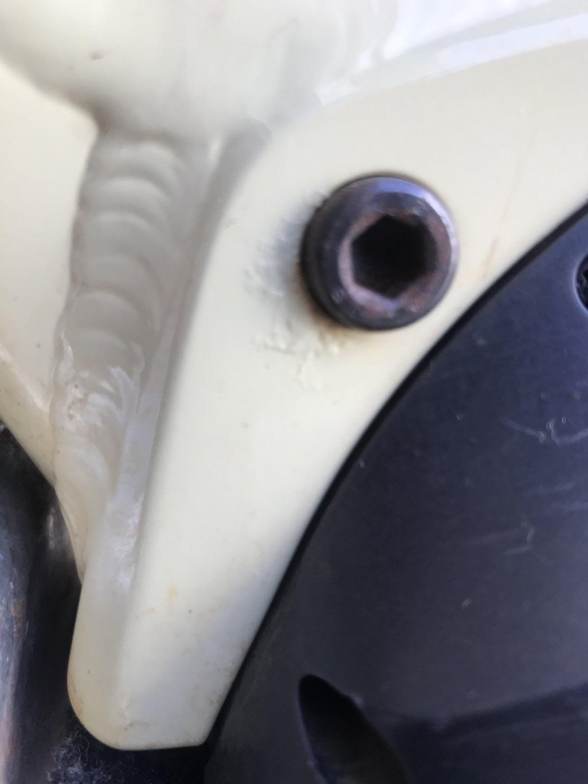

So I have a 2019 Meta power 29, I have had this bike for a little over a year. In this time I have had to have both motor and battery replaced under warranty (I know this is Shimano). Other issues I have had is a cracked stem (my fault for not torquing properly) broke my pedal off (replaced under warranty), constant loosening of rear axle and suspension linkage bolts even with blue loctite.
Now I have noticed some hard bubbles appearing under the paint at 2 of the welds and near a motor mount. So I contacted Commencal USA and they had to contact there engineers. They first told me they have never seen this before. Today they got back to me with the response that it is oxidation under the paint, it is only cosmetic and not covered under warranty. I'm not one to really care about cosmetics but don't feel that this frame should be oxidizing where there are no scratches and feel this should be replaced. At this point I am done with Commencal even though I really like there bikes. Any thoughts? and has anyone had there aluminum frames oxidize and bubble? all of my previous bikes have been aluminum and never seen this problem.

Maybe contaminants not properly cleaned before paint process. Something causing aluminum oxidation under the paint....it seems.

I've never seen an aluminium frame do that, its pretty poor IMO. That bolt in one of the photos looks quite corroded too, do you ride in a very salty environment - near the sea for example?
Almost looks like how a steel frame might rust, but cant be because its alu. quite surprising really.

I live in Hawaii, surrounded by the ocean and salt water corrodes everything. So maybe I should not be surprised, just never had a bike frame corrode like this. I have seen this happen many times with Fox kashima coated forks corrode and the coating flakes off over here and a friend with onyx hubs has the same issue.

Moisture can work its way under the paint even with a very small hole in the paint (caused either by faulty painting or from impact damage or scratches), and in your second photo it looks like you have a number of quite large "pinholes" in the paint.
The moisture eventually causes corrosion and lifts the paint off the metal.
I see this a lot with outdoor aluminium fittings, such as on aluminium floodlight bodies and door handles.
If you leave it untreated it will probably result in quite a large area of paint falling off.

Showed these pics to my paint guy that also does power coating and anodizing for a comment. He is of the opinion that even in Hawaii you should not have those issues with a bike this new. He lives in Rotorua, which has a very high sulphur content in the air and works in Mt Maunganui, a seaside town that is often shrouded in sea mist and has only see this sort of thing so early on, and that was due to poor frame preparation prior to painting. With the frames coming from Taiwan I would have thought they would go through a drying chamber prior to painting, but that may not be so.
I had a problem with a Giant CF delaminating and a fiberglass friend had his brother who is a F1 CF guy take a look at it. Giant claimed it was impact damage, but where it was under the top tube it would be virtually impossible to have impact. His opinion was that whoever handled the frame prior to the clear-coat probably had not used gloves and just the skins oils would have caused the issue.
That means it doesn't take much to effect surface coating IMHO.

That is a defect. It’s from poor paint prep. I have seen that happen to paint on our Fire Trucks that have aluminum bodies and the manufacturer warranties it to get repainted. Keep fighting it’s their mistake.

Just an update: I talked to Diego about a week ago, he tried to tell me it was the paint oxidizing not the aluminum. I looked this up on the spot and for sure this is not paint oxidation, I told him it was from poor prep prior to painting. He seemed unsure and started putting it off on the engineers in Europe, said that the decision was up to them and not him. So he emailed them at that time. Finally heard back from him today and they are still saying that this is not covered under warranty and nothing he can do.
I am just putting this info out there for everyone to make their own decision when buying from this company. To me this is poor customer service and not sticking behind their product. I guess it is what it is at this point, going to enjoy riding this bike until the motor and battery warranty runs out and then sell and go with a different brand. Probably specialized not for their price but only ebikes sold on island.

Unfortunately the corrosion looks identical to the corrosion I see at work on aluminum structures of aircraft every day. Moisture usually has a small point of ingress around a fastener hole or other defect/gap in the topcoat and becomes trapped. Pretty common to see in aluminum parts that are exposed to high moisture and salty areas. Metal prep is the most important thing to prevent this. It is likely the frame was not clean in these spots or inadequate amounts of priming or etching material was applied before the topcoat. As to their response that it is only oxidization under the paint, it sounds a little like they're underplaying it. Corrosion is corrosion, it is like cancer and will continue to spread (assuming you're riding in the same areas repeatedly) unless treated. Although it is likely light surface corrosion initially, after some time it can develop into something structurally critical, going deeper and becoming intergranular.
