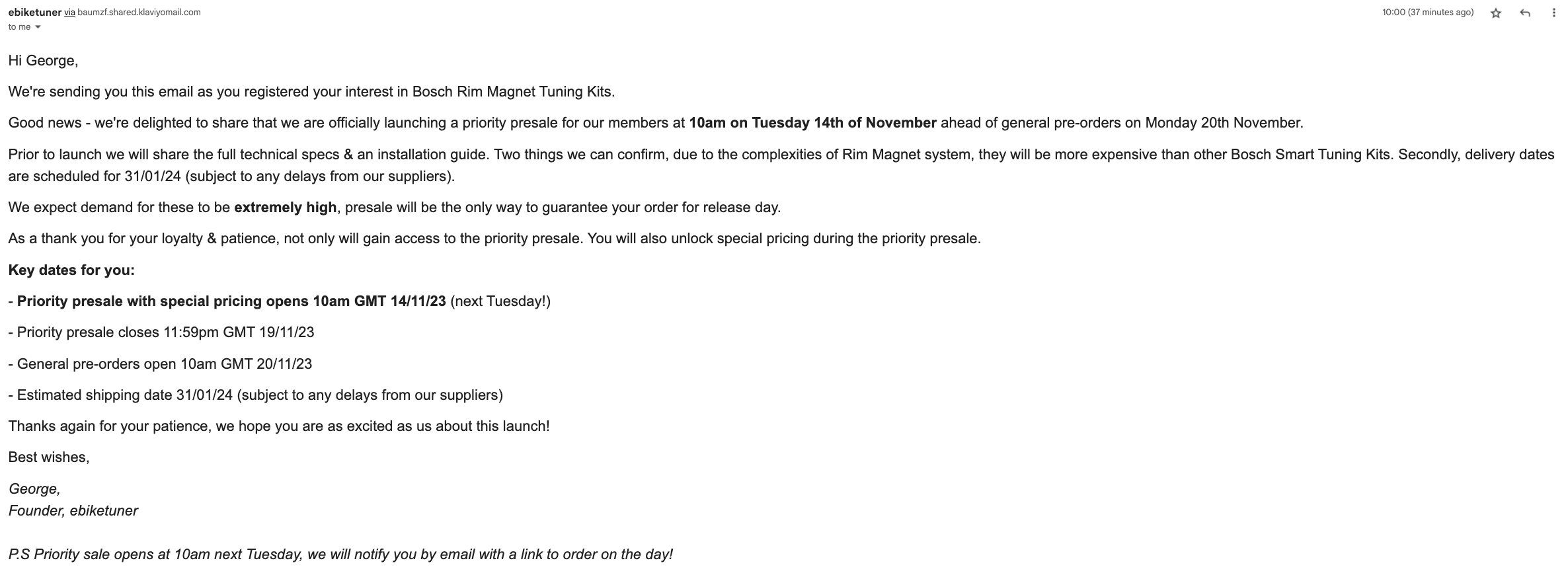

Some news from ebike tuner: (my name is not George tho)

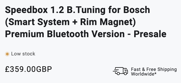

Great that SpeedBox finally came out with a new chip for the Smart system. It is said to be better than the previous version 1.0. So we'll see.
With my rim magnet, Smart System Canyon arriving next week, i was looking for a derestrict option. I don't blame anyone for taking an opportunity where there is demand / no competition, but this opportunist price has pushed me into "nah" territory. Good luck speedbox but you've misjudged it as far as I'm concerned.
The Italian competitor has that chip for a similar price (and without Bluetooth), but the processing is not great..

Assuming there's still interest now that you know the pricing, please like/reply to this if you're happy to go ahead so I can understand numbers.

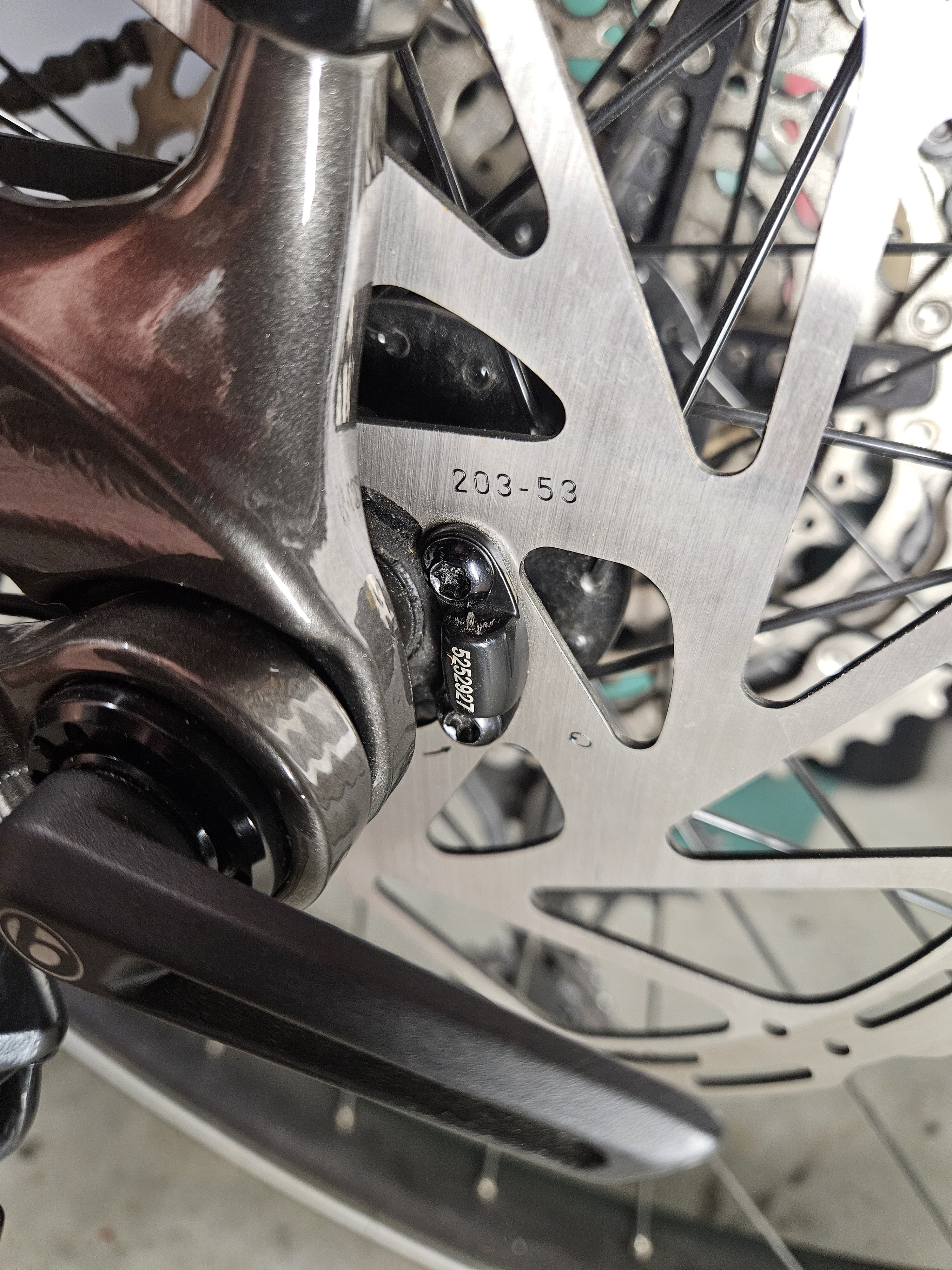

I have the disc rotor type sensor. I would like to get the board with code running and Bosch cables to connect properly. I will fine tune this end and post final documentation for those like me with disc sensor if that's whats needed.

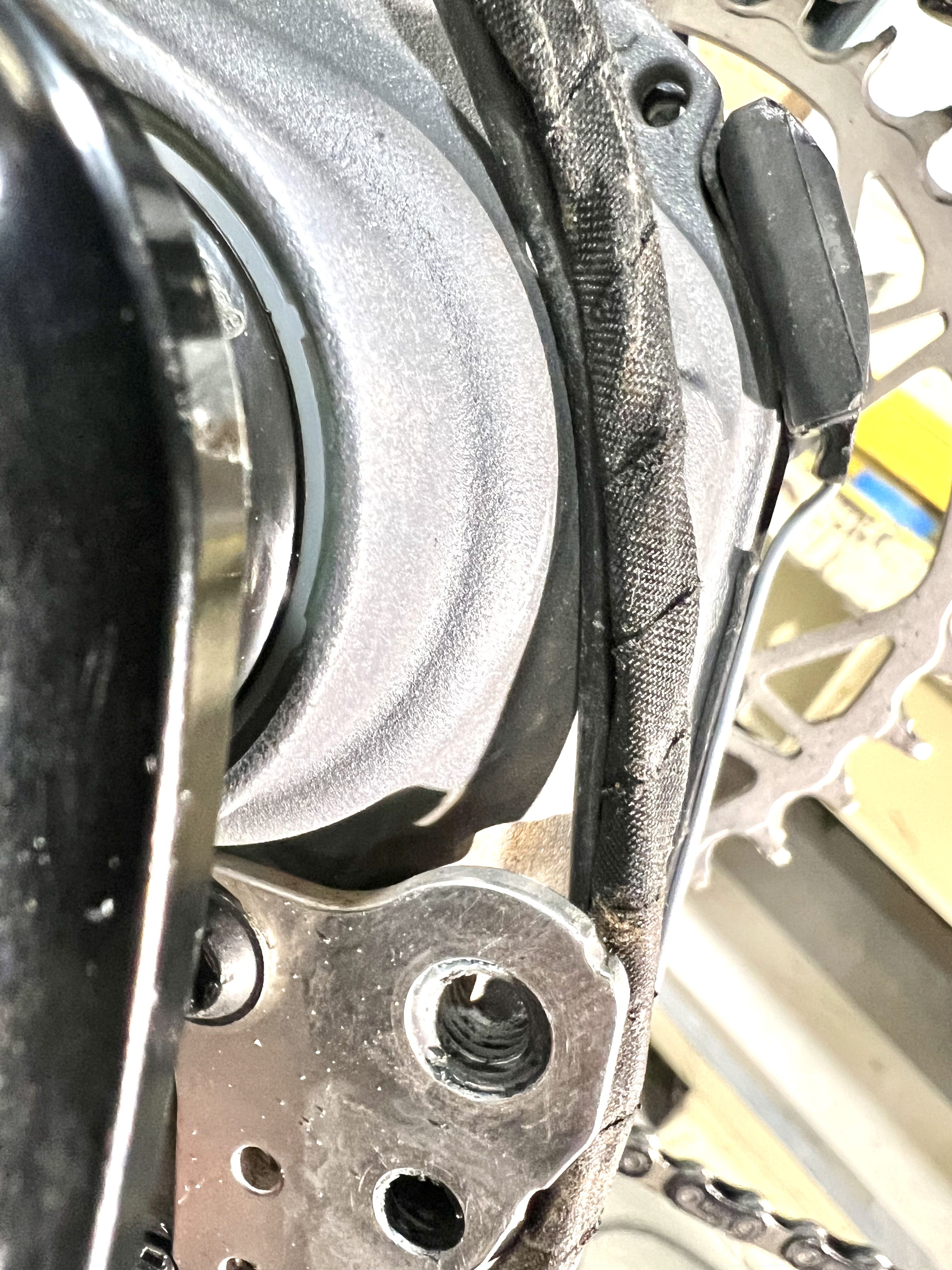

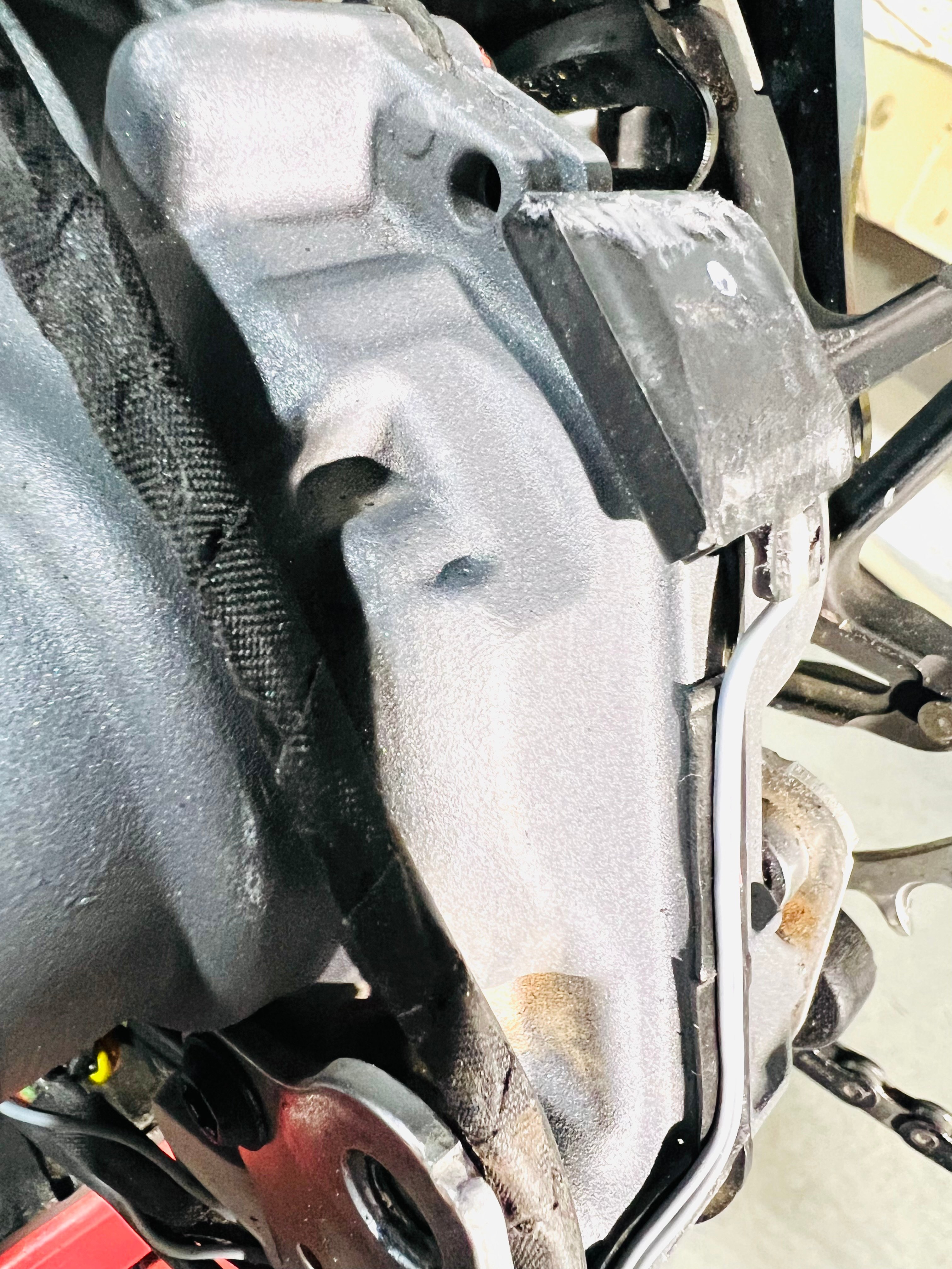

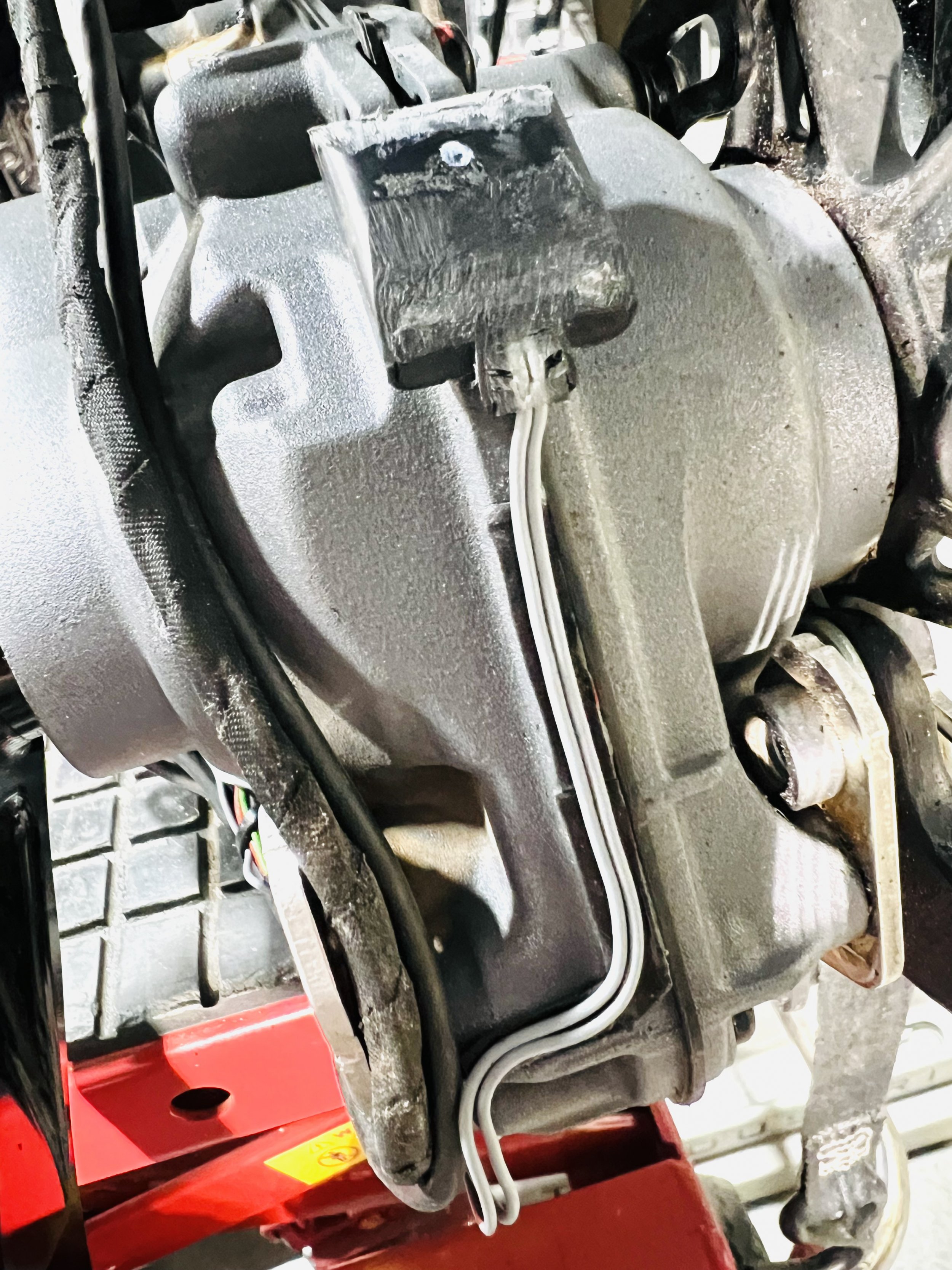

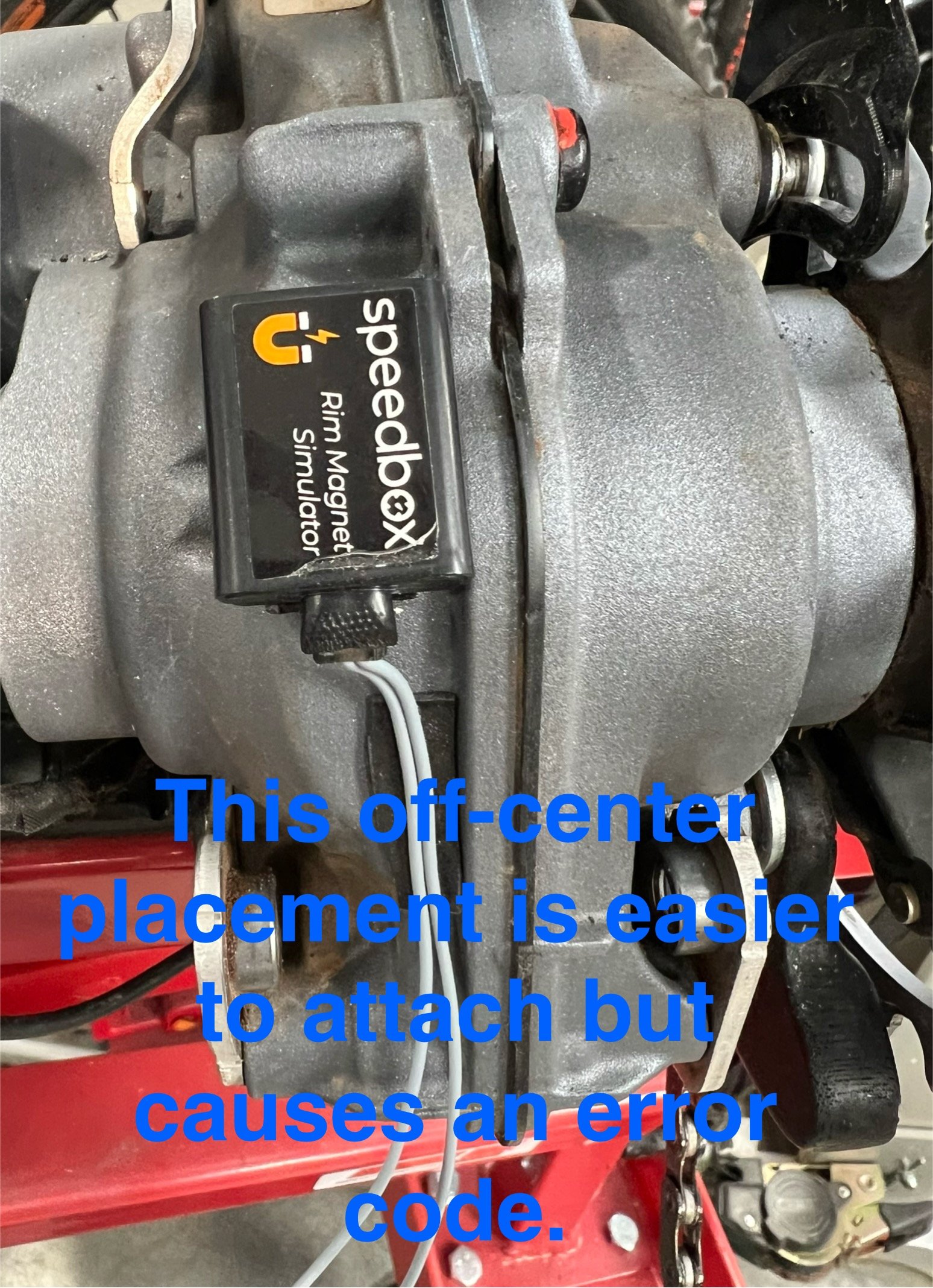

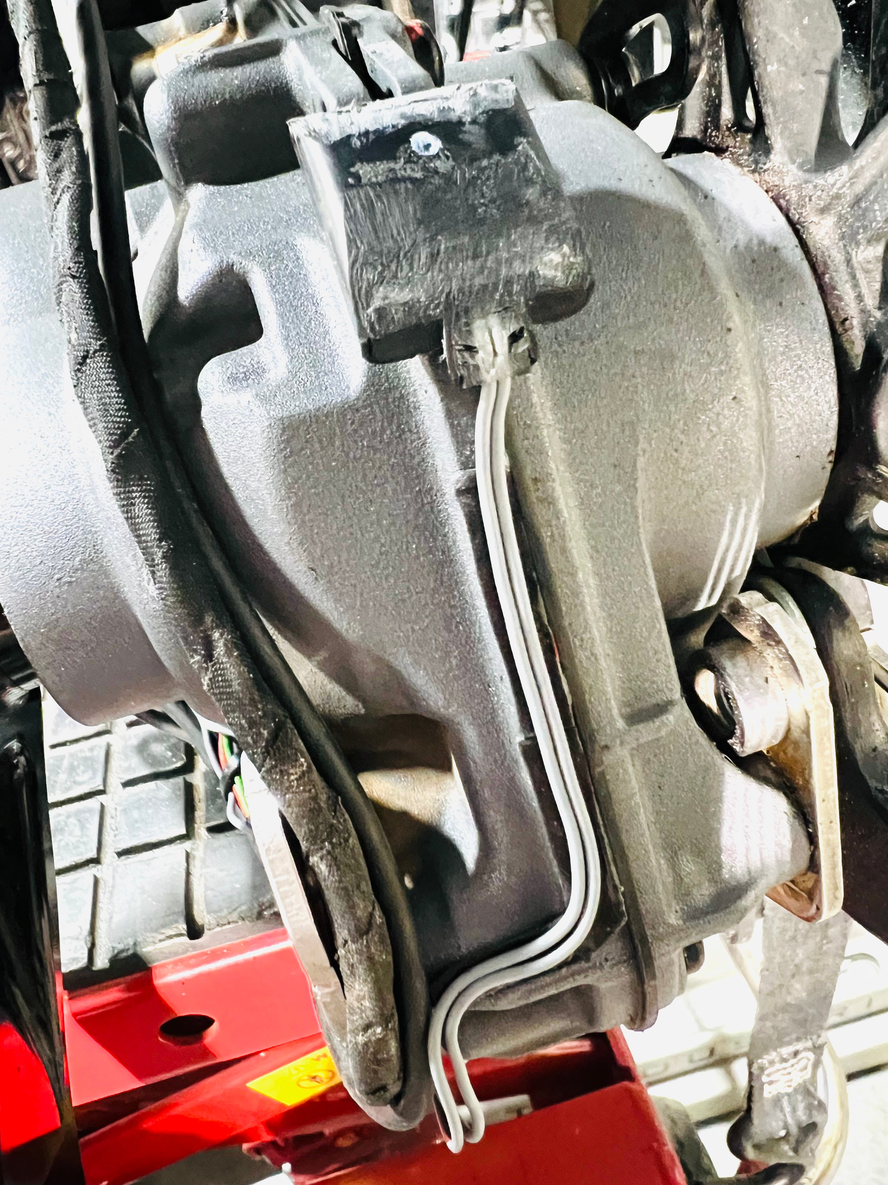

SPEED BOX 1.2 B (Bluetooth / Rim Magnet) installed today on my CX Race motor!
Due to how tight the motor fits inside my carbon frame I had to shave down the plastic electric magnet housing on the top and bottom to fit snug over the center rib of the motor.
I also had to heat up the plastic wire strain relief coming out of the plastic magnet housing and bend it downward to gain clearance.
It’s functioning as it should with no error codes while my bike is held off the ground in a stand. I have not ridden it yet, and unfortunately Cali is getting hit with an atmospheric river tomorrow, so once we it drys up a bit I’ll hit the trails.
I also have yet to play with the Bluetooth side of it….maybe tomorrow.
