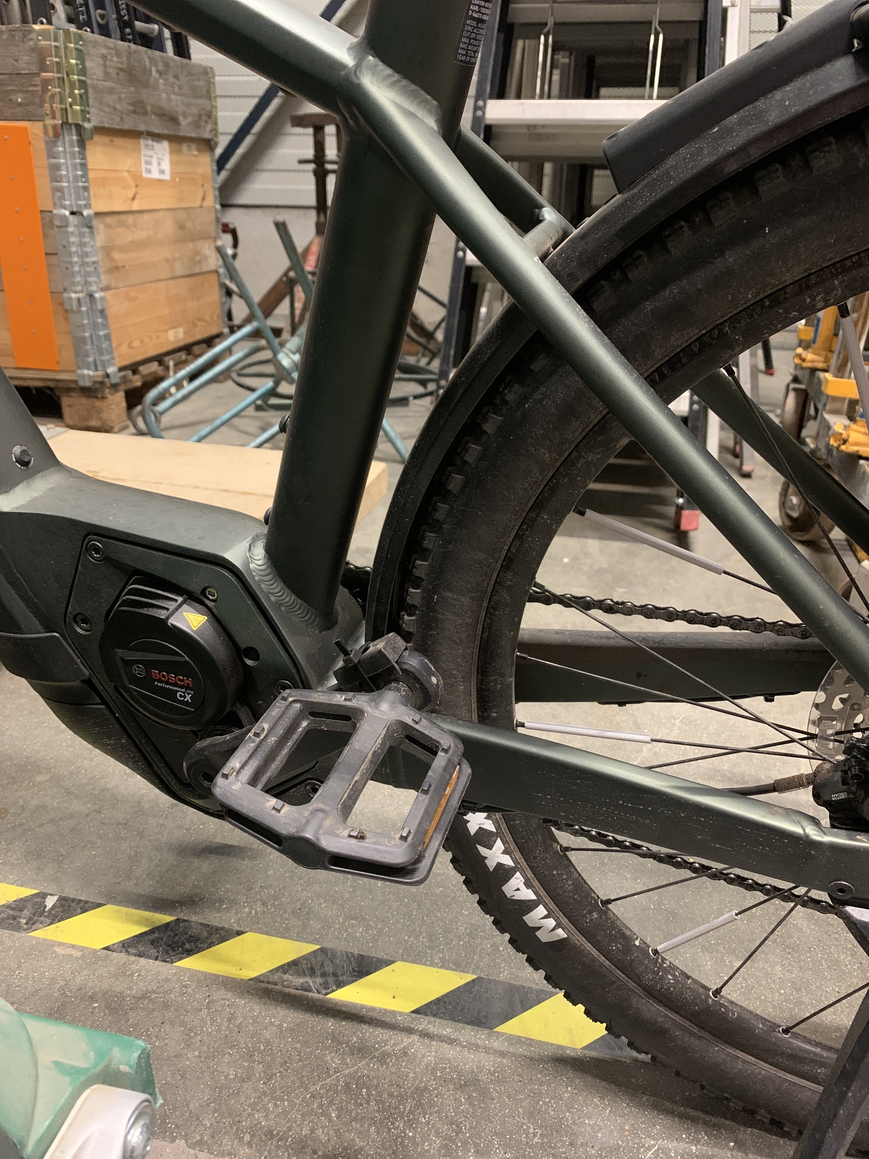

After a little bit of research I placed the magnet at my pedal. this makes the difference that your revolution is smaller and therefore your sensor is wrong. after 20km it still works. but the question now is whether the casting will detect this after a while? anyone experience?

Hi guys
I didn't want to believe it, but unscrewing the magnet to put it on the pedal crank is the dumbest or the most genious workaround I've seen.
It works flawlessly, tried for 5 km. Assistance above 40 km/h. ebike flow shows an average of 4 km/h.
