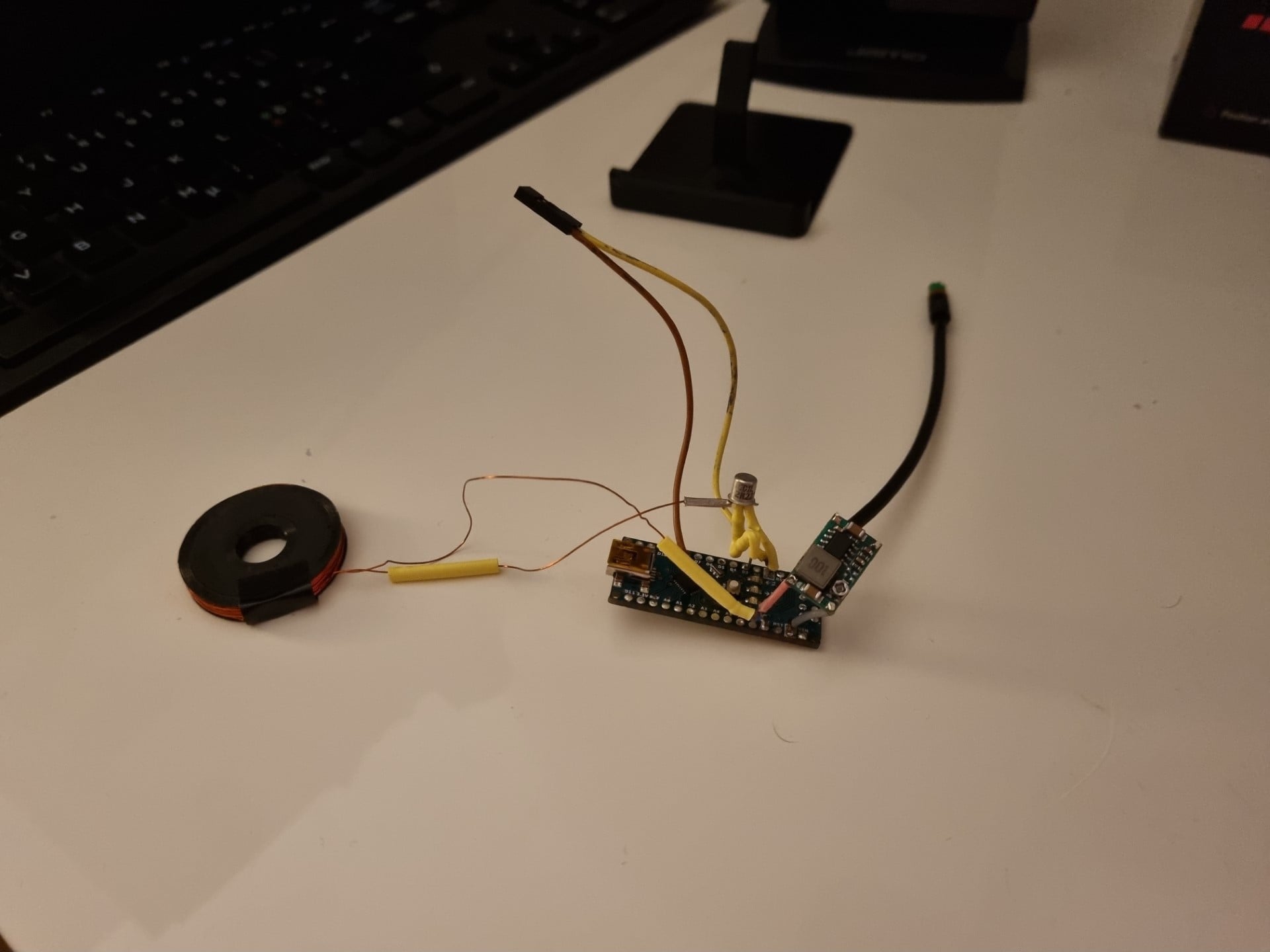

I'm having some issues getting my megabobra working. At first I printed out Koekie's holder for the winding and filled it out with 0,3 mm wire (I managed to get approx. 100 turns into it before it was full). I'm using 5,2V for the whole system and the electromagnet was giving out 3,2 ohm of resistance. At first I added 15 ohm resistor to it, but it was really weak. Then 11 ohm and then 6,7 ohm (measured). With 6,7 ohm resistor, total resistance was 9,9 ohm, meaning 0,53 A / 2,73 W. I made my own code for finding out the location for the magnet (Koekie's seemed a bit complicated for the purpose) but the speedometer shows nothing but 0.0 for speed.
The magnet felt still quite weak so I designed and printed a bit bigger "winding holder" which had 19mm inner diameter for the wire and same outer diameter of 35 mm, allthough the "length" of the space for wiring was constant, needed to print with supports. I managed to get approx. 200 turns into that one, estimated by the resistance of 6,3 ohm
I added 4,7 ohm resistor with that one, making the total resistance for the magnet 11 ohms. That means 0,47 A / 2,46 W. This magnet feels a lot stronger already, but when I went up to the bike trying to find the correct location, I only see 0.0 km/h. But this time I got twice the problem showing that the magnet is too strong! So some improvement I guess.

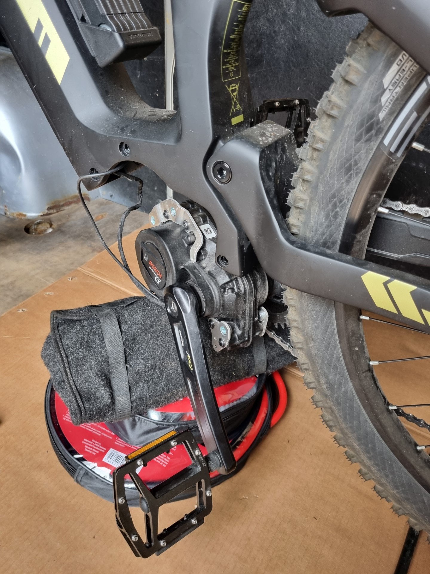

Attached some photos. I took the motor out from the bike to have good access to the motor. But still no winnings yet...

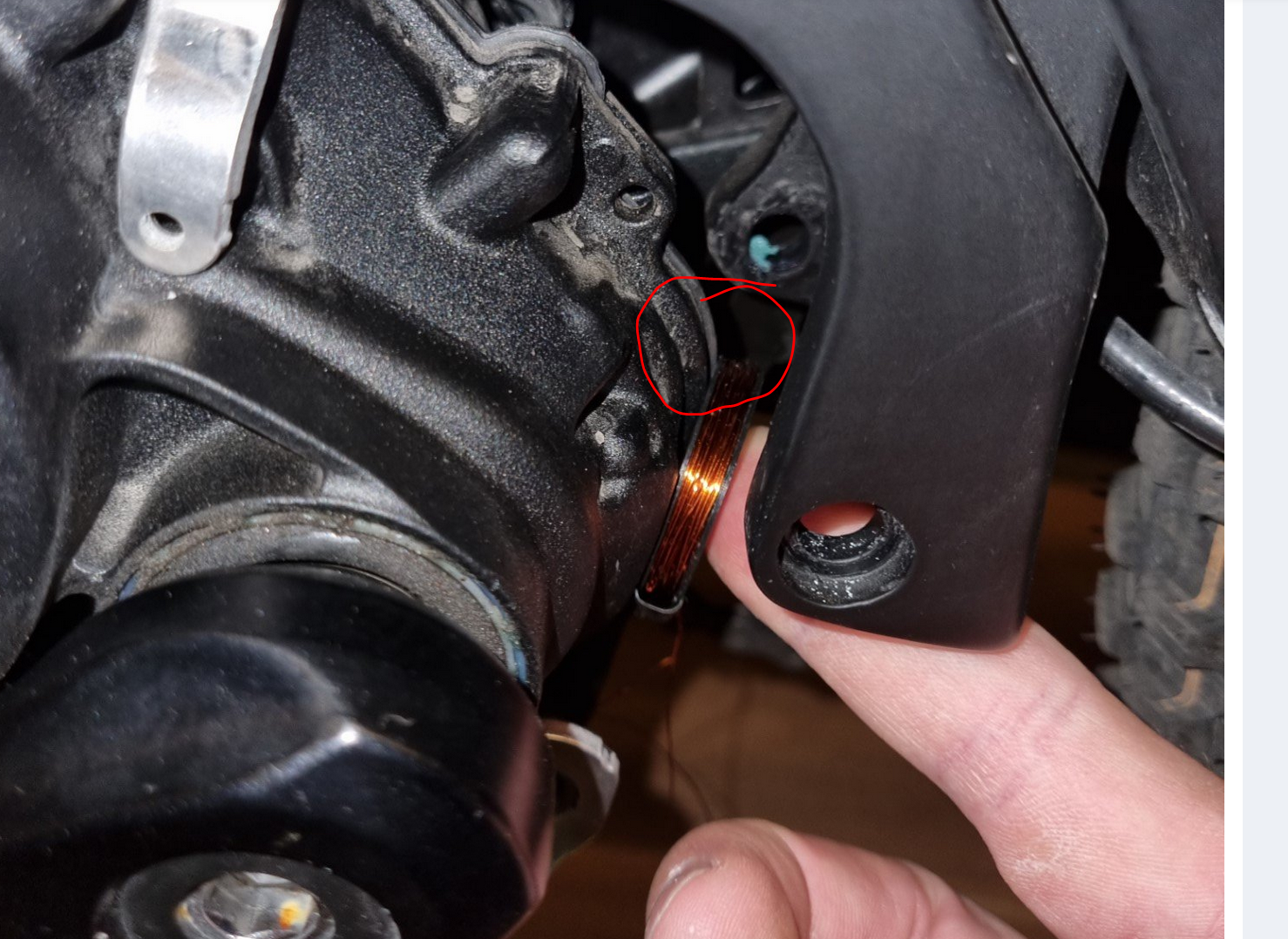

The location where the "too strong magnet" errors came shown in second photo.
And then the megabobra shown in third photo, just in testing setup still 😁 will be made cleaner if / when I get it working.

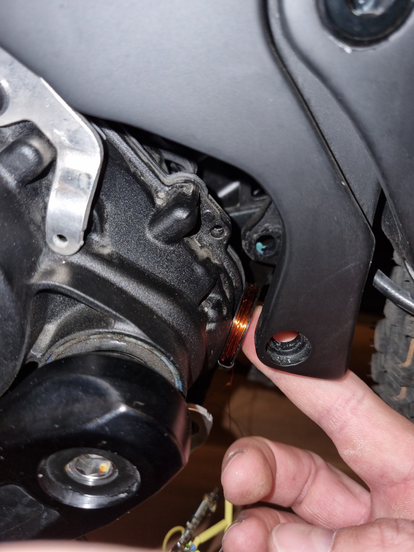

Hi Mervious,
First regarding the winding, 100 turns at 0.3mm giving 3.2ohm sounds exactly like mine. I've got a 6.6ohm resister in place to bring the total to ~11ohms. I think it's more the placement you need to perfect. Its not so much sensitive within 1mm, but looking at your photo, my coil is around 10mm higher than yours, see the snip attached.
I bend my coil so it straddles that circled lump in the motor case. Give that location a try?
Ps yes I noticed the same with the coil remaining powered on and put the same fix in, albeit for 2secs - but I never got around to uploading the updated code ;)

Hi Mervious,
Thanks for the tip, but nothing came up from that location either. And yeah, 2 seconds is better than 5, I modified also my code for that 😁

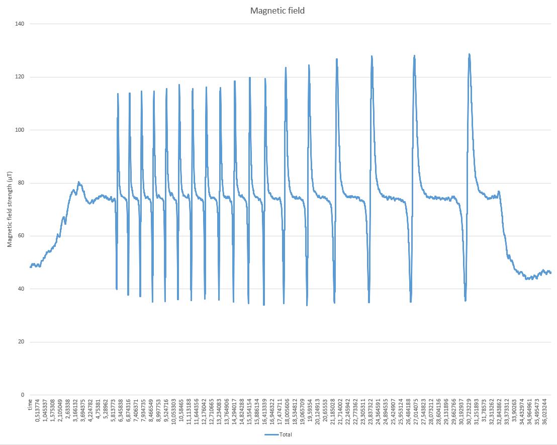

I then did what I should have done a long time ago, measure the magnetic field strength. I plotted the rim magnet field at approx. where the motor is and this is what I got:
So more or less 120 µT. I then plotted my own magnet with 200 turns and I got around 3000 µT lol. So 25 times more than the rim magnet gives. No wonder it didn't work. Well back to the 100 turn magnet. I plotted that also and it too was way too powerful at 8 ohm. Then few tries of different resistors and went with total resistance of 82 ohm (79 ohm resistor + 3 ohm from coil). That one gives out still over 120 µT of magnetic field and the bike seemed to like that! When I put that to the location you showed, everything seems to work very nicely. I also removed the printed coil "holder", now it looks like what you got. And that one is very energy efficient at 0,06 A or 0,33 W! No extra heat coming from this setup.
Now printing the case for it and then tomorrow trying it out in the field. Hopefully still works then 😁
That's outstanding, thanks Mervious! I had tried to do this early on in the project but I only had my phone to take the measurement. Needless to say it wasn't accurate... and in fact whenever the reading was too high, it would somehow temporarily wreck the phone's magnetic sensor such that it just wouldn't take a reading at all again until the phone was restarted.
May I ask what you used to collect the data? I think there's more value in improving the target strength of the field rather than its ramp up/down shape. I'd be keen to spend a bit more time with you with some more measurements if you're able? 😎
Unfortunately the same way as you did, with a phone 😄 I wouldn't look too much at the absolute values, but more on the relative. I think it is accurate enough (Samsung Galaxy S21+) for that kind of work, especially to see if the magnetic field is 25x more than what is needed 😁 I used an app called "Physics Toolbox Magnetometer" to plot the values. I noticed that the live screen doesn't seem to keep up fully, better to plot and use excel. But never had any issues with the phone sensor like you did.
But indeed, these are not accurate values like what could be got with real tools.
Terrific thanks. I'm using an S21, so I wonder if it was just the app I was using... I'll give it another try with the one you mentioned. Thanks for the tips!
I had 8 km test ride today and everything worked nicely, just like planned! Now hopefully it will work in the future as well without any error messages. Thanks @megabobra for the idea for the electromagnet! Lot's more fun riding a bit faster than 25 km/h 😉
