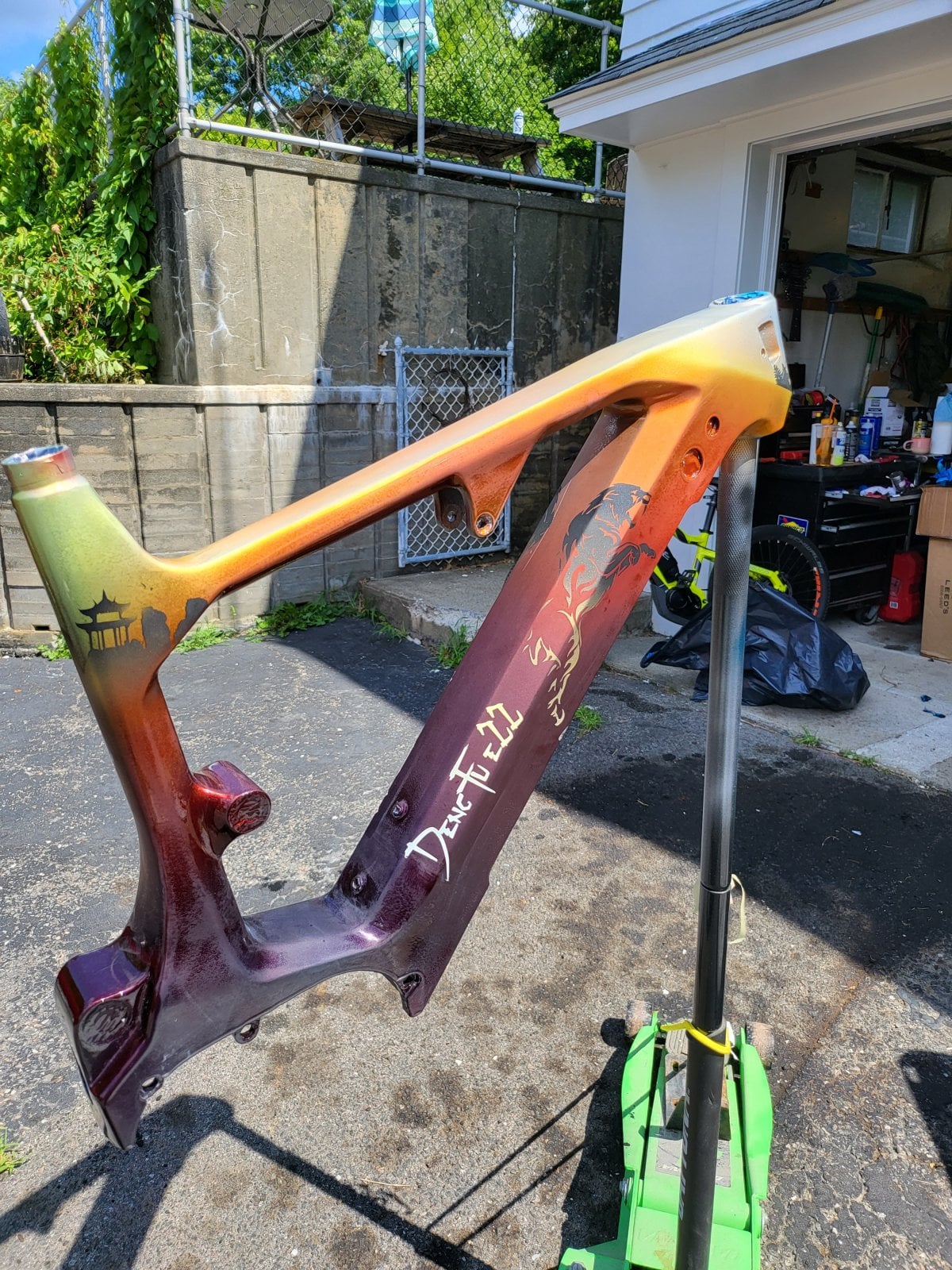

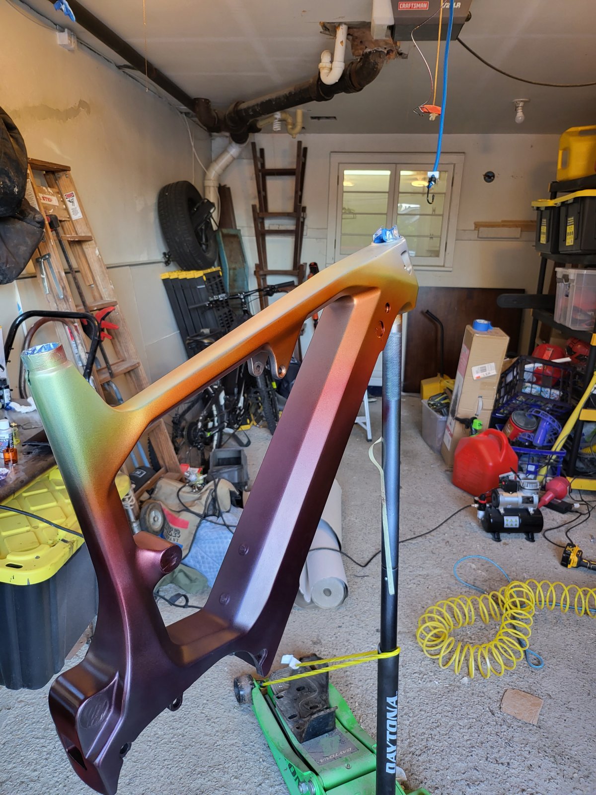

Paint job so far ..Goes easy on me fellas . Lol
Nice work you'll be back in shape in no time, I can't wait, tooling around town on my fat bike ain't cutting it.. lol

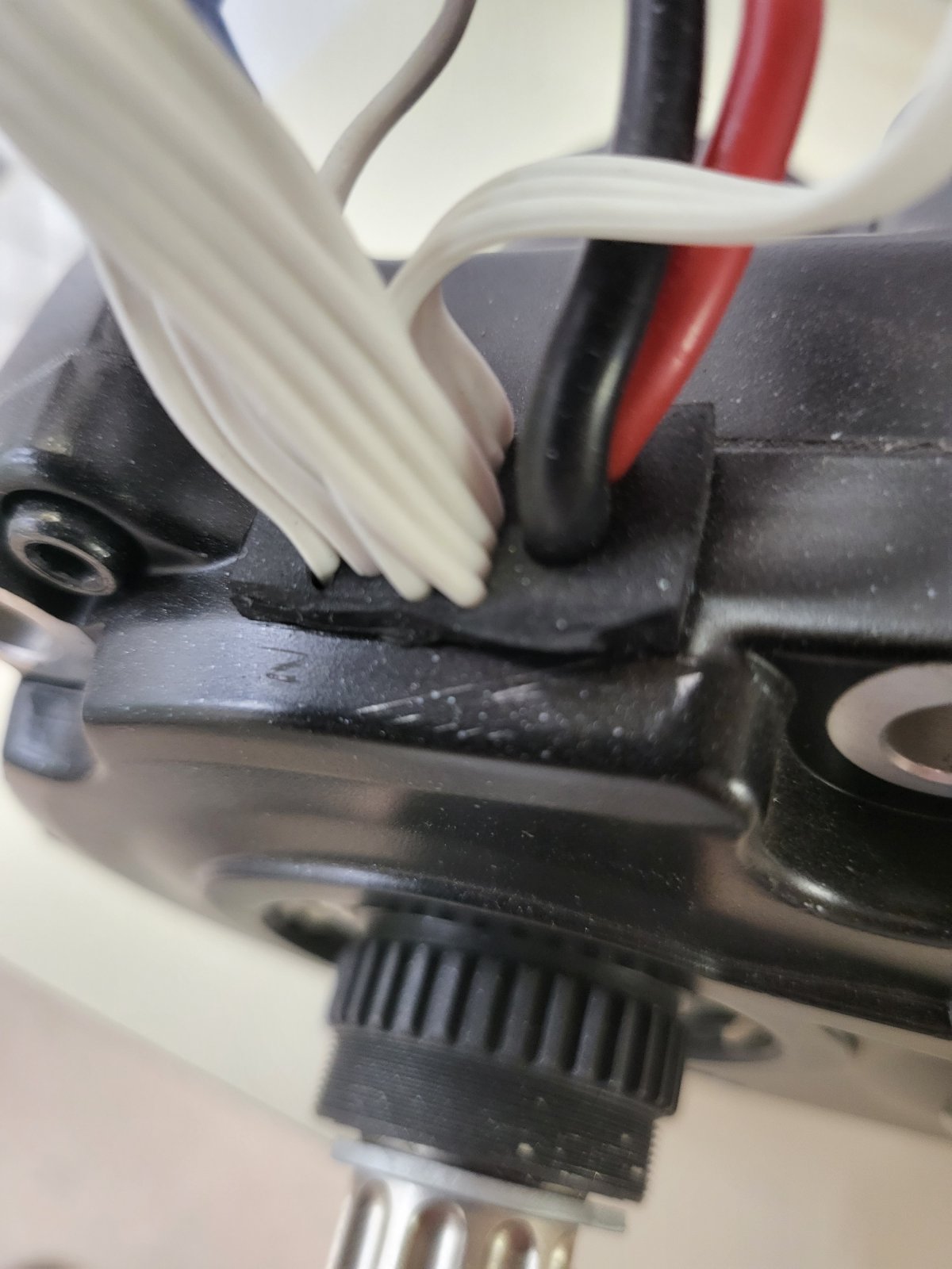

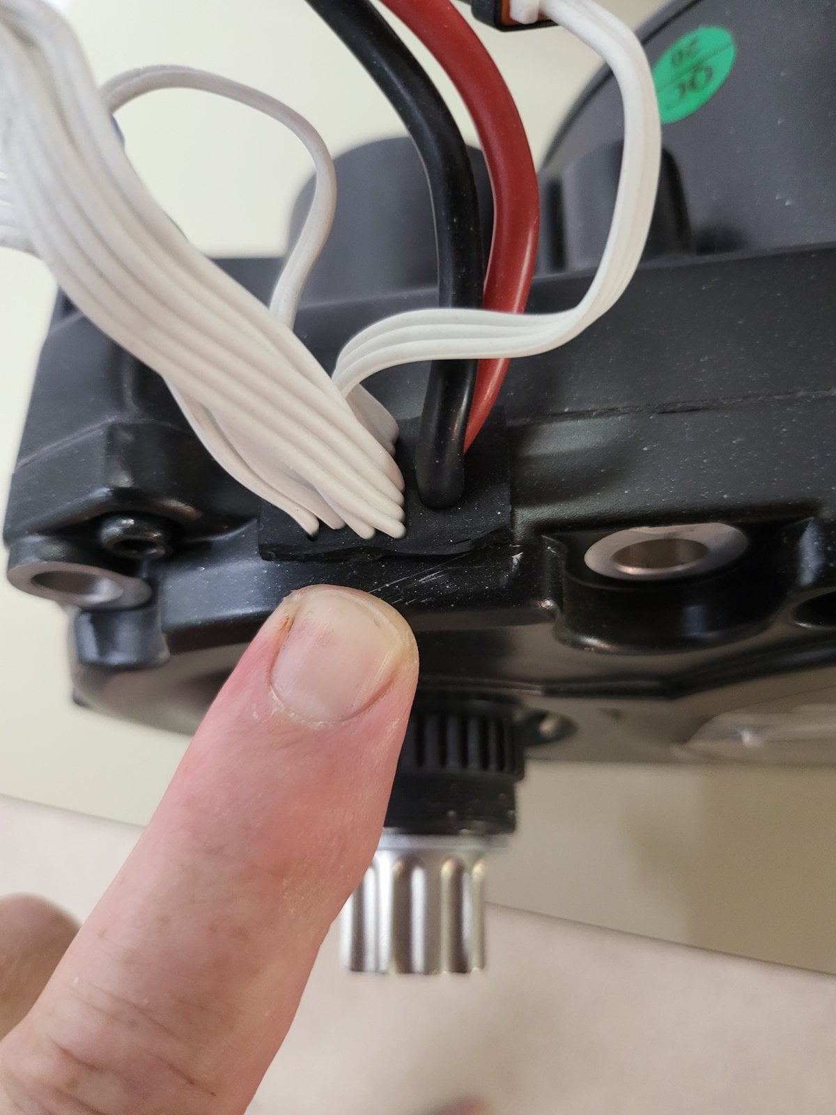

Anyone had any problem mounting the motor into the frame? Mine does not align properly..
Mine was quite tight. I had to get one bolt started, then tap it home with a hammer, then the next, tap it in, then the third and tap it in.
Just make sure that you don't have any wires or connectors getting squashed. And double check your rear derailer cable, and brake hose, to make sure that's not obstructing anything.
The pad around the white cables on the motor already pressed into the frame. Can't go any further than that. Might be frame defect?
I did a cold fit on mine before painting and I had the same issue I just trimmed a sliver at a time off the motor wire grommet with a razor it fits fine now I took maybe a 16th of material off .. hers a pic for ya
Thanks guy
I thought of doing that. Just making sure it's not frame defect..Thanks for confirming.
Glad I could help just be careful dont accidently nic a wire .. lol.. Ya I thought possible manufacturing flaw as well but I think it's just bafangs choice for grommets I thought of possibly filling out the frame, but this is much easier and has no effect on the motor . Let me k ow how it goes ..

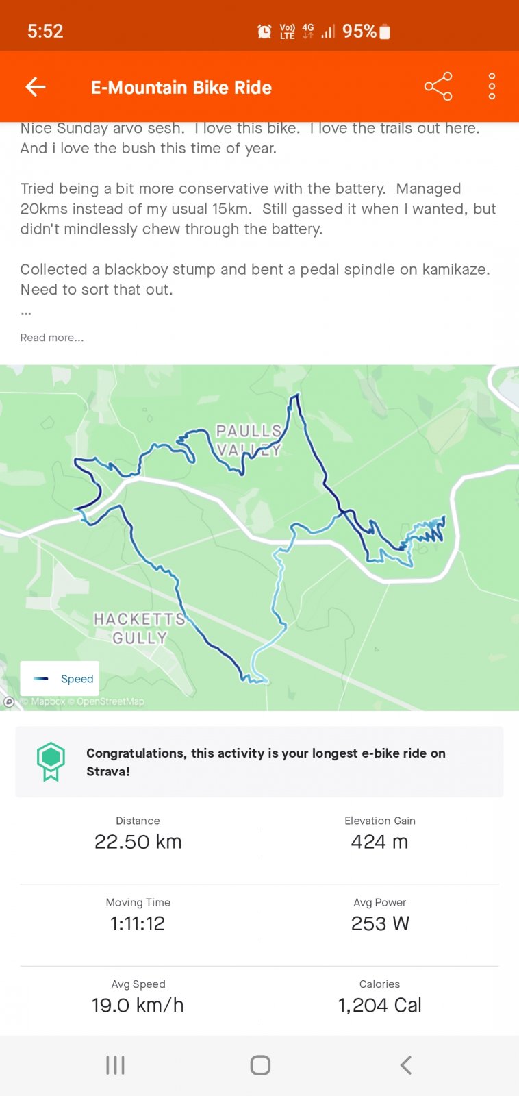

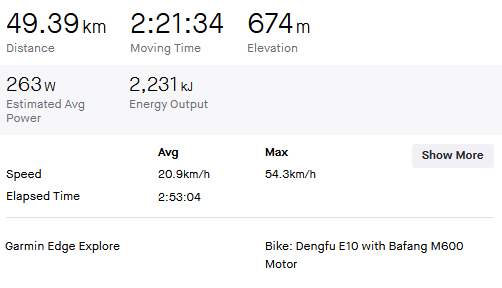

Interesting to see others Strava details in comparison where the throttle is not used. I used just over 60% of my 800Wh battery on this ride, using about the same energy and yet nearly twice the distance and almost 40% more elevation, with the same average speed on probably similar single track.
Totoally different motors with the m600. And different riders, since my vax myocarditis I've put on a fair bit of weight and I'm now over 100kgs. I'm also not pedalling much aswell, as I don't want to aggrevate my heart injury. (I'm still getting occasional chest pains after my rides, 10 months after my jab.) I am trying to build up to fitness slowly.
But even still, I did set 2 x KOMs and a few top tens aswell, so the motor is def working.
My brakes are also making alot of dust. Which I've never had on any MTB before. So all that energy is probably going straight into the disc rotor at each next corner.
I wish I wasn't so dependant on the throttle. But I am just glad to be out there again. I spent 8 months on the sidelines. The motor/throttle gets me back out riding, without it I probably wouldn't be able to ride still.

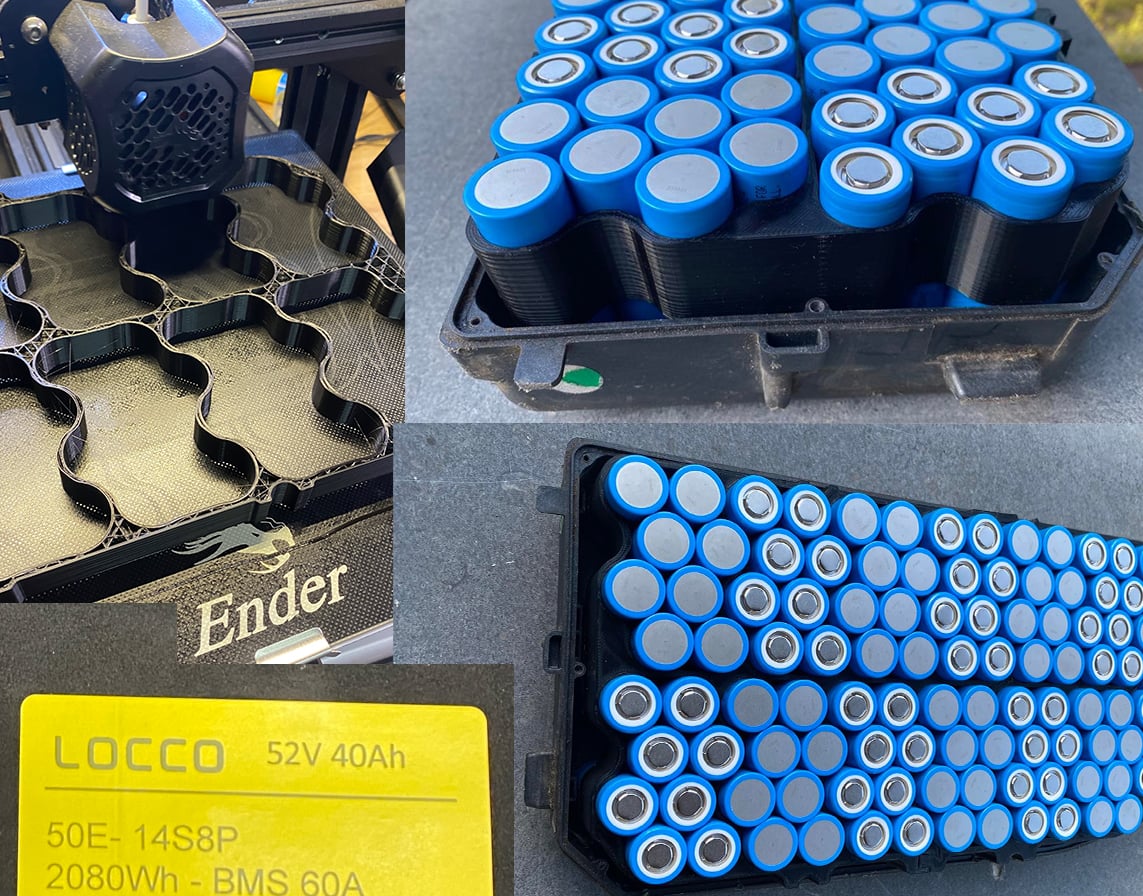

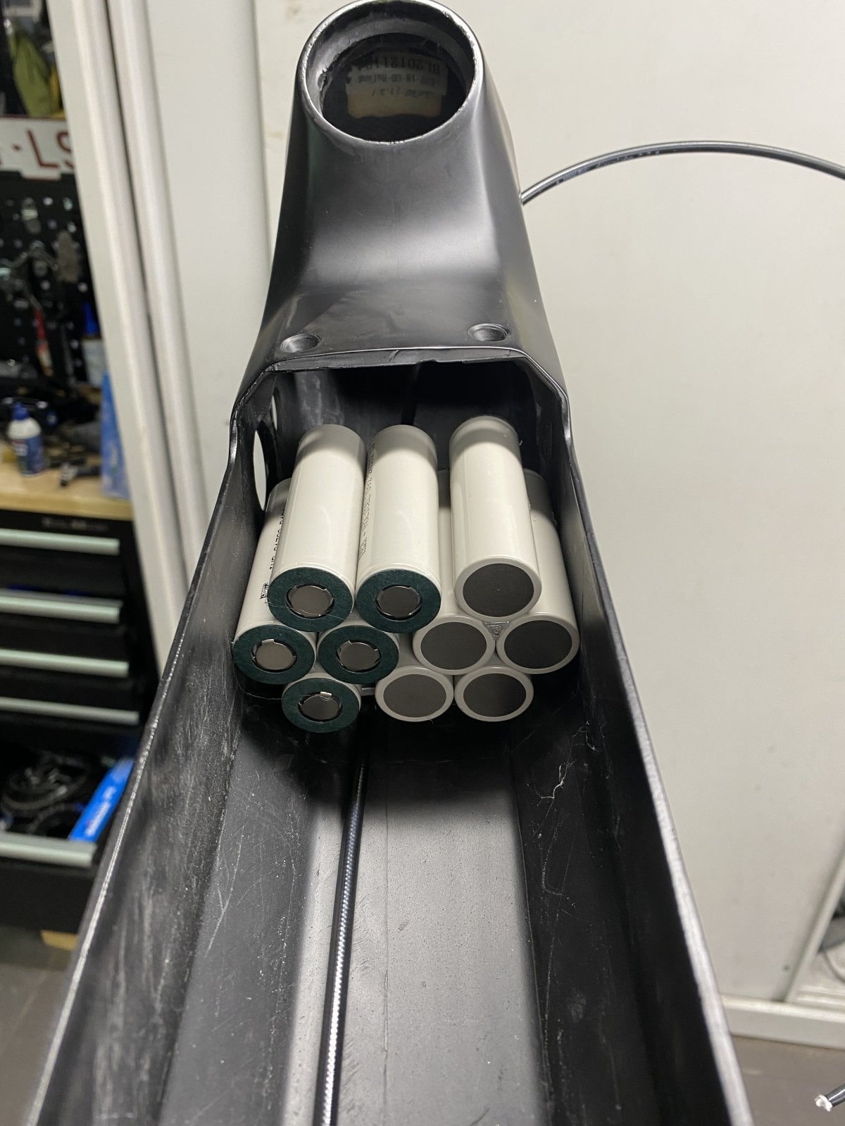

Fusion 360.
Will take another week or two.
Yes 21700 looks better.
Samsung 50E's are relatively cheap. (3.75€ @ Nkon)
18650 in 5P max 17.5Ah
21700 in 4P 20Ah
Cables run between frame and battery. There is enough room.
Yes I might sell some. I make a lot of custom batteries.
Any updates on your battery housing design @Daxxie?
