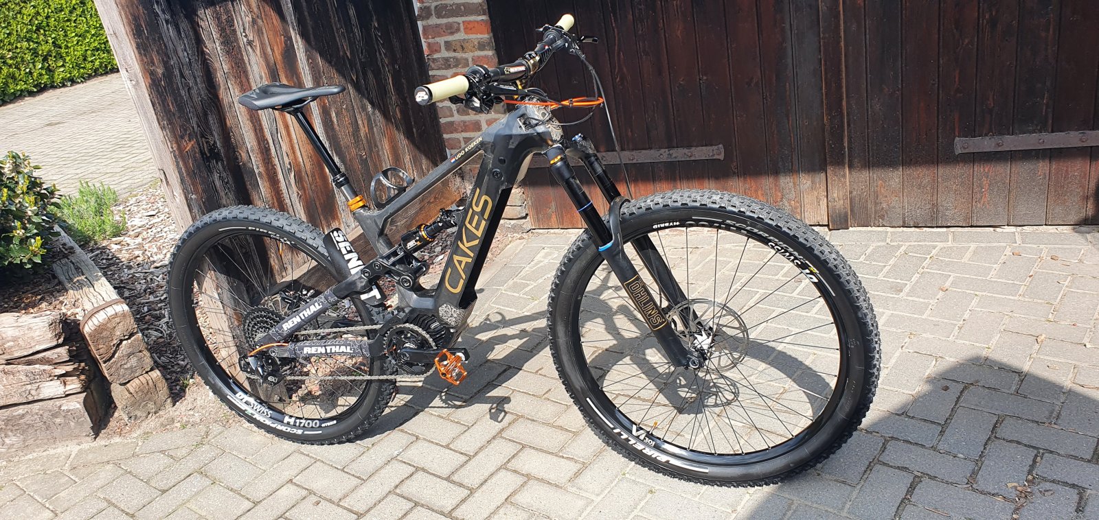

Soooo with some tire and suspension set up you can send the bike anywhere.
Bike park, mountains, city and urban ...ect.
Off course for commuting its a little overkill but the fun thing is you can take any exit or path you want.
And the better compound tires you will be surprised what you can do with them on a easy tirepressure.
Oh yes also did some foam in cable holders in the frame and in the front used some flexible glow to fill holes not used and make sure cables do not chatter to much
And there is a chance i end up using one click up more visco suspension oil to have a little broader set up, but thats done after the first 100 houres or something.
That was also the best solution for my xc fully with factory suspension together with a little more negative volume.
But thats all ok with the ohlins and cane creek. Realy plush.
I like it a little firmer so its working the best at harsh speeds and technical sections.
Cheers

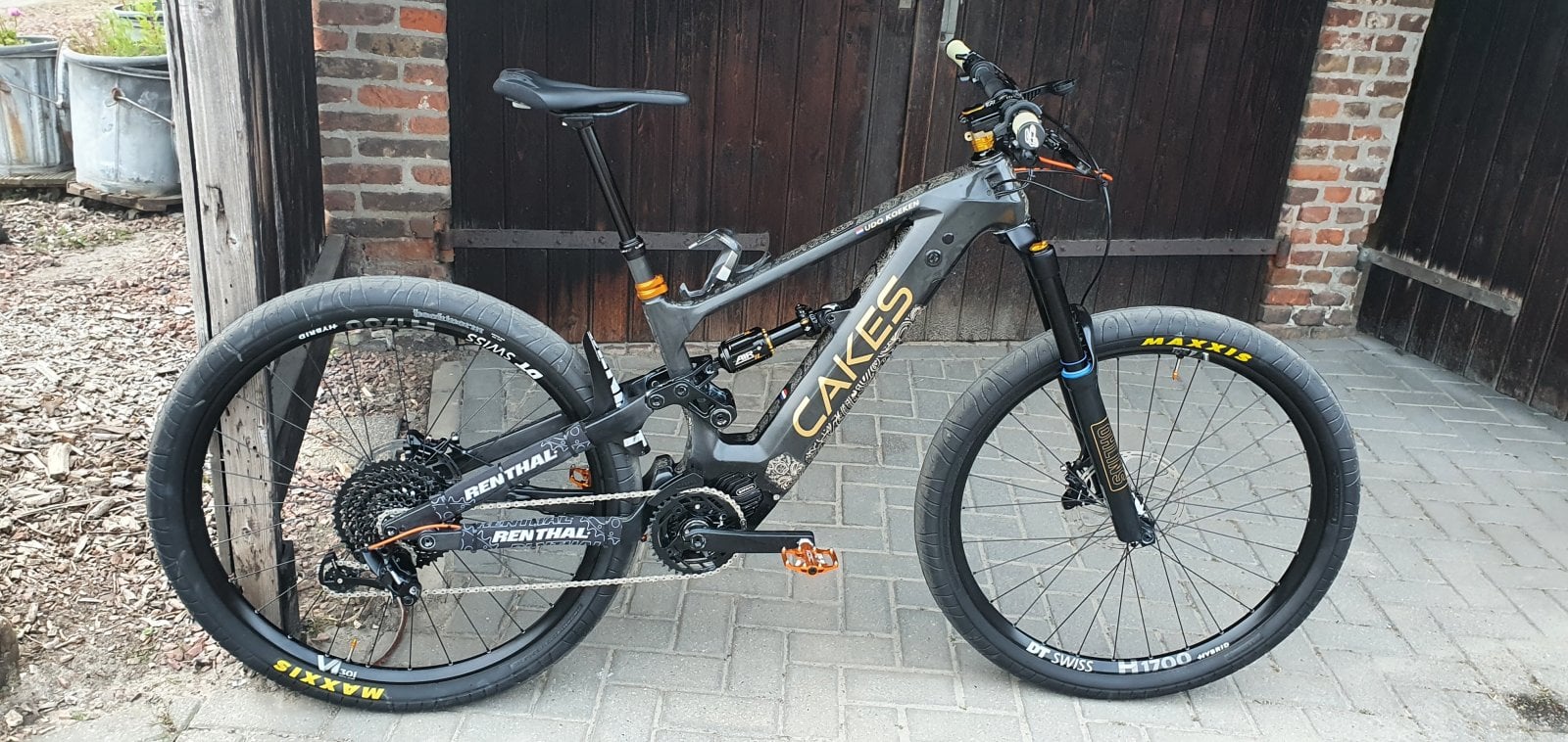

The spec
15.5 inch frame
Ohlins evo 160 51
Cane creek db air 210 55
Renthal cockpit 770 wide
Dt swiss h1700 hybrid 29er
Sram ex1
Sram guide re
175 dropper Ks suspension
2 x 840 batteries for the long fun days
M600 and M500 depending on use
Sqlab x06 saddle
Some renthal frame protection
A mud guard
Some stickers from riesel design and some custom stuff
Also put in foam in frame opening for cables and also on the rear triangel to hold out dirt
Off road i run pirelli 2.6
Maxxis tires are for urban racing and commuting.
I was surprised how grippy the where. And was almost racing supermoto again LOL

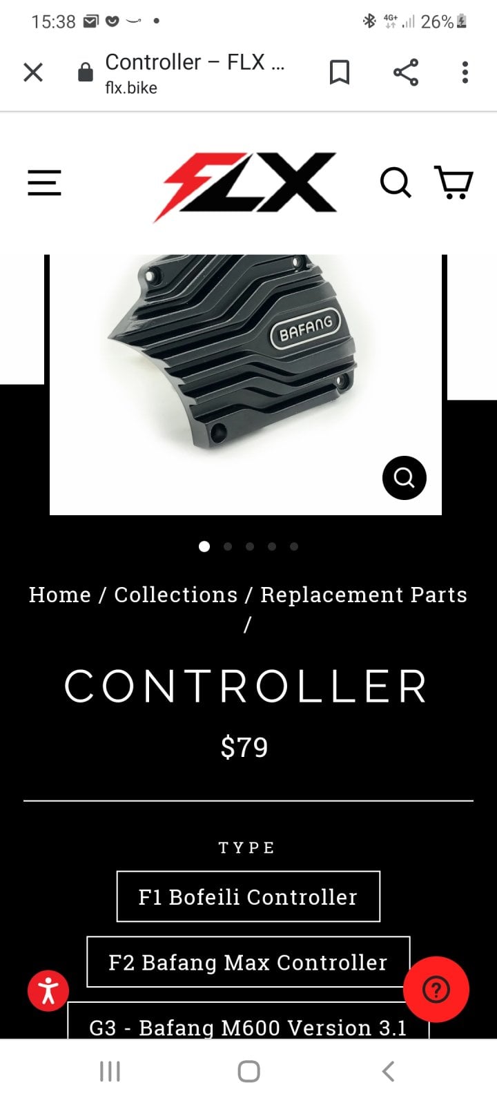

i had anticipated this failure and try all my possible to prevent it. A random failure will be always end up breaking definitively. but i had hope i will have time to purchase spare part to store it.
Since several month i have spent a lot of energy to try to purchase an controler. IMPOSSIBLE to purchase for M500. nobody store it, dengfu accept to sale one (for a motor who has been saled with warranty) but they need to order it to bafang without information of delivery.
On the quantity of dealer solicitated, only two have answered. TOSA have said they are out of stock and they do not know when they are stocked. Fang bike have say it wouldn't , because he need to order several to bafang to sale one to me. Nothing supplier located in east europe who propose it on their site have answered at my request. Do you know one dealer who can sale one ?
I have requested several time to bafang to say me where i can purchase one, never answer, only "our policy is to treat dirctely with supplier, not the customer". I'm blocked at home today instead of ride. in add i'm in vacation for the 2 next weeks. i am absolutly furious.

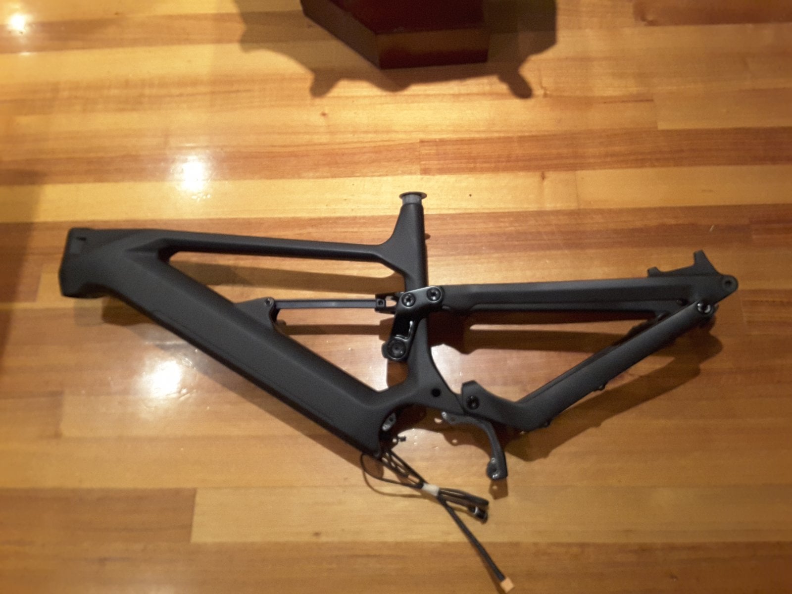

Well frame turned up today. Didn't expect it to look so big. It is a medium (17") looks ok though. 120mm HT.
That's everything I ordered from China. Now just need to build it up. You can see the charger hole is on the left side now. There is a key to unlock the battery aswell which I like. Anyway hopefully my healing from the fall and the build will coincide. I like how thick the frame wall's are too.
