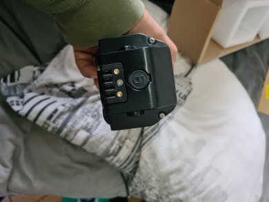

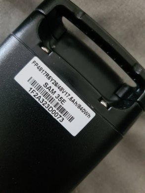

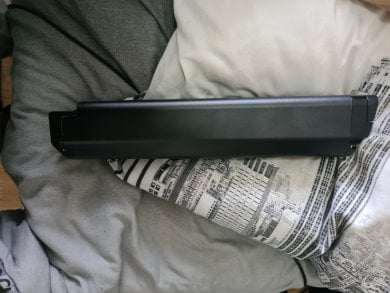

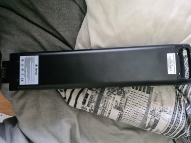

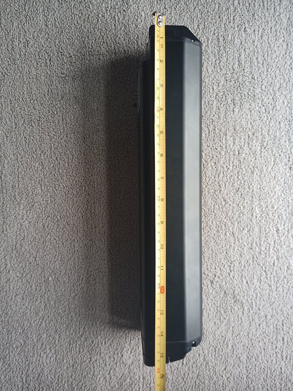

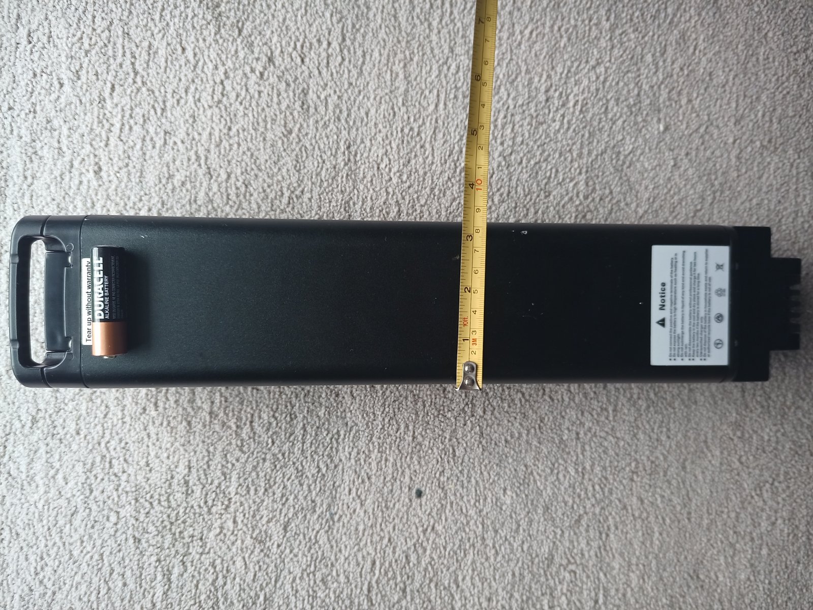

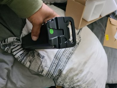

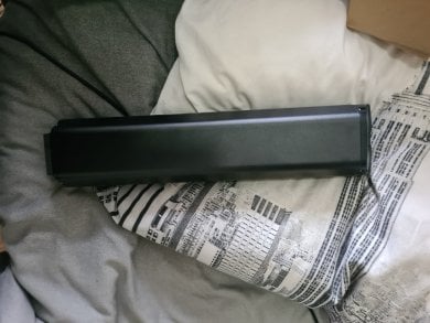

Could I please ask a favour? For those of us that want to build our own batteries for the E10, it would be great if someone could please post some detailed photos of the current Dengfu battery case, showing any part numbers etc along with external dimensions. Hopefully we can then source an empty case from the likes of AliExpress etc.
Its not essential to have the bespoke battery case, but it would be nice!
Thanks in advance.
hope this helps

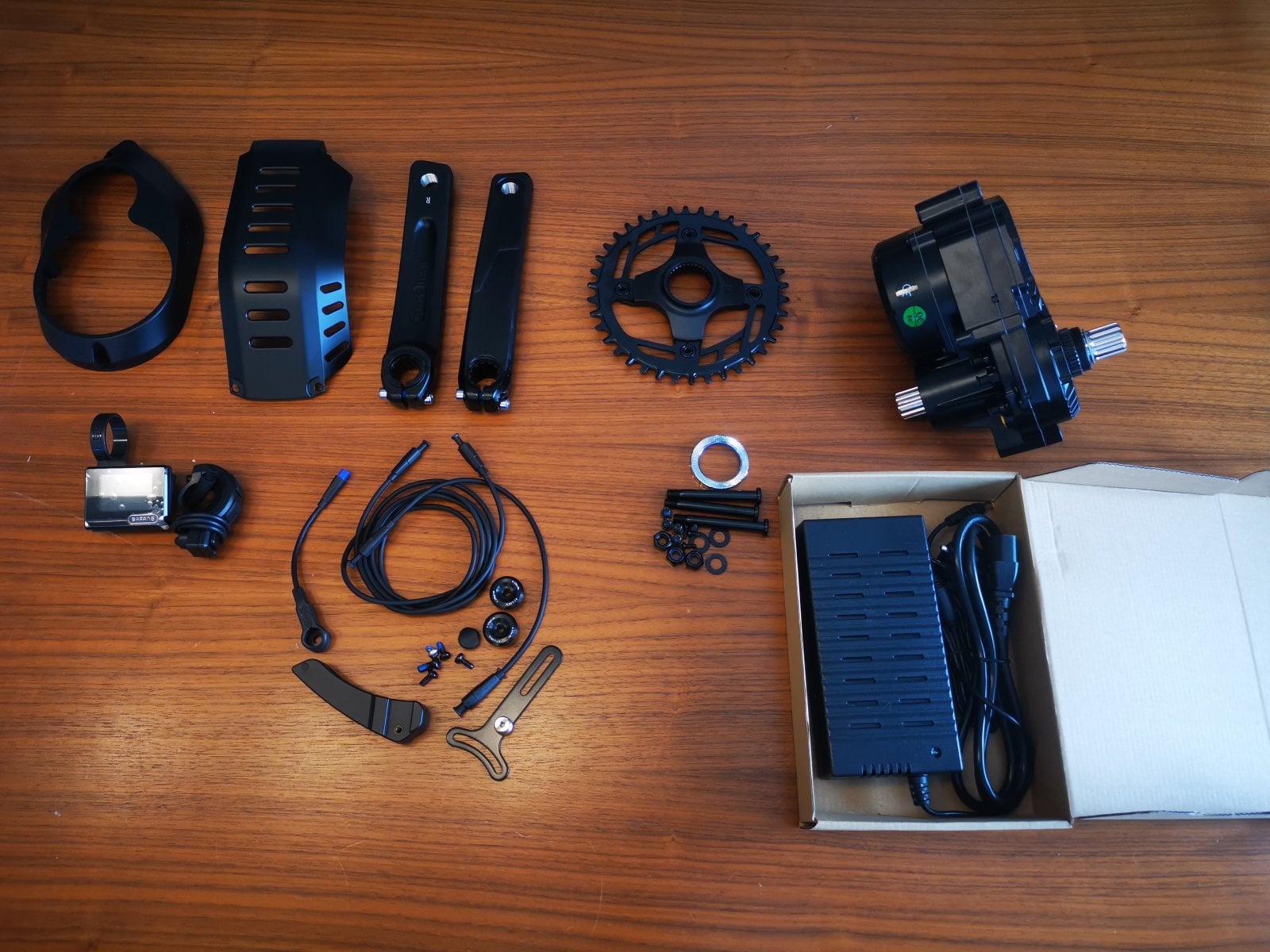

It was around the 19th last month battery turned up then the motor turned up 3 to 4 weeks I think it takes
I presume you got some sort of tracking, Melody asked for a tax number last week and not heard anything since.

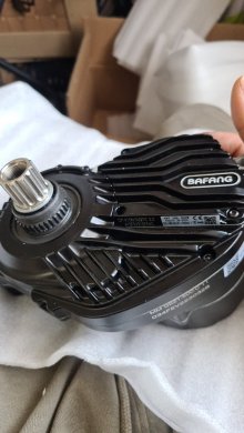

I received my motor yesterday too. It looks like it’s going to be more than a month before the frame and battery arrive. I notice that it’s the DP C241 display which has Bluetooth. Has anyone tried the Bafang GO app on their phone with it?

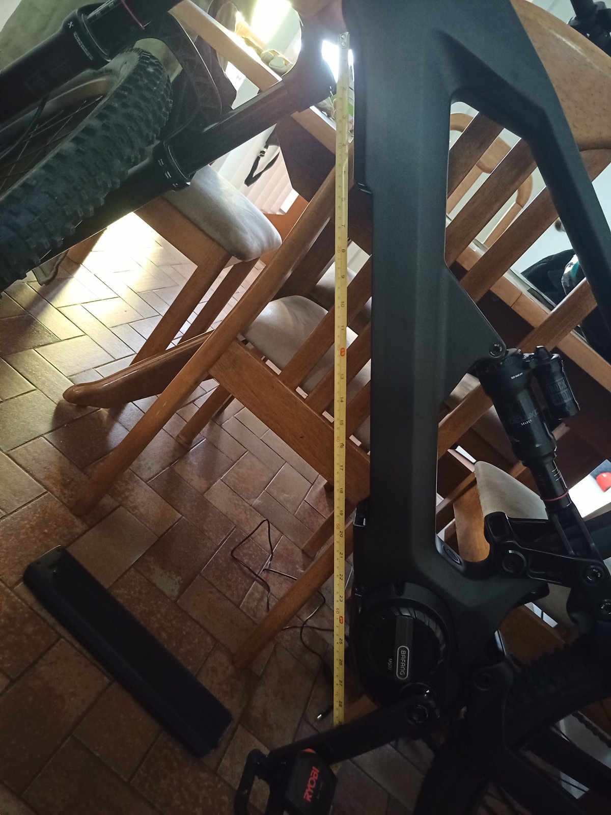

If you have an E10 frame, can you provide dimensions of the battery space?
Do you mean the battery lock and the base for connecting the battery? I'm not sure, but it only gets you when you buy batteries in addition, and are currently sold with a lower capacity and more expensive. That's why I'm not interested i try build my own.

On my pre-built, the battery space is approximately the same as the battery dimensions.

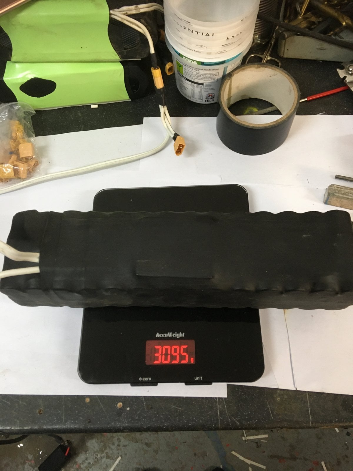

Guys aren't you getting a bit over excited about actually how much W/h's you really need. I'm using Samsung 50E 21700 batteries in 14S3P format. I've yet to fully flatten it ( I'm only using about 500W/h's ) over 3 hrs of riding, doing in excess of 1K metres of climb all on single track and often steep climbs.
Now that battery pack is nearly 800W/h's, fits easily in the battery compartment ( its less than the length of the cover ) so I reckon pretty easily 4- 5 hours of riding, I don't want to do any more than that.
If you really want to push things I reckon you could get a 14S4P pack of Samsung 50E batteries in there but you will be up around 4 kilos of battery and would you use the 1000 W/h's ever ?

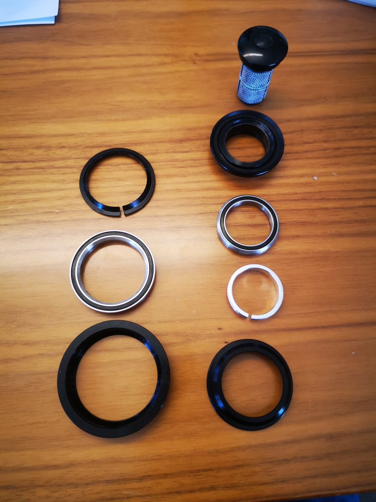

Assemble headset: Hi guys, the parts of the headset came and as i never installed one I wanted to ask help for the right way of assembling it. Can someone help me also by telling me the if I did bring themto the right sequence?
