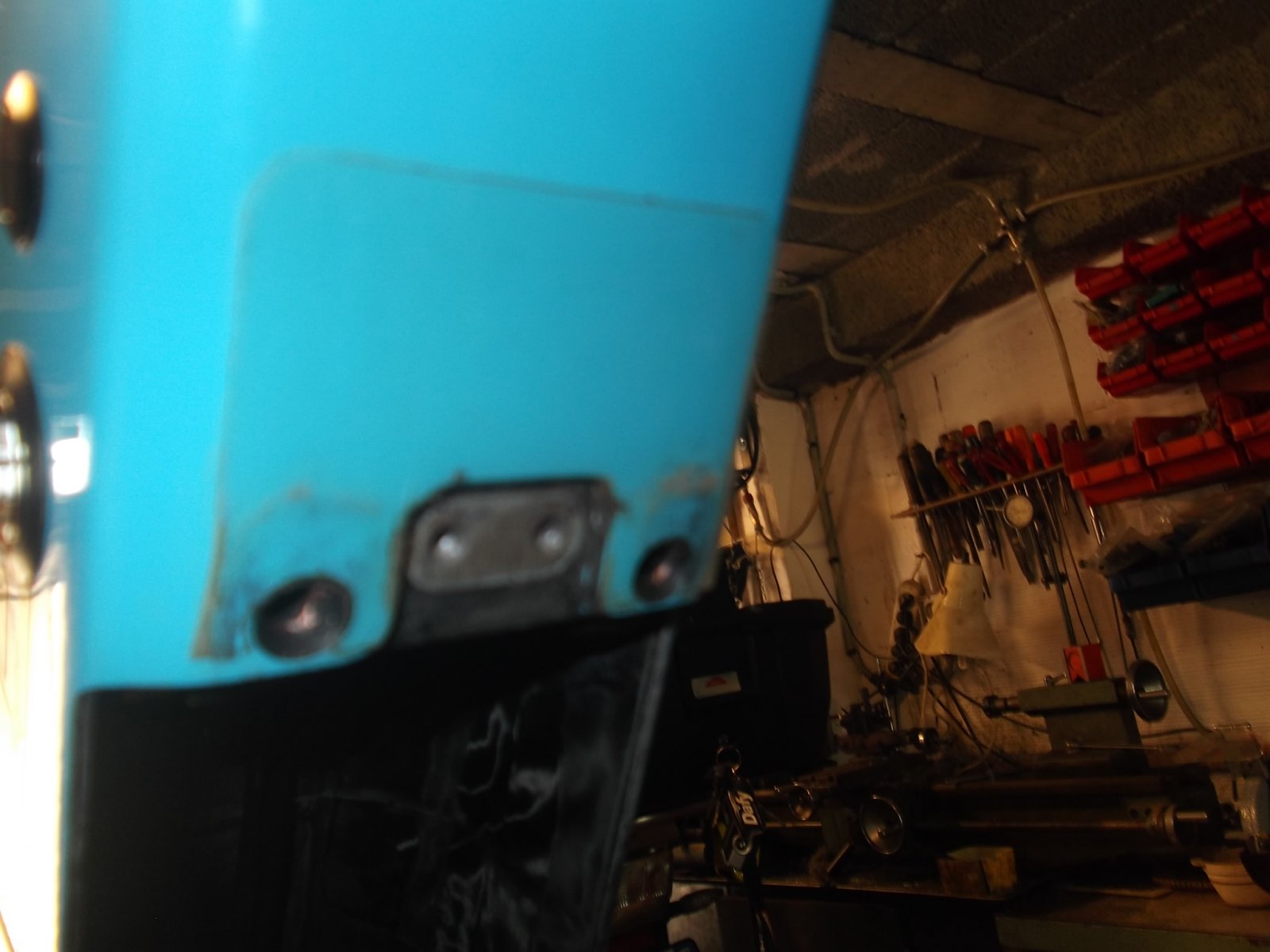

Hello,
I have a problem with the hood Help me pleaseView attachment 57542
pity that "bebert" do not said more. On mine i have different assembly ? It will be interesting if it explain us how past warranties.

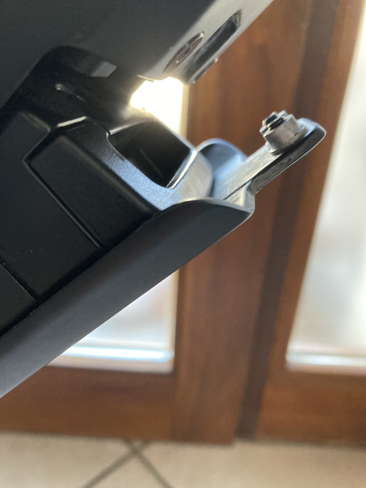

Could I please ask a favour? For those of us that want to build our own batteries for the E10, it would be great if someone could please post some detailed photos of the current Dengfu battery case, showing any part numbers etc along with external dimensions. Hopefully we can then source an empty case from the likes of AliExpress etc.
Its not essential to have the bespoke battery case, but it would be nice!
Thanks in advance.
