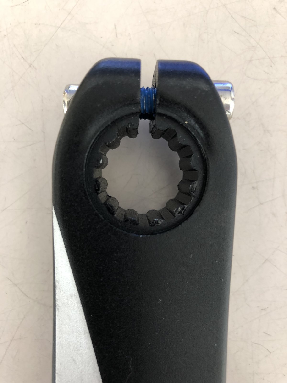

By chance someone knows what a standard crankshaft toothing is and whether there are lighter / shorter cranks for sale ? Thank‘s (y)
(3) Dengfu E10 Suspension/Wheel Options - EMTB Forums
To complete my previous speak on this subject.
It's specific BAFANG ISIS, only original cranks can be used (at this time)
I have asked to MIRANDA and LEKKIE last year ;), they answered "in study" (i think they still doing study)
After built and test mine E10, shortener cranks not necessary.
But if somebody really wants a set, i can sale or exchange those i have built (154mm)

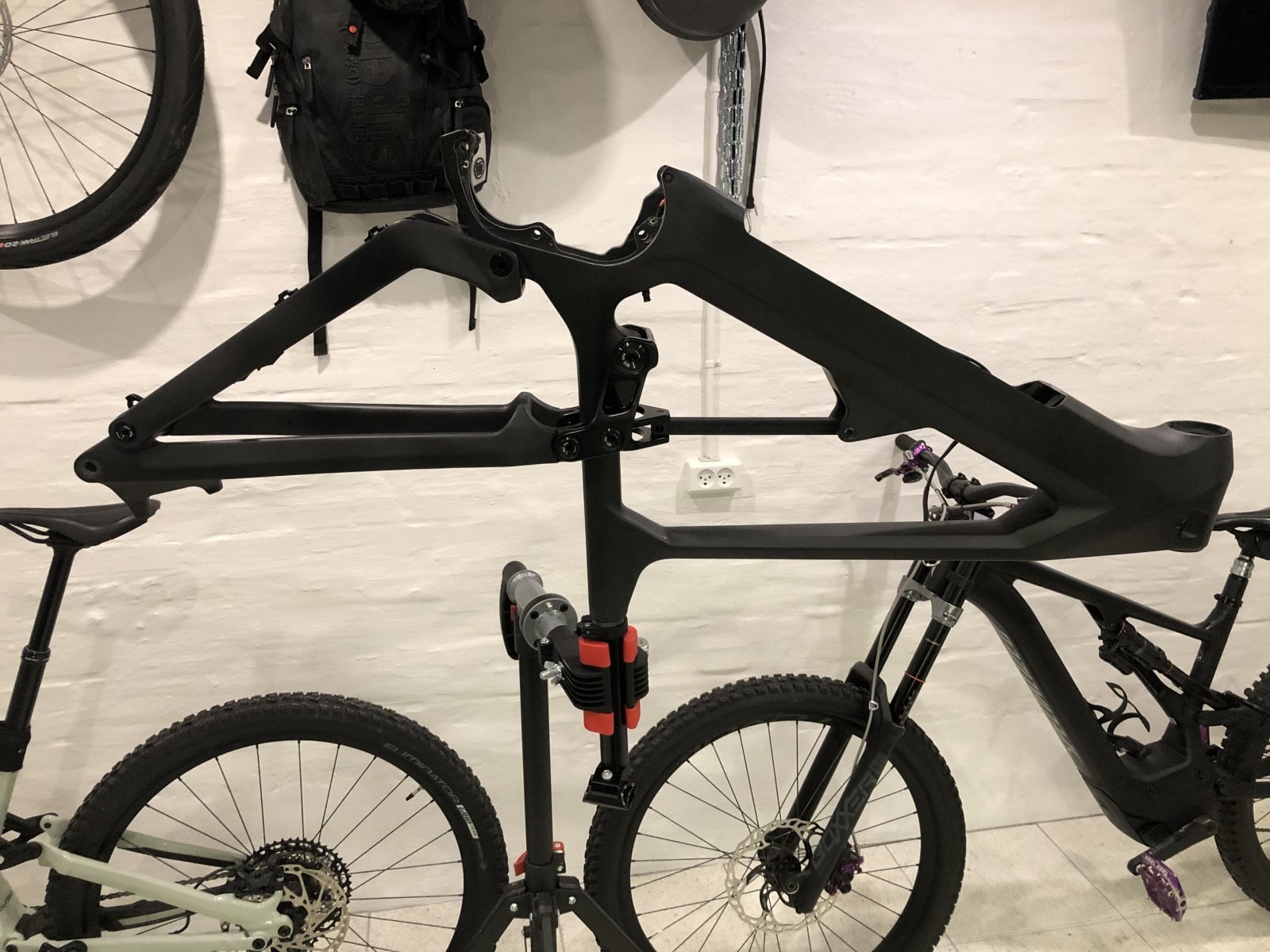

Rob what are your exact specs fork? 180mm 44 rake like you show in your order Bike discount?
Want to try 29er front and rear with ZEB Ultimate.
Have you tried a coil shock?
170mm 44 offset. Not tried a coil, wanted to but zero stock!
