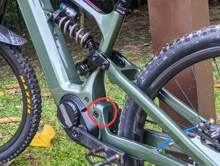

@thaeber What did you use to close the hole next to the battery lock? There is another hole above the engine how did you cover it?
Sorry I don’t get it. What holes are You talking about? Can You please do a photo?
No problem! 🙂
This hole is meant and there is another hole above the motor.
Ok thanks, that’s why I didn’t get it! Both holes are not closed, they are cut out and the on/off button as well as the charging port are installed.
As I understood, did you put a charger or charging circuit inside the bike frame?
