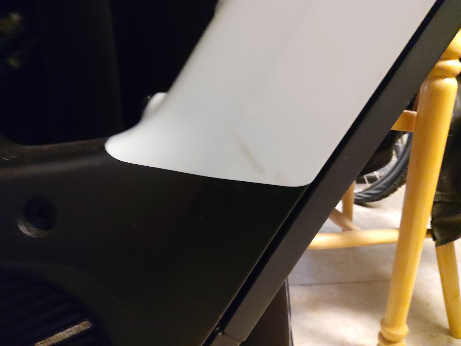

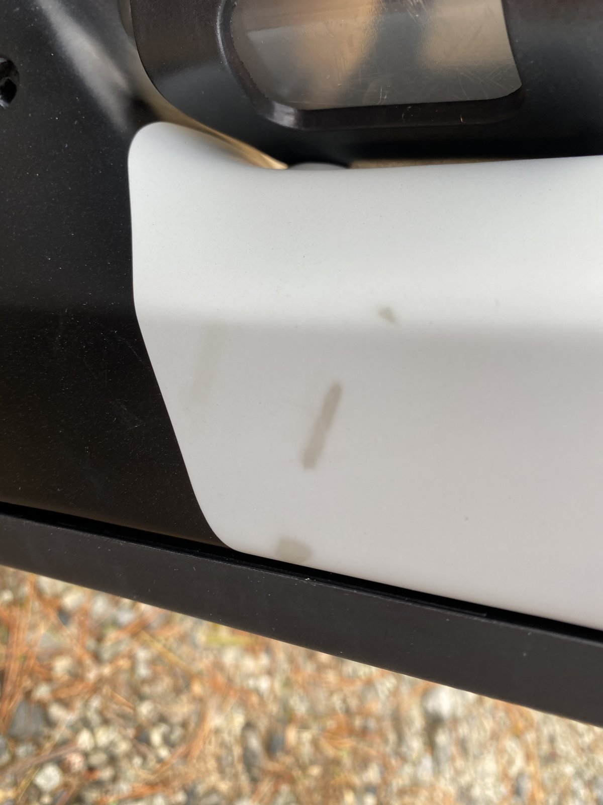

rode the new shred for the first couple of times and noticed this spot above the motor. Texted my buddy who also has one and has an identical spot. Could a wire get hot enough to burn through the carbon? It’s too high up to be foot rub and his bike has the spot in a almost identical pattern.
Whoa.....think that will require pulling the battery to see whats going on in there!

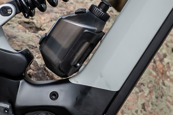

Damn! Just had a quick look at mine and its got the exact same mark! I've only had the opportunity to ride mine for approximately 45 minutes and just around town. Hasn't even seen serious dirt yet!!!
I have and it doesn’t seem like there is really anything in that area. Just thought it was weird my buddies bike had the exact same pattern.
Yeah that’s my plan to write them tonight. I rode today and couldn’t feel any heat in that area. But it looks like a burn

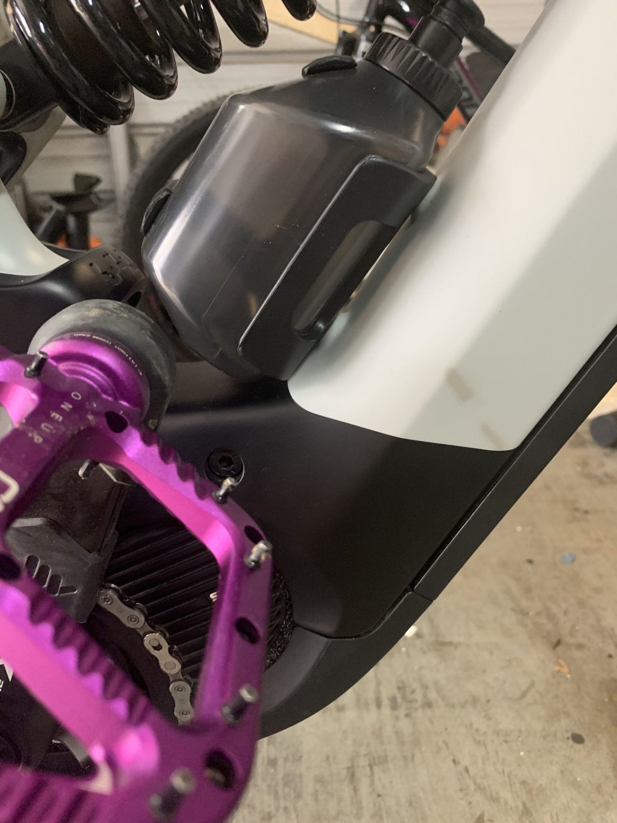

And here's a photo of mine. May be hard to tell from my shitty camera but definitely seeing the start of the same discoloration. Bummed!
I as well have the same discoloration in the same spot. I noticed it when unboxing the bike and thought it was some smeared grease or something and didn't think anything of it until I later cleaned the bike and couldn't get the mark off. Here is a picture of it just put together out of the box, never ridden. Although I believe it had 1 mile on it already out of the box.
Haven't pulled my battery yet but theorize it may be getting hot and discoloring the frame???
Wonder if any of the other Decoy owners have the same issue and just can't see or haven't noticed it because of the paint color on their bikes in that area?

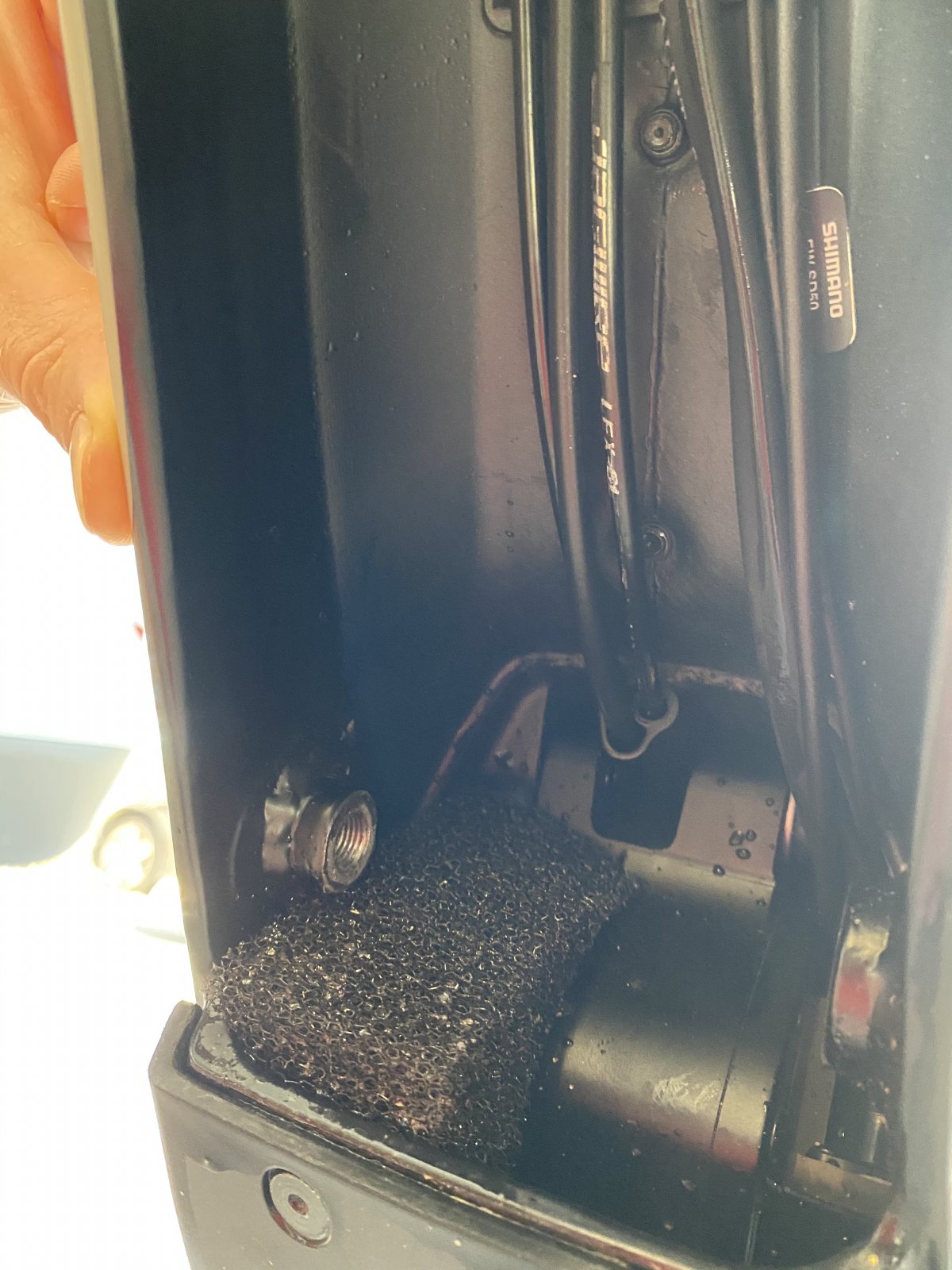

I took the battery out and don’t see anything in that area. My guess would be the battery getting really hot but I don’t see any damage on the inside.
Another thought....maybe the battery is getting too warm during charging and discoloring the frame?

To be fair the rest of the bike has been awesome. So smooth with the coil shock. My father in law has the 29er pro in the black color and we could not see the marks on his frame.
I would suspect thats just bad paintwork out the factory, never heard of a battery getting hot enough to do that, let alone manifest itself though a frame like that - the motor get a lot hotter than the battery too.
That’s what I originally thought but I found a picture before I ever rode the bike and it’s either not there or got a lot worse

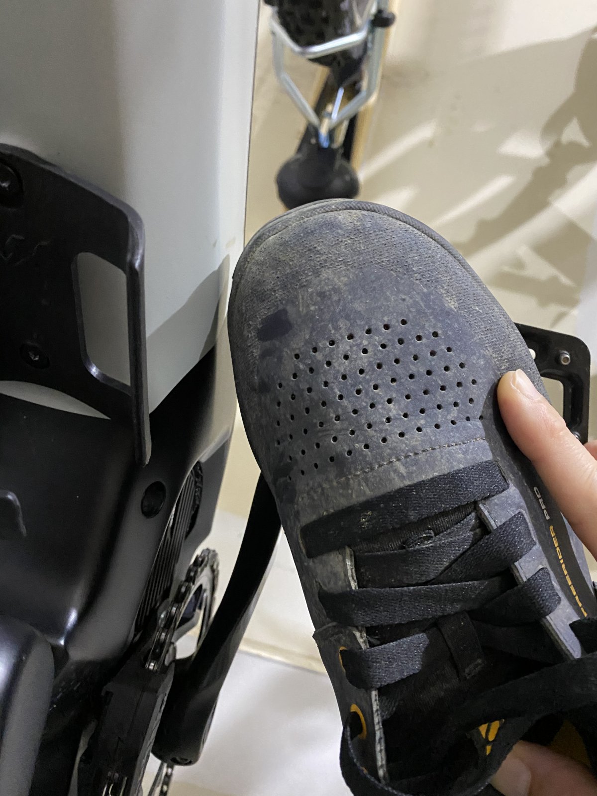

YT seems to think we all have really big right toes.
View attachment 44013YT seems to think we all have really big right toes.
I was going to say, that the mark is in just the right place to be caused by being rubbed by something while pedalling either shoe, shoe lace or trouser leg.
It doesn't look like a serious issue.
Hopefully it is just cosmetic I just don’t see how a shoe could cross the crank arm in the front part of a pedal stroke. Also why is it only on the right side. Either way I’m sure the bike will get scratched up as I ride it I just don’t want it to be a sign something is wrong with the bike.

Shoe mark my ass! Not even if we all had the exact same shoe size (and shoes)!

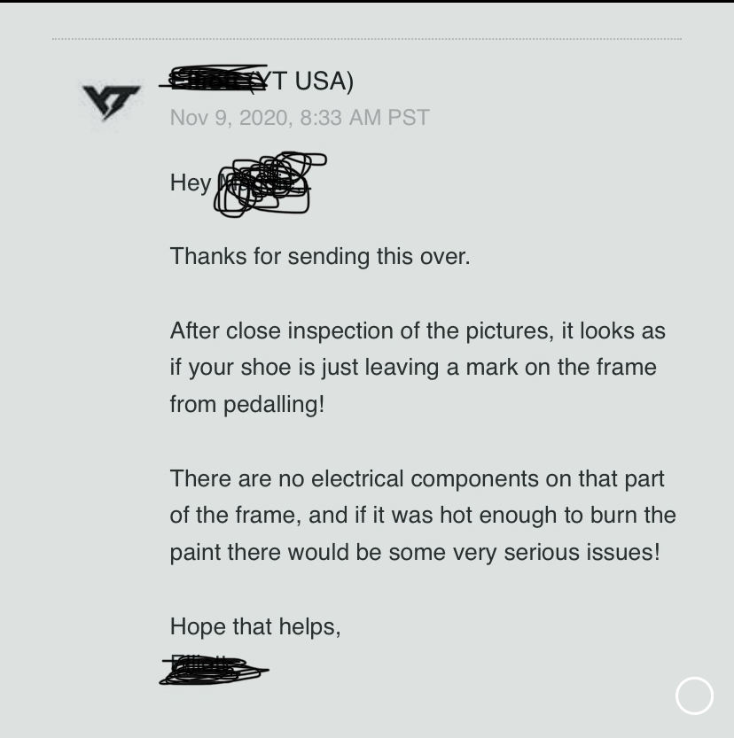

YT wrote me back again after checking with the German offices and said it’s from the tires rubbing the frame during shipping. They said it’s strictly cosmetic don’t worry about it.
Got the same email. Don't remember seeing the marks as I was assembling my bike but could've easily missed it. Big relief!!

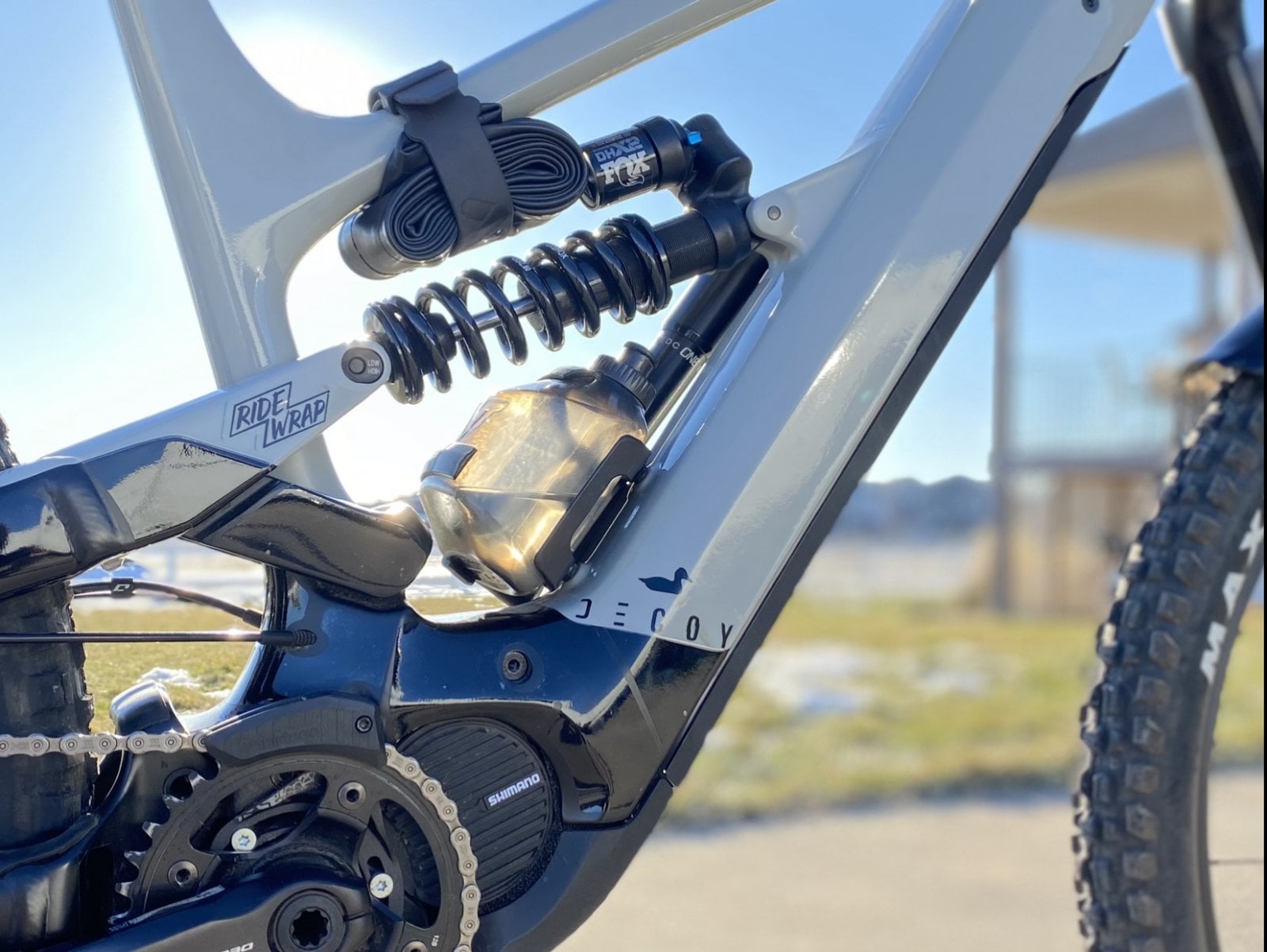

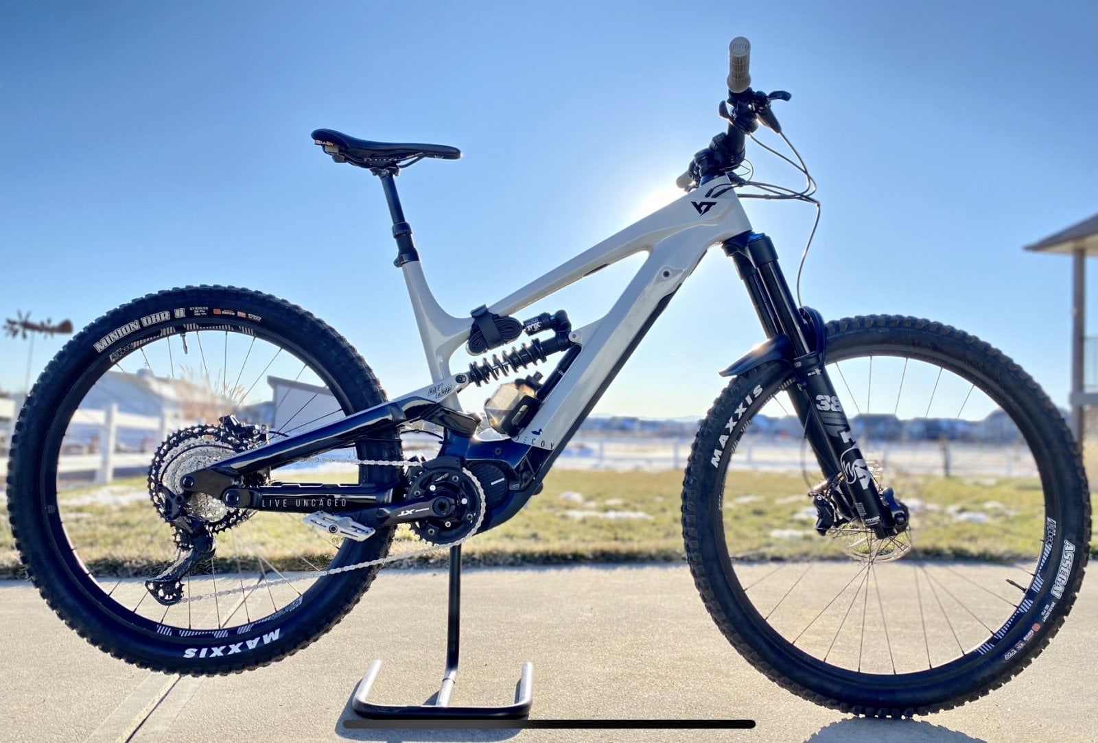

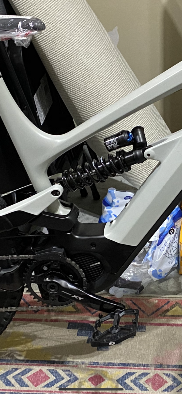

Made a little decoy sticker to cover/distract from the rub mark that came from shipping. Happy with how it turned out! Also weighed the bike, Size XL, Carbon bars, Tubeless, and Invisiframed: 54lbs
How is your bike performing? I've not been able to ride mine due to injury....hopefully soon!
Like the tube placement.
Cheers
View attachment 45895View attachment 45896
