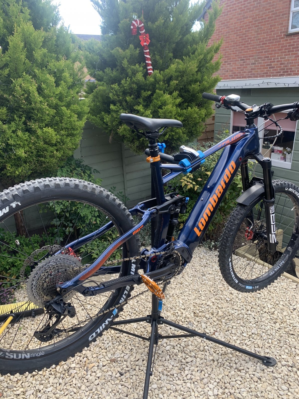

On reflection, the frame is on lots of bikes. Lombardo, Forme, Corratec as well as Decathlon. I'd be sending out a few emails, see what comes back.
