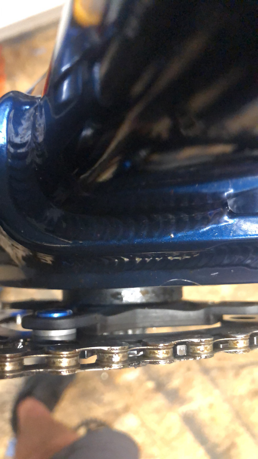

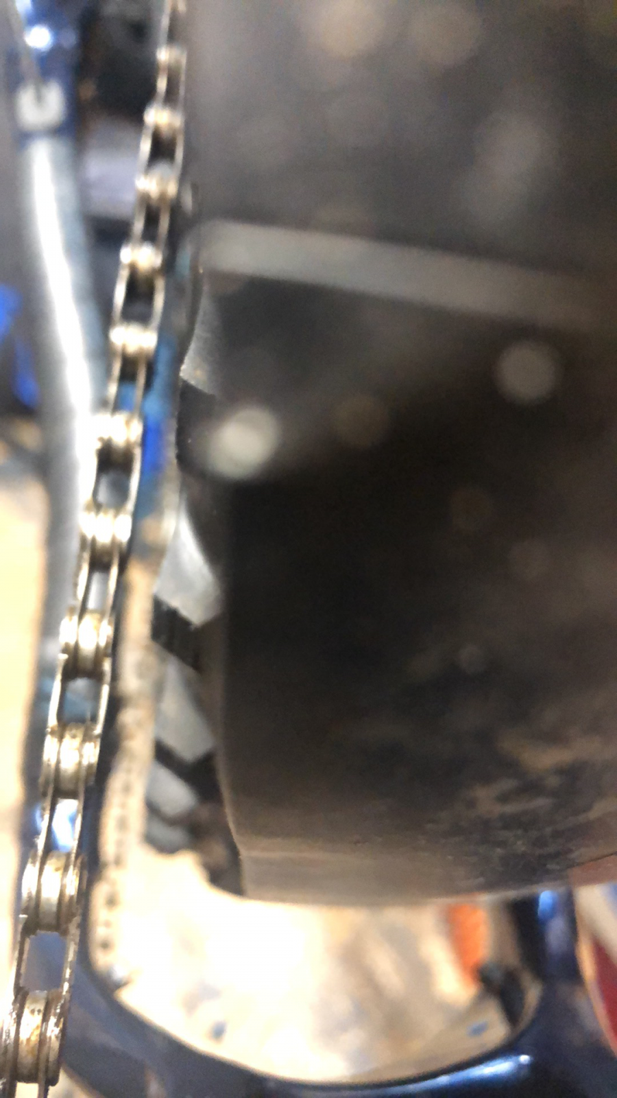

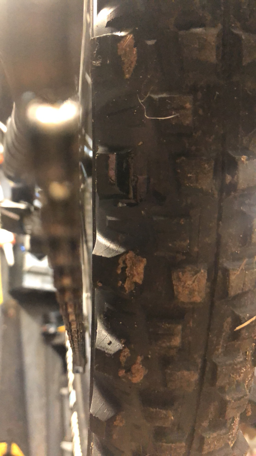

I’ve added 3mm space to the chainring and that’s the clearance on the rear tyre 2.8 wide
I’m making a spacer to fit on the shaft of the motor and remove the 3mm spacers on the chainring hopefully that will work

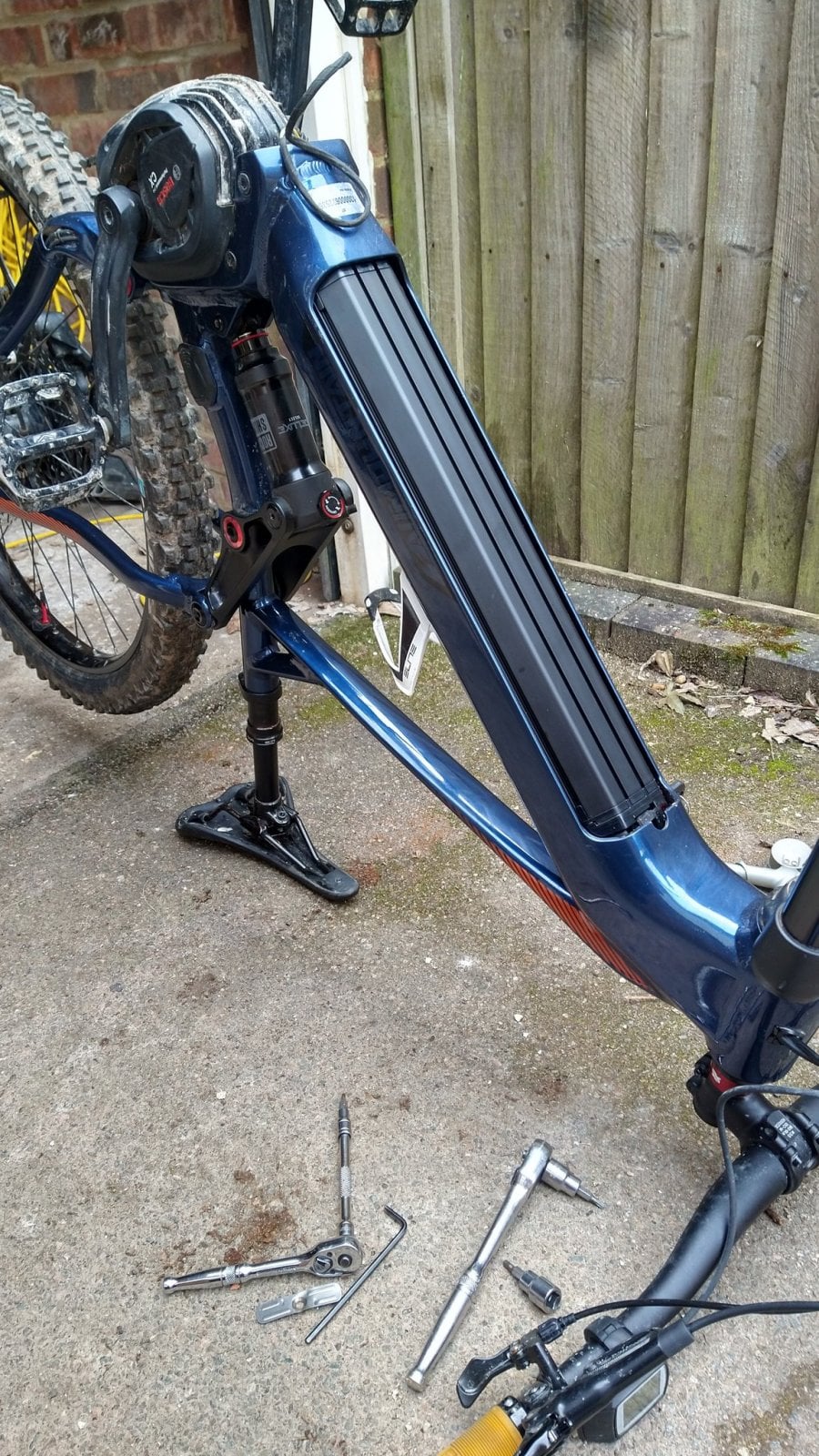

625wh battery upgrade. Am I right in thinking to fit the longer battery, the bracket at the motor end of the downtube has to be loosened & moved toward the motor?
This doohickey.

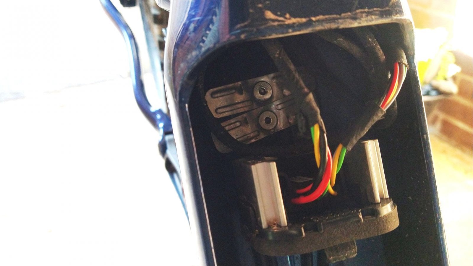

The 625 battery is longer than the 500, so I have to move the lower bracket about 7-8cm ish towards the motor in order to fit it in the downtube. The task for today is working out how to do that.
Okey dokey, it's in & working but has taken a bit more effort than I anticipated. The lower battery bracket is itself mounted to the frame on a metal bracket & I've had to reverse that metal bracket to allow me to move the bracket backwards sufficiently to accomodate the battery. In turn, that meant removing the bashguard so I could move the wiring about & to do that, I had to depressure the shock in order to move the rear triangle so I could get to the bashguard allen bolts. Phew!

Just as an add on, if you get an old Allen key and bend the short side (it's only a small size), you can get away with the shock faff to remove the guard (with patience).

You definitely don't have to remove the bash guard to fit the 625w battery. As you say Rusty you have to take the bracket of the metal holder and then turn the metal holder around 180 degrees and remount the bracket.
It's certainly tight doing up the repositioned bracket, but definitely doable.

True, I could have left the bashguard in place for sure but removing it it did make things easier as it allowed me to pull the wiring loom out of the way & so I could have room to precisely locate the battery bracket. Range wise, the last full to empty battery ride I had was wholly in emtb & that came out to 29 miles with nothing left at the end, on the 500 on a mix of single track & fire road with about 2k vertical & a mix of E wild on the rear & DHR on the front roughly 30/26 psi. I'l be happy to swap notes on range once I have a few rides notched up & I usually ride a mix of eco & tour,s so should see a decent increase, obvs.
