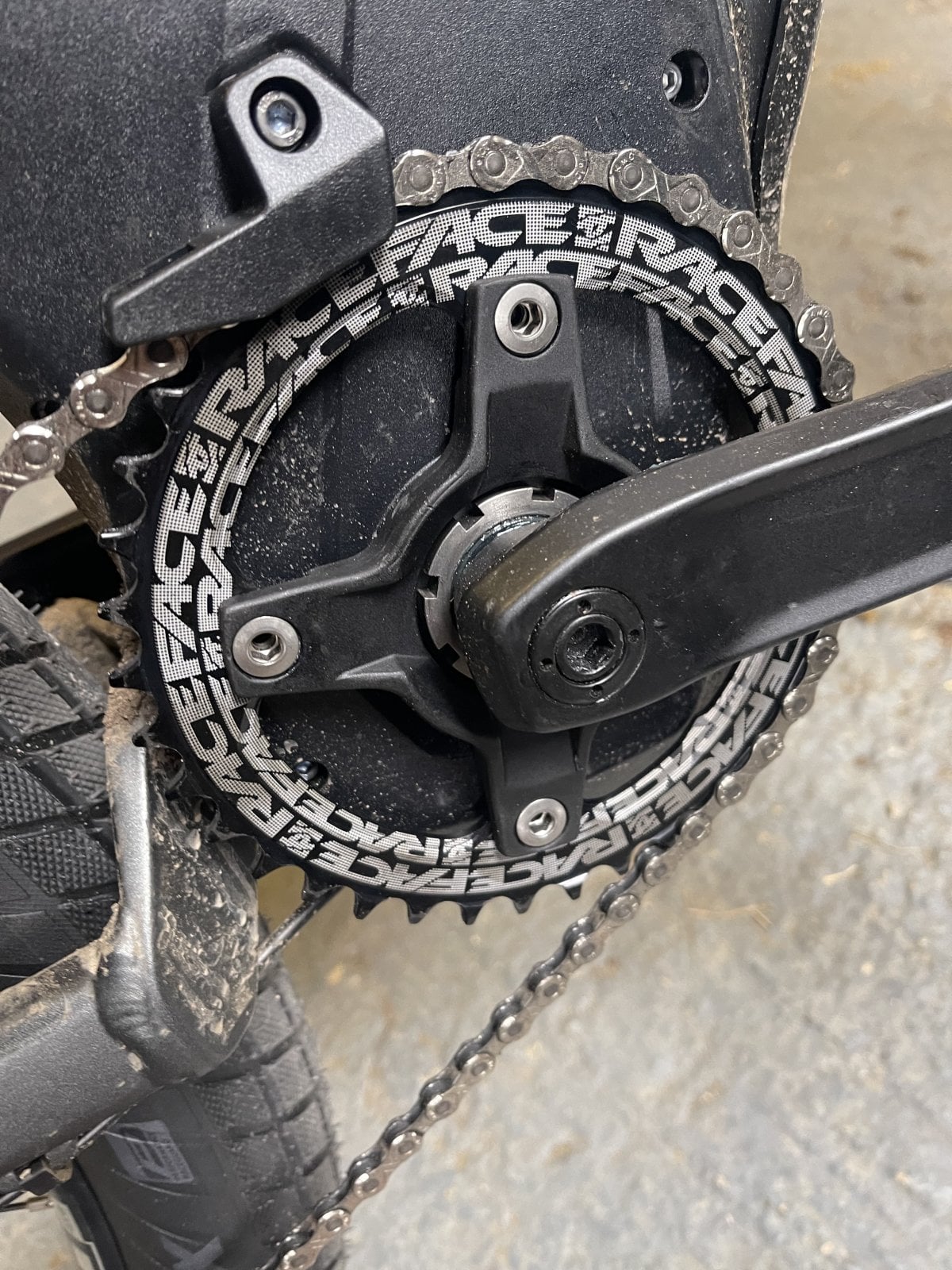

Hi,
I am new to this forum. I have recently purchased the RockRider eST900 and I am very impressed with this bike apart from riding on the flat and downhill.
After reading the opinions on this forum, I decided to change the chainring to a 38t one. I didn’t realise beforehand that this was quite a challenge!.
I took my bike to the local bike shop and they removed the crank arm fairly easily, then used the tool mentioned elsewhere to remove the lock ring. Then the spider should have slid off but was stuck solid, after several attempts they used some sort of bearing puller to remove it. Finally it was off but the chain bolts were absolutely stuck. The mechanic said that they had probably used industrial strength loctite when installing the bolts. A long soak in hot water finally released the bolts. The Deckas chainring I had purchased looked very flimsy compared with the one removed, I hope it is strong enough. The mechanic was concerned beforehand that the chain might not be long enough but it was just ok. Finally, I took the bike on a test run and it worked fine, the extra gear was worth the effort.
If you are thinking about changing the chainring then I would certainly recommend a local bike shop unless you have the knowledge and equipment to attempt it yourself. I was charged £15 which I thought was very reasonable.
Exactly the same today for me! Changed to 38t chainring, same issue but didn't need a soak but was very stiff. Also got tyres changed for £28.50 in total.

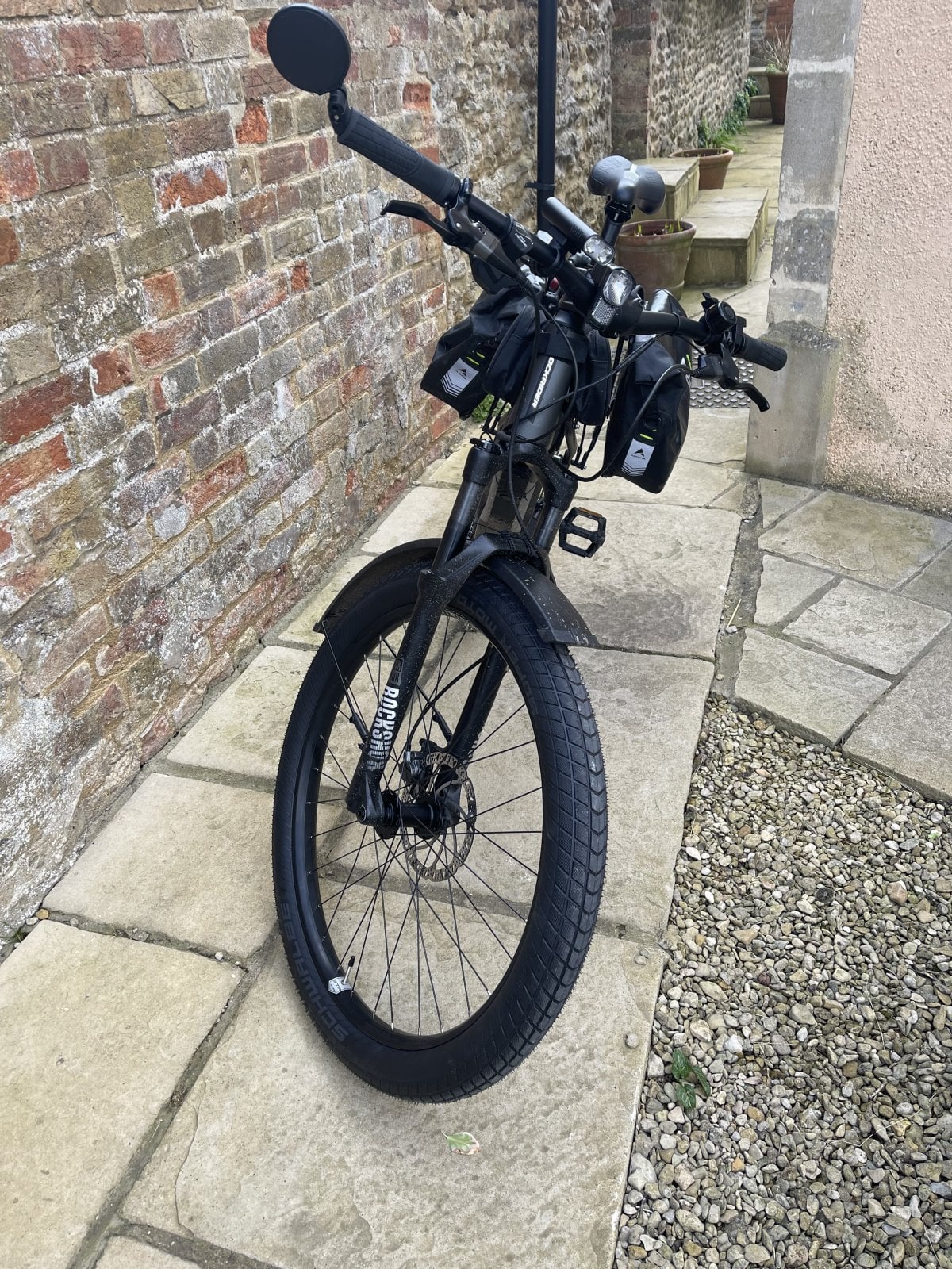

Very pleased with Rockrider E ST 900, have read around on here and used the advice. Wanted an “e-SUV” for up to maybe 20 miles local trips for
shopping, pub runs.etc in a hilly area, have a Nomad (analogue) tourer for when I want to beast myself. Changed chainring to RaceFace 38t, added pannier rack (and panniers I already had), SKS wide mudguards, bar end mirror (I think essential for narrow roads around me) and changed tyres to Schwalbe Super Moto-X. Plus lights and alarm. Best thing was that the tyre change to “road+“ tyres entirely got rid of the annoying metallic, obviously resonance driven, noise that came in at 20kmh+. Second best thing is that the panniers easily fit it a case of 18 cans of beer!!
The tyre pattern looks like the bike could fly along on tarmac without much effort
I might have a crack at a set of those (y)
Loving them, smooth and fast but great over the cracked and bumpy tarmac around here.
