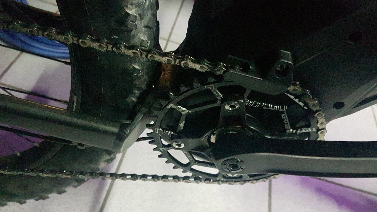

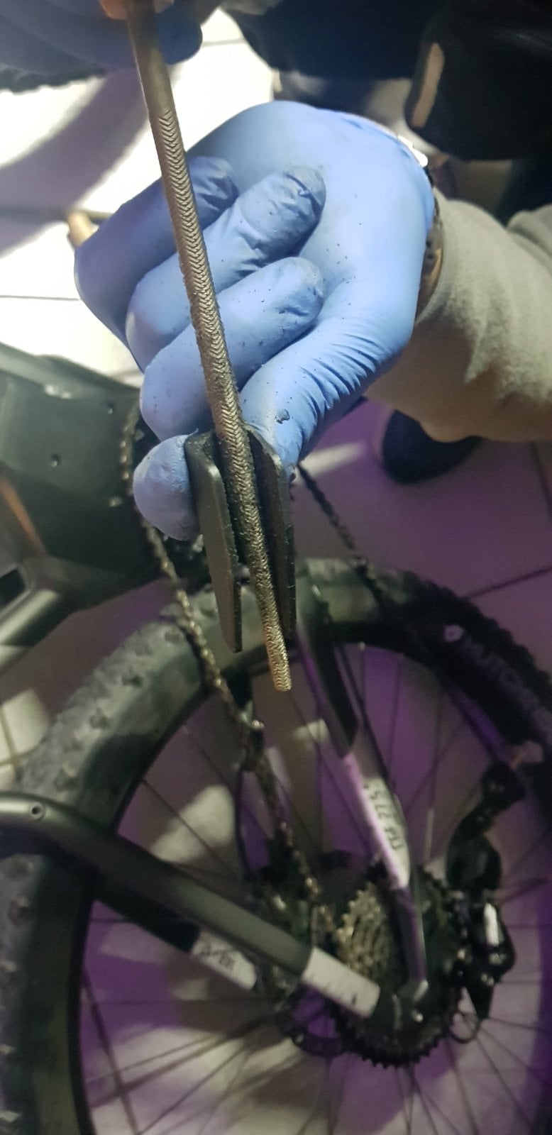

Ok, so I installed the 40t crank.
I had to grind the chain guide a bit to make it fit.
The gear changes are much more "violent" probably due to the more stretched stuff, I have to be more careful.
On plain road the highest gear is still not long/high enough for what I can pedal, but certainly much better than the 34t crank.
A pic with everything in place.

You don't need to unbolt the ring and crank.
With some positioning, puzzling and minor force the 34t chainring comes over, and off.
For those with less experience and precision: cut the useless 34t in half and throw it away.
The 38t, 40t, 42t chainring goes on or off very easy without disassembling anything, that's obvious.
If your 40t chainring doesn't give enough speed, you can only choose to:
1) put a 42t (big problem when you have chain suck)
2) replace the 11-t cassette with a 10-t (only with expensive microspline hub) (only when also converting to 11speed or 12speed)
A trick used by some is to shorten the pedal cranks.
This will of course not reduce your pedaling frequency (cadance) but it will reduce the pedaling path and rotational mass effect, which gives a similar effect to the cyclist.
Thanks for the tips, it was my first time doing this, it was not complicated, but I had to take my time. I did not even tried to fit the 40t crank that way since I had already had taken the spider off.

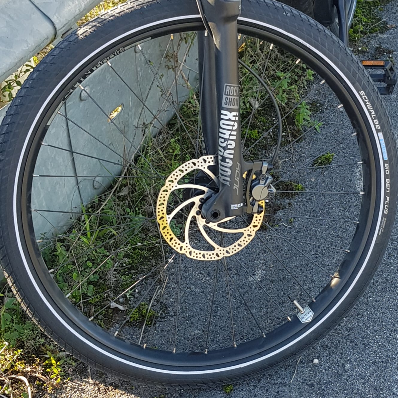

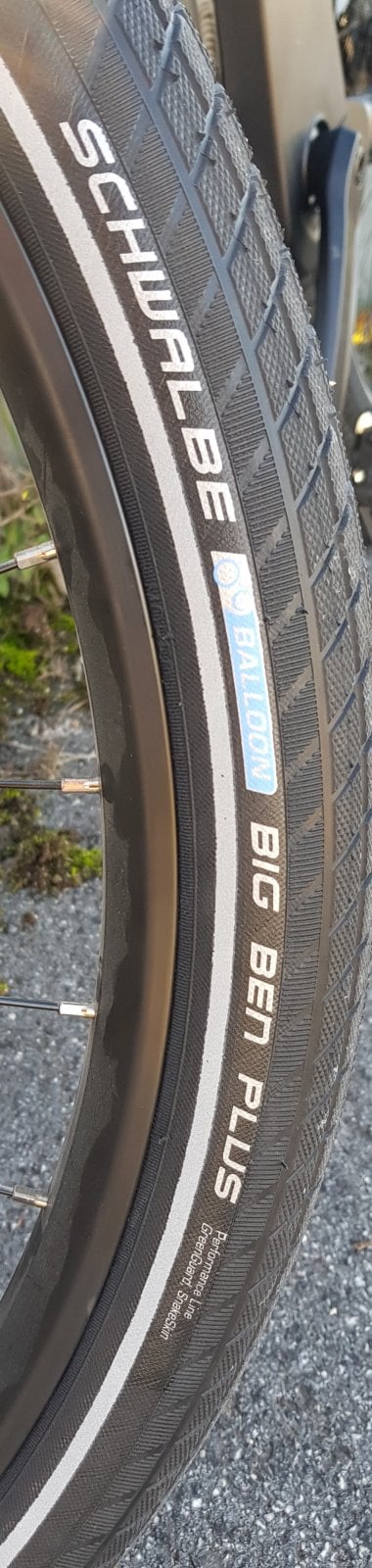

For anyone who cares, I just fitted a pair of these ( 27.5x2.00 ):
( edit: can't post links for some reason, anyway, search for schwalbe big ben 27.5x2.00 )
Much better for my needs and if you're like me and need something between an mtb and a road bike, I am happy and I hope it saves you some research time ( If not, well, nevermind ).

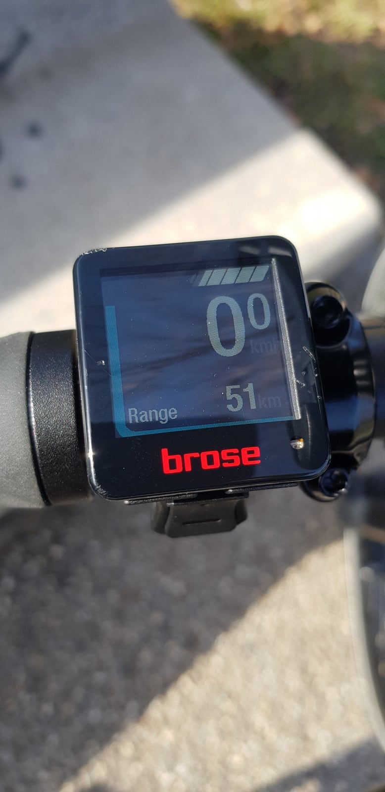

Ok, so after suspecting there was some sort of anti-hacking trick in the new units with the Brose controller ( like mine ), making the traditional magnet repositioning trick to stop working after a while, requiring a controller reboot ( apparently 500 revolutions? ), I went ahead and ordered a badass v4.
What I can report so far is that the controller does not shutdown with the badass v4 in place, BUT...
When I am going at about 37kph (gps speed) the controller measures 25km/h, making the speed restriction kick in.
No matter how I reposition the magnet provided with the badass v4, I cannot improve this.
Well, that's better than nothing, but they can't advertise it as a 100% effective solution.
I guess I am done with this "research" for now.
I hope one day eBikes don't come with autopilot too and other junk to take away the fun.
So it looks like your badass is a 1:1.5 pulse devider.
I suspect 1:2 would engage the alarm modus, so they limited the ratio.
With 37.5 or even 32 km/h I would be happy. Mine runs 45-50 km/h at the moment, nobody needs that.
