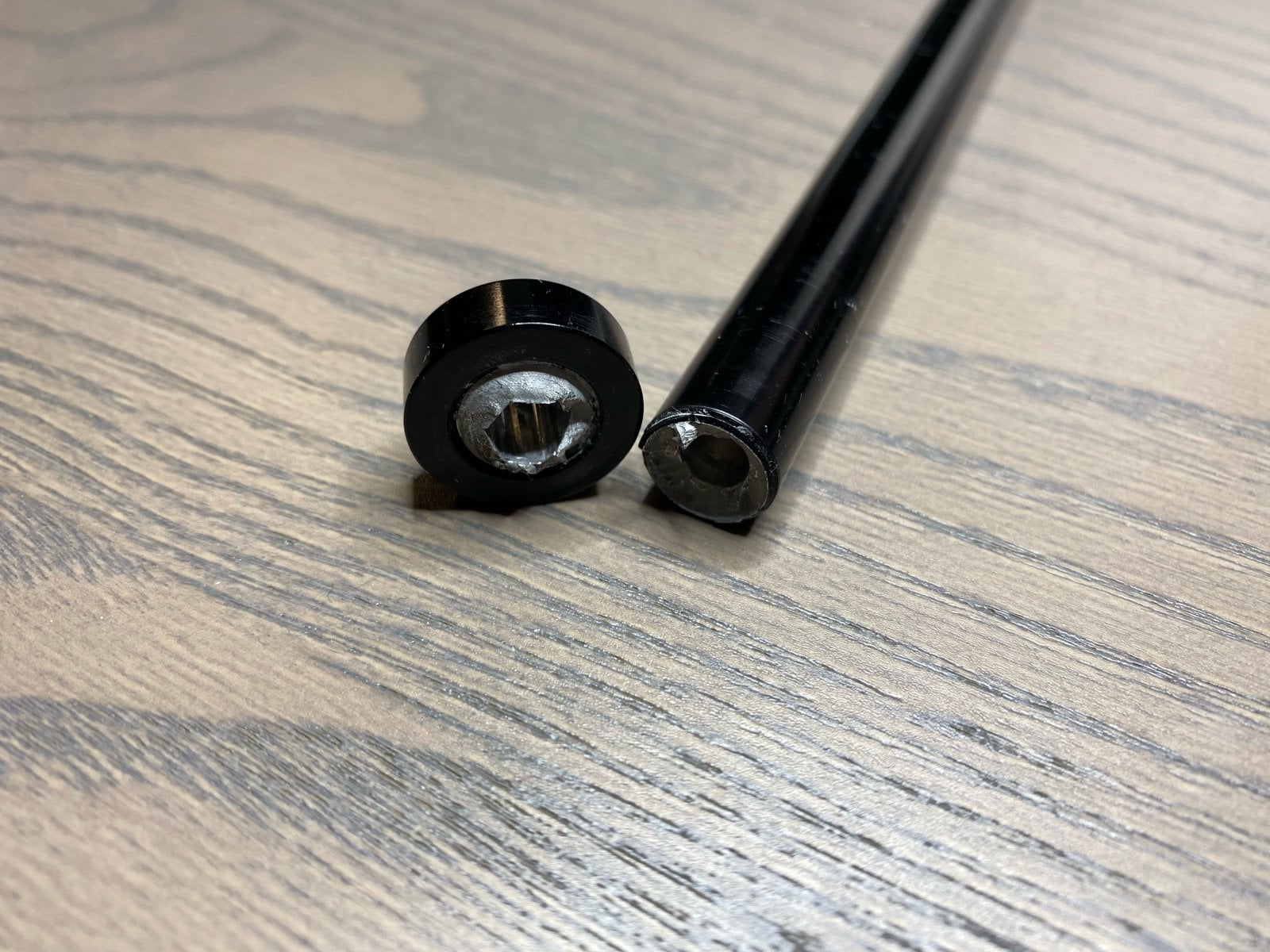

Hi! I bought an E-ST 900 in December but I just started using it because of the weather. Everything is fine, except I also have a noisy rear brake (when cornering at 20+ km/h). What is the correct way to fix? Is this just a simple brake setting (what I will learn on YT :D) ? Or should something be replaced in the store?
Just to add. Despite torquing up, mine still does it when cornering at speed! Let’s know how you get on?
So... mission failed:
I tried to tighten the axle with a Beta torque wrench two times (don’t ask why, I was just unsure). The second attempt was not tolerated by the axle screw. I think it's my fault, but be careful if you want to tighten it, this screw is very weak.
Now I'm going to search a qualty one. If there is any 12x148mm thru axle you would recommend, I would appreciate it.
Although Decathlon might suggest to tighten it up to 20Nm, it only states 10nm on the axle itself. When buying a new one, I would err on the side of caution and go with the recommended setting.
Link below shows a similar sized axle that will go to 13.5Nm :
