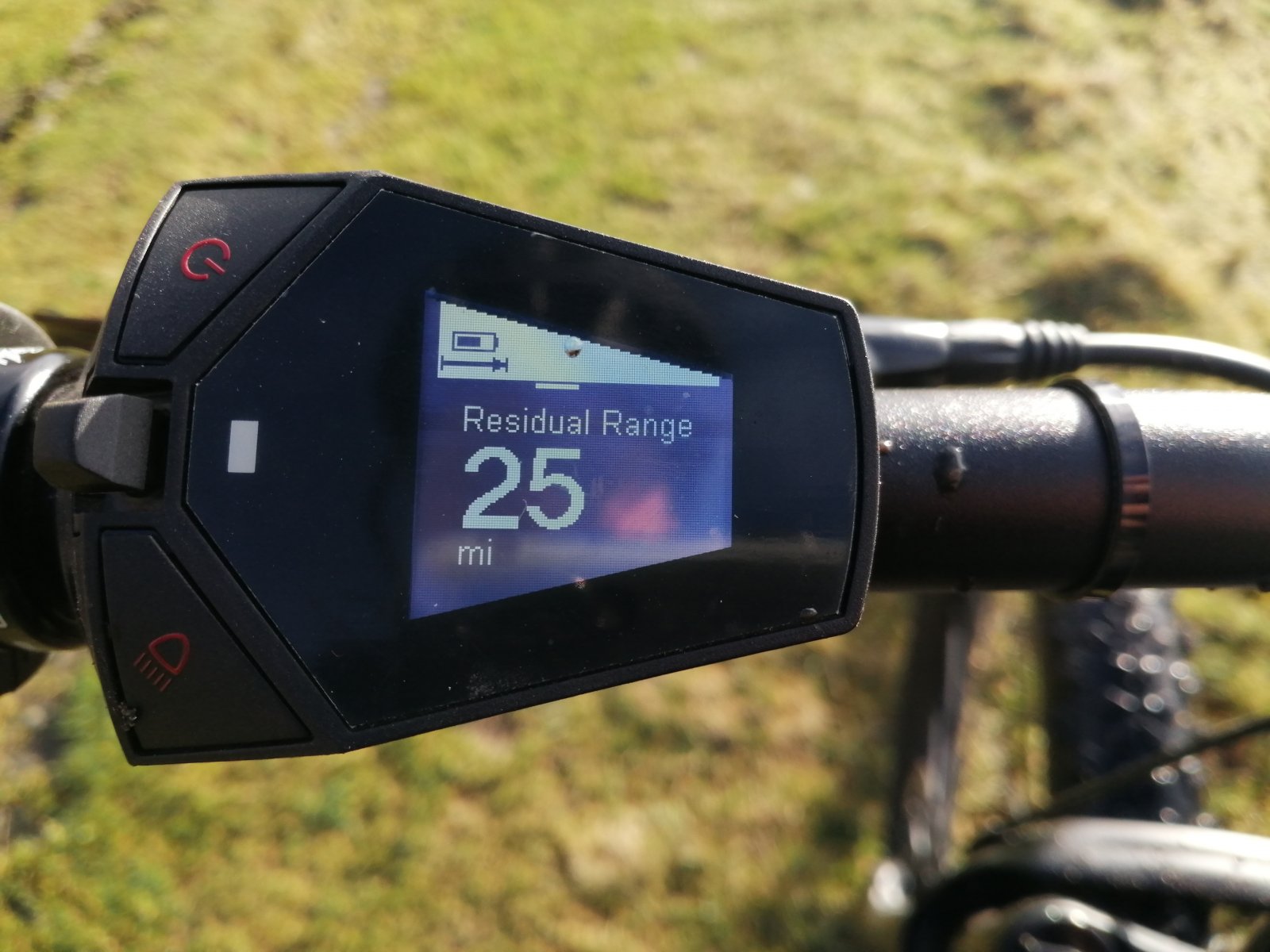

Anyone experienced issues with the residual range not updating while cycling? Does the range change when changing the power assistance level?.... please help!!... thanks
Oui, range updates , Also with mode Change.
Many hanks for letting me know. Mine must be faulty then. They changed the controller, but still no joy.
If you get the time, please could you let me know what residual ranges you see in the different power modes when the battery is fully charged?
It's going to be different from bike to bike due to historic data.
Oh, I didn't know that. Is there a reason why historic data is used? I just thought it would be a value based on battery charge and power mode (that's how my est520 was). Unfortunately my est900 gives me a residual range reading of 9miles when fully charged regardless of the power mode, although I can obviously travel further than 9miles.....would just be nice to know what yours says for the different modes so I've got some sort of benchmark.

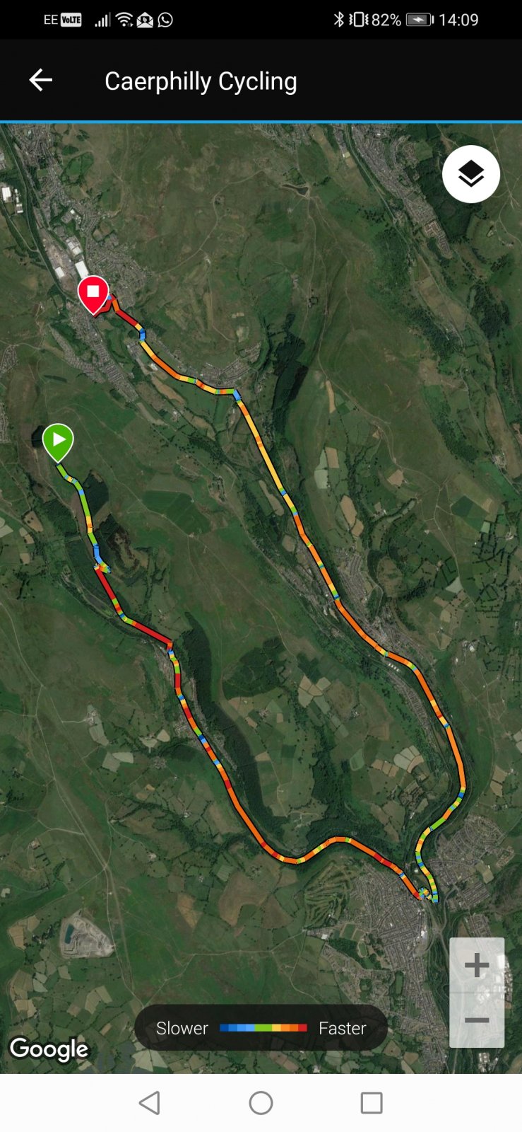

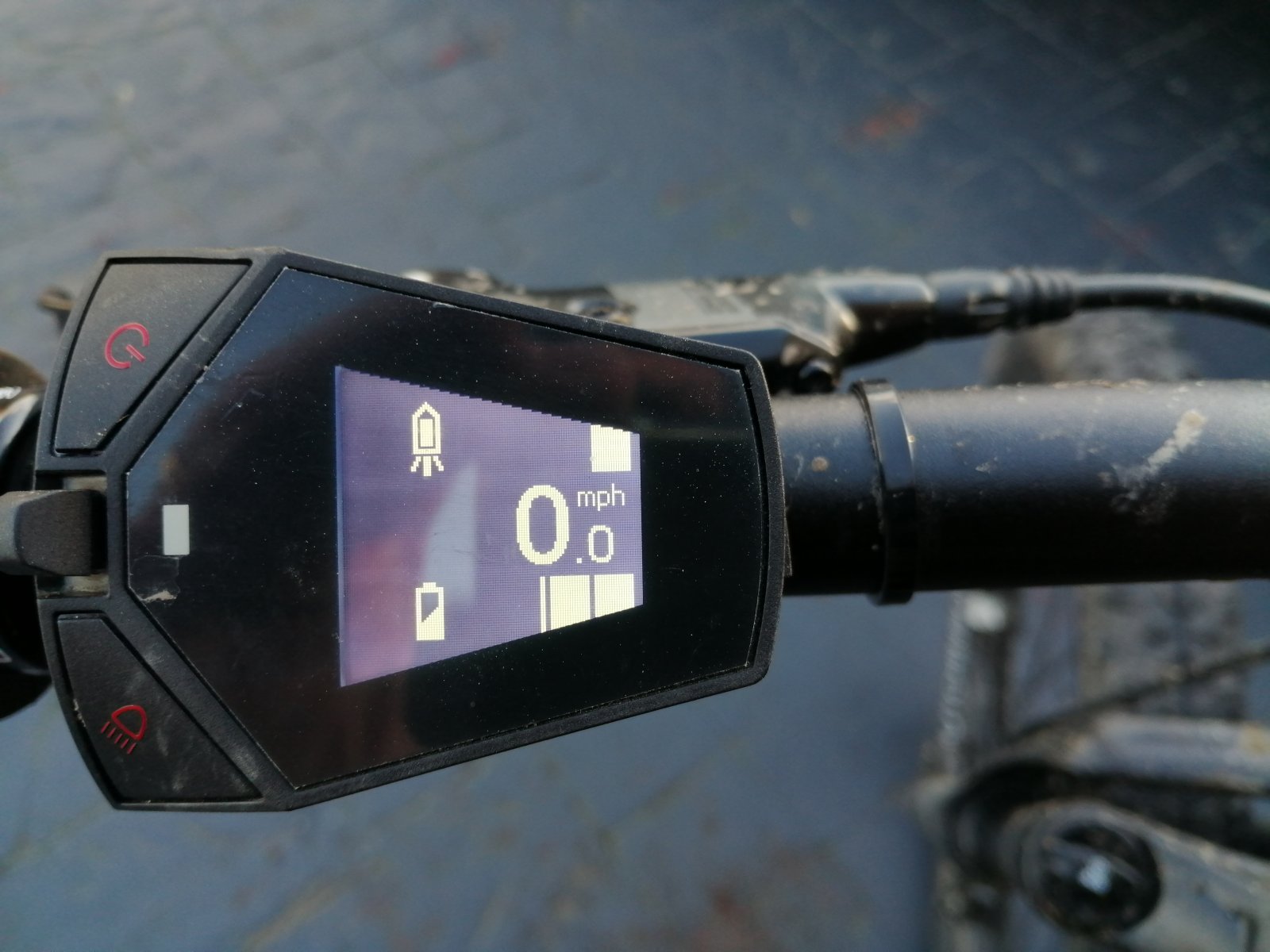

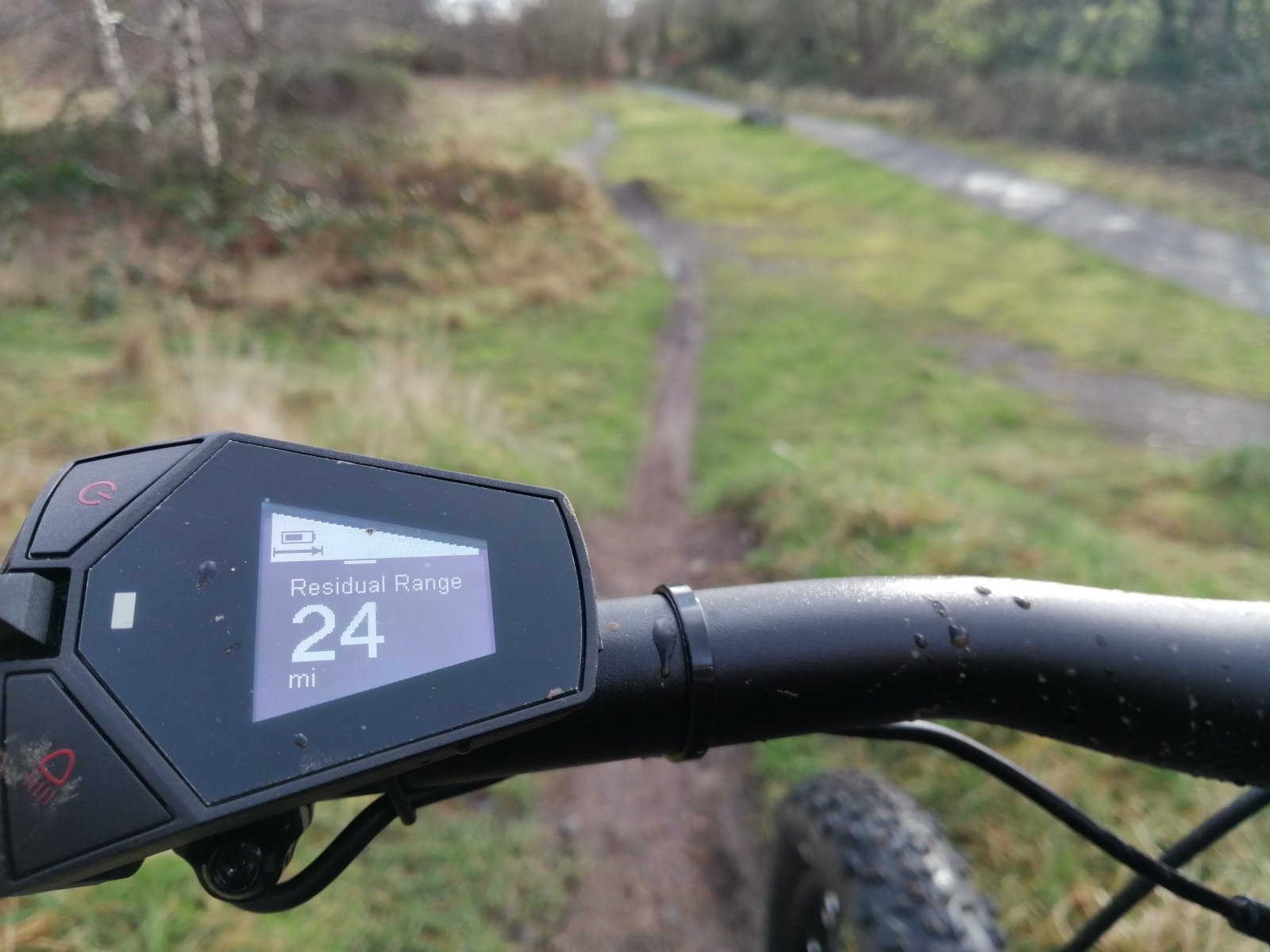

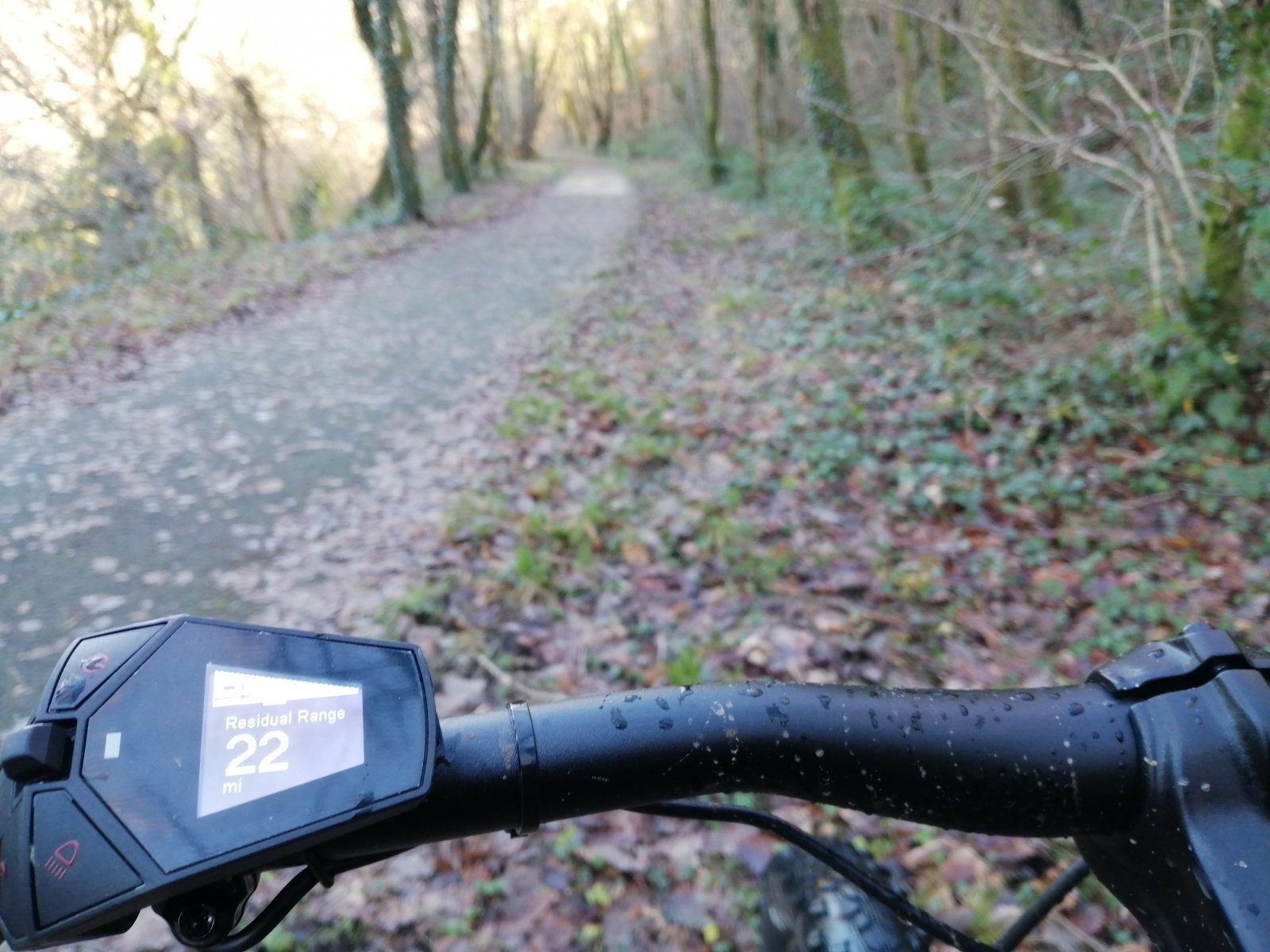

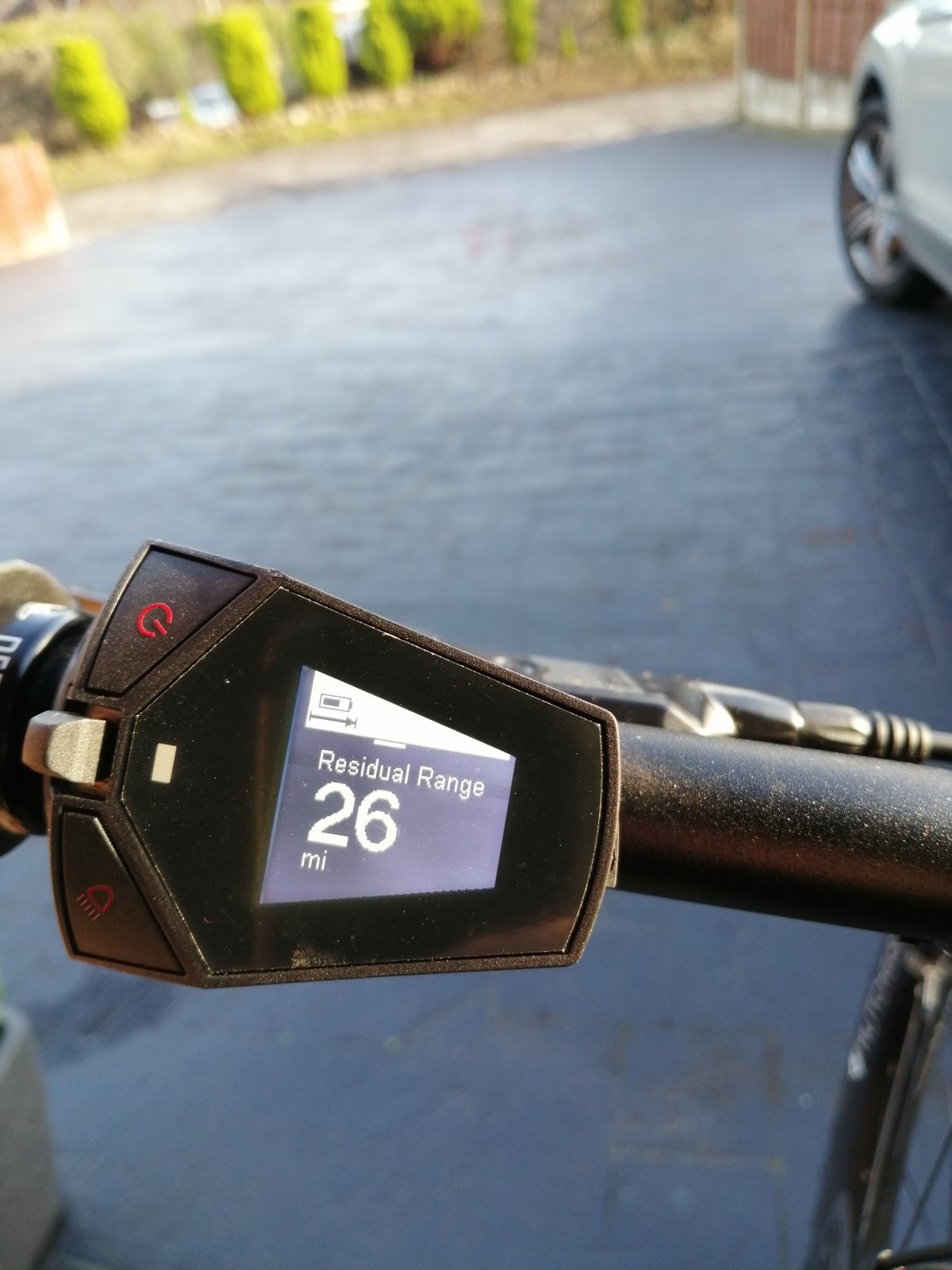

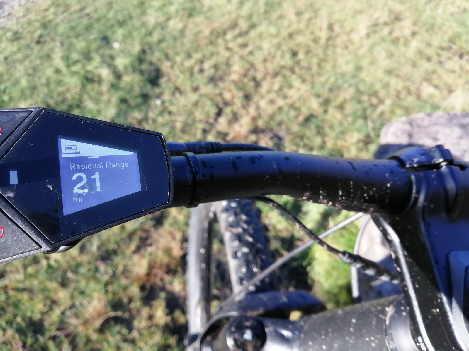

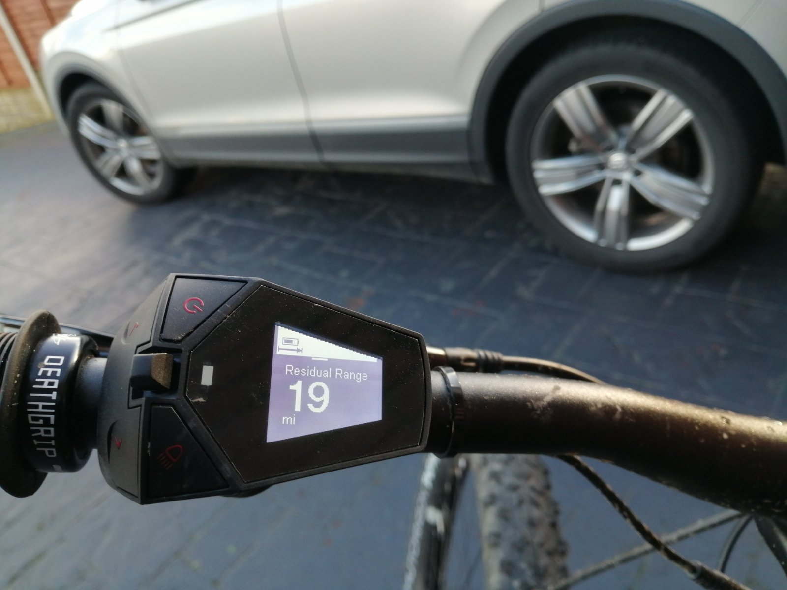

Went for a 12 mile ride today on a fully charged battery. 26 miles showing on residual at start. 19 miles showing on residual at finish, which was about 1hr 15 mins later. Residual range was definitely updating along the ride, as it was decreasing slowly every time I checked it. Just over 2 bars left at the end of the ride.

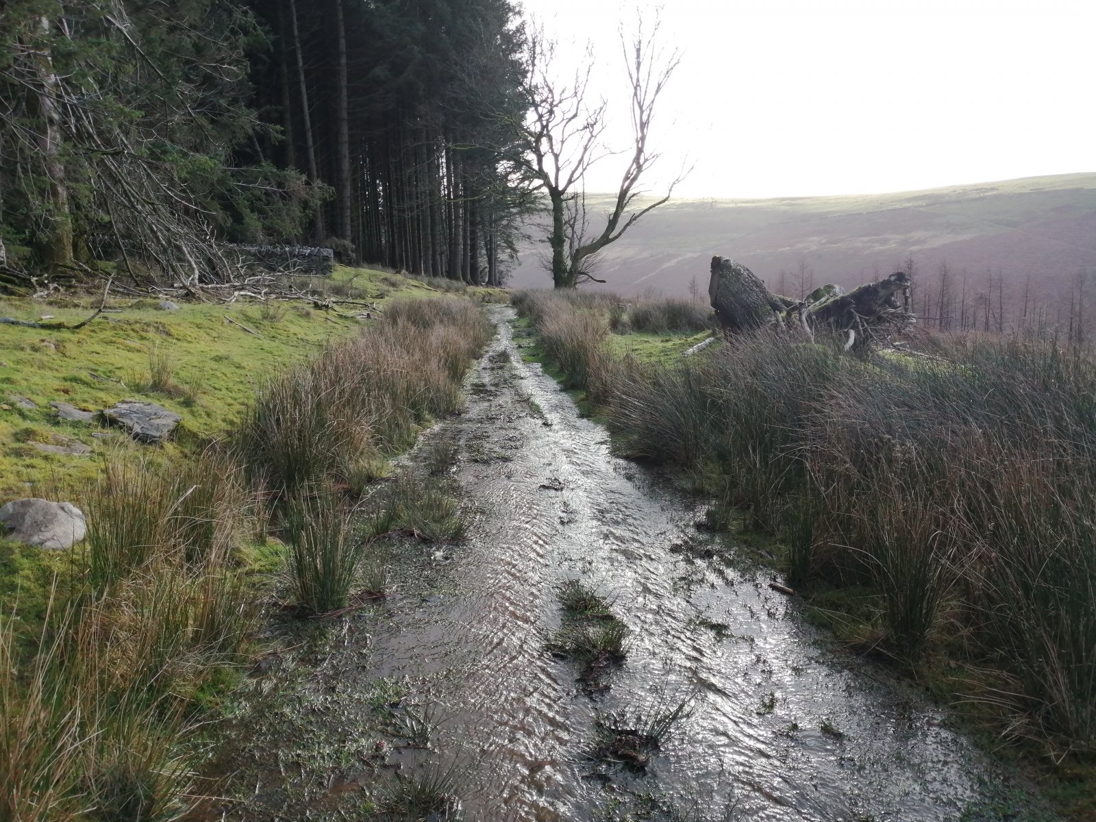

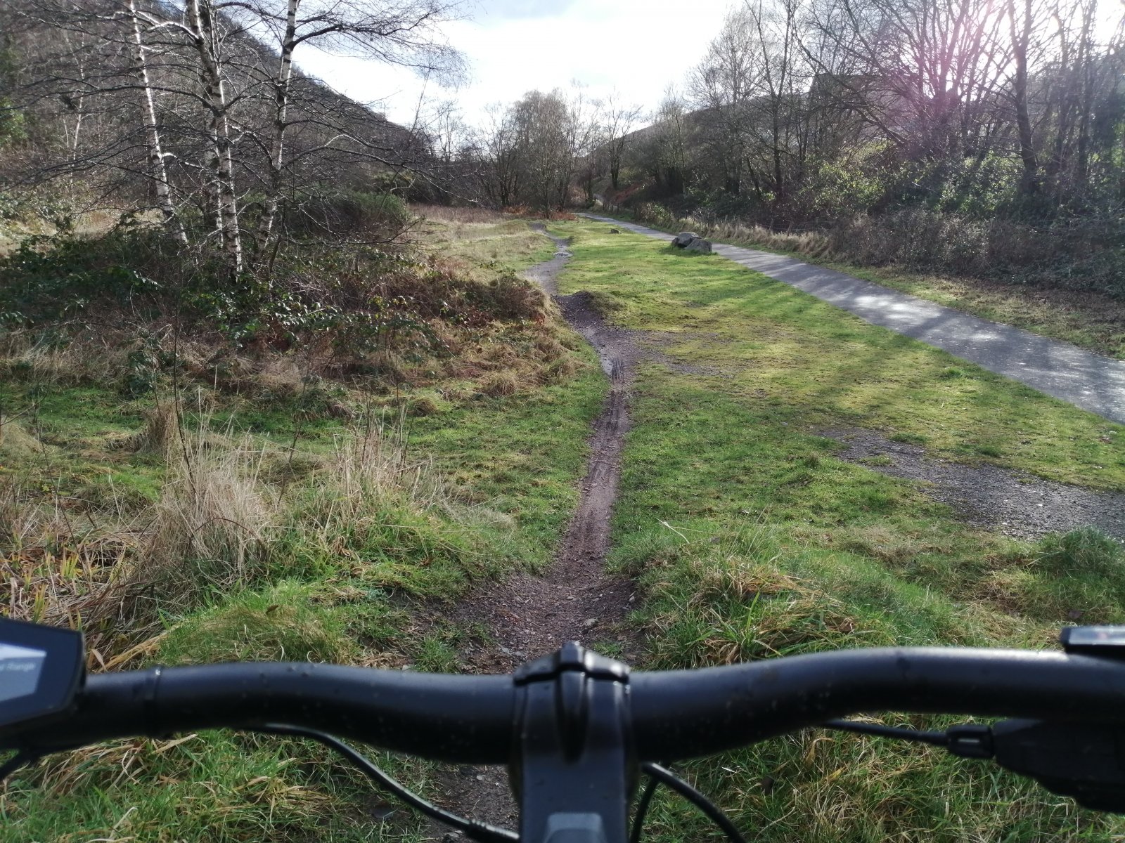

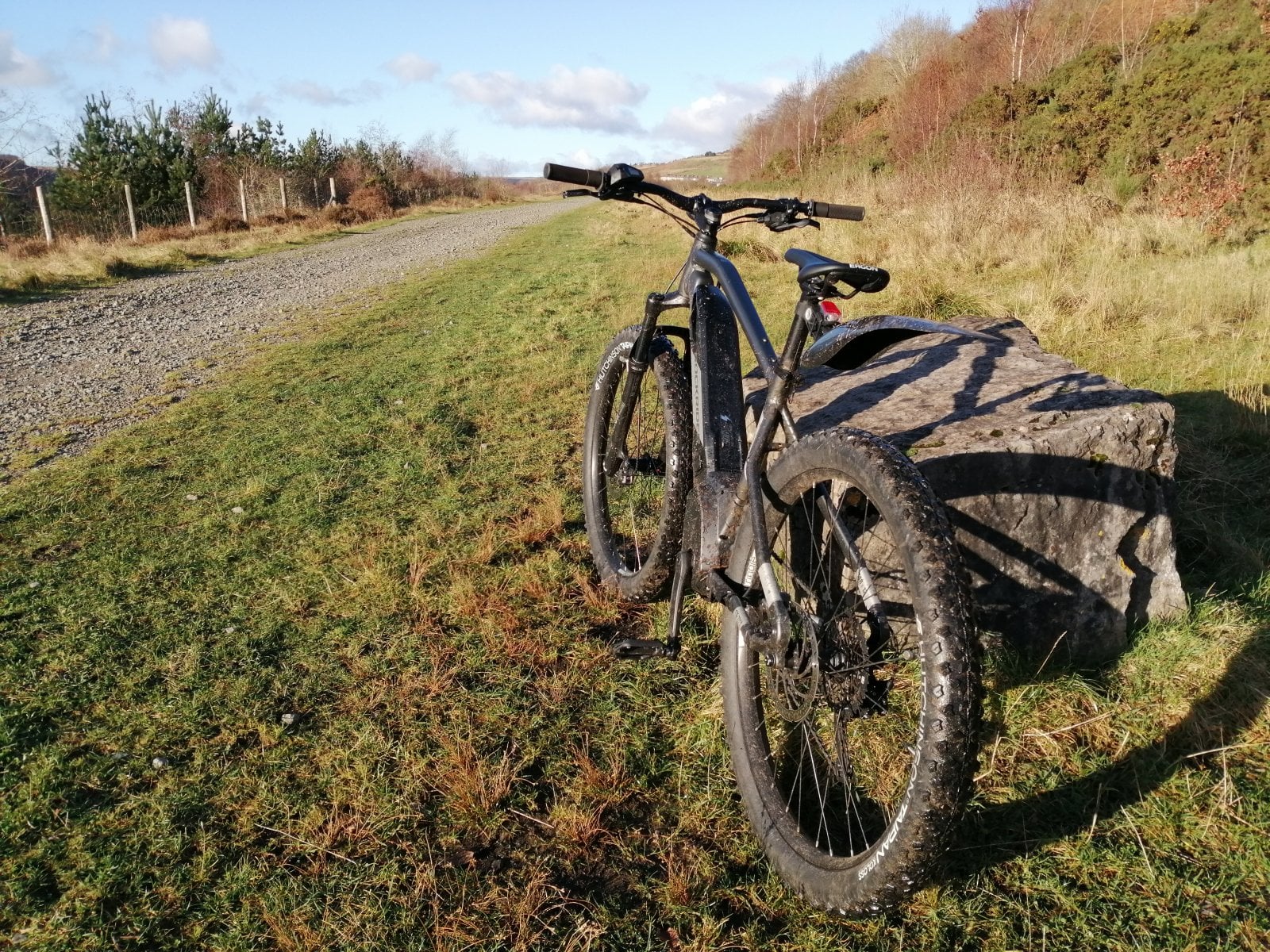

Pics show the type of terrain that I was riding and all four assist modes were being used when necessary, as some sections getting to the top of the valley are very steep. Hard steep hillclimb initially to forest, then downhill and mostly steady trail tracks after that.

So, residual reading does change and decrease while riding. Don't think I would really use this function again though, as I would just look at my battery bars on the home screen.

Regarding the residual range, please could you kindly check next time if when you change to a different power mode that the residual range changes to a higher/lower number automatically too?
For me it's strange that your bike showed only a 26 mile residual range at full charge....I would expect it to show more unless it refers to power mode 4.

I think though that the different power modes didn't affect the readings of the residual range, but I'll make sure to confirm.
I can probably do this same loop again without a re-charge, which will be interesting to see how much lower it goes.

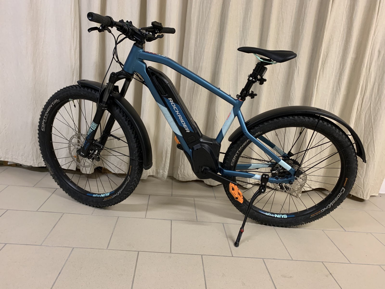

hi, est-900 friends.
let me suggest you this few changes to improve your ridings into the wet wild trails
vittoria e-agarro.
brakes xt
btwin flat pedals

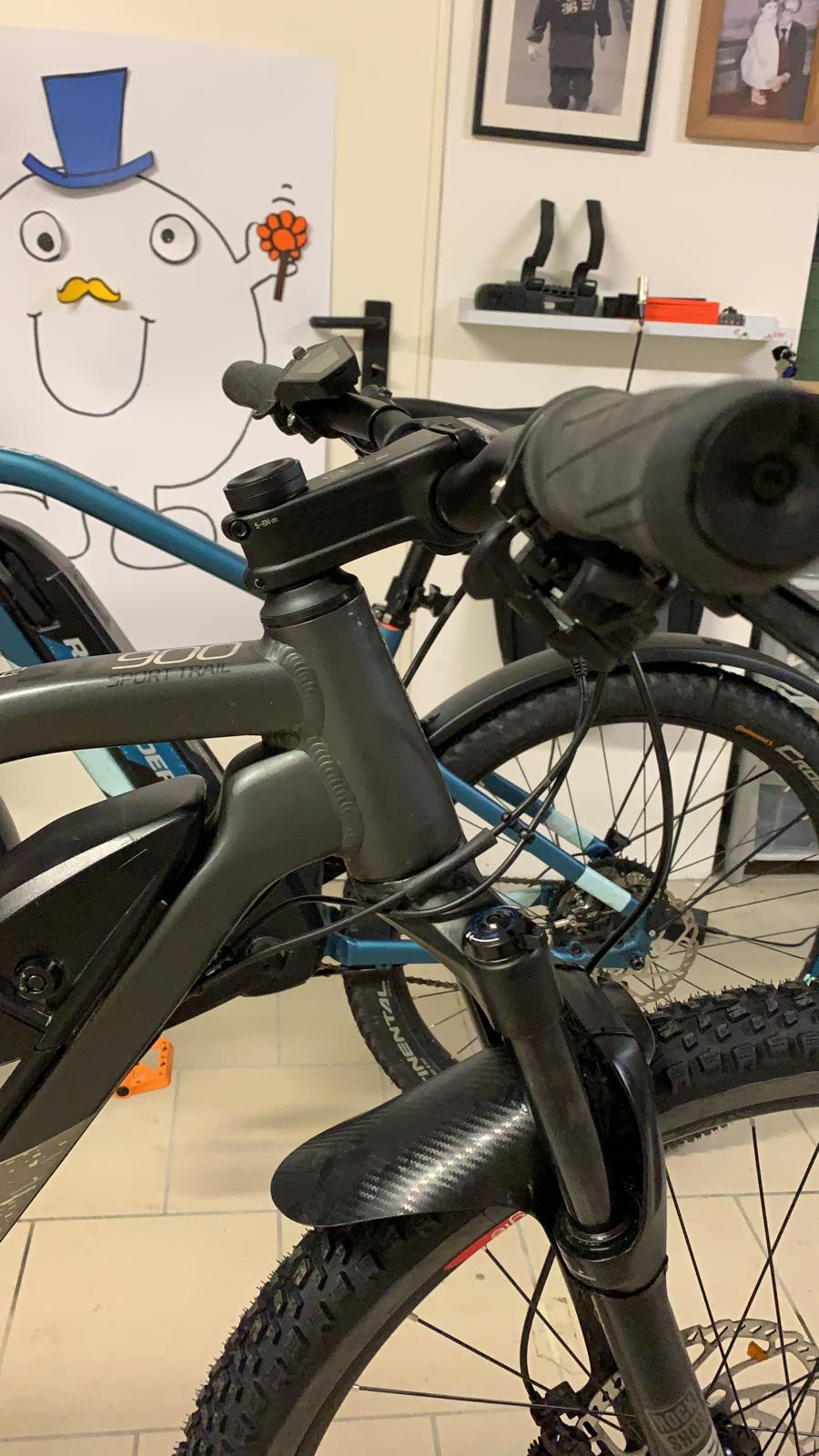

I’ve ordered a front 29” wheel. I will try to change it into a mullet
What are the advantages of this modification?
I've heard of bikes with 29" front wheels, but am not bike build savvy enough to know the reason why.
oh I will tell you..any way there are some reasons to do this mod and some reasons to leave it as it is.
you can read about mullet in every forum or bike magazine. at the end it's up to you decide to change something or not.
in my case after left the 27,5+ i've gained agility but lost ability riding downhill. so i will try this mod spending less than a new saddle.
vittoria e-agarro.
brakes xt
btwin flat pedals

returning to the mod I’ve came back to stem 60mm

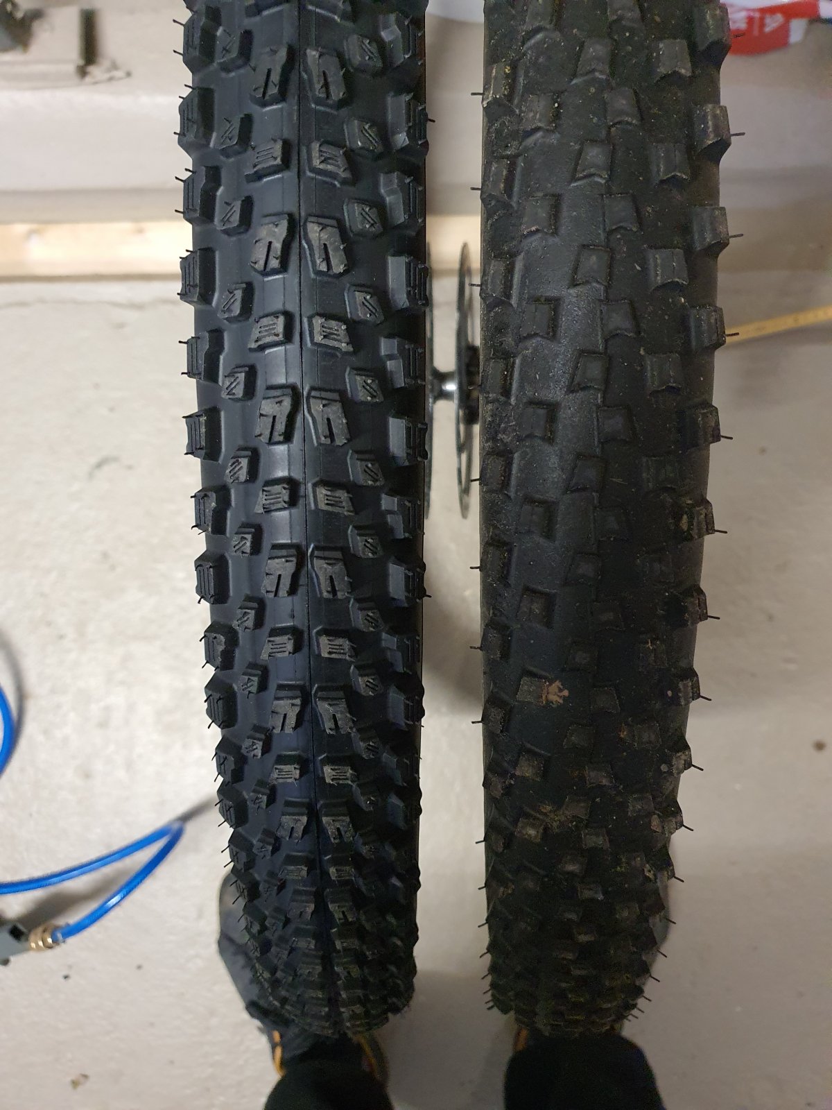

So i fitted my tires today. Its pretty weird that they allmost look the same on width.
Old tire is 2.3 vs 2.6 on the new one
When i change from old nobby nic 2.60 to continental 2.3 the difference was huge
