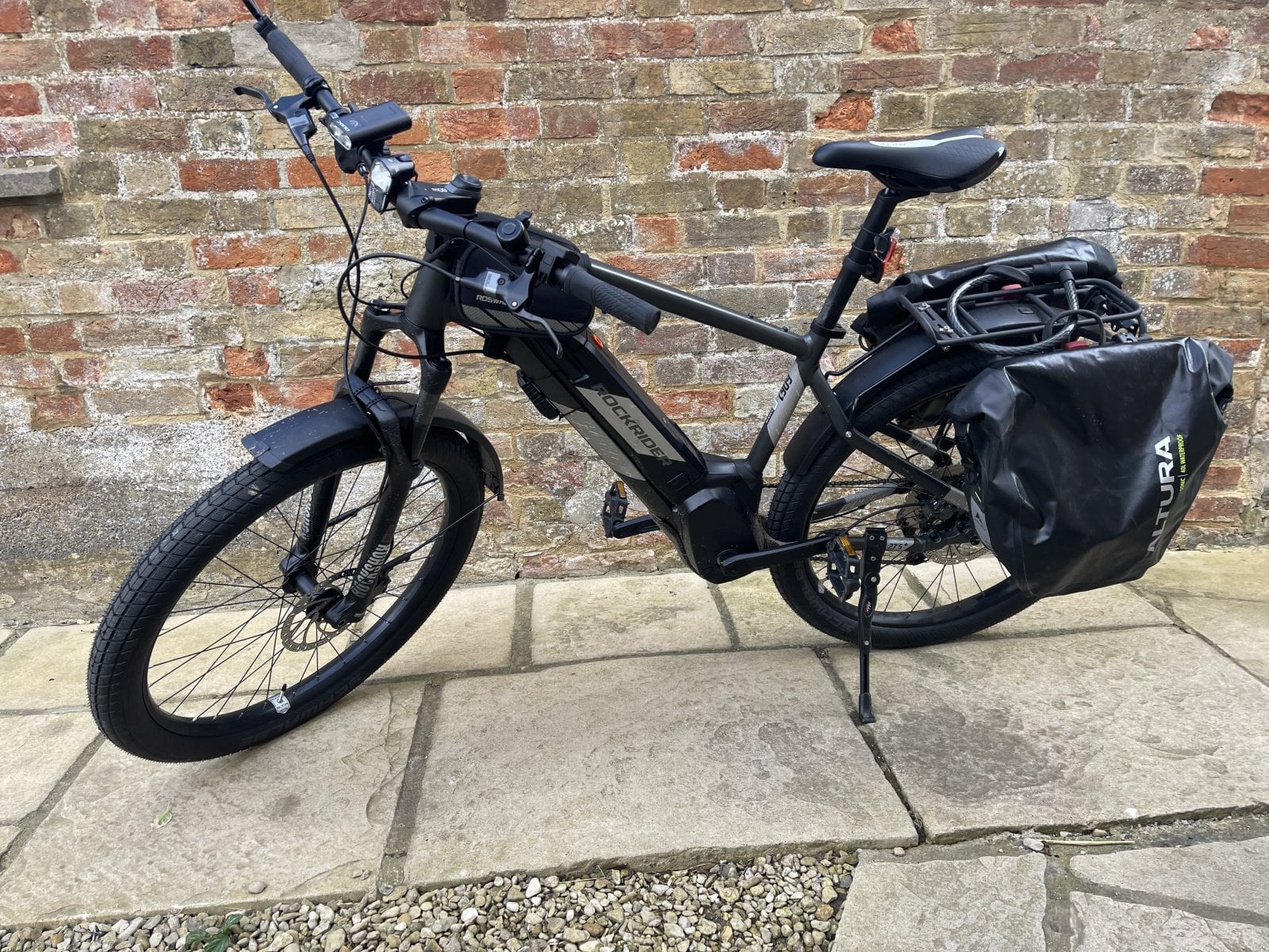

Very pleased with Rockrider E ST 900, have read around on here and used the advice. Wanted an “e-SUV” for up to maybe 20 miles local trips for
shopping, pub runs.etc in a hilly area, have a Nomad (analogue) tourer for when I want to beast myself. Changed chainring to RaceFace 38t, added pannier rack (and panniers I already had), SKS wide mudguards, bar end mirror (I think essential for narrow roads around me) and changed tyres to Schwalbe Super Moto-X. Plus lights and alarm. Best thing was that the tyre change to “road+“ tyres entirely got rid of the annoying metallic, obviously resonance driven, noise that came in at 20kmh+. Second best thing is that the panniers easily fit it a case of 18 cans of beer!!

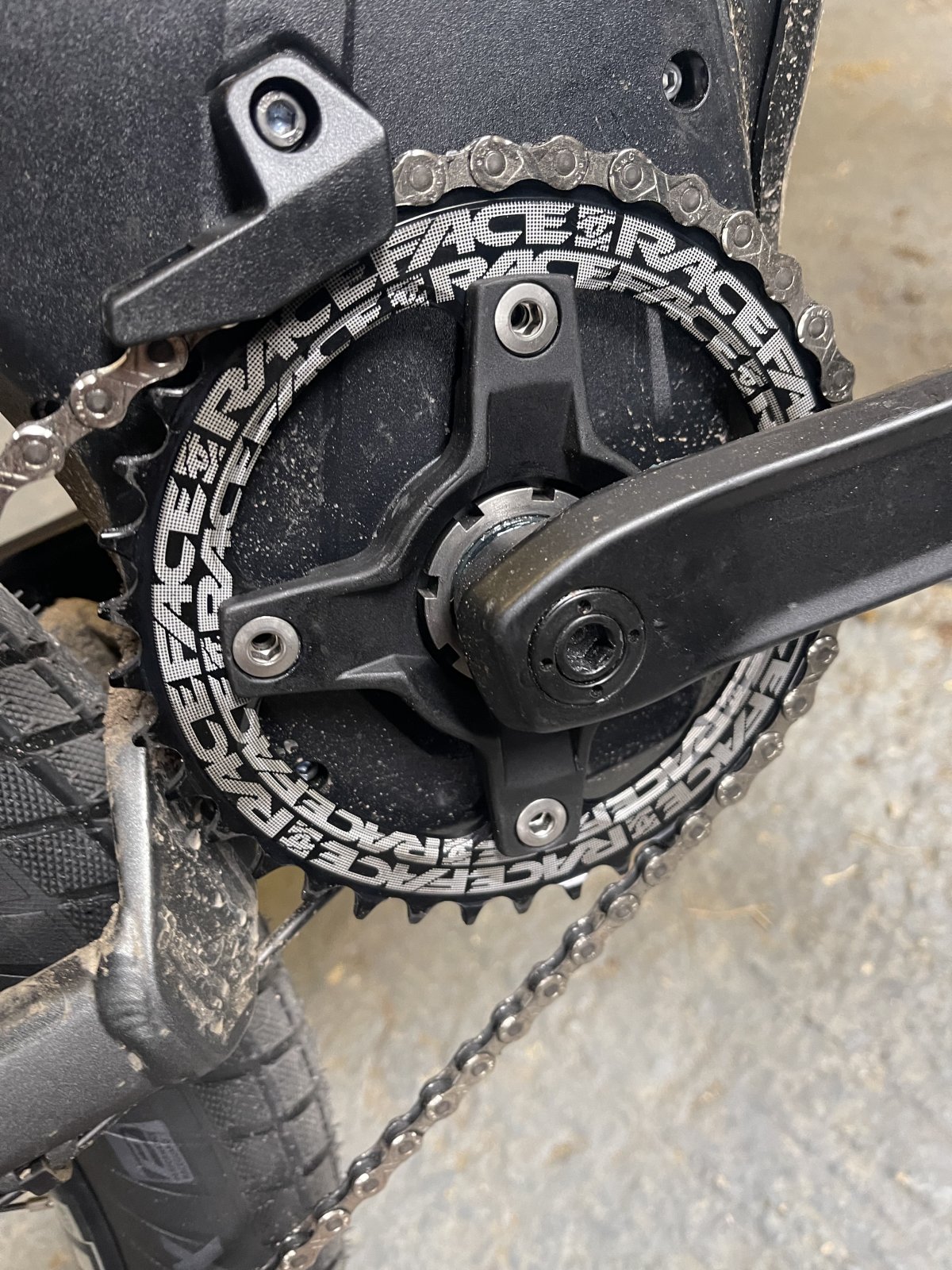

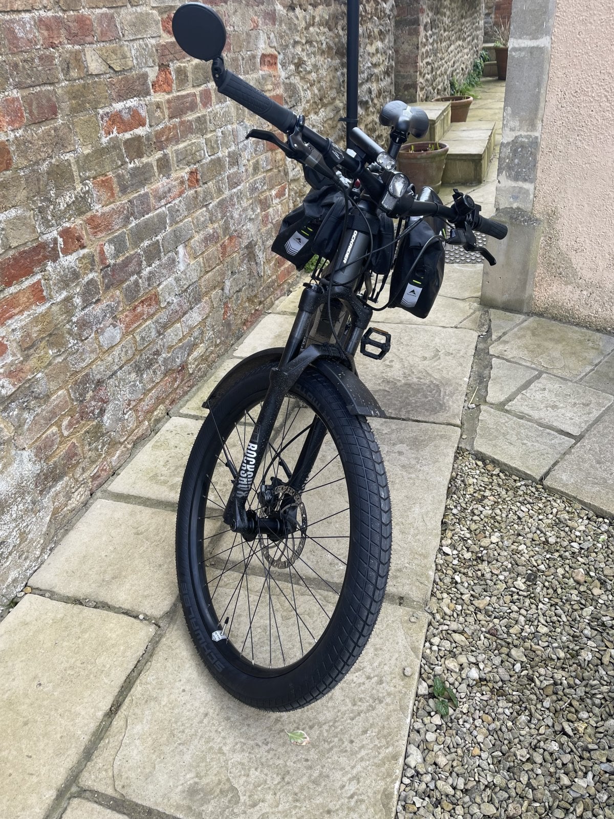

Added raised bar (no higher than original but flat not angled grips), 90mm 45 degree angled stem, and Ergon MP3 grips, (have MP5’s on my Thorn Nomad tourer). That’s me done for now - not now an MTB but really loving it as tourer/cargo bike and fun for a fitness ride if the bumpy bits are too steep. Can’t fault the E-ST 900 after first 300km….love the motor, almost silent and no “sharp cut off”.
Looks great. I am just about to purchase mine with the intent of making it a base bike for a tourer/light offroader - any suggestions on sizing?

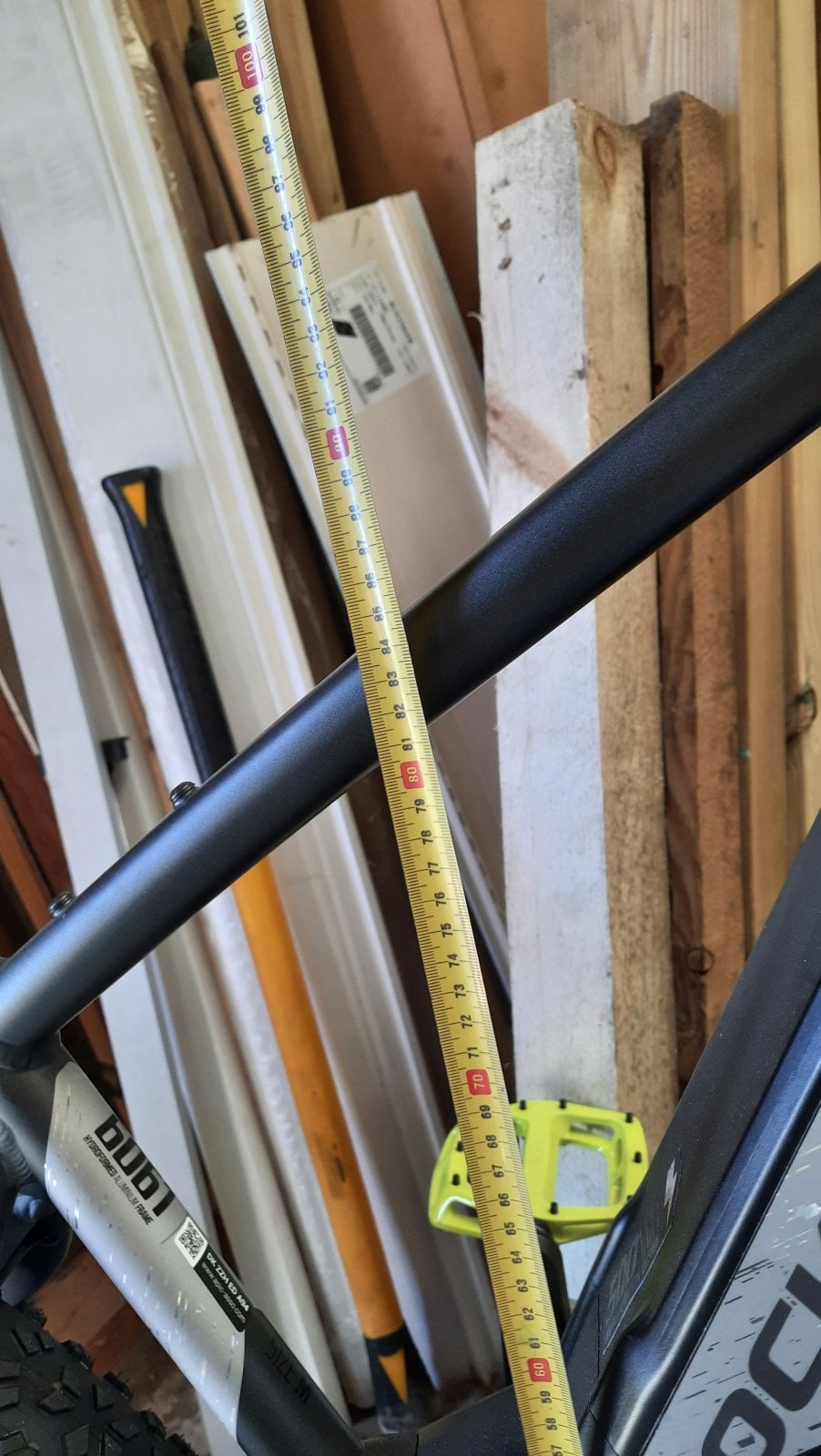

Actually, does anyone happen to know what the realistic standover height on the medium or small is?
I'm still quite confused by the sizing numbers on the decathlon website! The reach seems quite small for such a big bike, is the cockpit a bit cramped on these, or is it just a bit more of an upright seating position?
Here's a pic of the height on my medium

Thanks all. I've ordered the small after comparing geometry with lots of other bikes (and that standover is just to high on the medium!). Can't wait for it to arrive now :)

  • It's brilliant at hauling loads, I added a set of panniers - using the rack "ELOPS BIKE PANNIER RACK 500 26-28 DISC". I did need to bend/twist some of the fittings in a vice to make them fit nicely on the frame
  • Rear frame seems a little short, I have to make sure the panniers are slid back as far as possible on the rack to stop shoe strikes.
  • I've hauled all sorts of stuff from ratchet sets to powertools on my commute in the panniers, and not noticed the weight at all on the journey.
