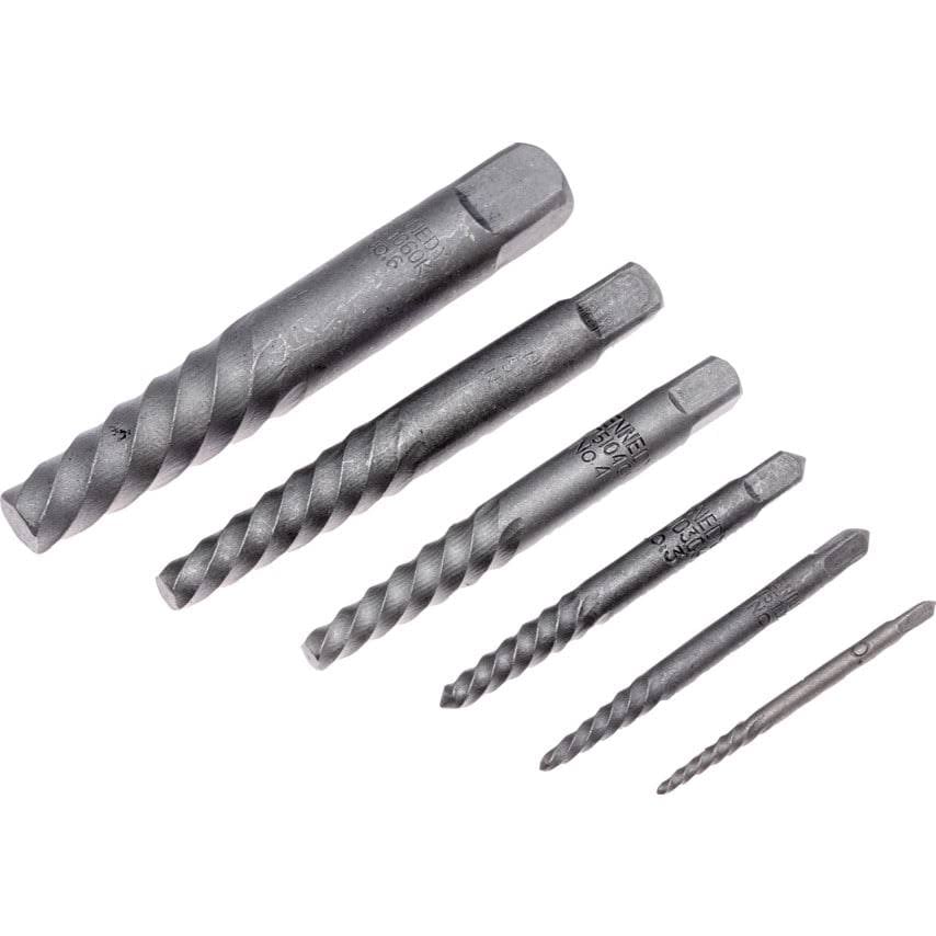

attempted the hack this afternoon. Epic fail. Used a T20 torx screwdriver to remove the torx screw that holds in the sensor but it was driven in so tight I’ve damaged the screw when trying to unscrew it, and no way is it coming out now. In such an awkward, recessed spot too.
Damn!
Any ideas of a remedy? Take it to a bike shop and get a specialist to remove it?
If you cant hammer in a larger torx or allen key, then a screw extractor is needed.

So, I managed to get the Torx screw out slightly, enough to allow me to slip a junior hacksaw in between the sensor and the frame and cut the screw off. Unless I can drill what remains of the screw out, then the sensor is never going back to its original location - unless I cable tie it, I guess?

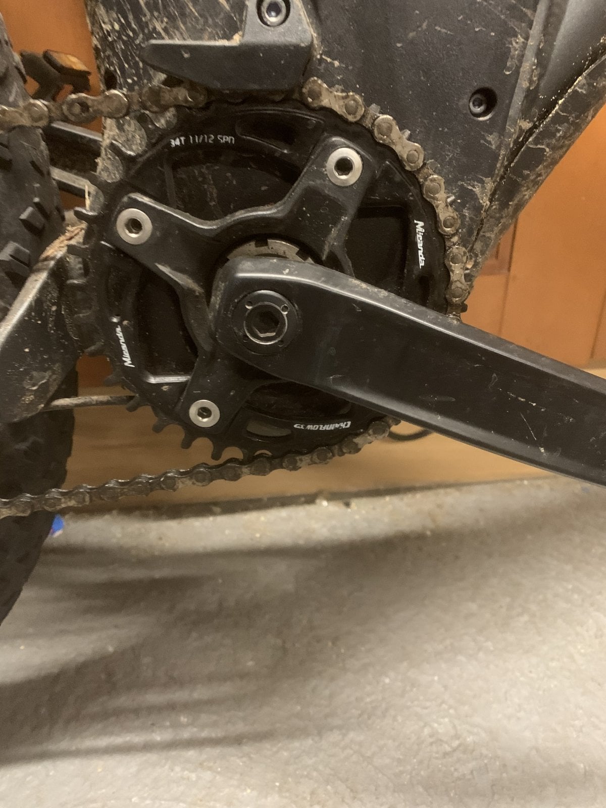

So, the sensor is in its new location and WOW, what a difference. But, the gearing is clearly not correct for the increased speed. Is there a gear upgrade that takes care of that, that anybody has done?
That’s ideal but, try a cheap 38T from the likes of AliExpress first. Worth a try for the sake of about a fiver!
In regards to swapping out the chainring, is it just a case of unbolting the pedal, then the 4 x Allen screws, then it’s just a straight swap? Does the chain need adjusting or is the diameter of the old and new chainrings exactly the same?

@BeBiker goes for the brute force option to remove the original chainring 🤣
I bought the proper tool, a SuperB TB1069, and did it properly! 😉
I wouldn't call some taps with a wood piece brute force :)
But If I could start over, I would just cut the small 34t in 2x17t, it's useless anyway.
The 38+ fit over everything without touching anything.

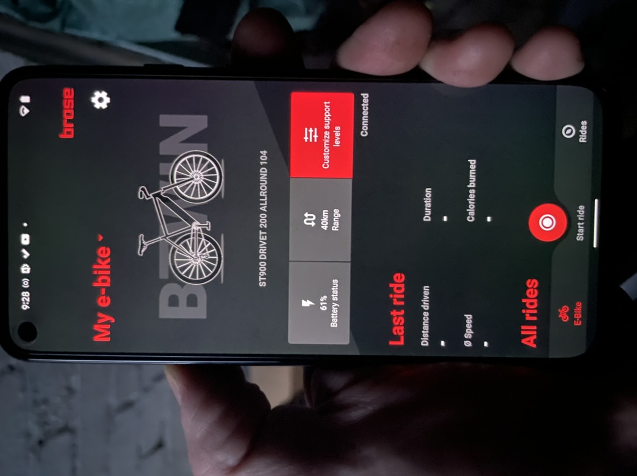

Not sure if anyone else has already done this, but the Brose app does connect to this bike. Problem is the app isn’t on the UK iOS or google store so I had to google for it and put onto an old android phone.
Can you update the firmware?

Can’t see a firmware update option but I wouldn’t want to as it works fine and might stop my derestricter working.

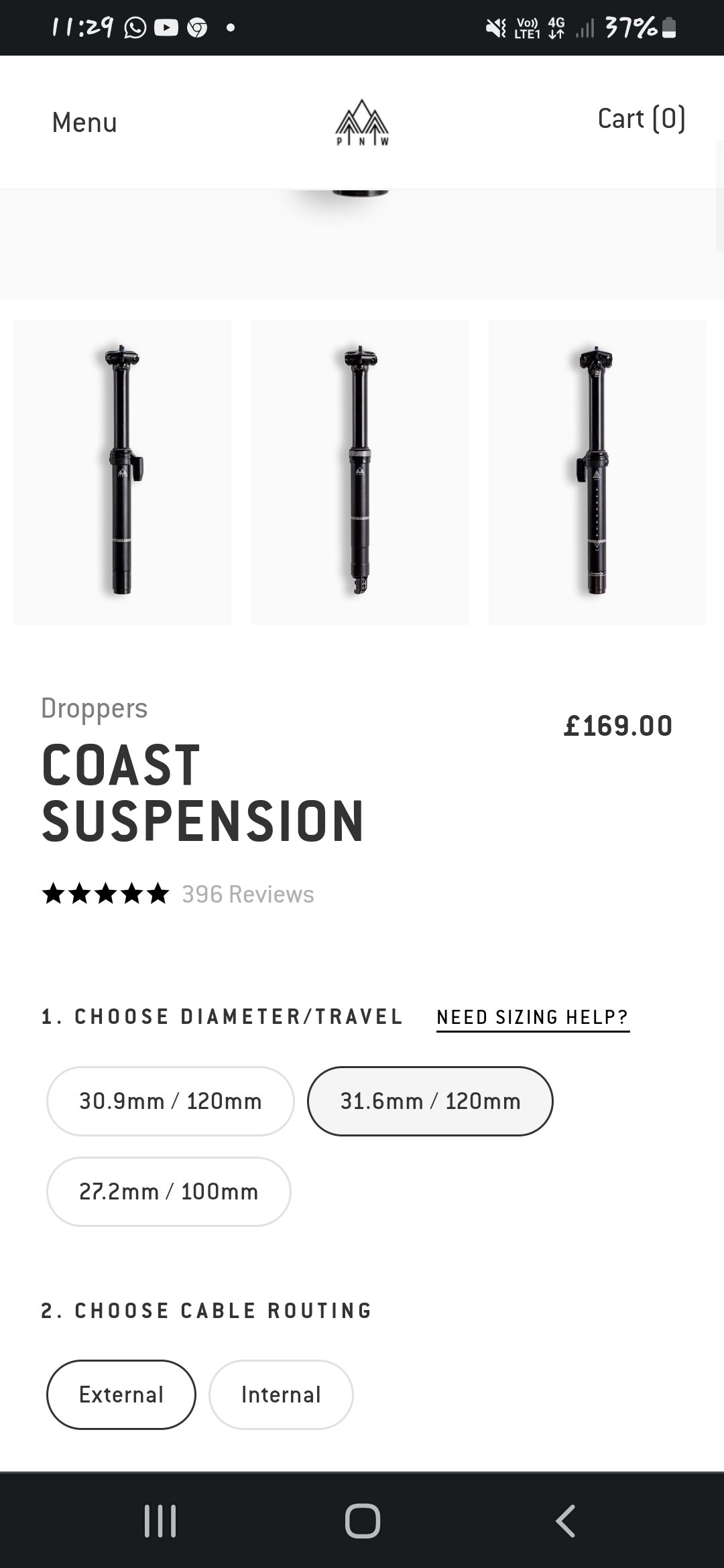

anyone installed a dropper seatpost? looking to get one, but no idea where to start
