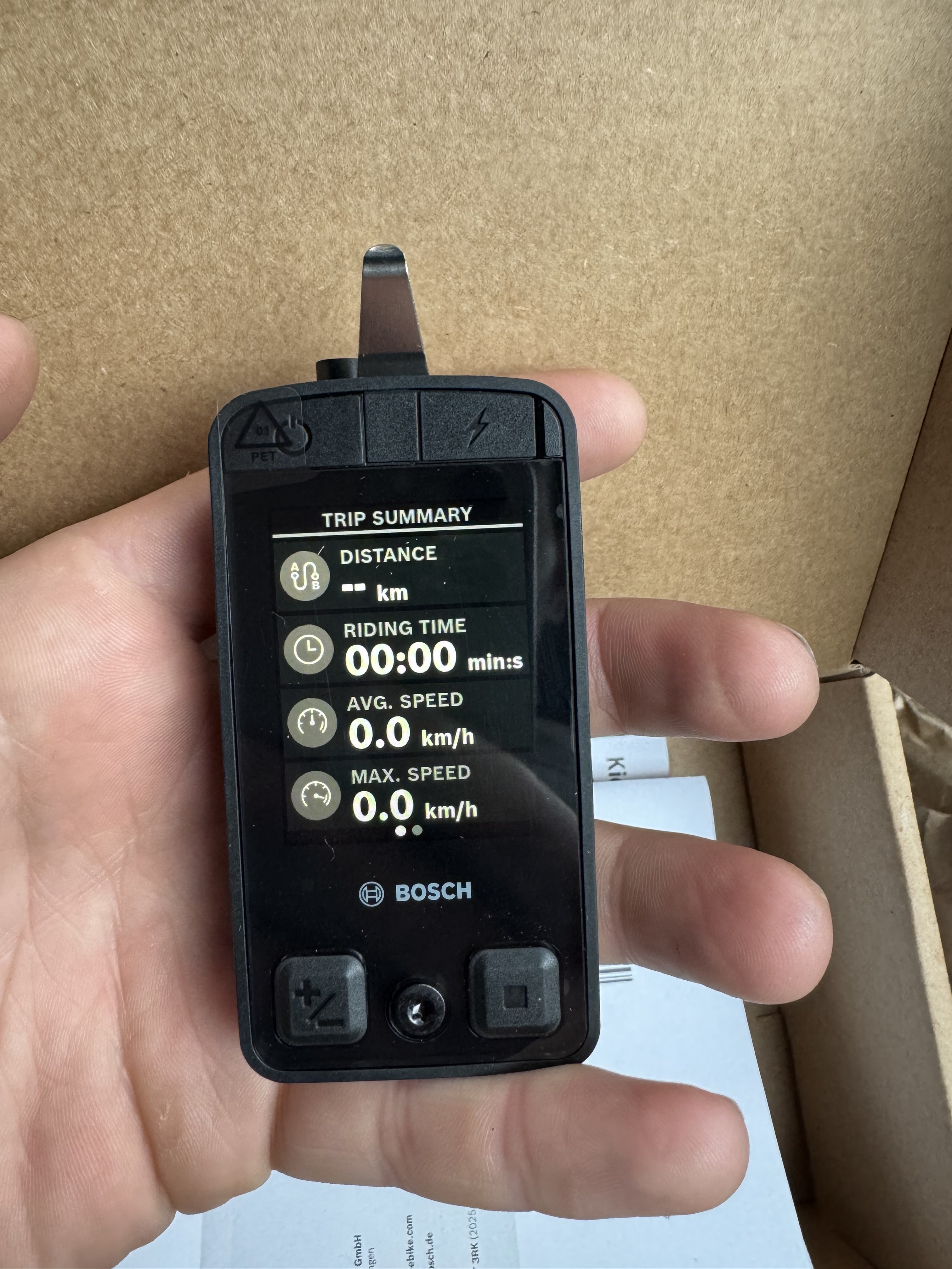

I have a Cube Stereo Hybrid ONE44 HPC with the System Controller and the Purion 400.
What do I need to install the Kiox 400 C?
I know I need the display adapter.
What about the cables? Is it just a case of removing the System Controller, connecting the Kiox 400C, and it will work ?
Do I need to remove the Purion 400 ?
Do I need to change the cables ?
Please explain in simple terms, with the steps and the parts to be changed.

I swapped my Purion for the Kiox not long ago, it’s pretty straightforward.
Remove the system controller from the top tube.
Disconnect the Purion and remove the unit from the bars.
Push the Purion cable through the headset bung (you may need to lift the stem and spacers up to give easier access to this) and simply coil the cable up. I then inserted the cable into a small plastic bag and zip tied it closed to prevent and moisture ingress on the plug end.
Fit the new Kiox on the top tube.
Then on the Flow app remove the Purion from the component list.
Turn on the Kiox and add that to your component list.
This is where it gets/can be a bit tricky. Pair the mini remote with the Kiox (there’s vids online of how you do this, as I can’t remember, sorry).
If the Kiox doesn’t operate once it is paired, then the easiest method I found was to remove the bike from the Flow app and then set up as a new bike. I had to re-install the updates once I’d done this though. Your bike mileage will be unaffected, as it will transfer over to the new Kiox.
Sorry the last bit is a bit of a faff, but that’s what I had to do to get mine to operate.
If you’re in UK and near the Nottingham store for these guys The Electric Bike Shop, they had loads of them in stock in the store a few weeks ago. The shop manager said he got loads in when the Kiox 400c was announced, as he knew lots of people would want to upgrade. If you do struggle to source one, I do have a spare one in my garage now as I had ordered one online the day I smashed up my Purion 400 in a crash and it hadn’t arrived by the next Saturday when I wanted to fit the Kiox 400c that had arrived (hence re-looking online and then finding the shop 20 minutes away from me had them in stock in store - doh!)
For everything else, just follow Eyuplad’s instructions above. What I’m not so clear on is if you can simply keep the Purion 400 plugged in as well as adding the Kiox 400c. Suspect the best thing would be to remove all of the components from you bike in the flow app before starting (less motor and battery, that from memory I don’t think you can remove) then re-add them in the order: Kiox 400c, then mini remote, then the Purion 400. I may be completely wrong, so best watch the video on this exact subject here
