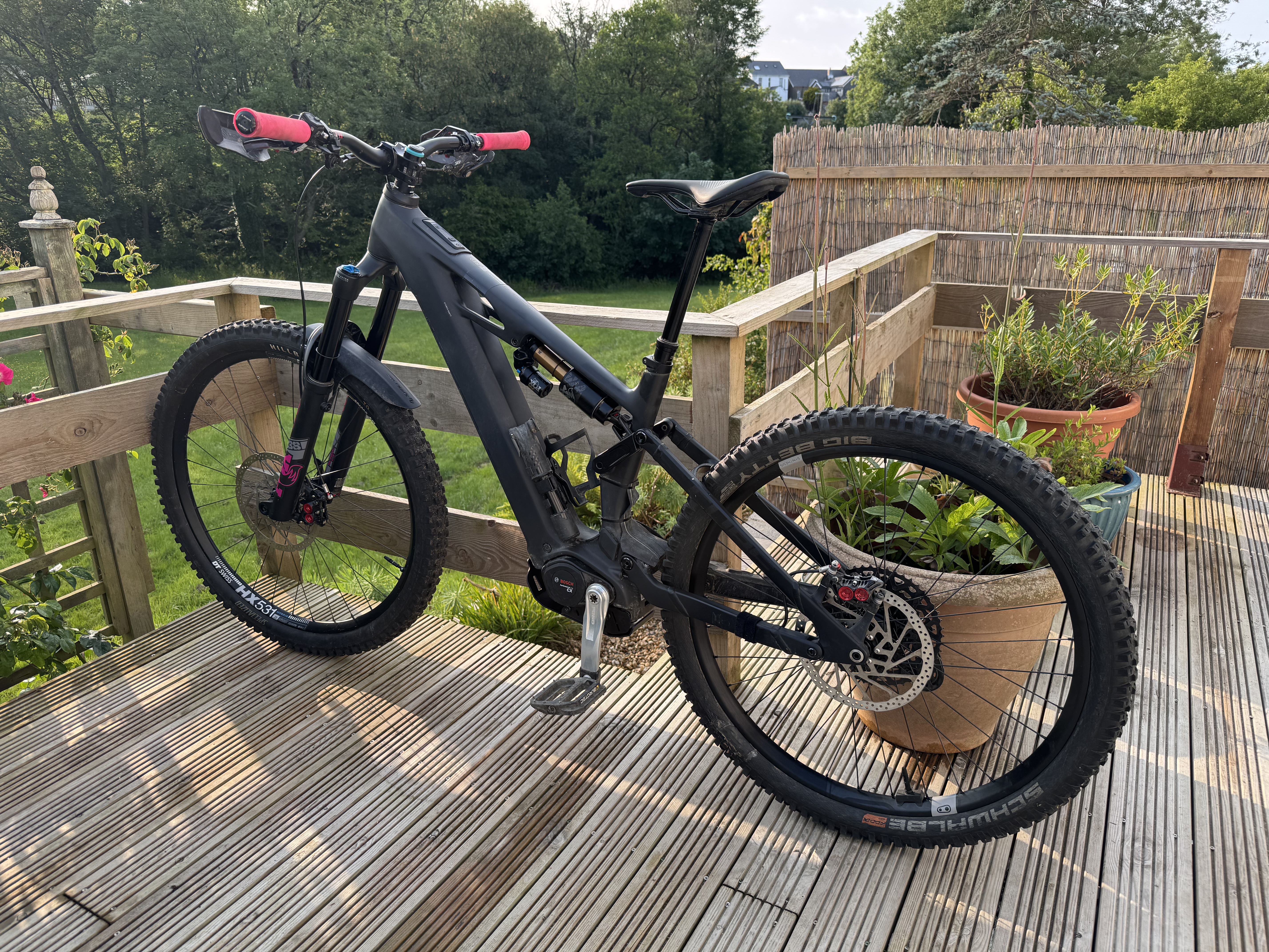

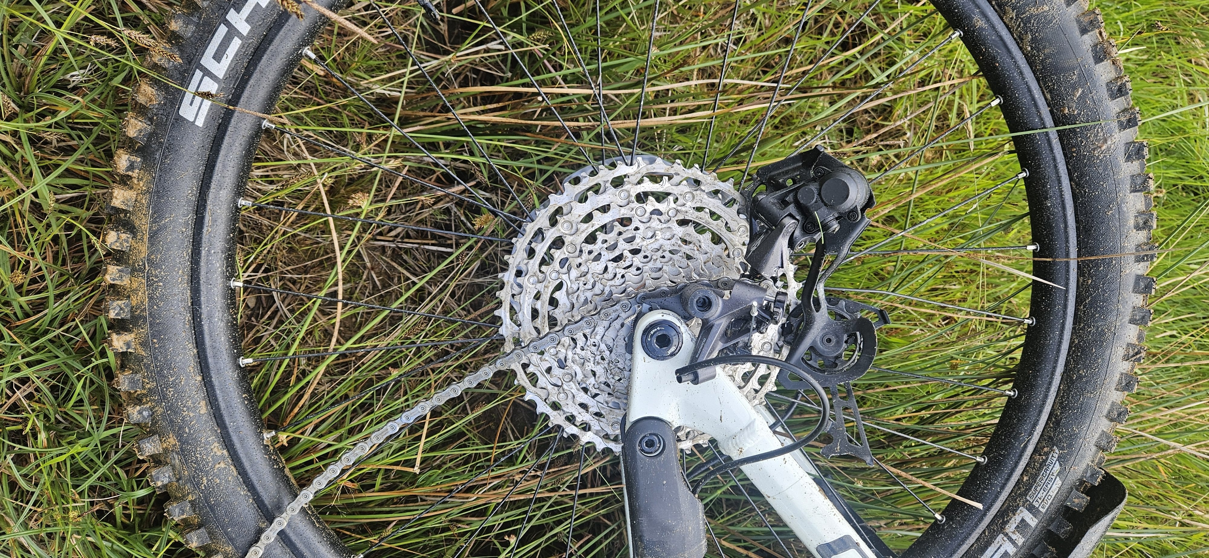

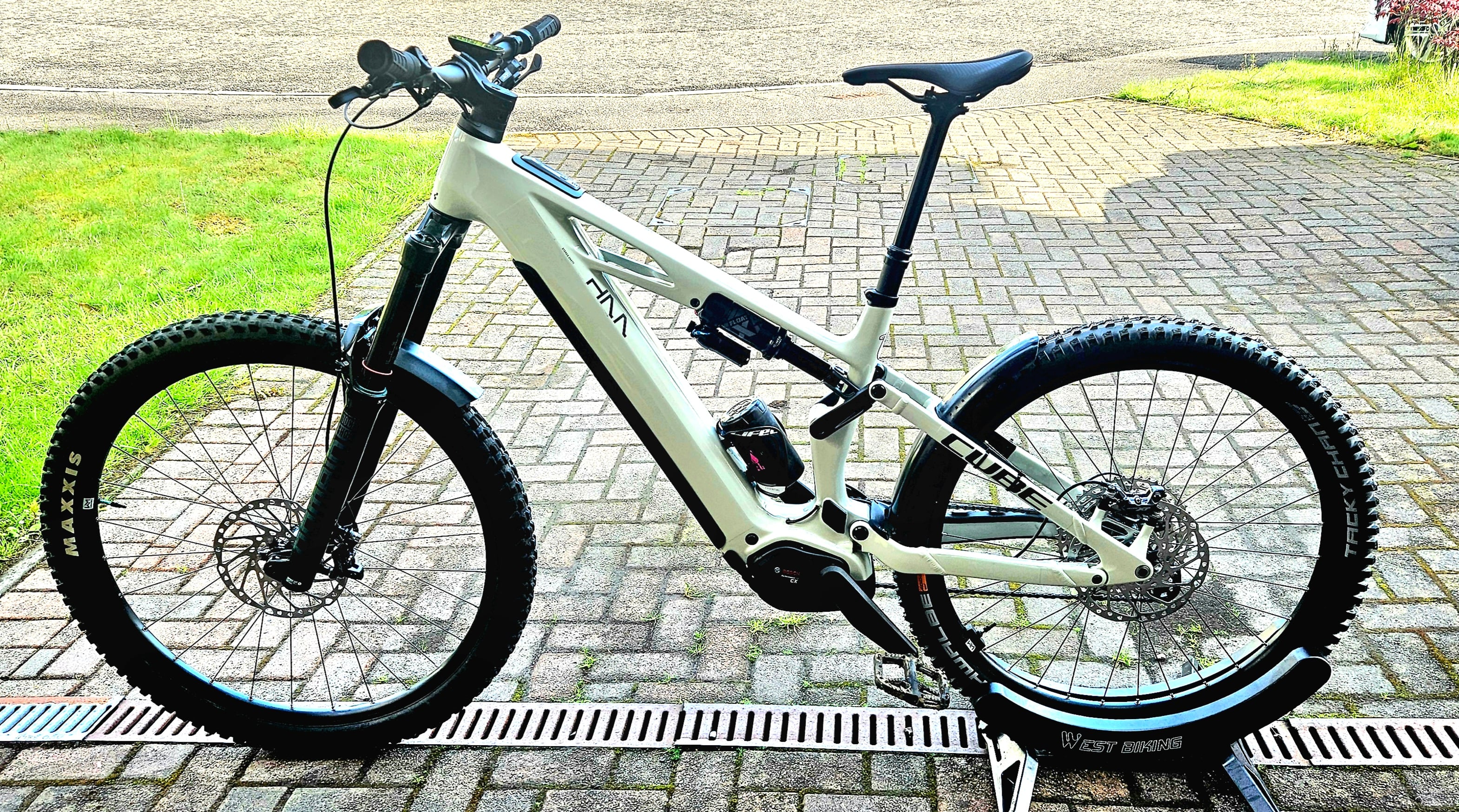

One77 arrived, pretty pleased with it so far. It's had a quick run round the trails. Real struggle to get tires on the rims with inserts in but got there eventually. First ride disaster when the mech got into the rear wheel, had to replace with my spare deore one. Pretty weighty but pretty good VFM I reckon.

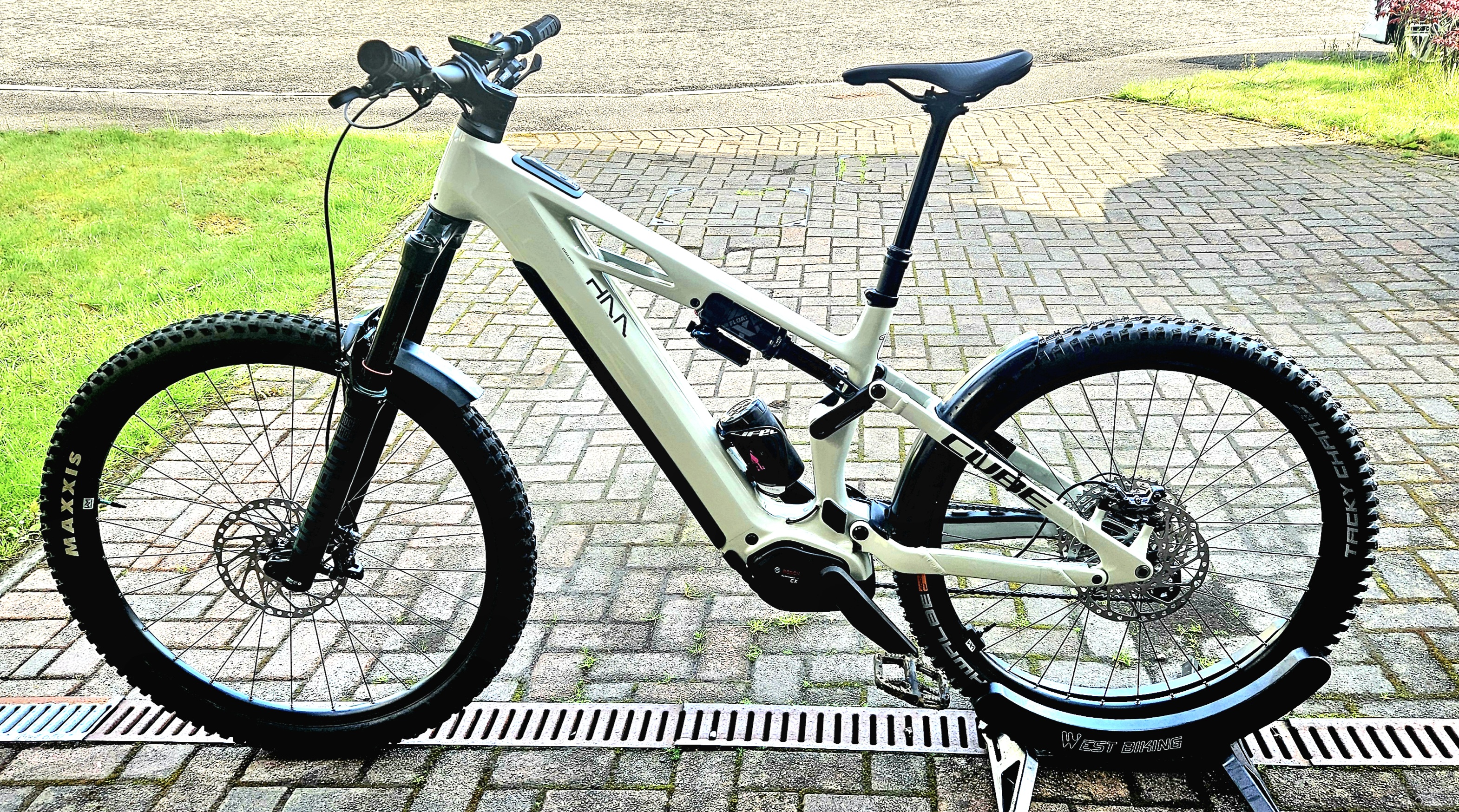

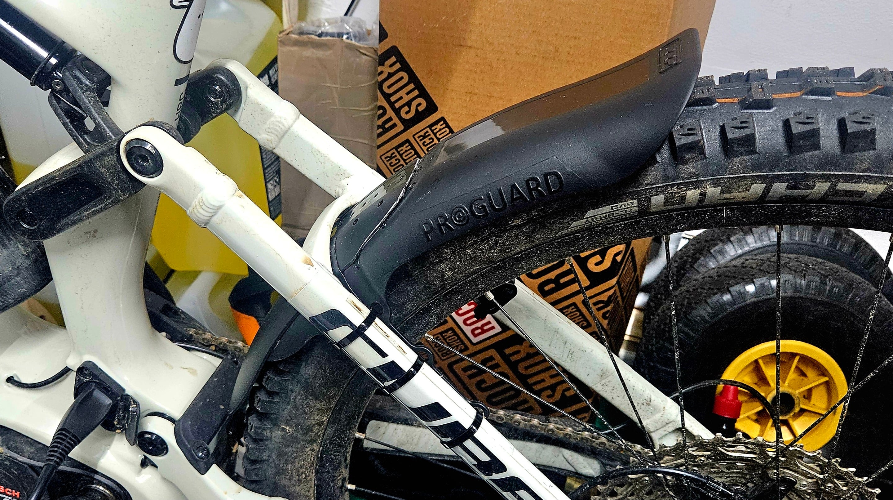

Thanks, thats a front mudhugger that I had lying around. Cut it down to fit. I was waiting on a rear RRP rear guard arriving (mini with extender) and have fitted that now. It's a bit of a better shape at the back lip.
Nice one. I’ve got an RRP rear with extender on its way to me. Does the extender drop down past the stays?
Yeah it will, I cut it slightly shorter so it sits just barely above the height of that rubber pad at the base of the stays.
Sweet. Should do a decent job of shielding the lower swing arm pivot from the crud come winter time then.

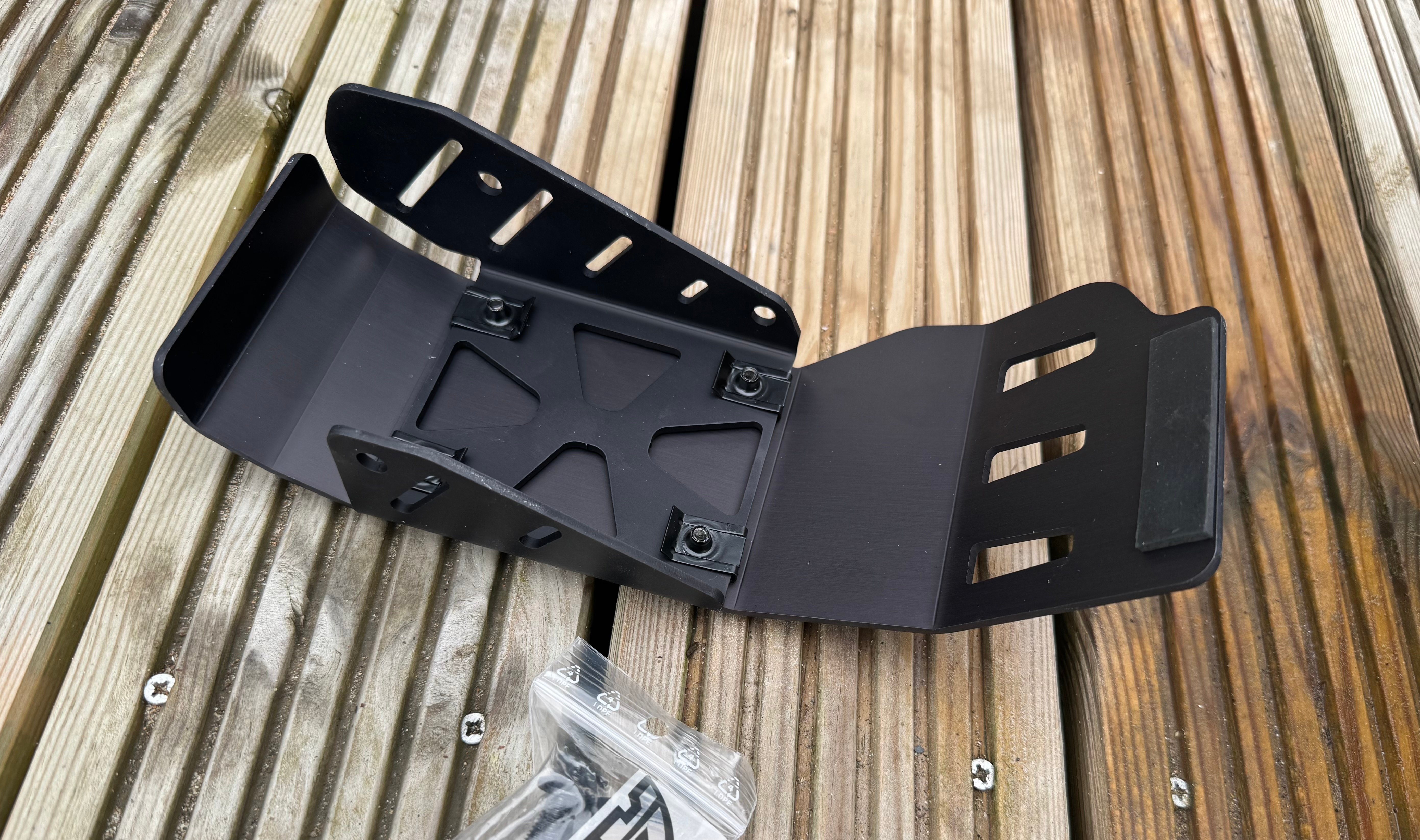

Good bit of kit aren’t they? Mines taken a few knocks already that would have obliterated the crappy stock plastic cover.
Agreed. Really nice and I thought £90 delivered for a quality, made in France, product was very reasonable.
Just fitted so it’ll get a shit kicking next week after my new 34t chainring arrives…

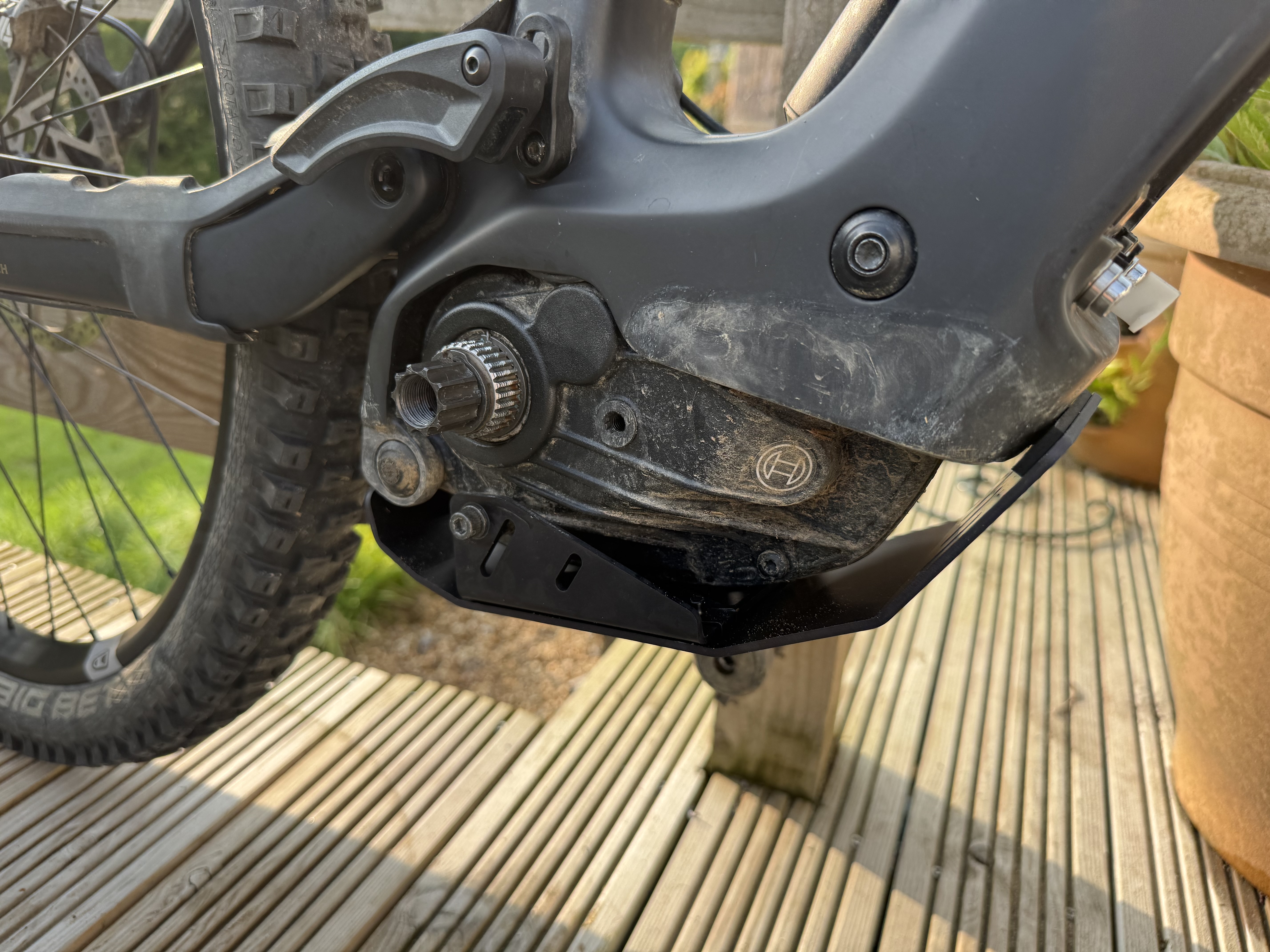

Anyone know the crank torque setting? My none drive side has come loose 😭
I have the same problem on my drive side. I used thread lock and carry a hex with me and check it every so often.
I don’t suffer from “range anxiety” with my bike - I suffer from “crank coming off” anxiety.
I have the same problem on my drive side. I used thread lock and carry a hex with me and check it every soften.
Take them off, use a small blue flame candle lighter in the thread of the crank in its hot, shove it on and tighten up to about 30nm. It’s looser than it needs to be but it cools down and then it’s solid. A rubber “persuader” can take it off.
The crank doesn't attach in the way you're thinking.
The Bosch Gen 5 motor uses a standard ISIS bottom bracket spindle. The crank arm slides onto the ISIS splines, which prevents slippage under torque.
The bolt threads into the hollow ISIS spindle, pulling the crank arm tightly onto the splines.
It appears to be a common problem.
No it attaches just as I expect it to. The heat soaks in to the crank and when you put it on the motor spindle and screw it in it shrinks. 30nm on the BOLT used to tighten the crank on when hot allows it to go deeper in to the spindle (we are talking microns retrospectively) and when it shrinks you get the effect of using a much higher torque without stretching your threads. A rubber mallet is all then is then needed to shock the bolt to slip. This is similar to how you can heat press bearings and bushes.
I get you.
I've ordered some new bolts and a torque wrench.
Thanks for your help. Much appreciated.
I tightened my new cranks to 40nm weeks ago and they haven't budged
Ordered a torque wrench and new bolts so will try again.

Oh and my motor casing is f***ed too. But have a metal guard on the way.
