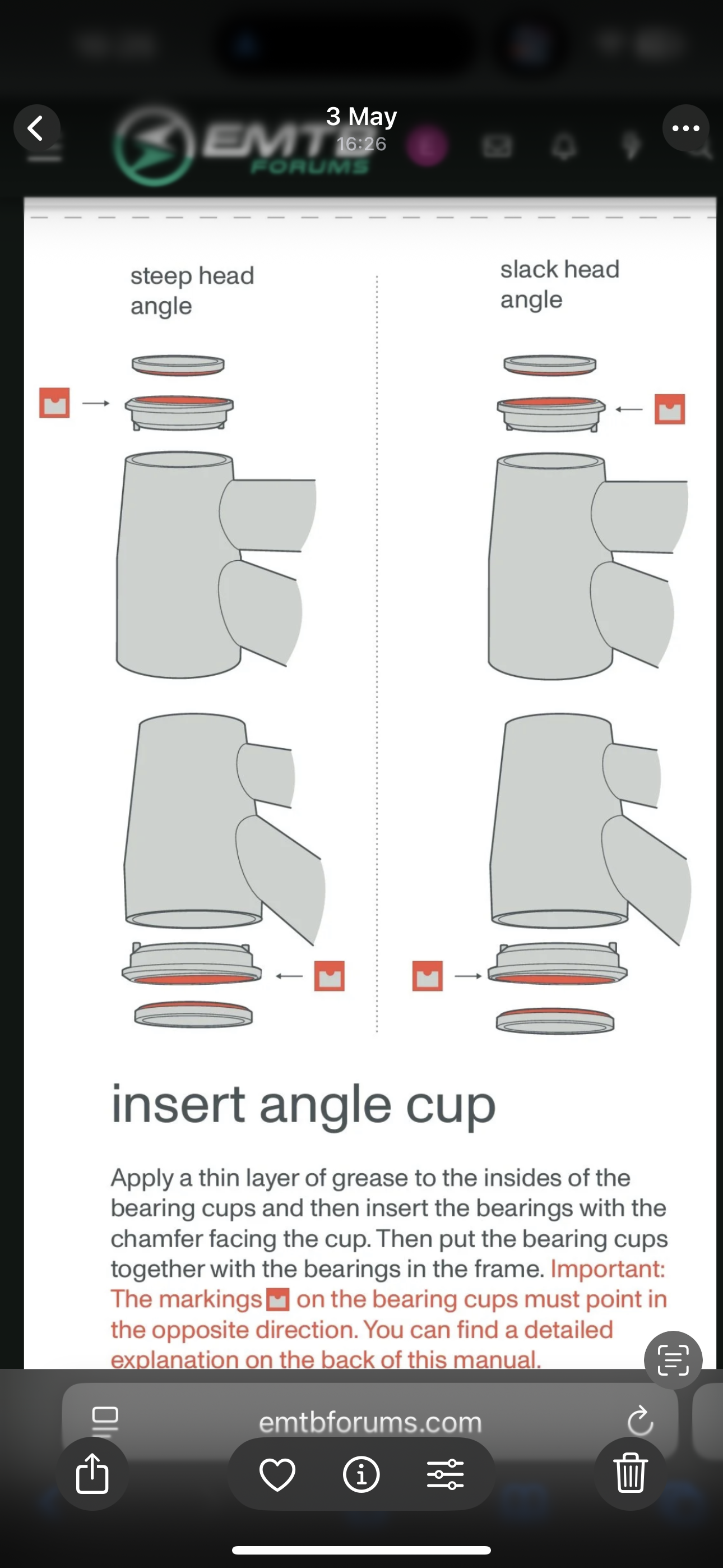

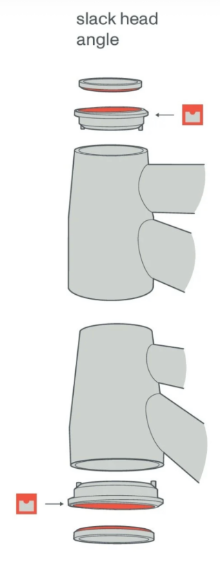

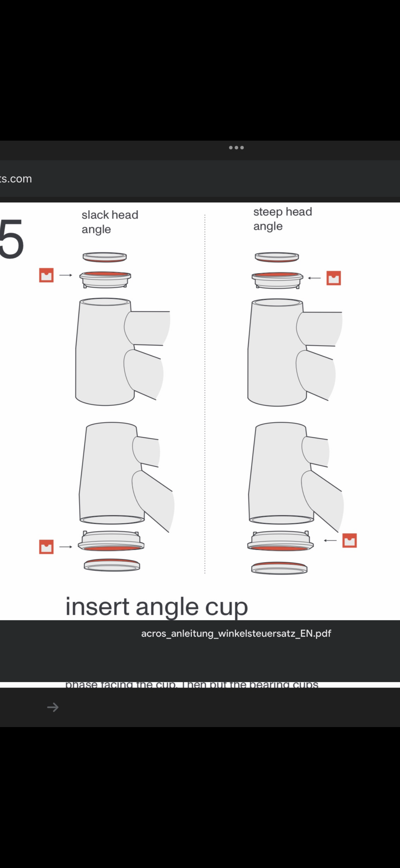

Can someone confirm which is the correct orientation for the headset cups in the slack setting please? Got two conflicting diagrams from Acros!
I also lost it while on the road to the forest near by... Interested if someone knows the answer

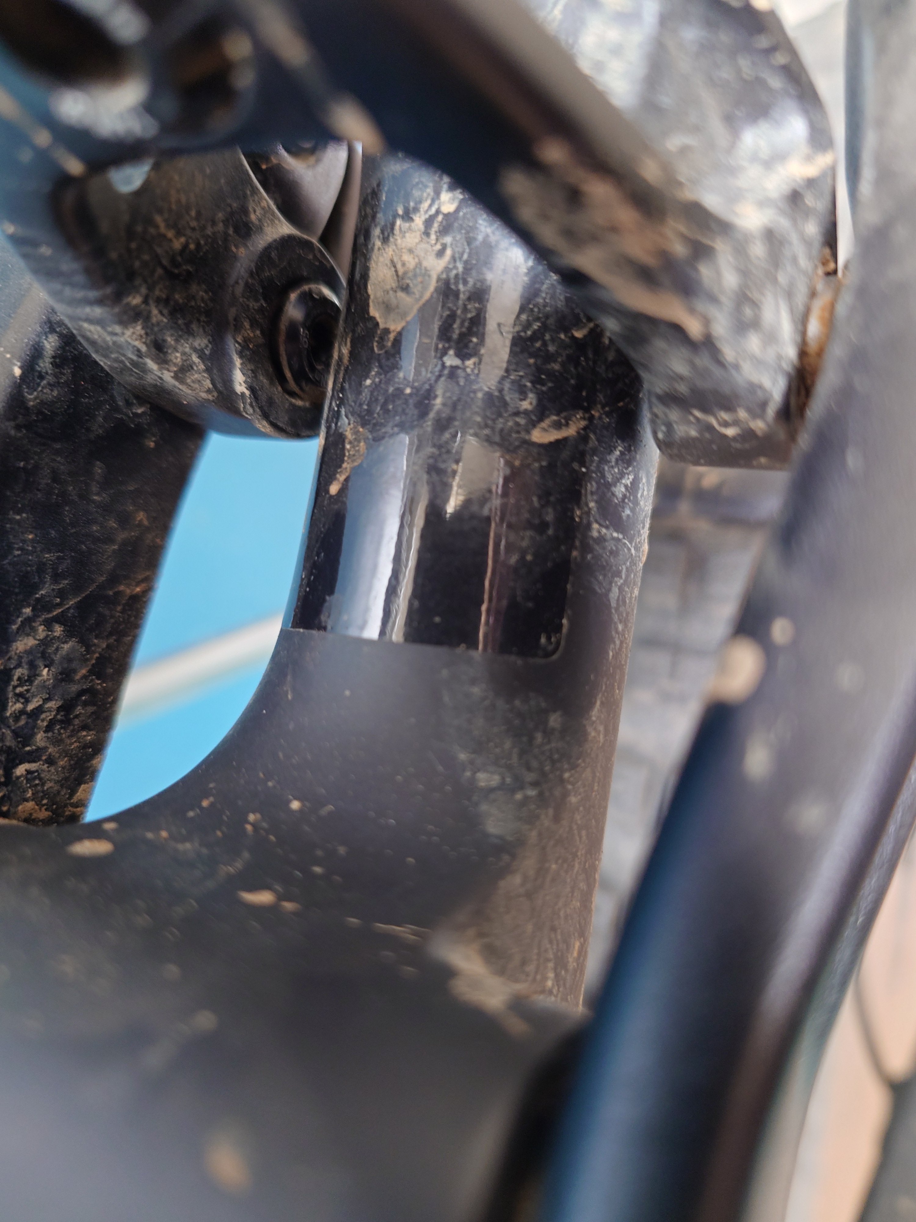

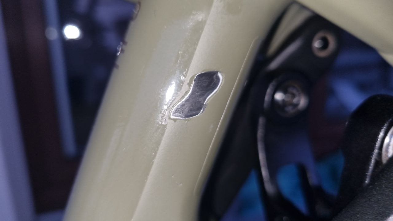

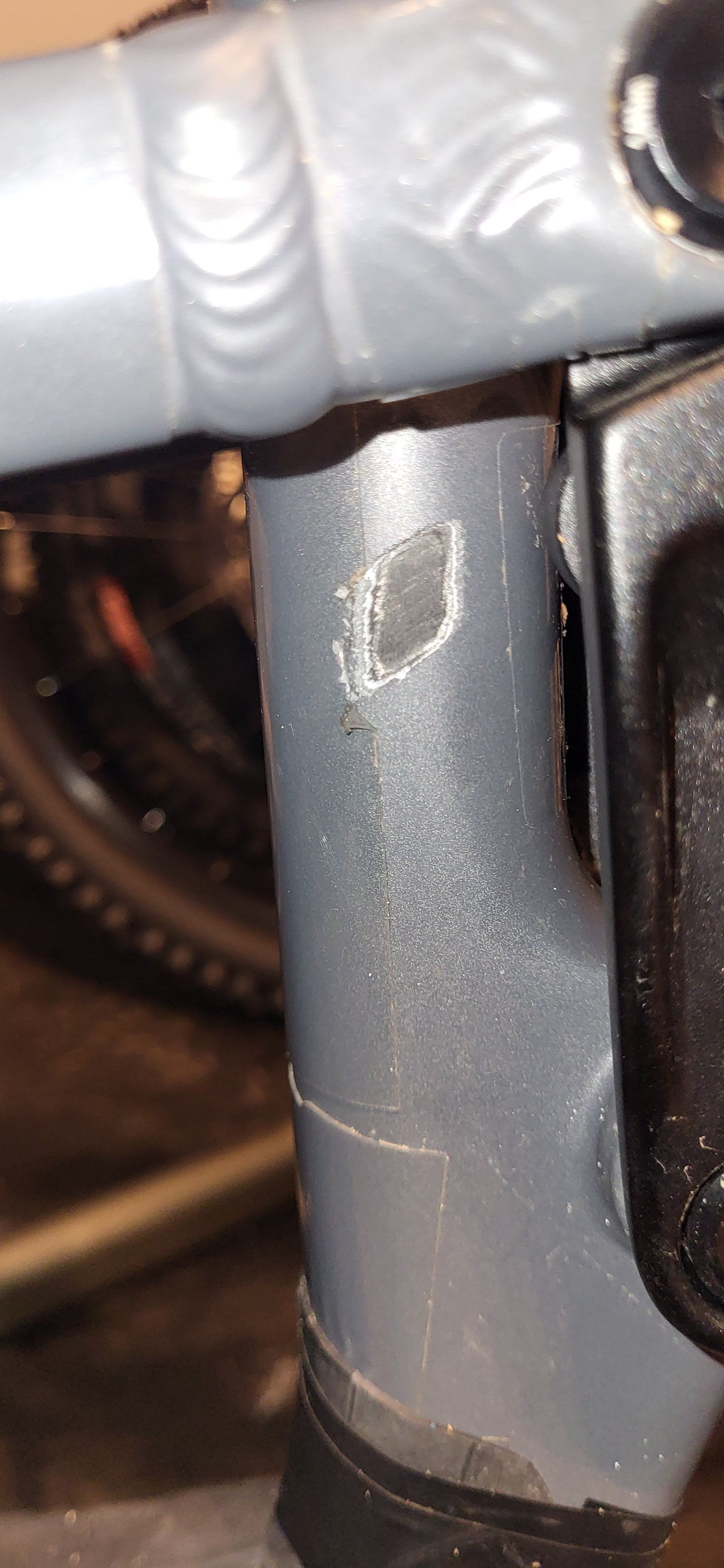

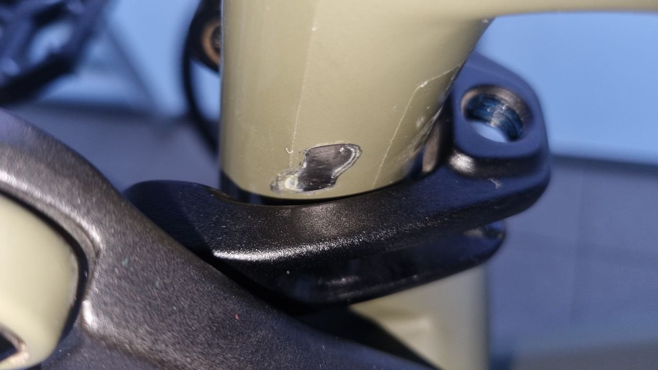

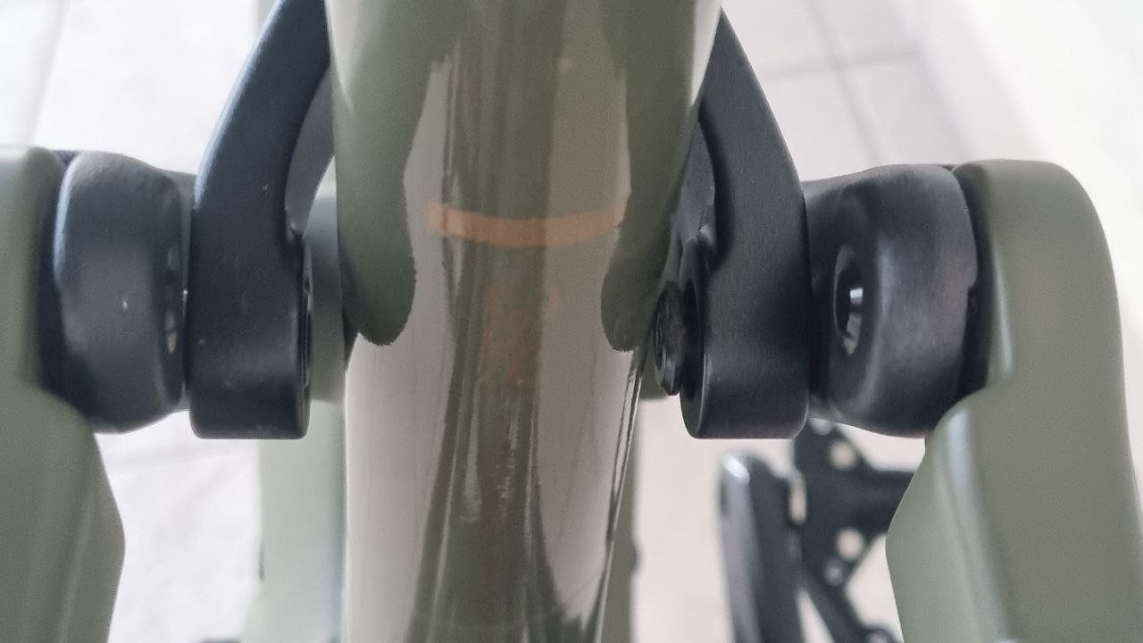

Check all your torques by the way, one of the rear arm screws was not tight at all, it damaged a bit the frame along the seat tube
View attachment 157605 View attachment 157607
I have the same issue — bolts don't hold up and unscrew during intensive riding.

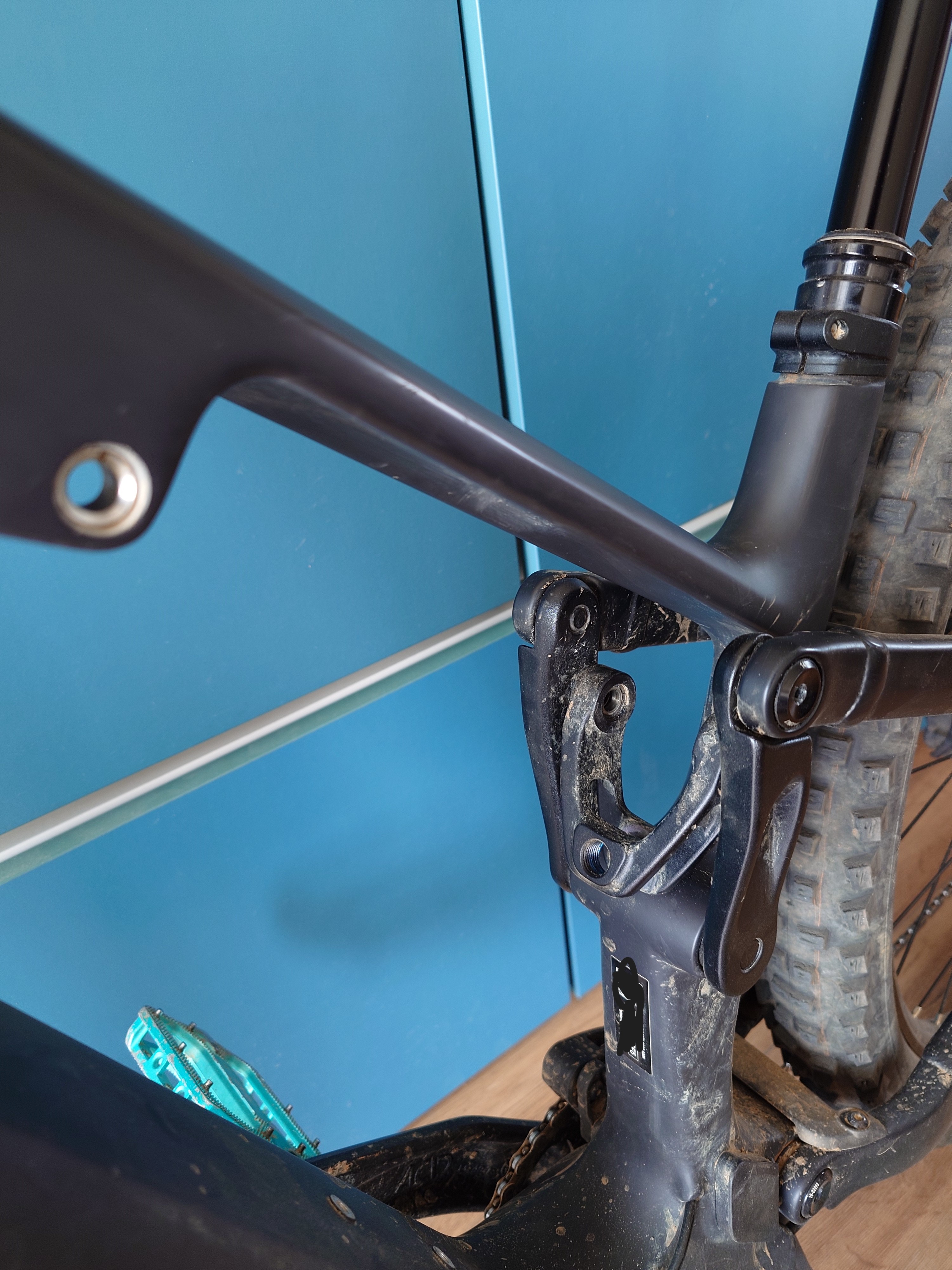

Also, the linkage has poor design. To tighten the bolts, you have to unmount the shock to gain access to them.
The first time this happened, a loose bolt damaged the frame badly. While riding, I heard a strange knocking sound but couldn’t find the exact location, so I kept going and kept hearing the bolt rubbing against the carbon frame 🤬.
After this happened the second time, I added thread locker — I'll keep an eye on it.

Wow. Have you contacted cube ? I’ll definitely be keeping an eye on mine
So thread locker wasn’t there from the factory? That’s nice…
Happened for me same i just dropped to dealer to investigate and they should come back this is definitely they not assembled right because to access it you need to remove rear shock, but i have claim warranty they have to replace front triangle i wont accept if they said you can still ride it its normal ...lol i had only 2 weeks bike and done only 2 rides...ill ask for refund and buy another brand if they refuse to replace frame.
After all these nightmare reports of bolts working loose, I’ve just stripped all of my pivot joints down (including those two hard to get to ones 🤬) and added fresh thread lock to the bolt ends, then torqued back to the prescribed setting (couldn’t torque the awkward ones though, as I simply cannot get the torque wrench in there, so settled for my best guess at 8Nm with my carefully calibrated hand on the hex key). I’ve also put tiny blobs of white paint on the bolt head and corresponding point in the frame, so it’s visually obvious if they start to loosen.

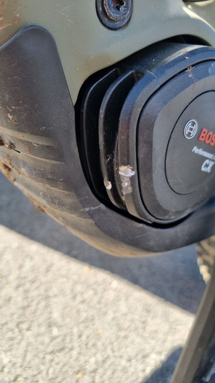

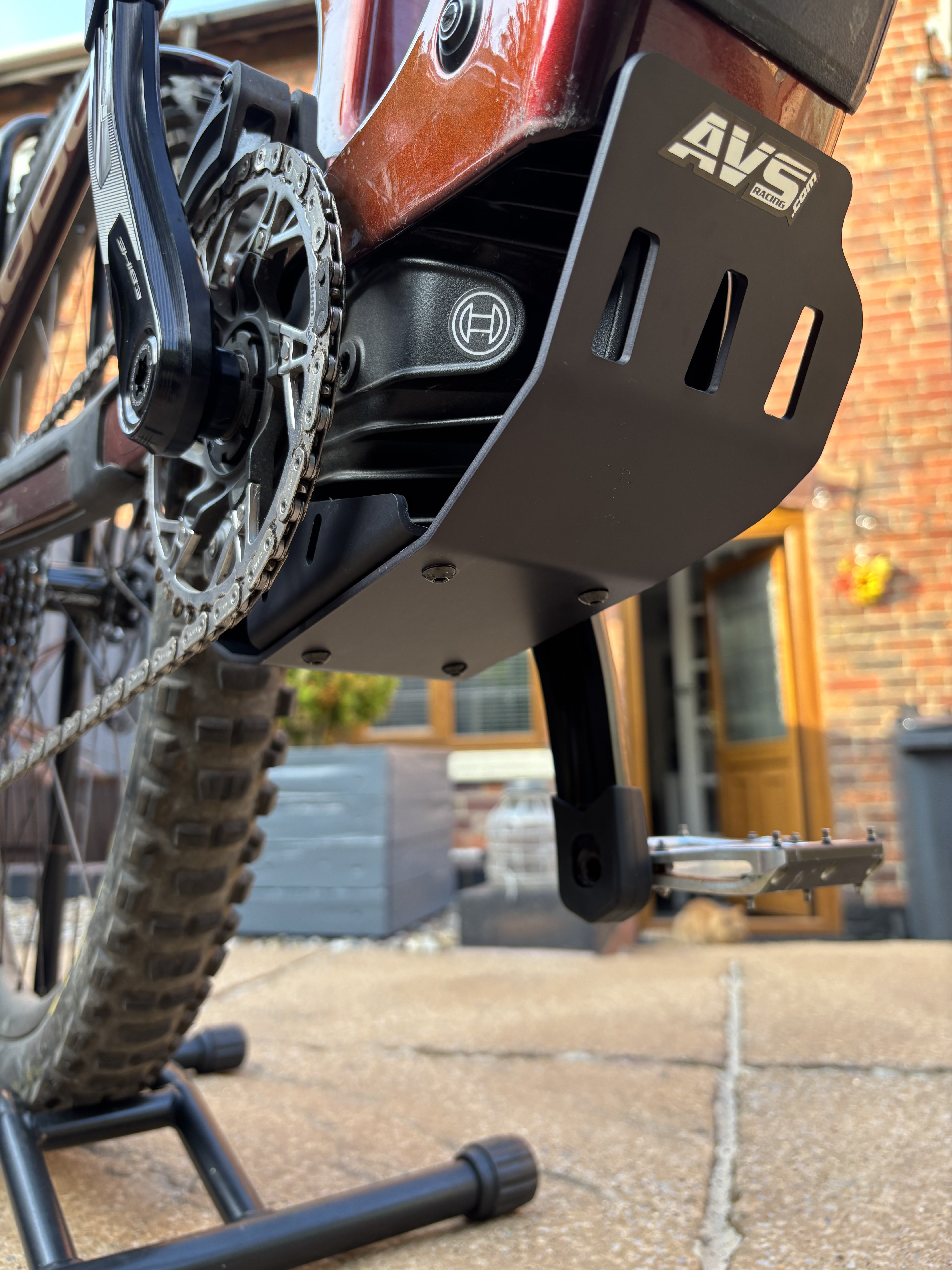

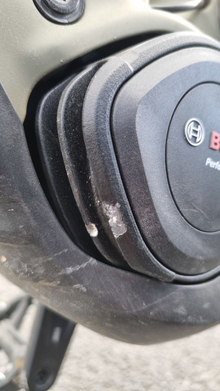

Brutal protection, but the most vulnerable part of the motor is still unprotected.
The motor casing is so fragile that stones flying off the front wheel literally rip chunks of metal out of it. I took 2–3 hits in almost the exact same spot during just one descent.

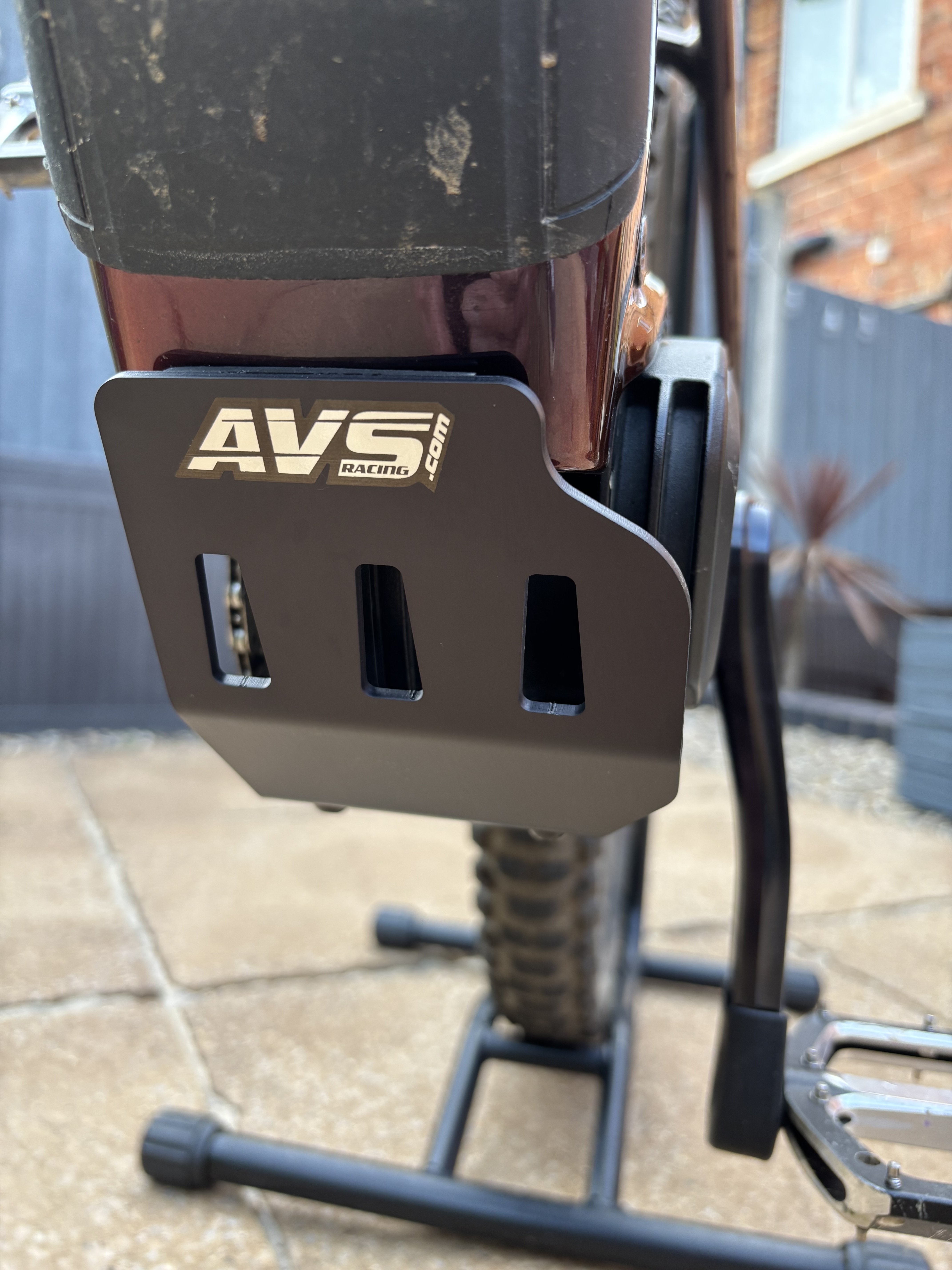

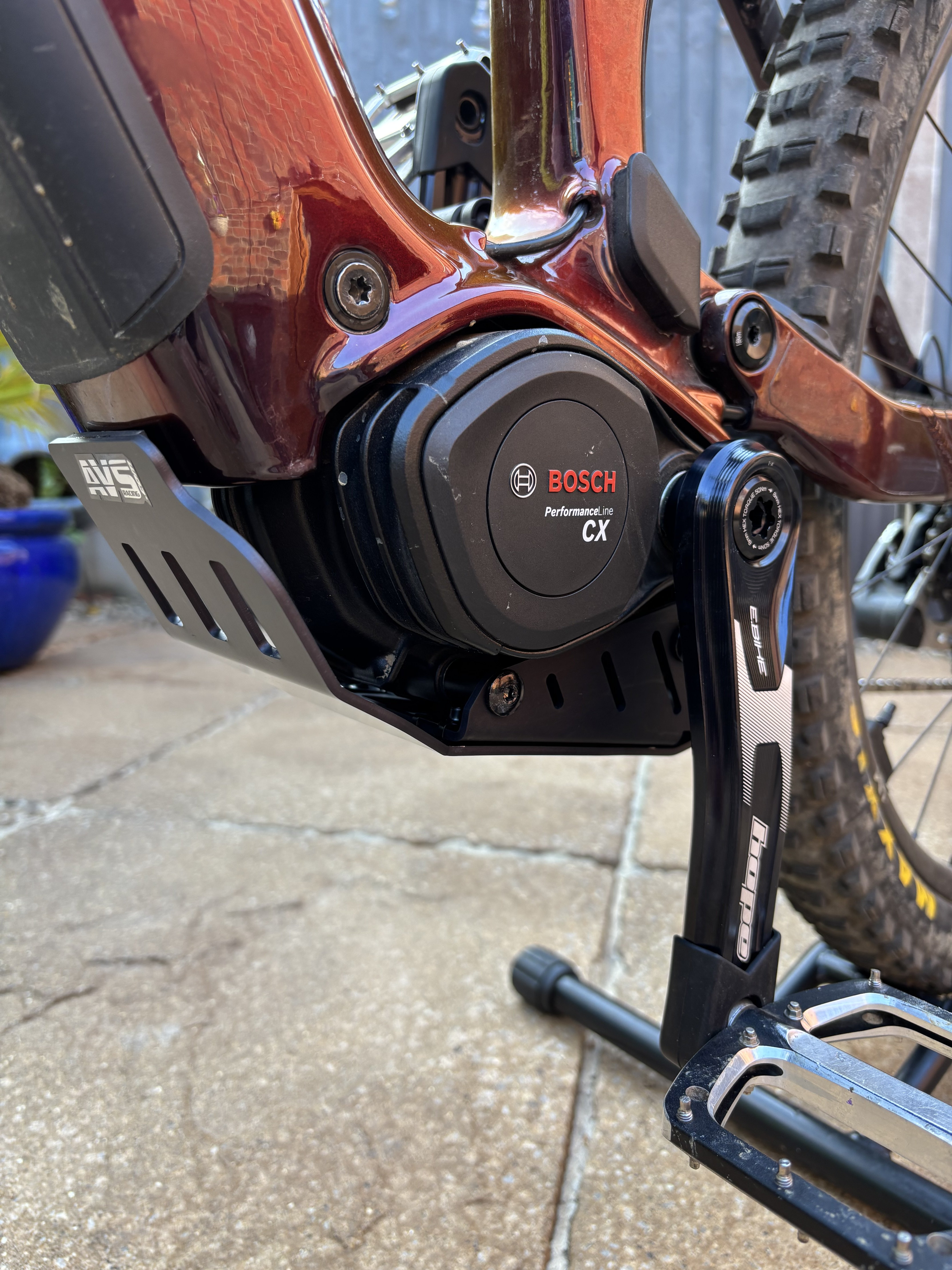

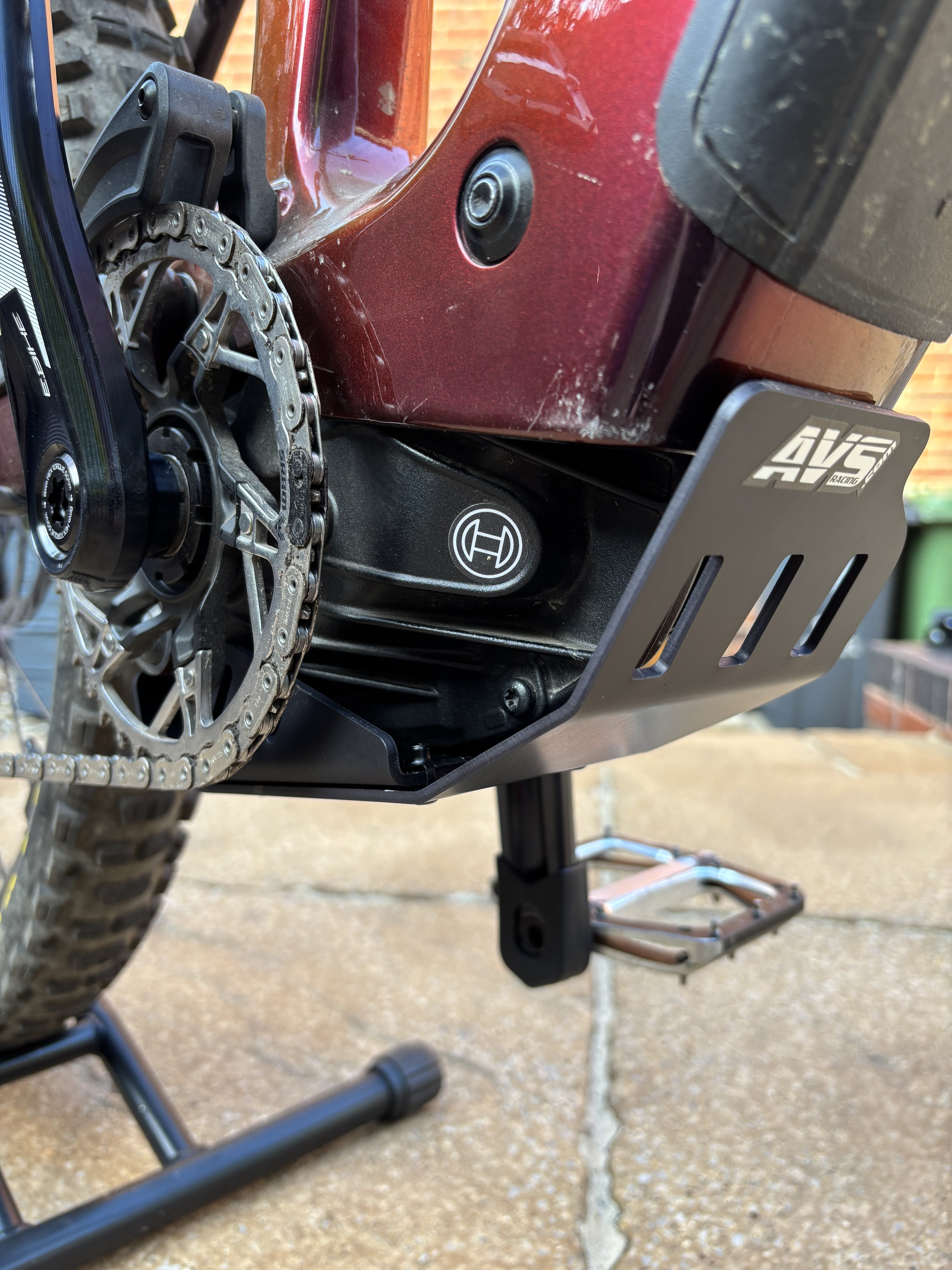

Nasty 😬 The AVS one gives a little more protection, but the outer cooling vane is still a bit vulnerable.

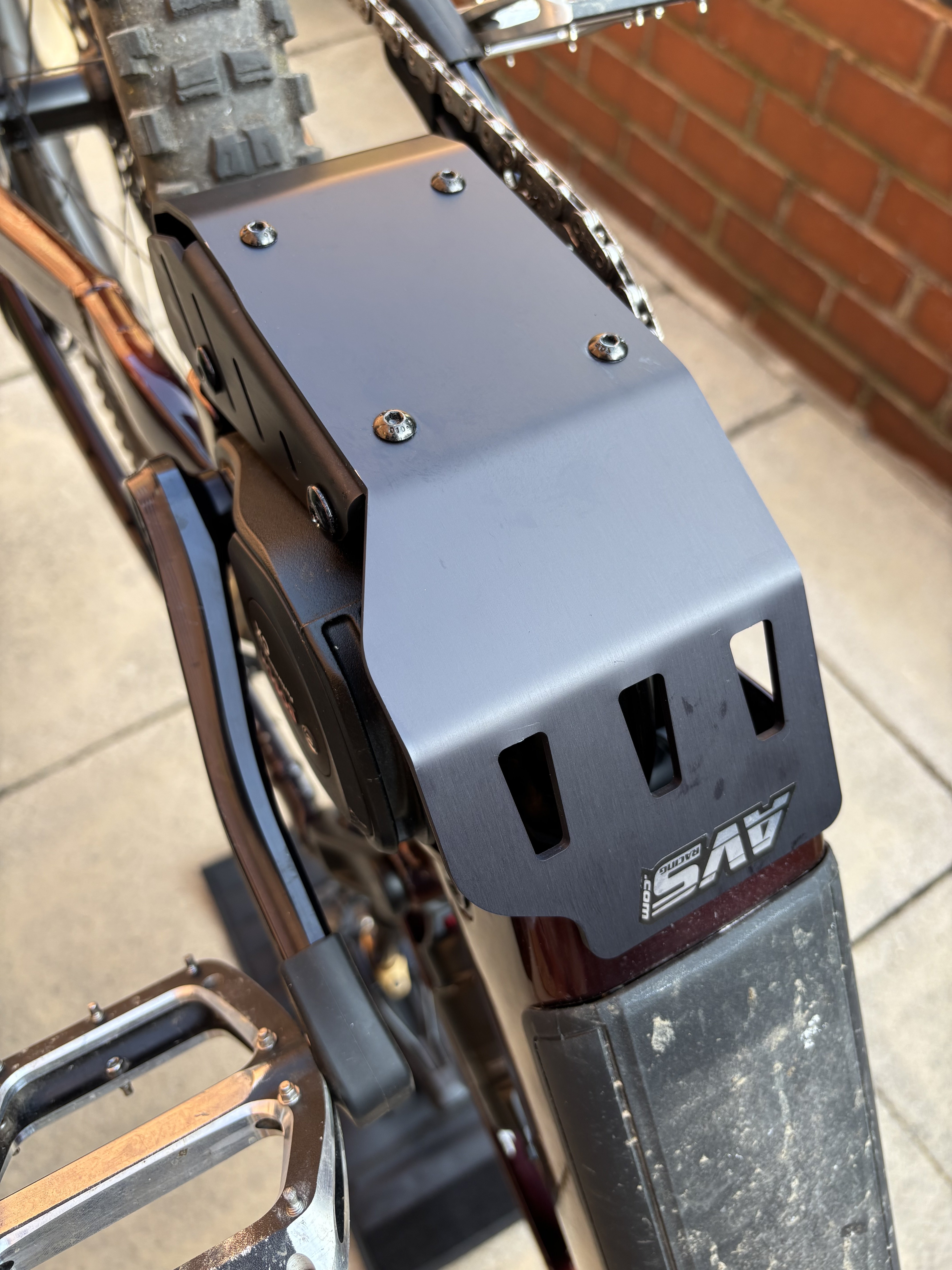

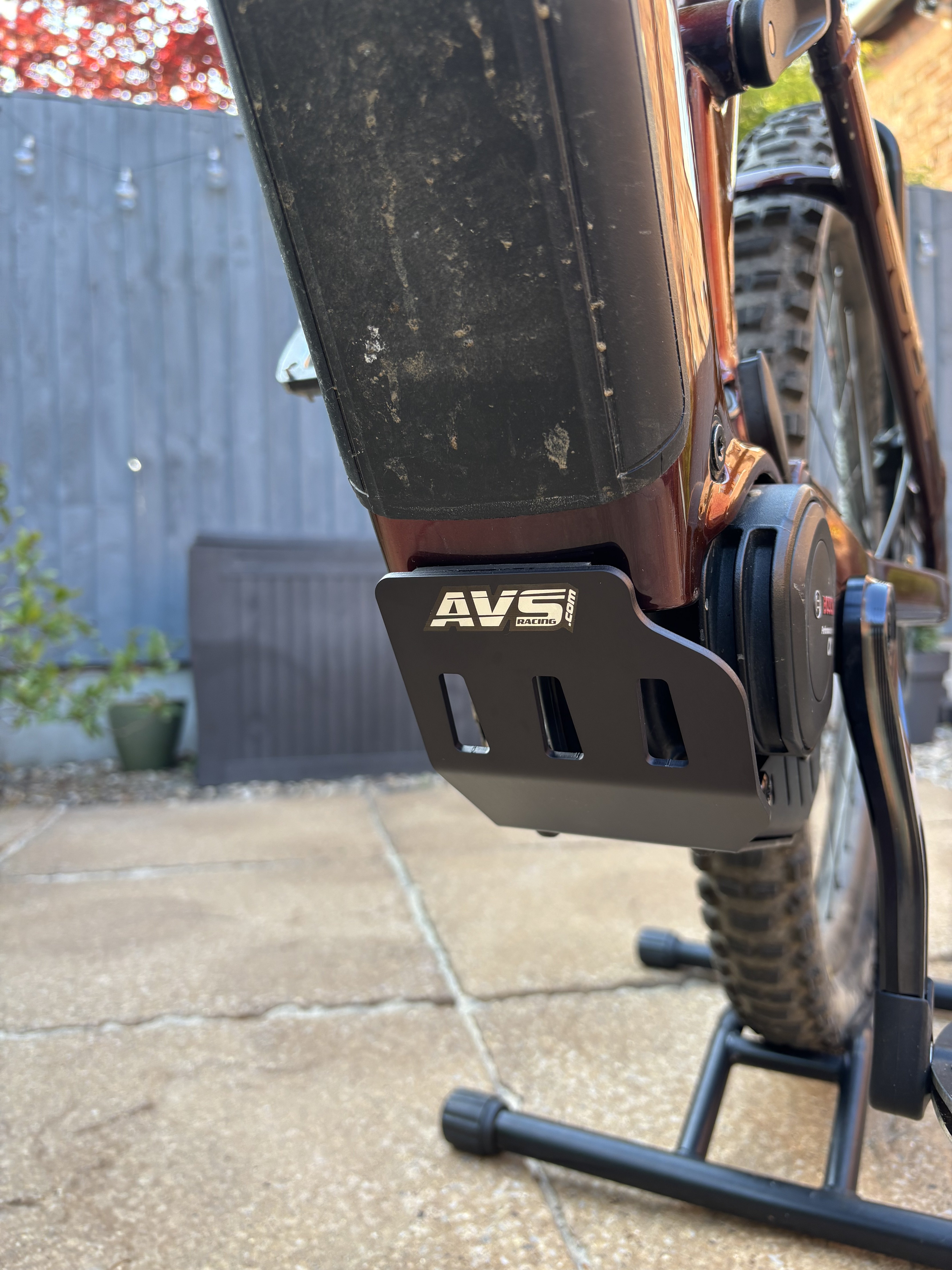

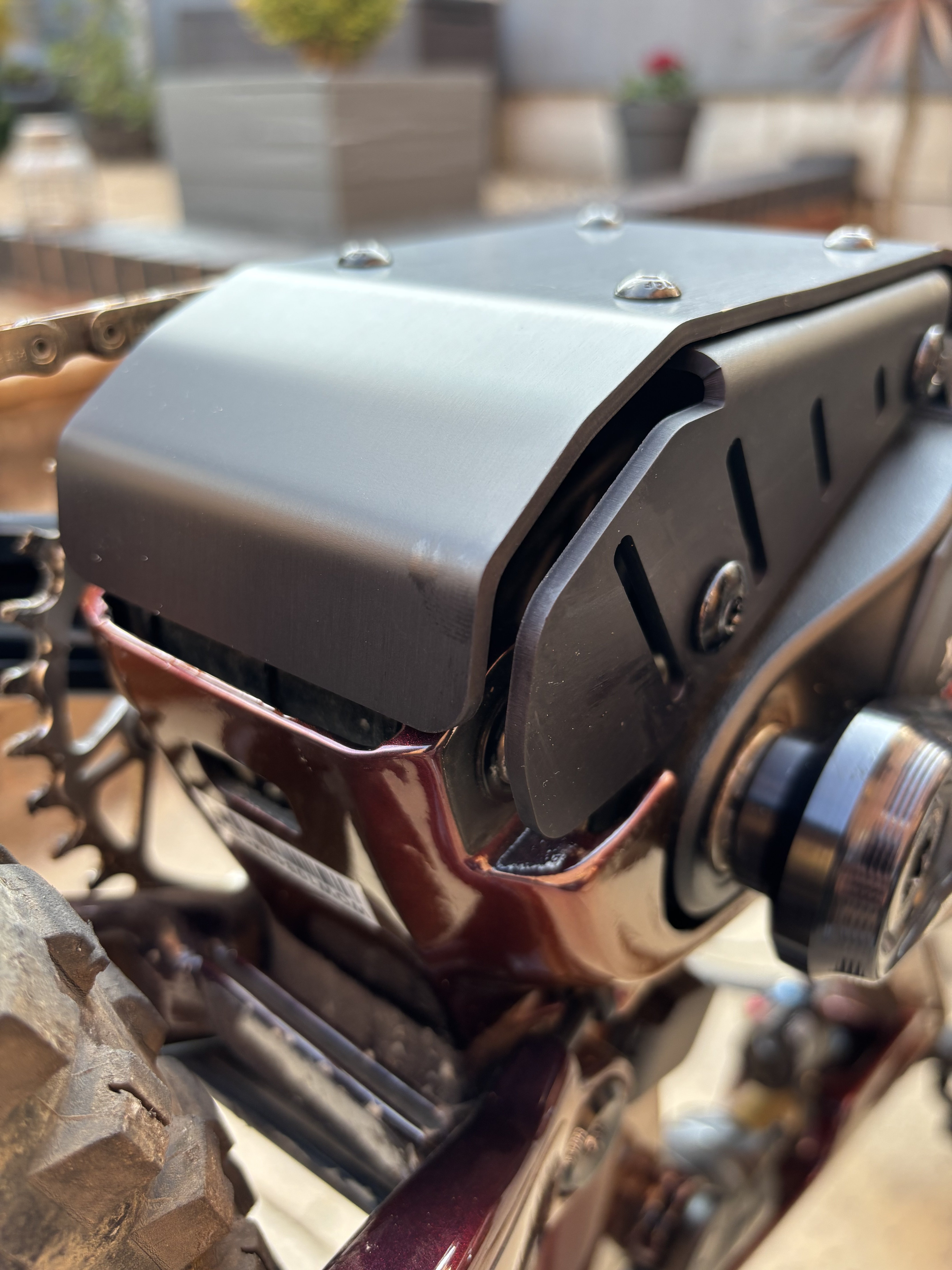

Bolt on cover? Motor has threads/holes in it for this cover? How about on the rear end, where wires and connectors are?
Yes, there’s a cradle which sits over the cables and plugs and that’s bolted to the motor using the existing motor mounts. The outer skid plate is then bolted to that.
The diagrams of how it all fits are on the AVS website. Took literally 5 minutes to fit.
yes mine is similar in that I've had stones lodged between the motor and pedal crank making a right mess of the motor case!
