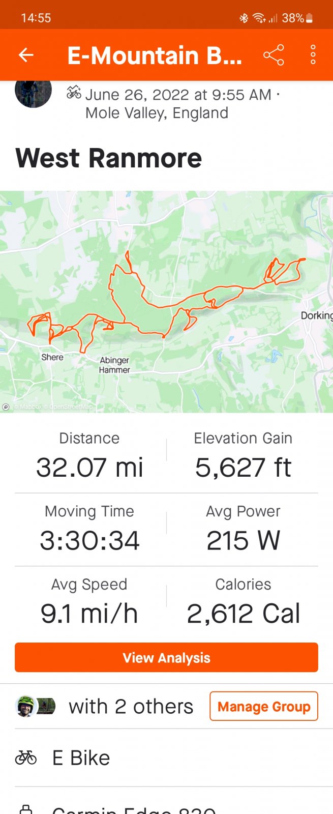

Seriously hang in there, it gets much better, I don't fully understand what's going on with the smart system, whether it's the battery needing a few charges or the software sorting itself out, but at about 400 miles on my 22 Rail I am more than happy with the range.
Last week I did a 32 mile ride with 5600ft of climbing, and still had about 30% battery left and that was using about 30% tour, 50% emtb and 20% turbo.
My friend who was with me has a 2020 Levo with 700wh battery, he weighs about 15kg less than me and was using a mixture of trail and eco and he ran out, I had to push him up the last hill.
