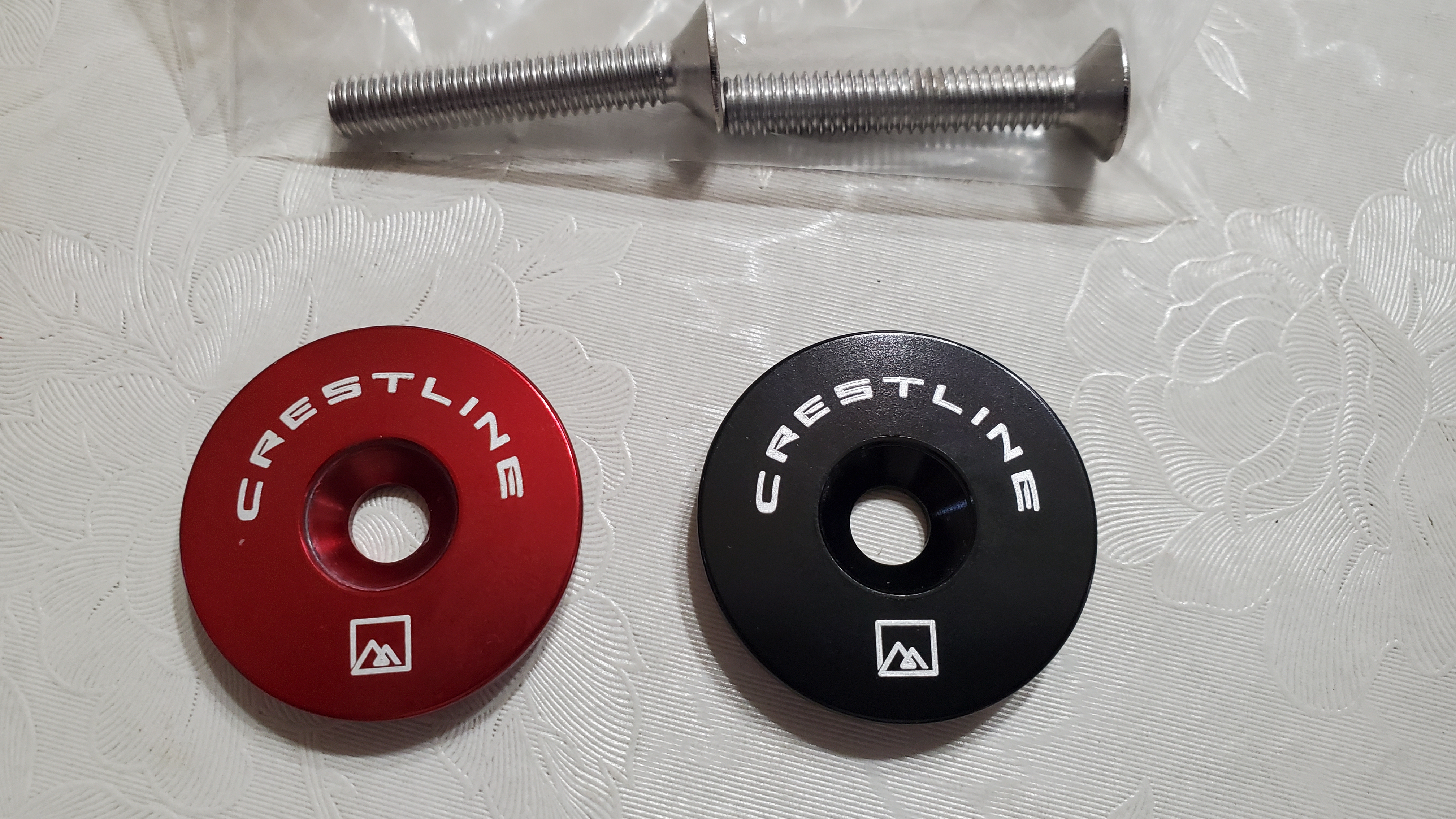

Just got the first new and perhaps the most critical of parts going for the upcoming build, the top cap(s)!!
