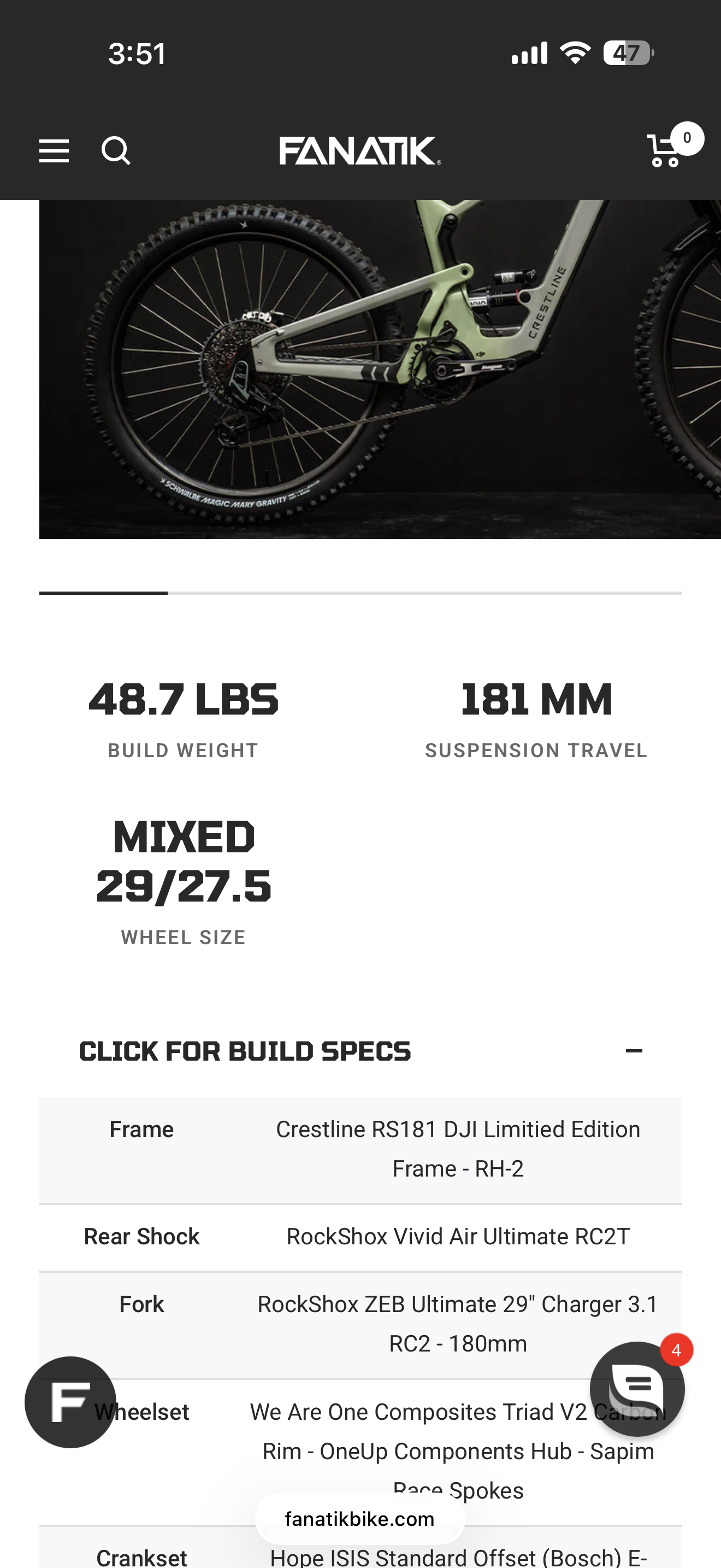

Curious for current Crestline/DJI owners, what are some of the total build weights ending up at?
Fanatik has one listed at 48.7 lbs, RH2, but must have 600wh battery. Most of the ones I have seen or read were few pounds north of 50lbs.
Full build specs are listed, but couldnt find battery info. Idk, that weight seems suspect to me, but I dont know.
Its possible. I have a near identical set up and my bike was 49lbs with a 800w. I was rocking ohlins front and rear (coil). Gained a little weight moving to rockshox. Tires also play a big factor in weight.
1 lb or 2 lbs you're not going to notice anything. Its when you start hitting the 5lb range is where its noticeable.

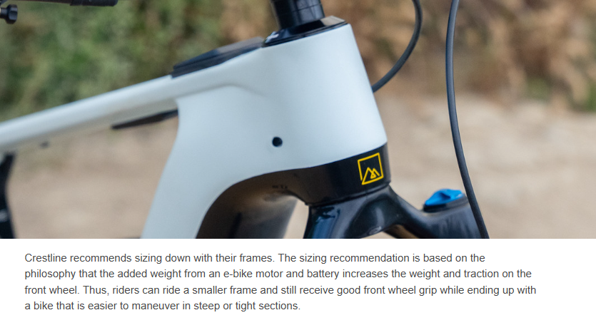

I will ask a question here. 190lbs, 5-10 with 32" inseam. Aggressive older guy. I ride all tech, up and down, never flow trails unless I am at a park. This would be my first ebike, looking forward to steeper climbs and conquering uphill obstacles. This bike will also be used for aggressive technical descents.
I usually buy size Large bikes (XC and Trail frames) with 470-480 reach numbers because mediums can feel a bit crowded, BUT the large usually feels a tad big and has me trying to shrink saddle and stem, and raise the bars. I am a tweener. (same with M-L helmet size)
Should I consider RH-2 or 3? If RH-2, what CS length do you guys recommend for climbing prowess without losing too much maneuvering?
I will ask a question here. 190lbs, 5-10 with 32" inseam. Aggressive older guy. I ride all tech, up and down, never flow trails unless I am at a park. This would be my first ebike, and the part that is most exciting to me is the steeper climbs and obstacles I would be able to CLIMB.
I find myself on size Large bikes (XC and Trail frames) with 470-480 reach numbers because mediums seem can feel a bit crowded, BUT the large usually feels too big and has me trying to shrink saddle and stem, and raise the bars. I am a tweener.
Should I consider RH-2 or 3? If RH-2, what CS length do you guys suggest for climbing prowess?
I am 6'/185lbs with 32" inseam, running a 40mm stem/155mm crankset and the RH3 fits like a glove.
I don’t think you’ll ever get a clear answer, so much is down the preference. I’m 5’10 ~165lb and ride a large 95% of the time. But I don’t find that they feel too big. I bought a rh3, have run 50mm and 40mm stems, either is fine, 445 cs mx setup. The space between my saddle and bars feels shorter than a lg bullit i was previously on but the wheelbase feels longer (and is).
Ultimately if you want stability go rh3, if you want flick-ability go rh2. With both you can size it bigger or smaller with reach adjust and cs length. Based on your description I’d probably go rh2, +5 reach adjust, 45-50mm stem and 450 chainstay.
I'm with 👆 and that last part.
I'm 5-10 on an RH2, 450mm CS 29er. Compared to my previous bike when seated reach with a 50mm stem feels a little tight, I had originally wanted to use a reach adjust. But once standing because of the longer wheelbase and wheels I sink right in and feel balanced. For me as a do it all bike the size is spot on. If it was a DH/park bike strictly looking for stability I'd have gone large.

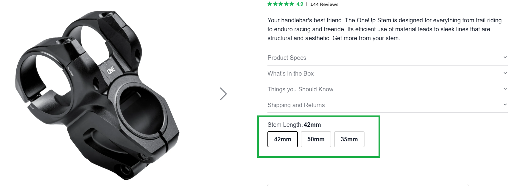

You can also consider going with a slightly longer stem and adjusting spacers, say 42mm vs the 35mm OneUp. This will give a bit of reach and a dash of stack height without changing up the travel or head angle. Fine tune with spacers.
