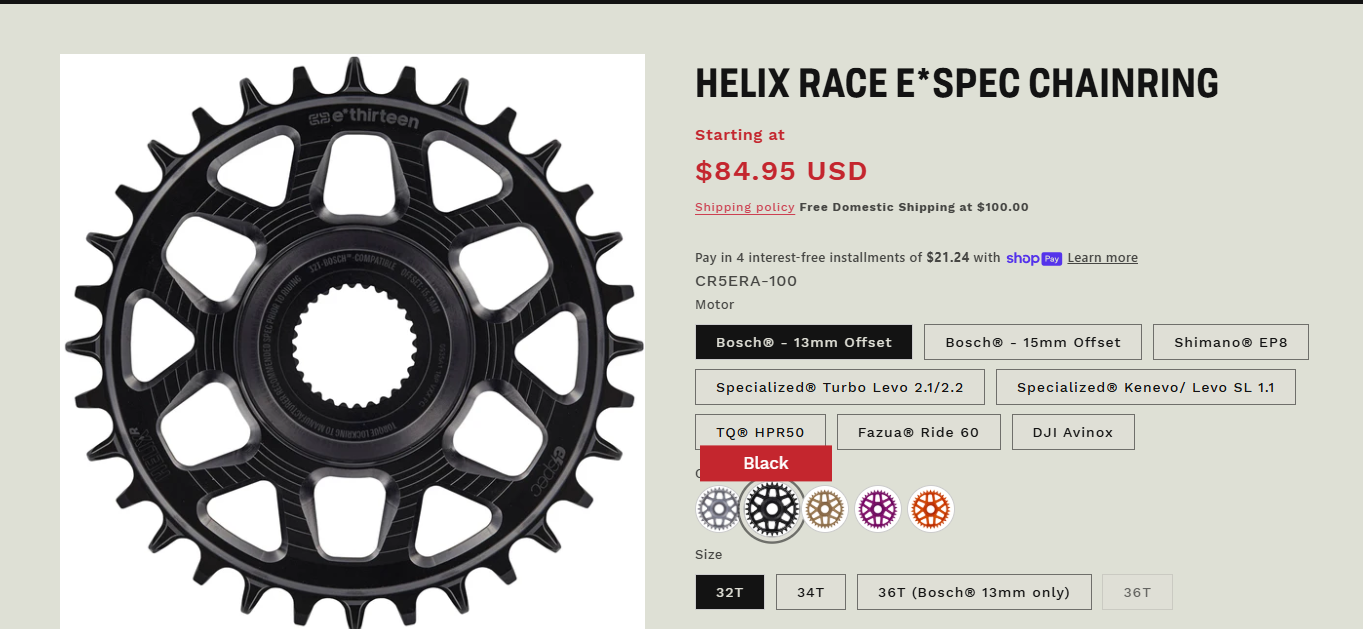

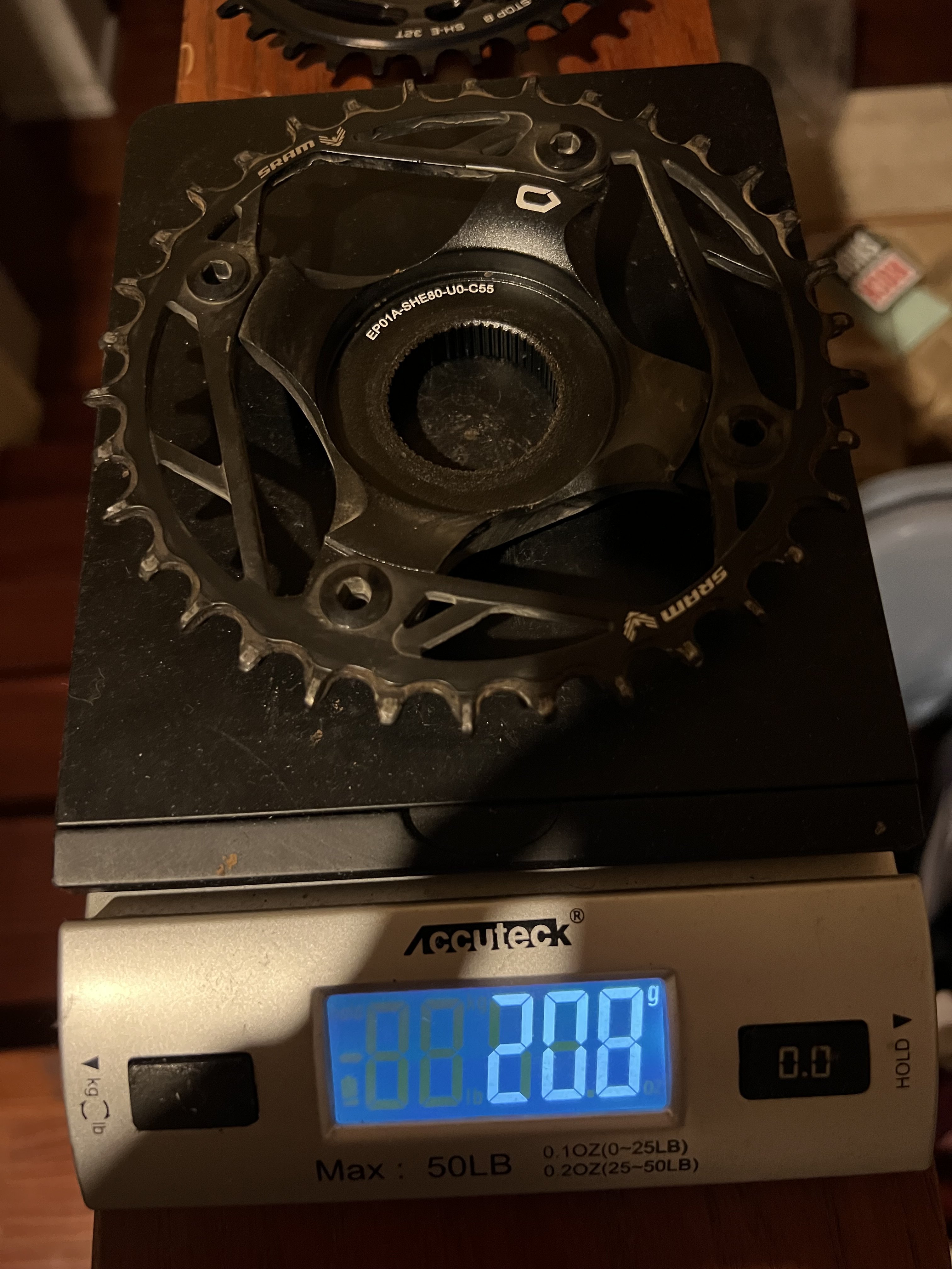

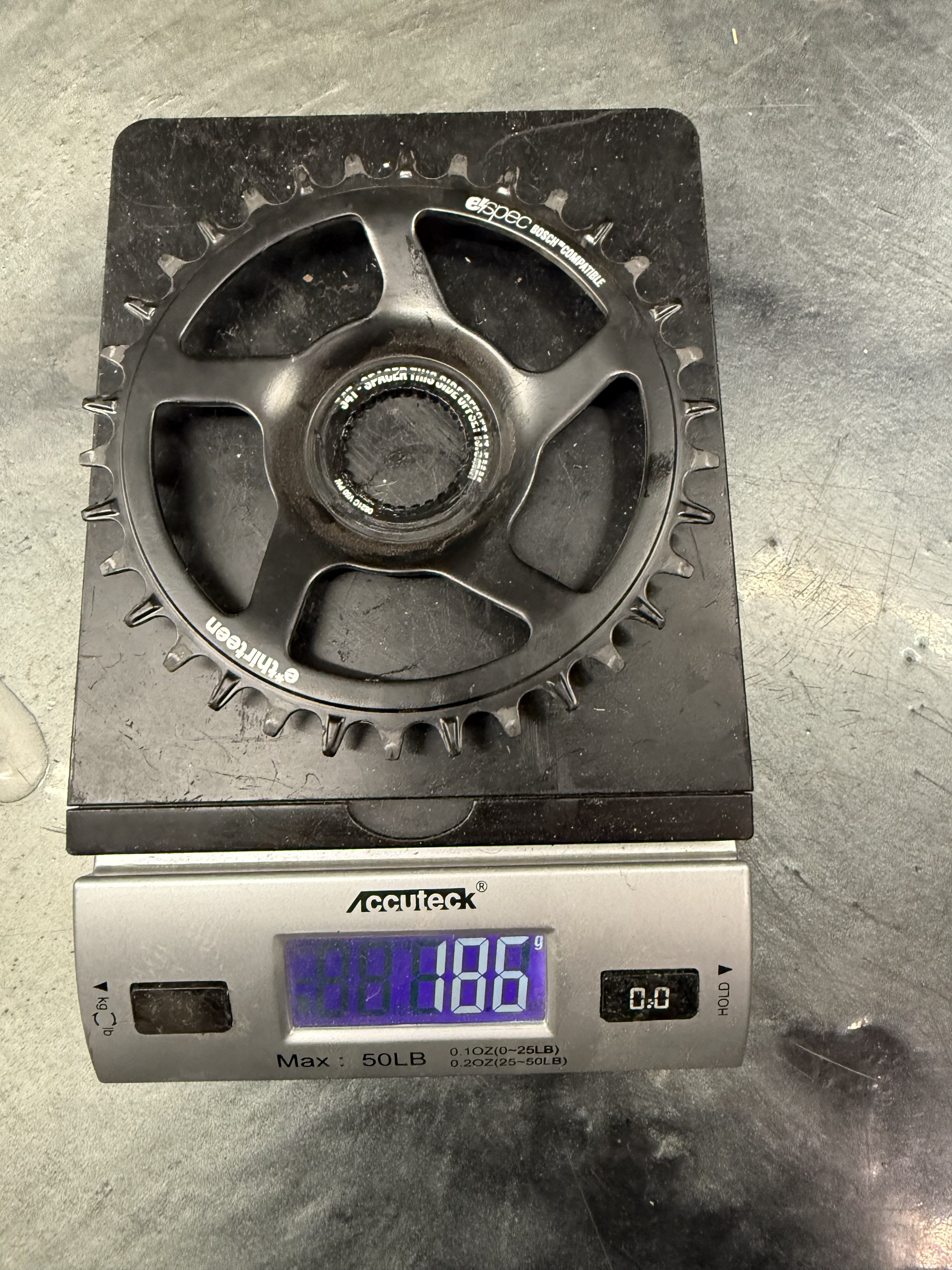

Did anybody ever find a one piece chainring or is everybody stuck using the 104BCD spider?
I usually replace something like this for a 100g one piece $80 alloy chainring. Sure steel last longer but most alloy 36t rings will last 3000 miles. Plus I’m a weight weenie 😆
I didn't look, you have to know the Avinox drive spindle/chainline specs. I'd hope they stick to an existing standard like Bosch and in that case you could certianly find a one peice.

I Did this on my new Trek Rail with Bosch Gen 5. It came with a Steel e13 chainring so save 80-90g

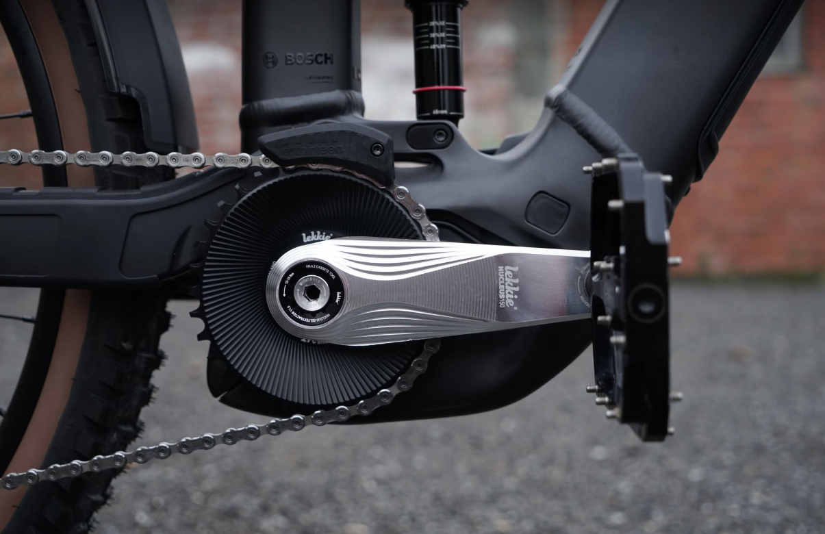

You can also try Lekkie if you want a funky ring.
117gram. I think 34T max.
It doesnt show on his web site. Hit him up on fb. I think he's just about to release them and up date the website.

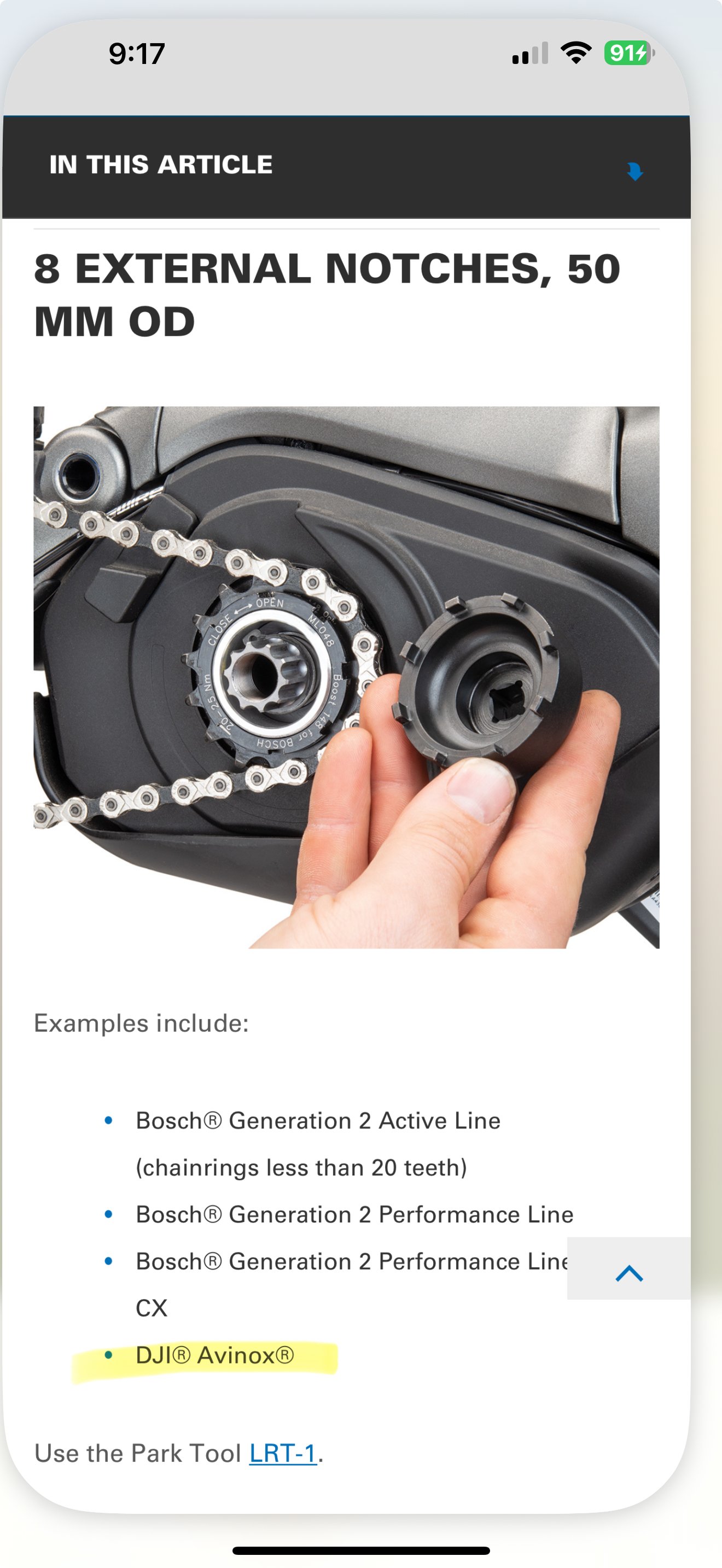

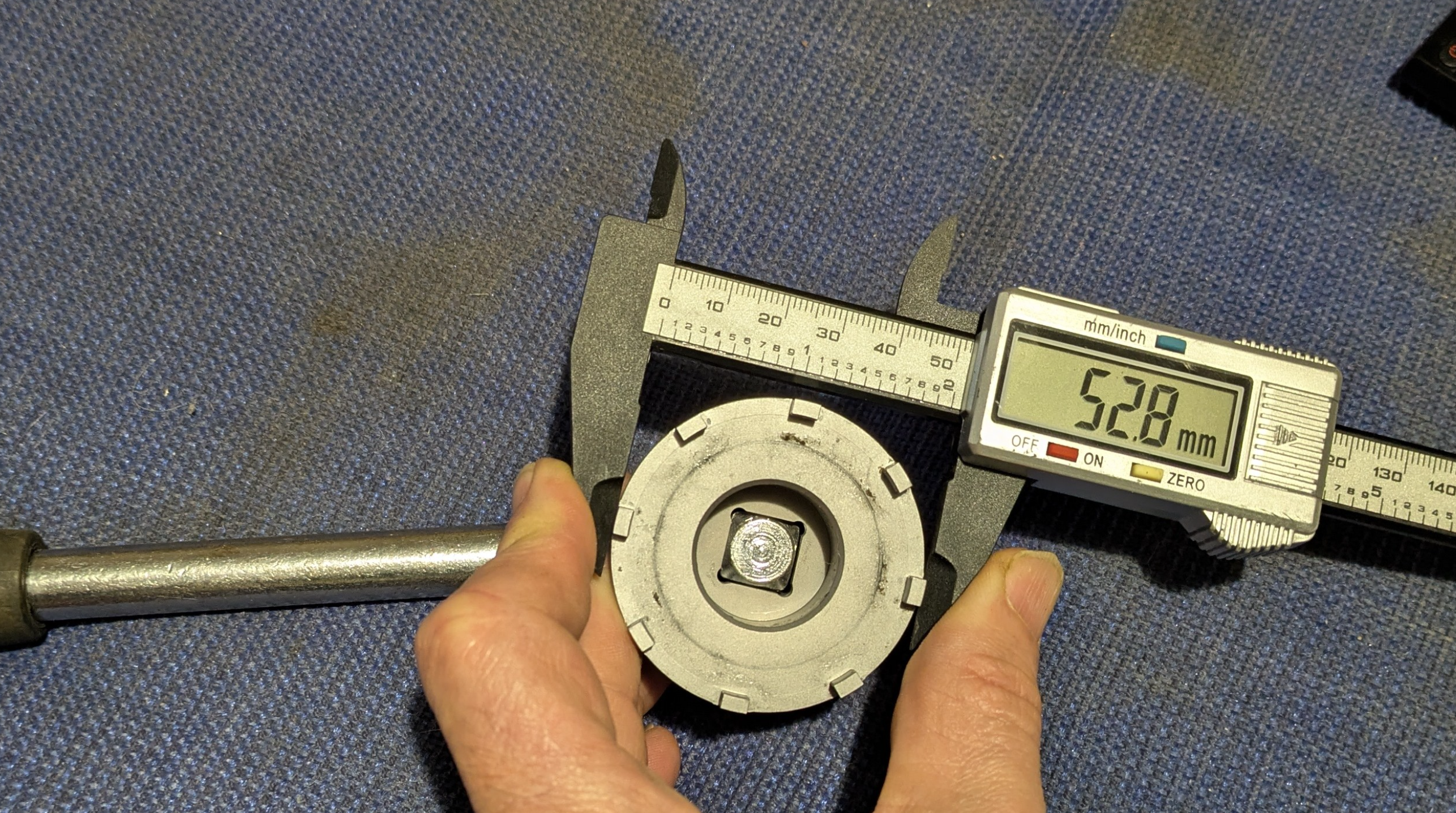

That won't fit. It's a special tool. 53mm outer diameter. I bought the last one from this company.
I don't think that will fit. The lockring, which sits flush against the edge of the lockring tool, is definitely 53mm diameter. And the inner teeth diameter is 47.2 mm.
The Bosch lockring is definitely different. The DJI lockring does not have a Left Hand Thread. Maybe someone can be the guinea pig and try it.

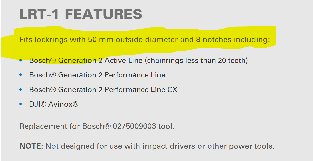

The 50mm refers to the lockring outside diameter, not the tool.
The Bosch Gen 2 tools teeth are as you say approx 47mm inside diameter so will fit the notches in the lockring.
I said the locking was about 52mm diameter previously. I have measured my locking. It exactly matches the tool. I wasn't going to remove my locking to take a photo.
But sure. The teeth on the 50mm Bosch locking could be smaller. But the Park Tool and the Amflow tool, are different. So I am telling people to be cautious, and just get the Amflow Tool if they can.
I can 100% confirm it fits. Rob has also put out a video using the Amflow Tool.
BTW. I also asked Amflow support about the Bosch Tool. And they said to use the Amflow Tool, as any damage from using the Bosch Tool, may void my warranty.
Park Tool usually has their shit together. The ring only needs 25nm, jam a couple screw drivers and long nose pliers in there and you'll be fine.
