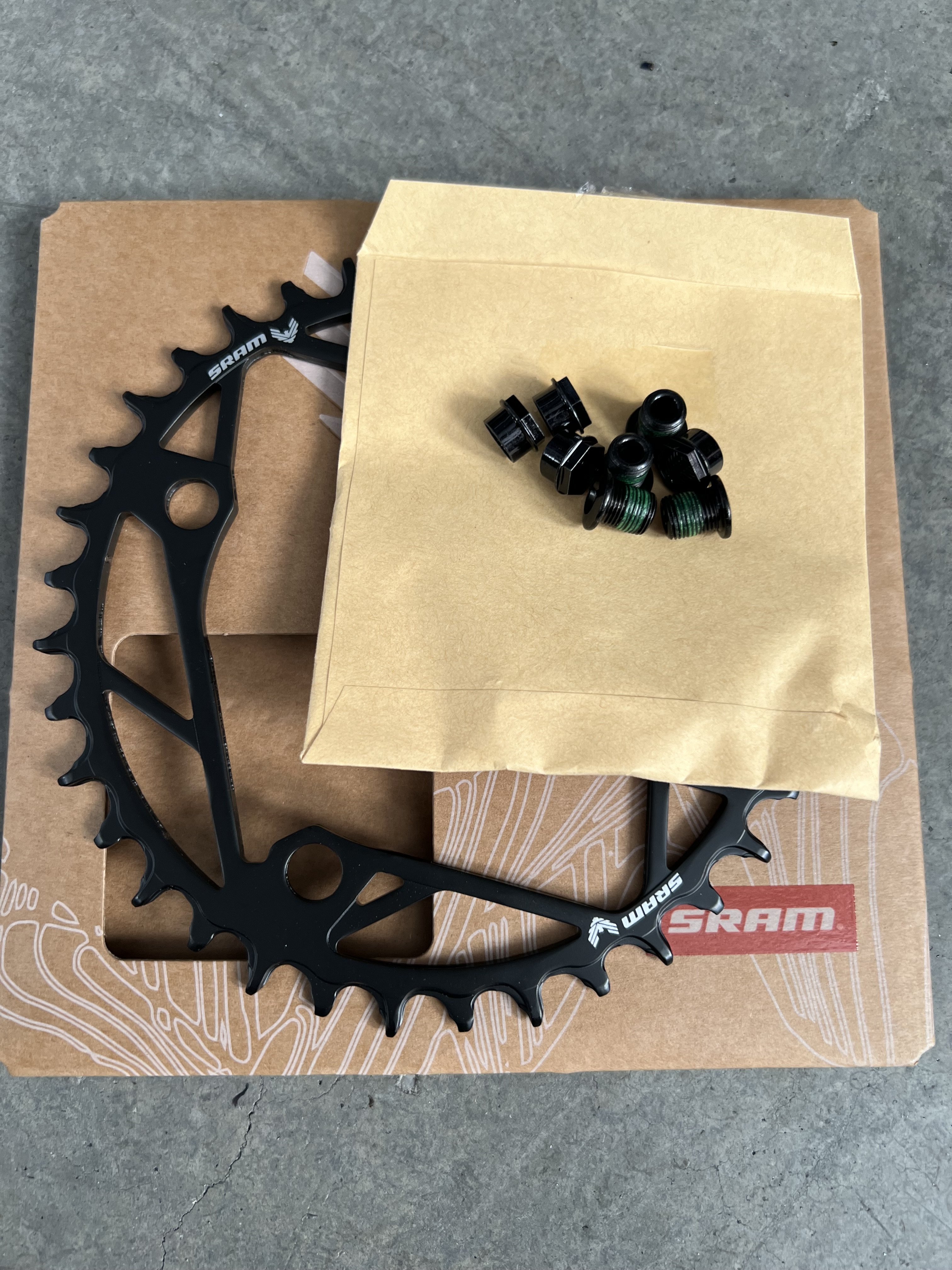

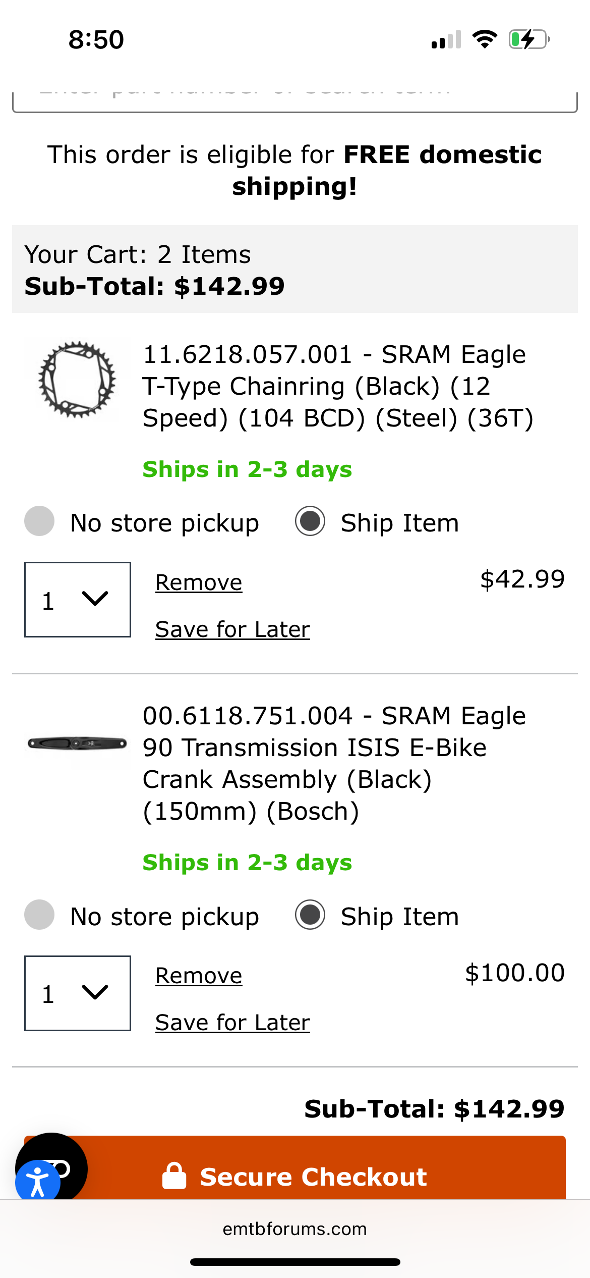

Hey Rob do you have any insight on the best chainring / bolt length to use with the included DJI spider ?
What I have waiting to be installed.
Thanks , do you know if the bikes come with the nuts / bolts for the chain ring? Trying to figure out if I need a 6mm length or something different .
I would hope the DJI spider comes with the bolts to hold the chain ring on.

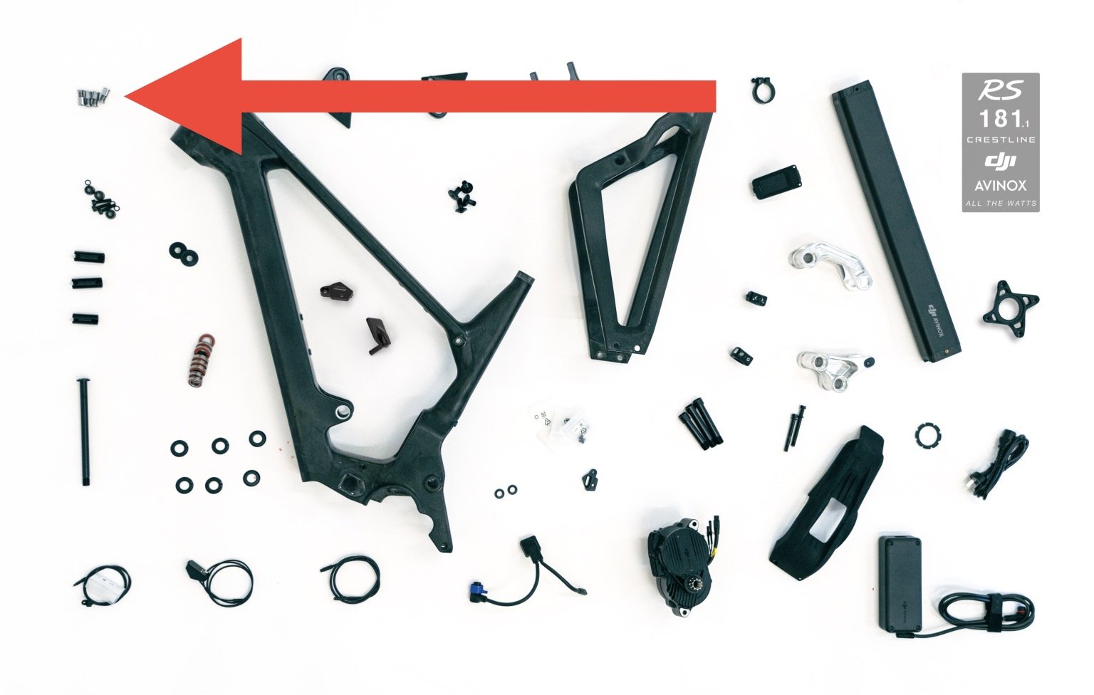

This picture shows what’s included.

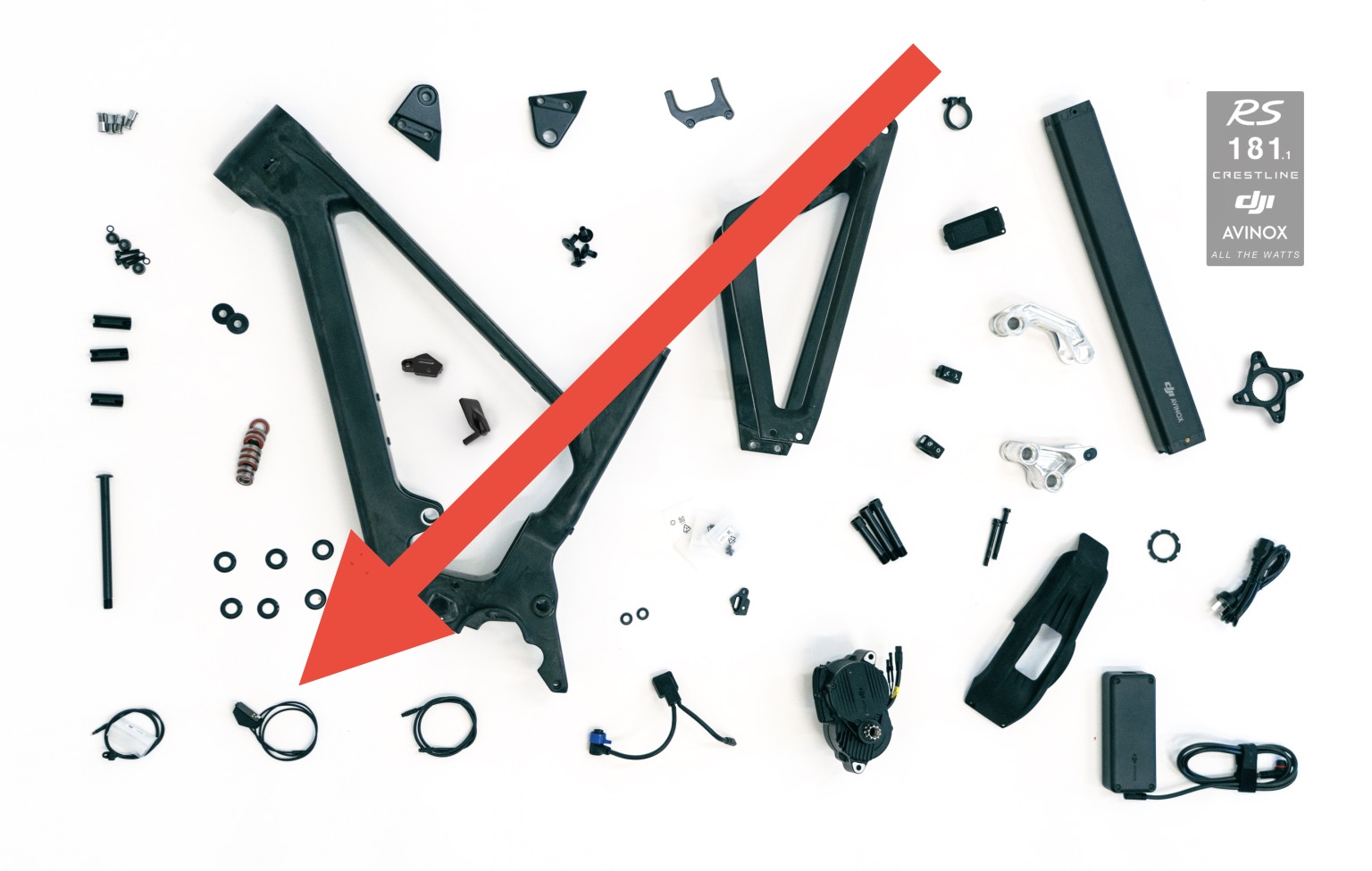

Which now brings me to another question……does our frame set come with the SRAM T-Type power cord?! Look closely in the pic, do you see what I see?!

- Most chainrings come with chainring bolts to fit standard thickness spiders (the SRAM T-Type 104bcd does), which I'd guess the spider is. Only a guess. Also, don't forget you'll need a locking tool to get the spider off. Looks like Avinox uses the same as Bosch gen2.
- Ugh, after all that back and forth it DOES look like it comes with the Sram power cord.

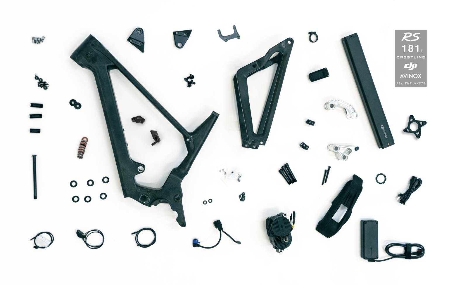

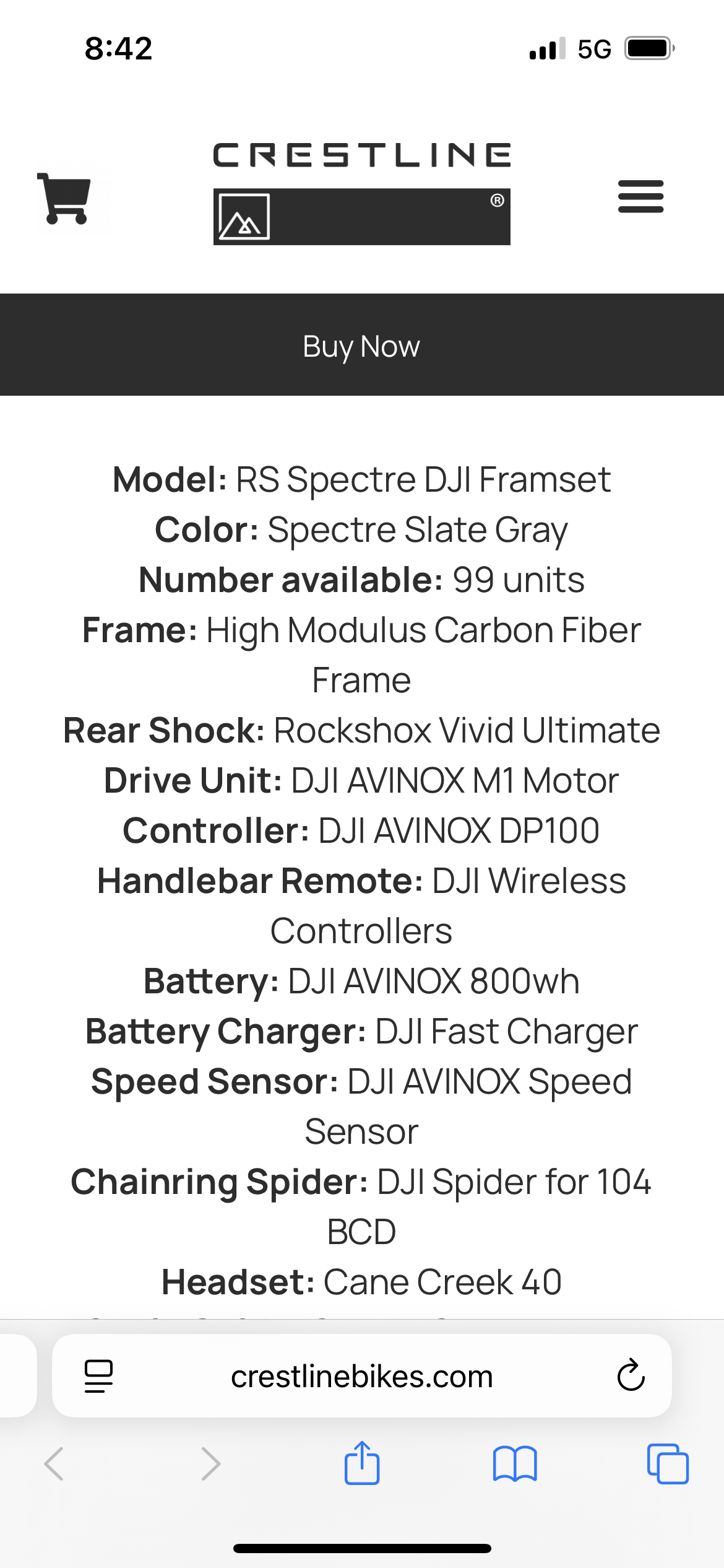

Do we know if the frame will be shipping with the headset? The website indicates "Watts in the box" includes Cane Creek 40 headset, but I don't see it in the parts diagram.
It should like the bosch gen 5 frameset. It comes with a shock but not pictured.

They don’t list the the power cable in the parts list on the website. I would love for that to come pre installed though
This is what is stated it comes with.
I highly doubt the SRAM T-Type power cable comes with it, that’s $150-$200 for a part that not everyone could utilize. I’m guessing it was a mistake that it was in the parts picture, I’ll ask Troydon.
You're probably right, or at least I'm hoping since I opend the package. lol
