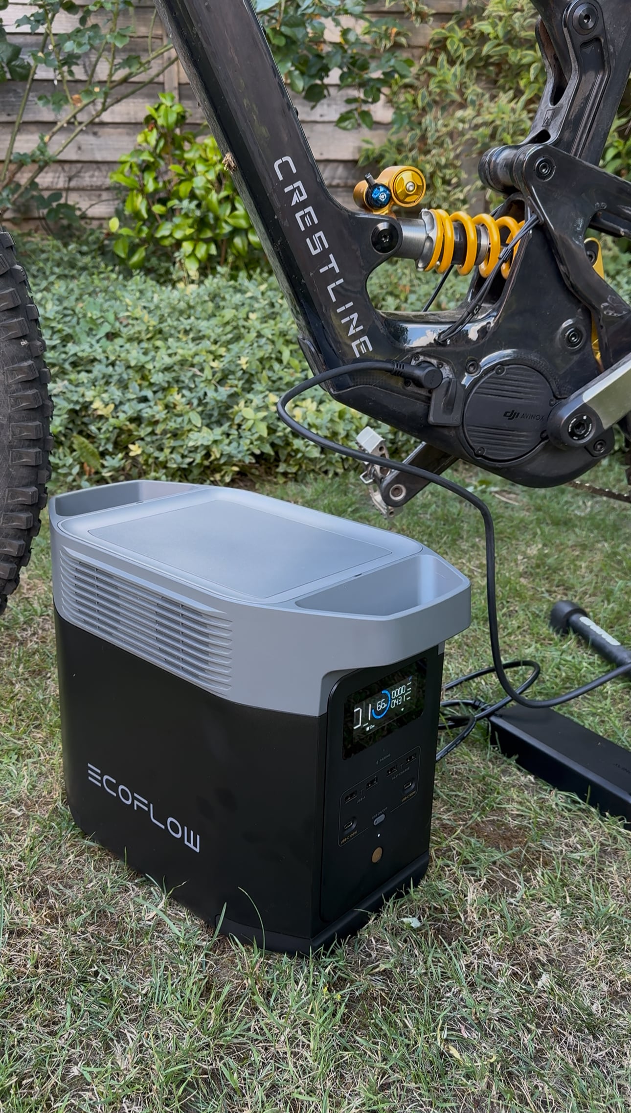

I got this EcoFlow Delta 2 portable power station. It charges the 800wh bike battery at a rate of about 1% per minute, and it’s going on the boot of the car. Easy 40-50% lunch time battery recharge using the fast charger.
I'll admit. I would probably giggle if i saw that at the bike park. Practical as hell if you don't have a second battery or an integrated battery.... But I still..... that is next level, It probably needs to be sitting next your Porsche while you sip your double frappmockaawankerchino.
If I don’t burn through the 800wh on my typical rides I’ll look into getting a 600wh battery to try. It would be nice to have two different Wh / weight batteries to swap out.
Two batteries are the business. Crestline is a bit fiddly to change over. I've got it down to 5 mins.
800 and 600 would give you mega capacity for a days riding.
Yeah that’s ideal.
The portable charger is a fair alternative if it fits in with your ride, and is cheaper than a second battery (£499)
When you get a chance Rob. I'm interested to know what wh/hr the dji burns.
EG you used 50% of 800wh battery and it took 2 hrs. 400wh/hr.....
I couldn’t find any information how to charge dji batteries outside the frame. Has anyone got info? And when they will be available to order separately?
Sure. I’ll check it out on the next ride. It’ll be very mode dependent of course, I’m still experimenting with which modes to use on longer rides.
Good question. Not tried charging it off bike yet! I asked DJI about buying spare batteries and they mentioned that they will be able to be ordered from DJI dealers in the future. No solid date yet, but it’s coming.
I'm like Rob. I keep an Ecoflow in the car. But I've got a lighter smaller unit at 768Wh. But because I have an EV. I can charge the Ecoflow, whilst I'm charging the bike. So on my lunch break, with the Avinox 12Amp charger, I can add 40% without any issue. More if I take a longer break. And for overnight trips with no power outlets, I just leave the bike in the car charging. It does eventually get to 100% as the car recharges the Ecoflow.
I do seem to be burning through more Whrs with the Avinox system, than on my Shimano EP801. You just travel so much faster. So, I'm not sure 800 grams saving is worth the reduced range, but that's your call.
I wasn’t wanting to get the 600wh for extra range, swapping out with a dead 800wh. I was just thinking it would give me the option of installing a slightly lighter/lower weight battery if I knew the ride I was going on that day wasn’t going to be a long one. Unfortunately I typically don’t have time to spend more than 2.5hrs on each ride. Which typically takes the Bosch 750wh down to 25-40% left.
After a few rides with the 800wh DJI I’ll know if the 600wh would even be a possibility…..I’m guessing not since I really enjoy techy steep hill climbs, which sounds like the DJI will suck the battery down doing so.
Ideally it would be nice to try the 600wh battery for one ride before having to shell out the money for it!

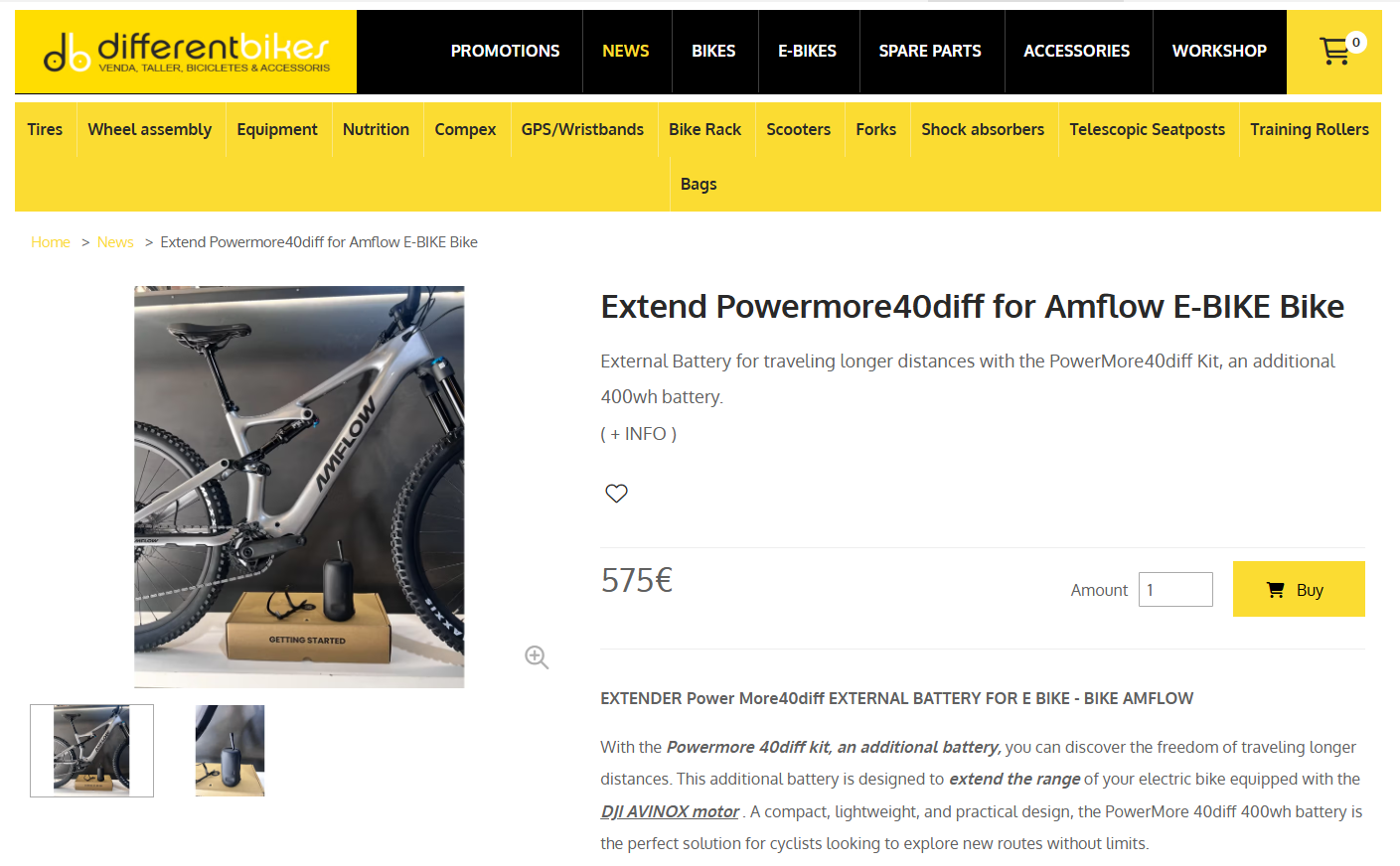

Just be aware, as Rob said. There is no facility currently to get another battery, unless it's a warranty issue. So whichever battery you choose. You could be stuck with it for a while.
I will mention that there is a Spanish company that claims to have a range extender for the Amflow. But details about it are very scarce. They will let you order it. About €550. But I wouldn't recommend it, until there are more details, like how to install it. It looks like it plugs into the charging port.

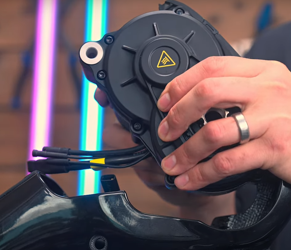

Hi Rob,
That's awesome!
I have a Dji Crestline on order. Which Dji motor accessory port do I connect the AXS cable to exactly (got pics)?
And do I need a wiring adapter, or can the AXS cable directly connect to it? Thanks in advanced.
Hi. This is the exact part. Same as the SRAM powertrain cable. Nothing more needed. Plugs straight into the motor.

Hi Rob,
Is it safe to assume that there's only one open port/wire on the Dji motor? I want to make sure that I don't connect it to the wrong port/wire.
Thanks for the assistance!
Four cables coming out of the motor. It will only fit into one. The other cables, Power, Controller and Speed Sensor should be used, anyway.
