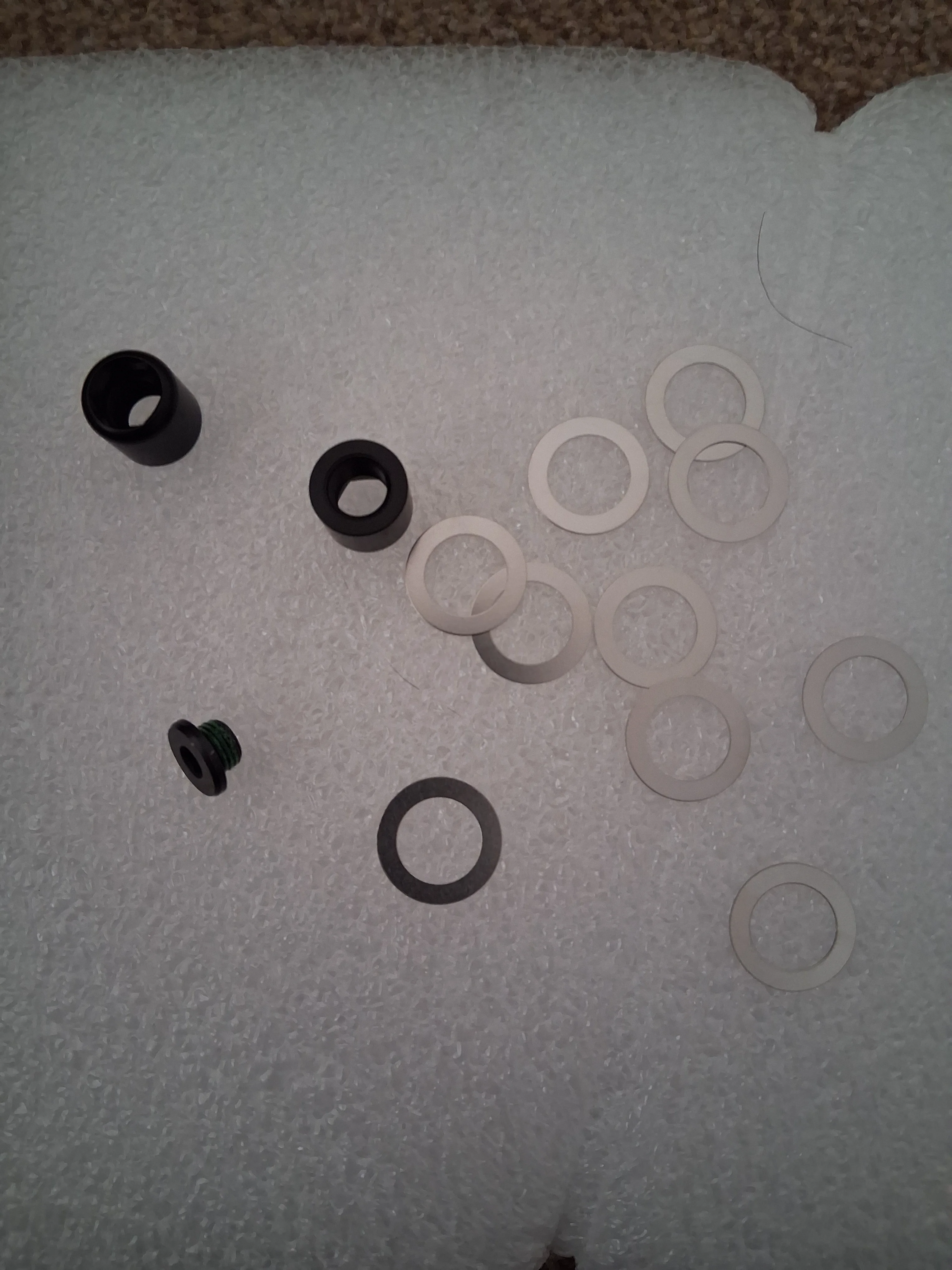

Spare collets and washers for the rear linkage, not sure about the small screw.
Hi ,thanks for that,small screw must be spare for something i guess😁
Looks like the same style as the dropouts. Maybe an extra for the brake adapter? Whatever it is, its not meant to be removed often as it has green thread lock on it.

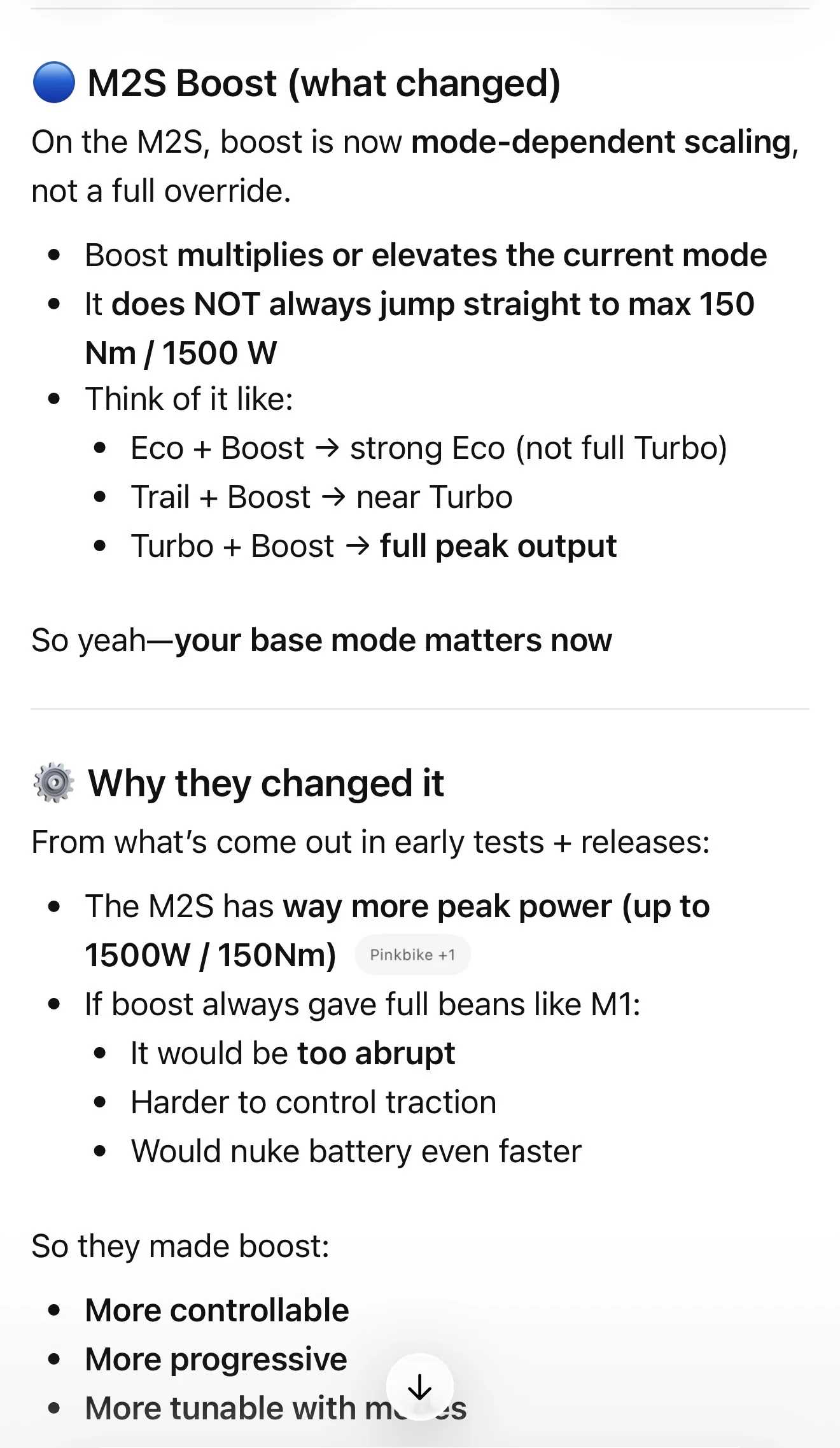

I thought I read/heard somewhere that the power of boost mode is dependent upon which mode you are currently riding in?View attachment 182688
Chat seems to agree
That’s interesting, i did not know that. I tend to ride in a detuned auto or eco, and when i activate boost I like having full power. I’d love to hop on a m2/s and compare the difference.

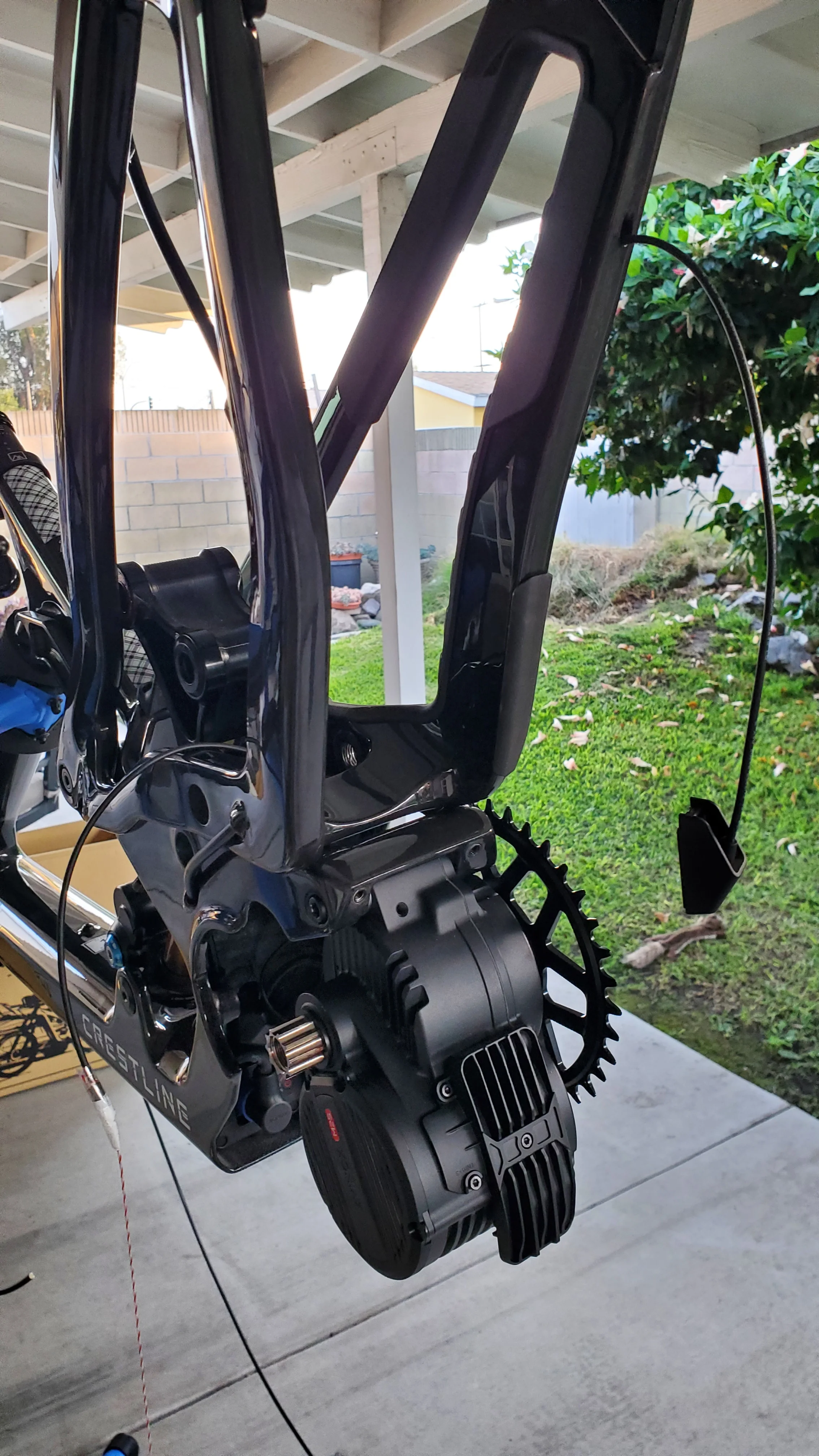

Long time rider, first time poster. My daily driver is a Gen 3 Levo and I also built up a Kenevo SL with a Fox 40 as an EDH rig. Retired the Kenevo SL and moved the 40 to my Crestline. A couple shakedown rides last weekend, hoping to get out of work for some weekday laps. Almost done, just waiting on a new I9 wheelset.

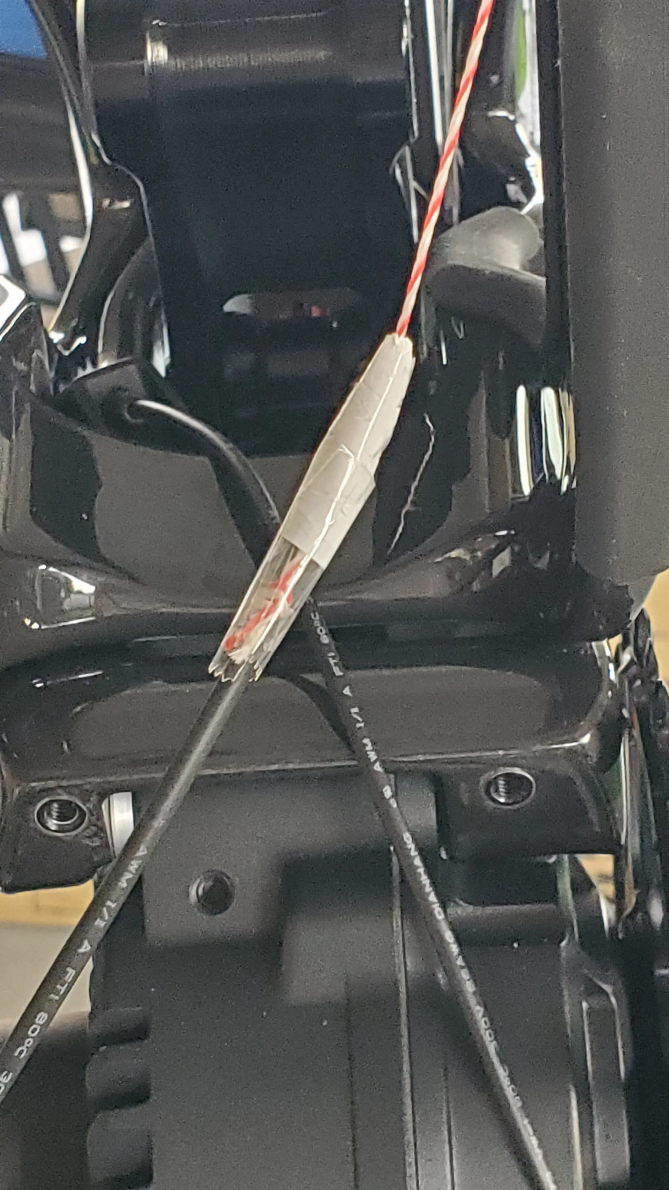

This thing looks beefy with that 40 on there! If you or anyone still needs to route the axs cable (noted in your pics), I will share how I did it.
FIrst use the plastic guide to fish a strong string with extra length to work with for some real fishing. Then tie the string around the connector to hold it while you pull it through. Then I wrapped some plumbers tape to hold the string inline with the connector and create a coned shape. Lastly covered it with shipping tape to keep it together and smooth. Use a little tape as feasible to keep it slim of course. Here is the setup, worked first time no issues.
Pulled it right through, easy peasy!

Did you have some washers and small collars in a bag in the charger box of accessories?

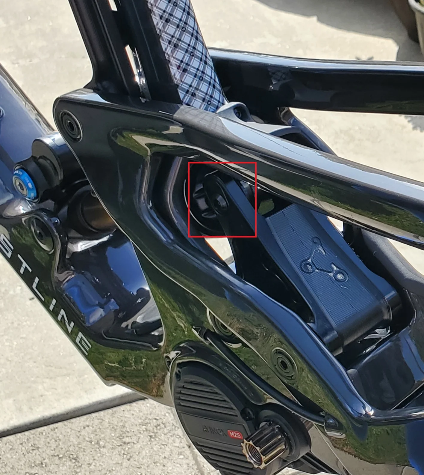

In case anyone missed the critical build note from Troydon to avoid FRAME DAMAGE -
Troydon
said to ensure the all frame rear shock mounts get some blue thread lock going as a crucial step of the build.
If this bolt comes loose the rear of the frame could get damaged, give it some blue locker TODAY:
Troydon
Can confirm, that bolt comes out VERY easily.

I just watched these videos on Avinox-ebike site. Very helpful. Apparently there is a “boost local enhancement” option that needs to be toggled on, or boost mode wont work. I have to watch it again because it sounded contradictory.
Check it out. Its in the first video.
My hole near the motor was small, almost the same size as the connector head so it was quite a pain in the butt.
I of course tried it with the plastic guide which broke, then i had to go back and fish through some shifter cable which fortunately i was able to grab out of the chainstay with needle nose pliers, then did the same tape job you did and had to use a tine screwdriver to align the head of the connector so it was exactly aligned with the little hole and was able to muscle it through.
It took me almost two hours since there was some repeating of the process when the first time i taped it to the shifter cable the tape pulled off and i had to do it again...
Long story short, do not use the plastic guide to pull, either use strong string or a shifter cable, and check the size of the hole near the motor so at least you can see what you have to pull the connector through!
Hey, I'm having the same issue with my new M2S Crestline. Once I activate Boost, feels like it falls flat on it's face. I've been researching and it sounds like only bikes equipped with the PF700 watt hour battery gets the full 1500 watts.
Have you been able to fix your lack of boost problem?
I haven't had a chance to test it spinning high rpm as John described.
That's not correct. With Boost Local Enhancement turned on, you get a more powerful mode that your in, not the straight shot to the 1,500 watts. Like if your in Eco and hit Boost, you get Eco+. With this turned off, and you hit boost, then that takes you straight to the 1,500 watts. Then when the timer is done, you go back to the mode you were in.
I don't think you'll ever get to 90RPM when your in the fall flat on your face boost mode. Feels like your in ECO, now try getting 90 RPM out of that, maybe on a steep downhill.
Im new to avinox ,finding this confusing,im going to be running 800wh battery,so is the 1300watts mentioned in boost or constant🤷
Not the way I was testing it no. I've only ridden one other Avinox bike and when I hit the button it felt like turbo+ mode for the 30 seconds, and I don't recall having to spin my legs off to feel the extra boost either. As it is now as soon as you activate boost the power is gone regardless of what mode you were in. The power comes right back when canceling it.
