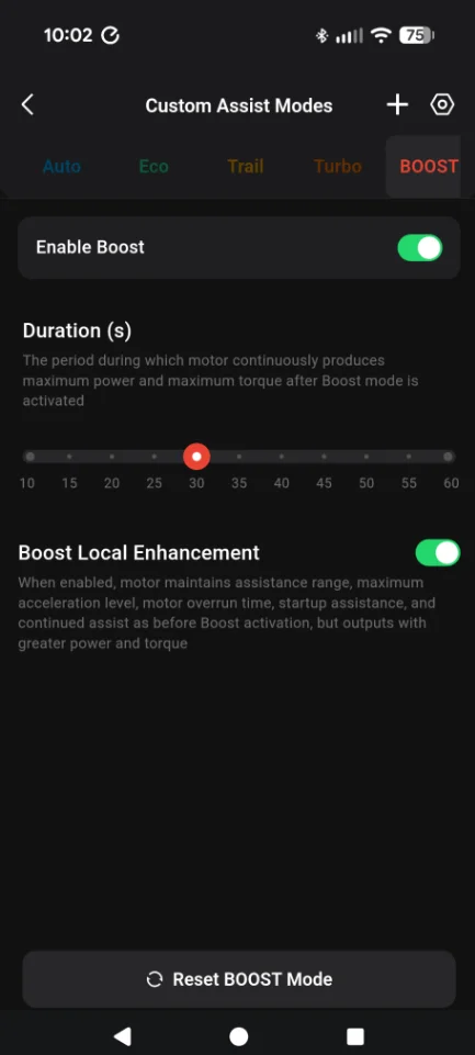

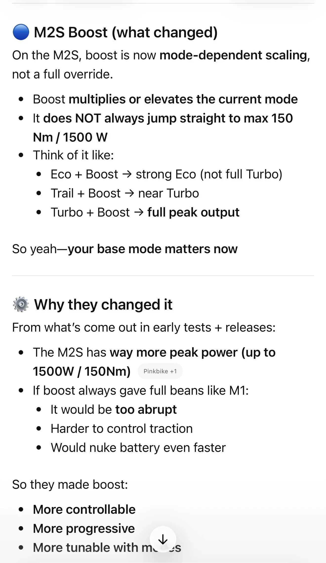

I don't think my boost mode is working correctly after enabling it. It feels like it drops to eco mode when I activate it. I did a quick look though the settings but everything seemed normal, anyone else tried it yet?

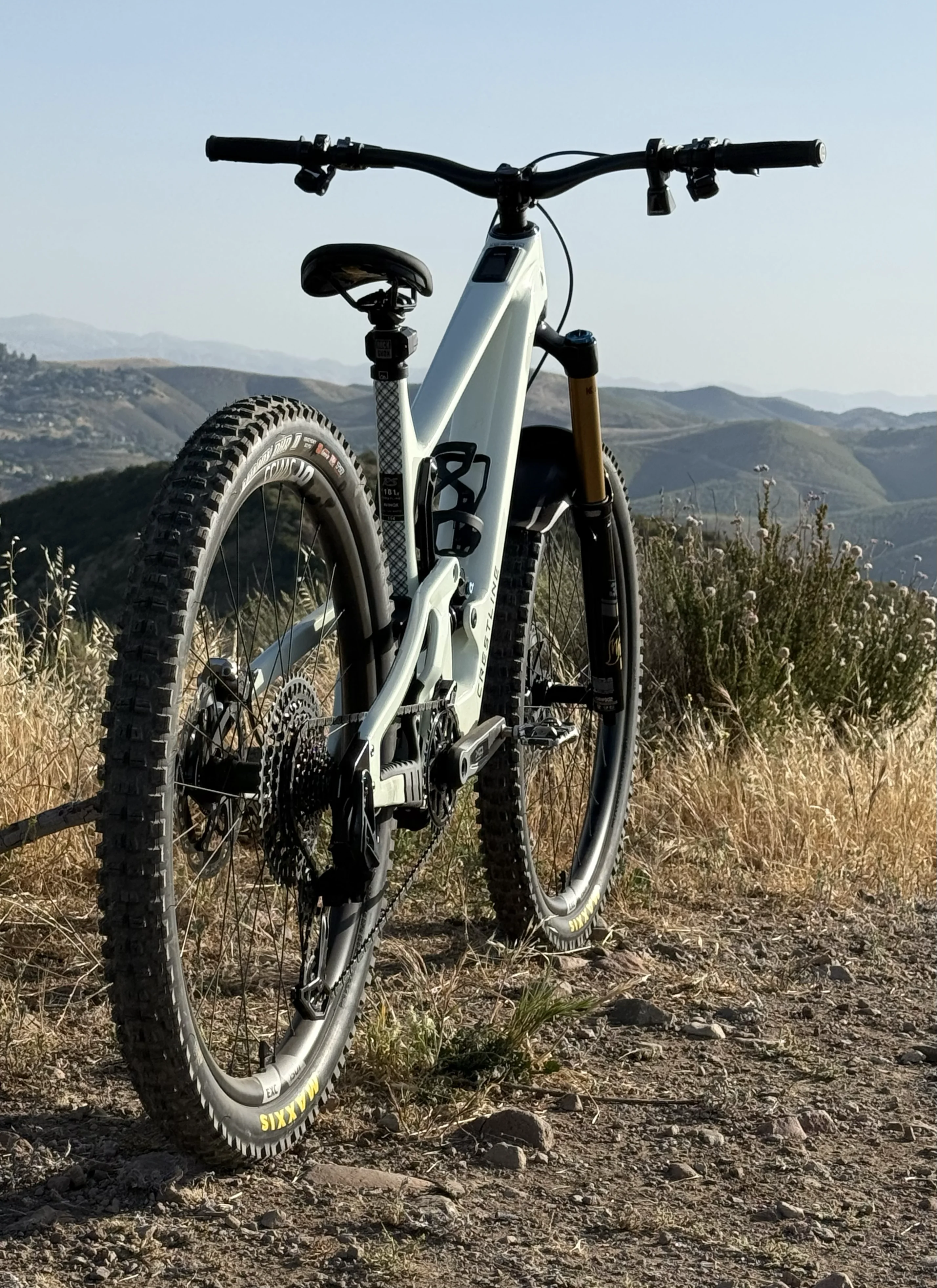

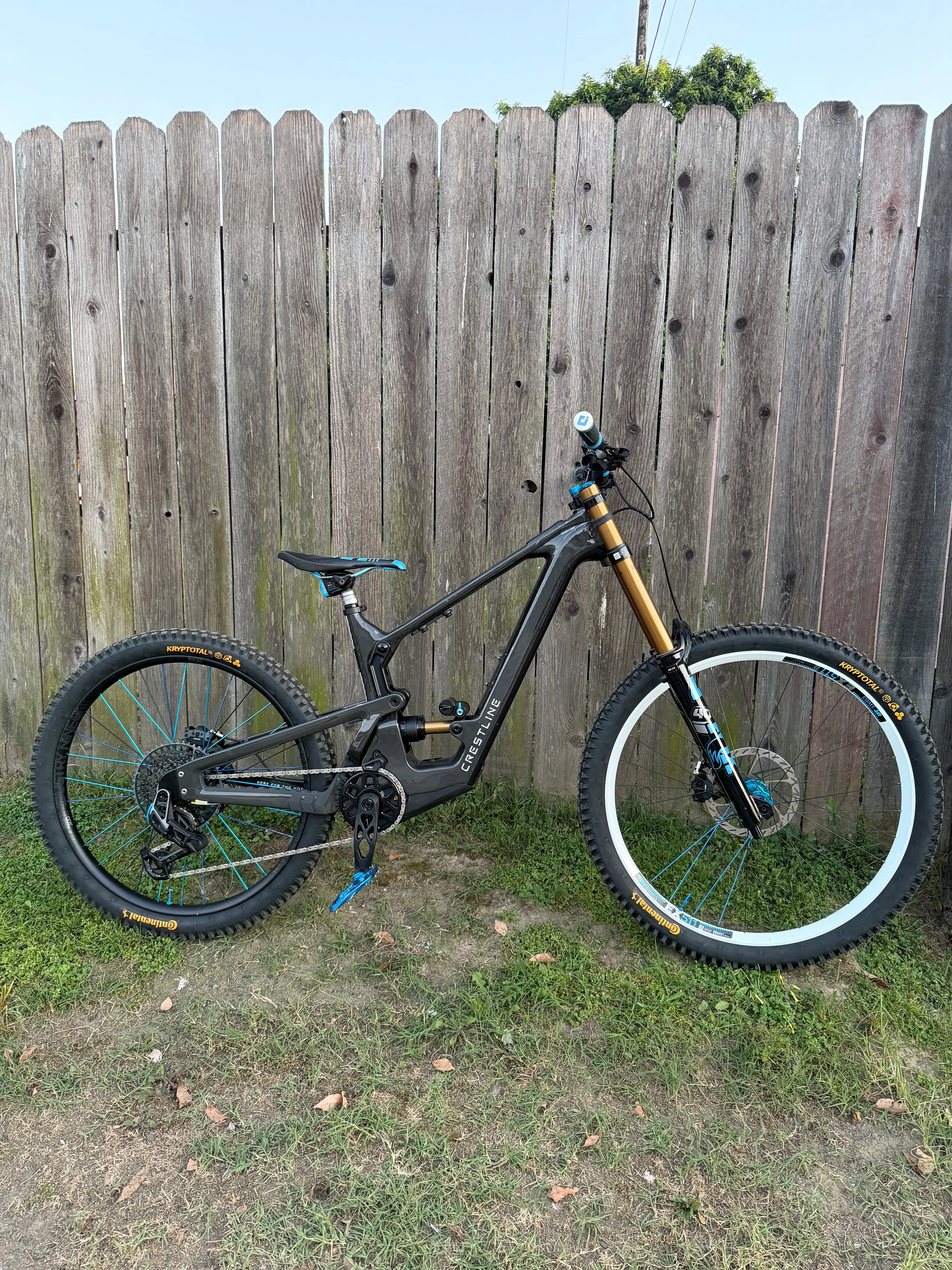

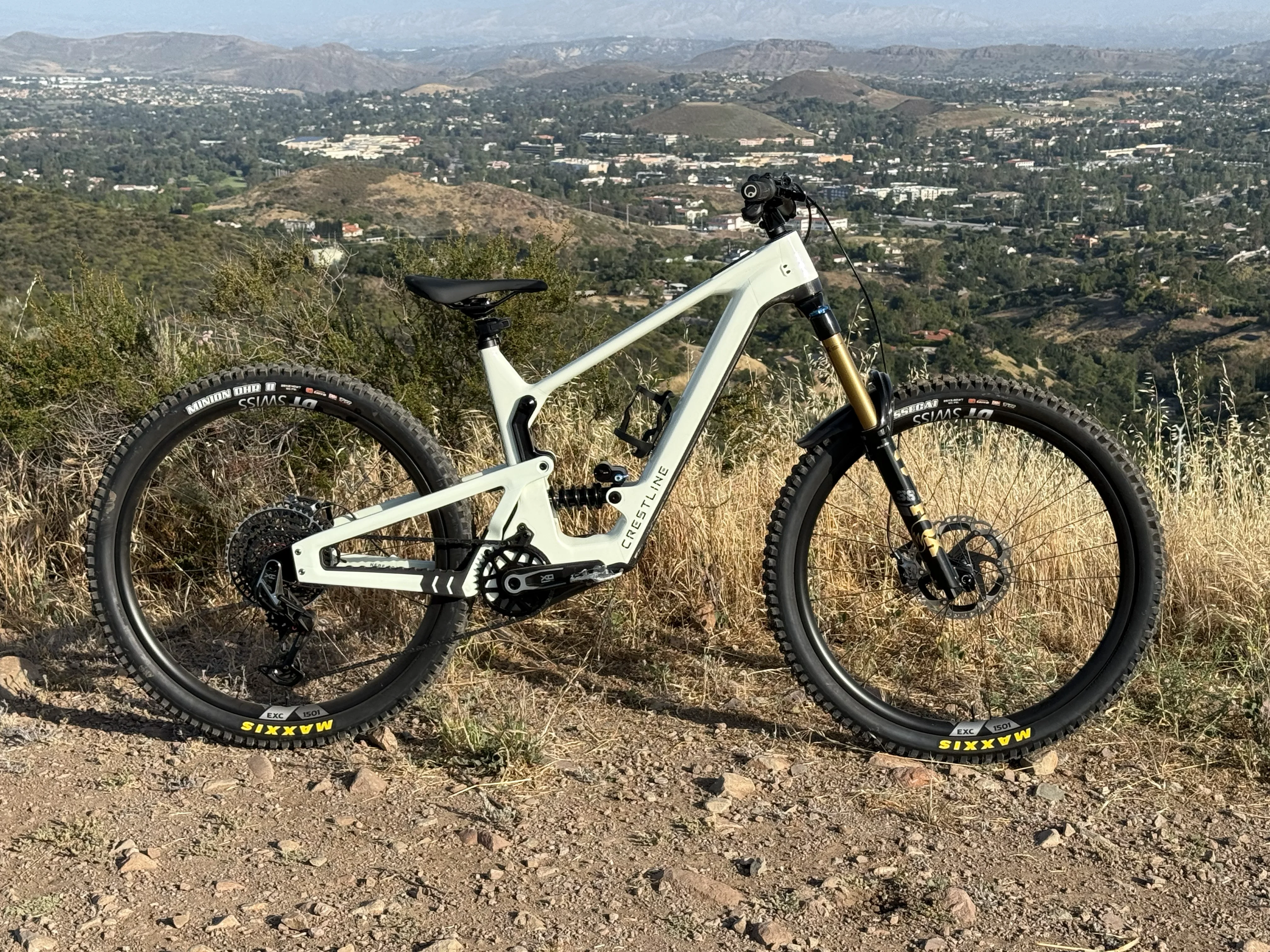

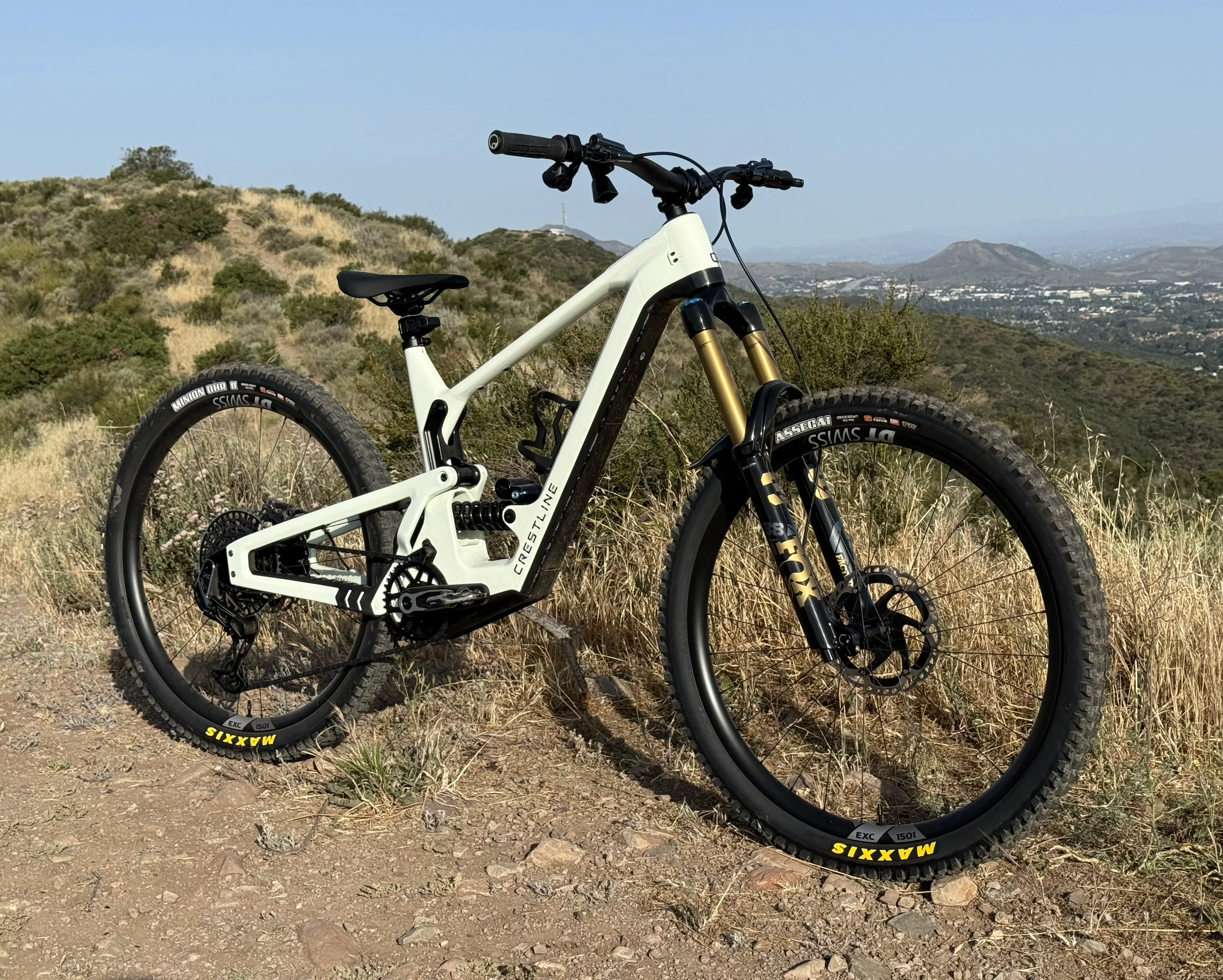

Long time rider, first time poster. My daily driver is a Gen 3 Levo and I also built up a Kenevo SL with a Fox 40 as an EDH rig. Retired the Kenevo SL and moved the 40 to my Crestline. A couple shakedown rides last weekend, hoping to get out of work for some weekday laps. Almost done, just waiting on a new I9 wheelset.
Plaid 181.2 #93 RH2 Fox Factory Float X2
Fox40
Maven Silver
SRAM XO Transmission
SRAM XO cassette
SRAM GX chain
Continental Kryptotal
RockShox Reverb AXS
Deity Saddle
Deity DH Carbon Bar 25 degree/800mm
One Up Pedals
Big Thank you to Troydon! True to his word, my frame was delivered early on April 11.
Tried out Boost mode a few times and it definitely has way less power than turbo. Checked my settings and looks like it should deliver more power, but it does not. I'm guessing we don't have it correctly set up.
I thought it would just be max power when it's activated. There isn't really any setting to adjust like the other modes. I tried with with and without local enhancment.
That sounds odd, I can’t speak on the m2 motors but my m1 has a noticeable jump in power when I activate boost. Really can’t imagine that would be different on the m2’s

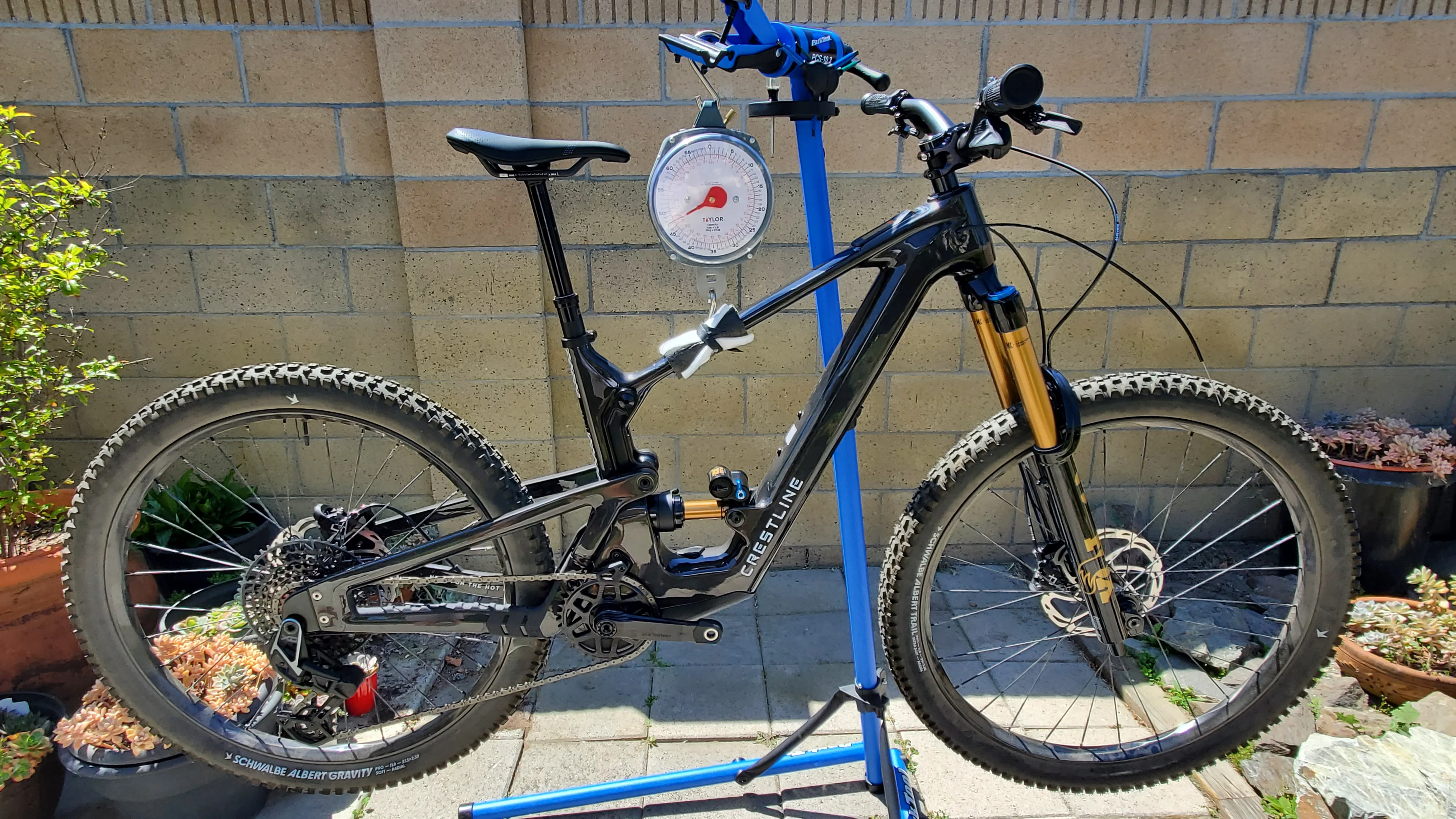

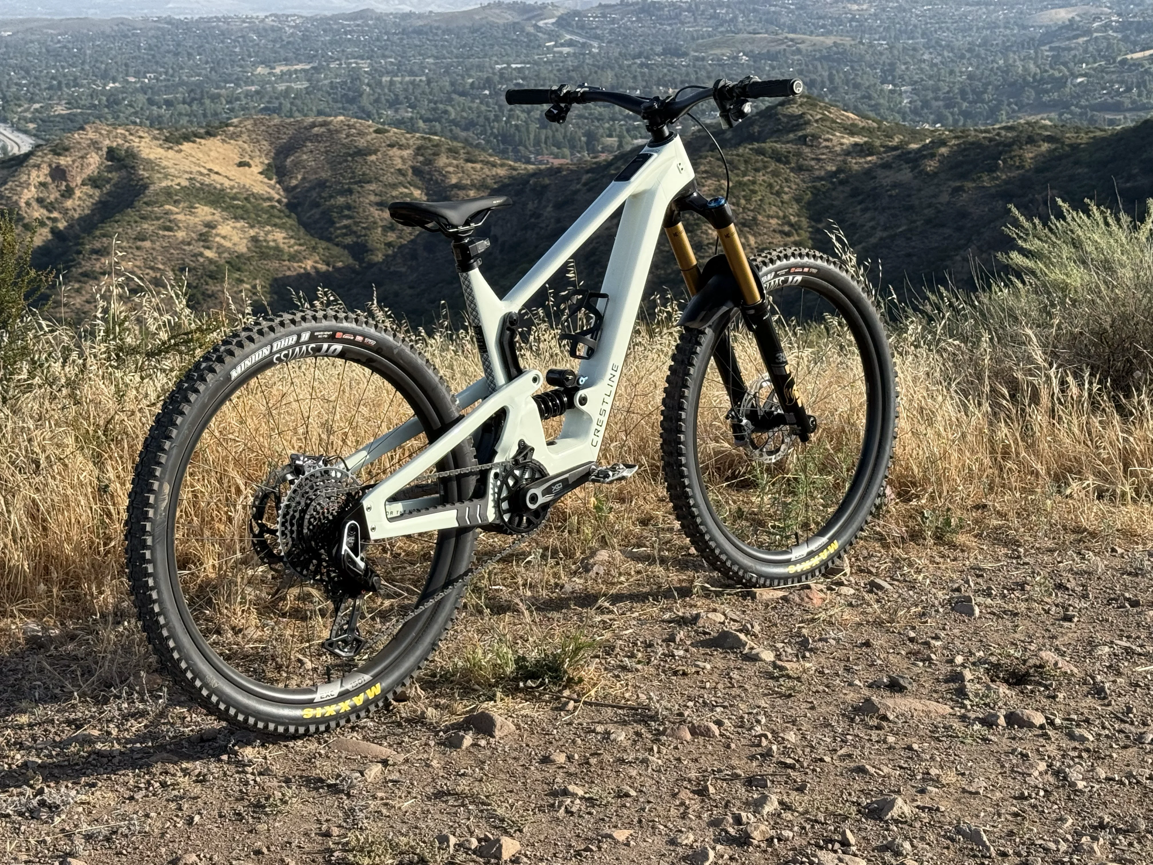

Build is mostly complete, just dropped her off for the ridewrap install. Found a good deal from a reputable installer that will have it done by tomorrow so I guess I can wait one more day for Plaid magic..
The obligatory weigh in without pedals came to 47.5 pounds on this scale!

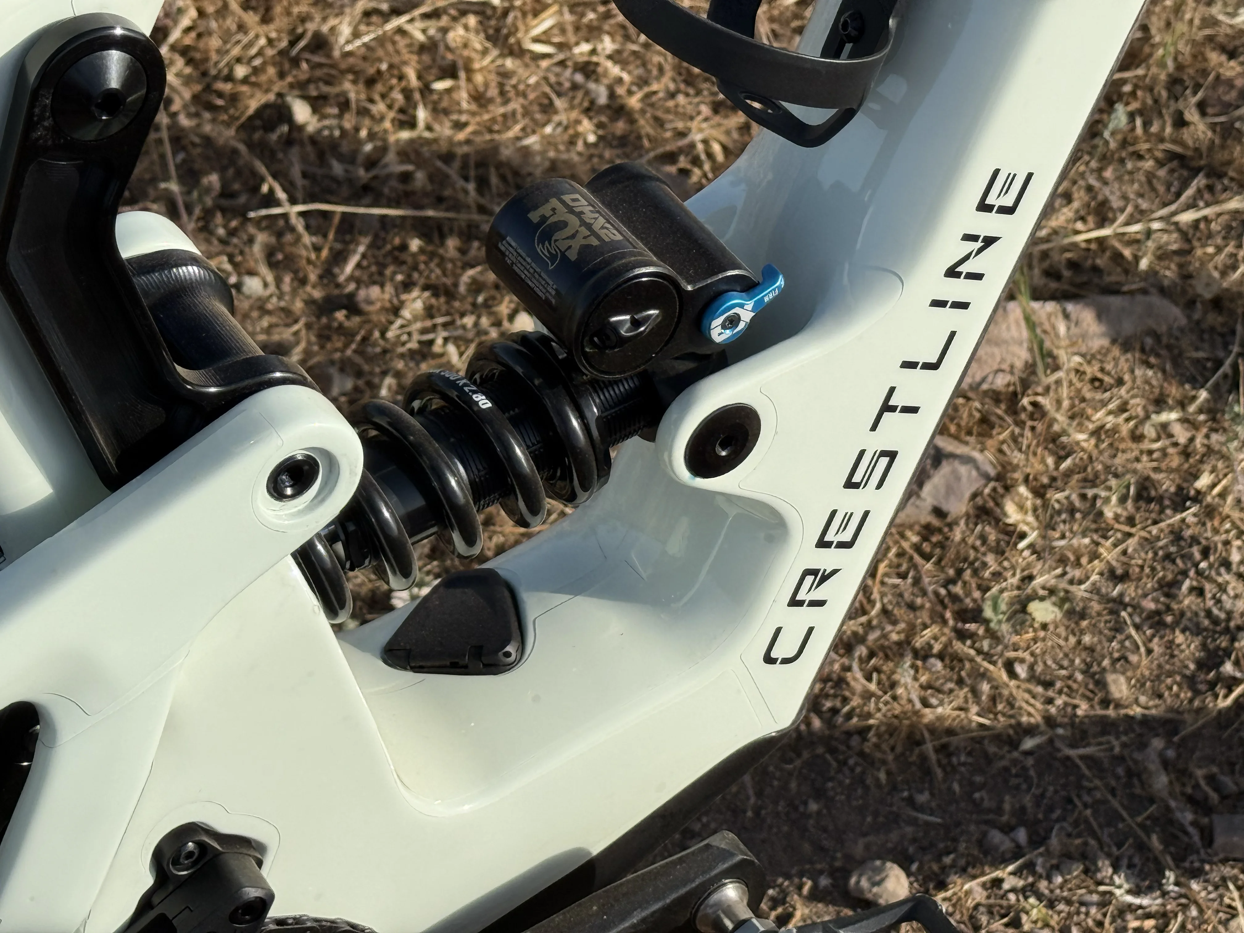

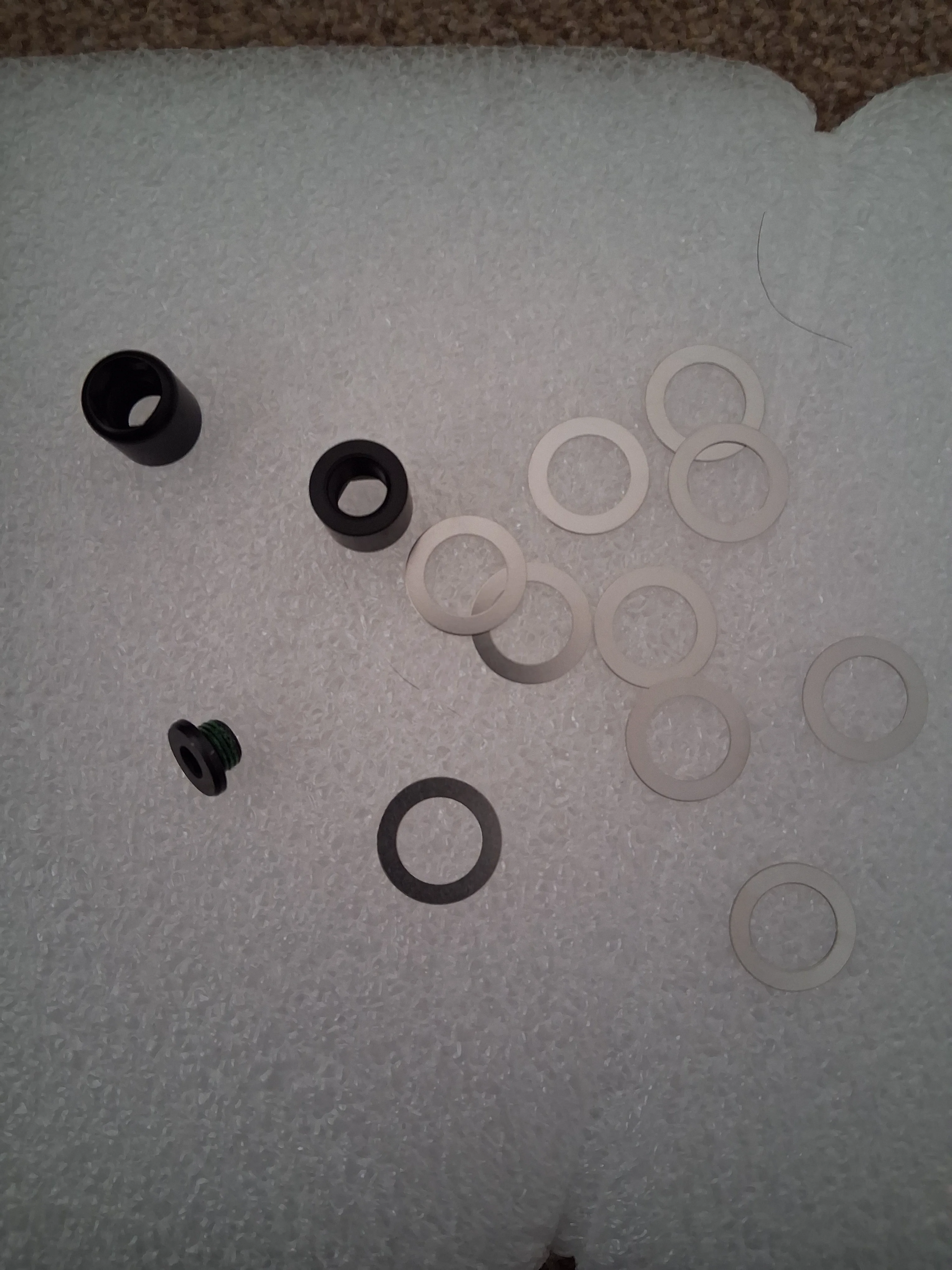

NOTE: CRITICAL INSTALLATION TIP
Bike shop told me Troydon said to ensure the all frame rear shock mounts get some thread lock going as a crucial step of the build. If this bolt comes loose the rear of the frame could get damaged:
Do this NOW!
This wasn't the case on the M1 bike I rode. When boost is activated it feels like the bike basically falls on its face.
Technical Climbing​
Mode Selection: Utilize Boost Mode on the Avinox system.
  • Technique: Maintain a high cadence (90-100 RPM). The FOC algorithm favors high RPM for thermal efficiency. Use the "Ratcheting"technique (partial pedal strokes) to clear technical rock steps; the motor's instant engagement will propel the bike over obstacles without a full pedal revolution.
I thought I read/heard somewhere that the power of boost mode is dependent upon which mode you are currently riding in?
Chat seems to agree

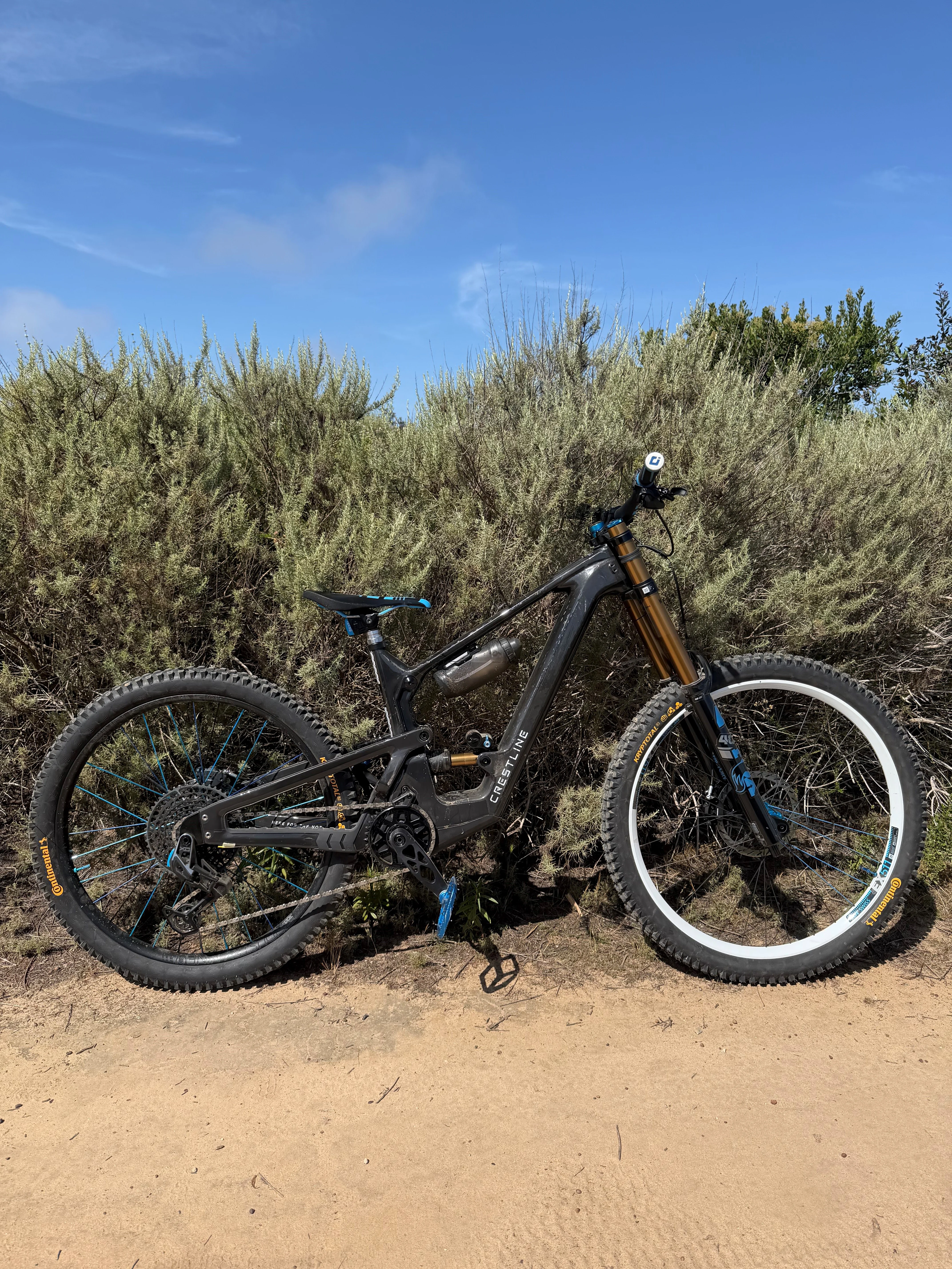

RH3, 800, 450cs, 29/29
52.1 lbs with pedals
REAR SHOCK 2026 Fox DHX2 Shock w/ Climb Switch - 205 x 65 mm
FORK 2025 Fox 38 Factory Fork - Kashima - 29" - Shiny Black - GRIP X2 - 180mm 44mm offset
STEM Race Face Turbine-R 35 Stem - 32mm
HANDLEBARS OneUp V2 35mm Rise Carbon Bar
GRIPS Ergon GDH Team
SADDLE Specialized Bridge Comp Bike Seat
SEATPOST SRAM AXS Dropper 31.6, 170mm
FRONT BRAKE Shimano XTR M9120
REAR BRAKE Shimano XTR M9120
FRONT ROTOR SHIMANO XTR Rotor RTMT905 6 Bolt 203mm
REAR ROTOR SHIMANO XTR Rotor RTMT905 6 Bolt 203mm
REAR DERAILLEUR Sram X0 TRANSMISSION T-TYPE EAGLE AXS E-MTB BROSE GROUPSET
SHIFT LEVERS Sram XO Transmission T-Type wireless drivetrain
CASSETTE Sram XO Transmission T-Type wireless drivetrain
CHAIN Sram XO Transmission T-Type wireless drivetrain
CHAIN GUIDE OneUp Components
CRANKSET Sram XO 160mm Crankarms (ISIS)
CHAINRINGS e13 direct mount chainring
Front Wheel DT Swiss EXC 1501 Carbon Wheelset (29) 6-bolt 15 x 110
Rear Wheel DT Swiss EXC 1501 Carbon Wheelset (29) 6-bolt 12 x 148 XD - SRAM
FRONT TIRE MAXXIS Assegai
REAR TIRE MAXXIS Minion DHR II
UPGRADES Ride Wrap
UPGRADES SWAT Conceal Carry MTB Tool
Really all the high end e-bikes with 600 wh batteries come in between 48 - 50 lb depending on build (DH tires mainly) ready to ride.
And the ones with 800 watt batteries all come in about 50- 52 lbs.
If you've got a high pivot you can add about 1 lb for that.
If you have a cheap build you can add another 1-2 lb to any of these.
If you do a trail build with 36mm fork, trail wheels, small rotors, Float X, shorter dropper, etc. you can knock off about 2-3 #s. Aka Amflow.
Once you add the needed bashguard to the Avinox, it weighs the same as the Bosch.
Really the weights are not as dependent on the bike manufacturers as you would think. The CF frames are all within about 1# of each other.
