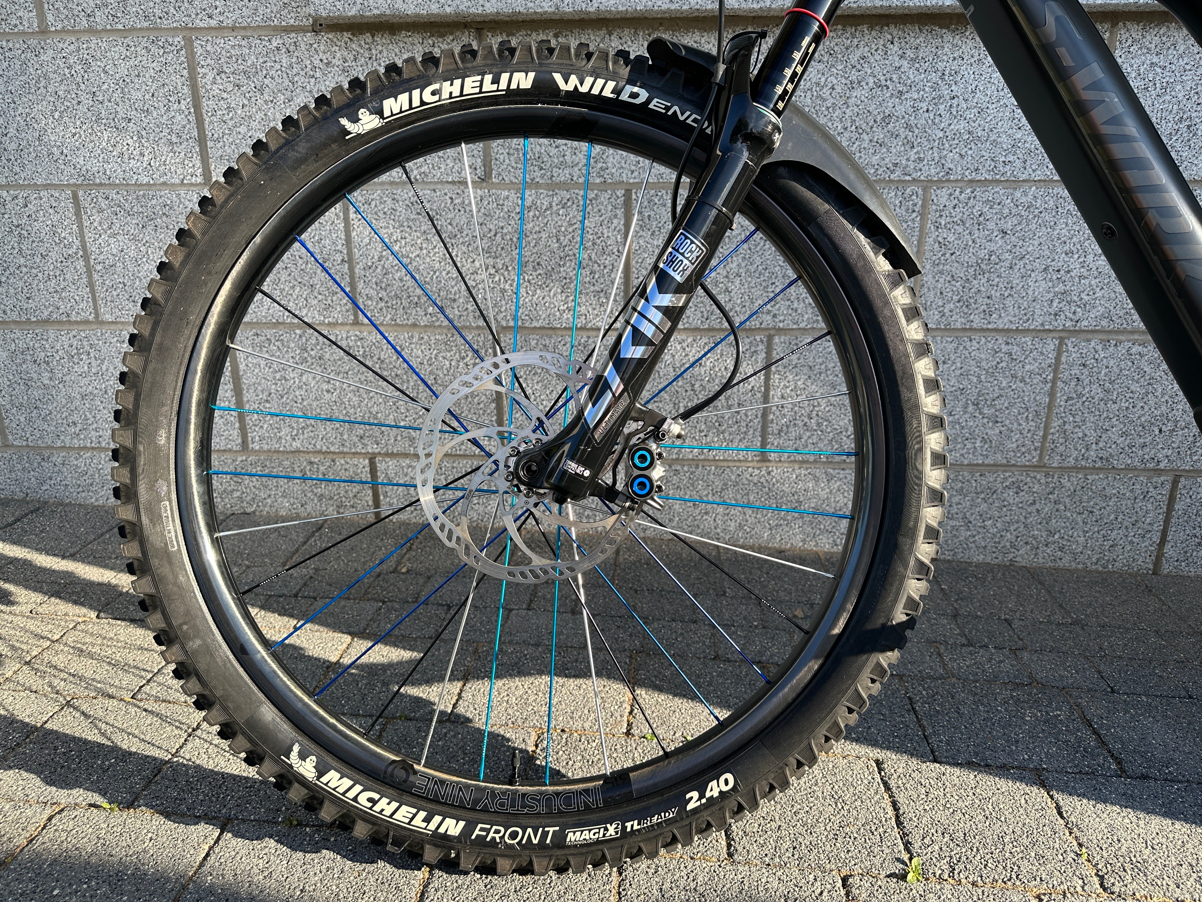

I got an i9 EN315 Carbon wheelset a couple of weeks back. So far I’ve only managed 1 ride on them (currently in Mallorca for the kids holidays), but hopefully home early enough to get another ride tomorrow afternoon!
Most of my previous wheels have been Roval, so usually DT Swiss hubs… but these i9 Hydras make a crazy noise. They sound like I’m being chased by a swarm of bees! I believe it’s a desired noise… and I’ll get used to it 😂😂
The engagement is amazing though… and I think they look awesome. Just need some more blue ‘bling’ to add to the bike to set it off.

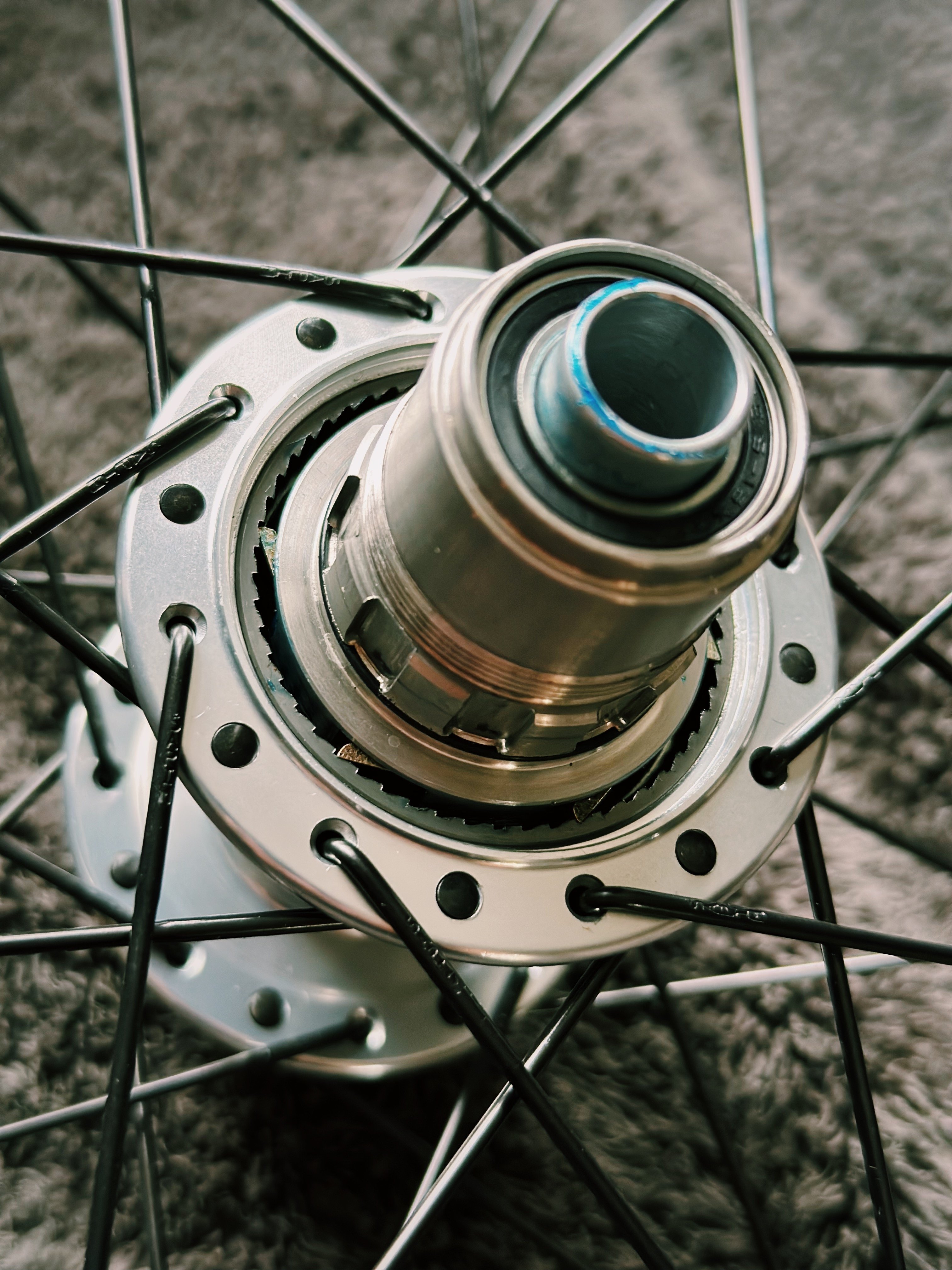

Like to get some input on either to go with Chris King or Industry9 hubs. Anyone running either one?
I do like the sound of Chris King.
On one of the bikes I have Industry Nine Torch hubs. They've worked ok, but have not been without problems. The Industry Nine service has not been as good as other companies.
The biggest problem was a broken axle. The hub was a few years old, and I had to pay for the parts. That's ok, but other manufacturers would have send me out replacements under warranty. So don't forget replacement parts when you're figuring the cost of the product.
There are six out-of-phase pawls, where only two engage at any one time. All the force is on two tiny pawls. My hub shows severe deformation on the pawl sockets. It hasn't failed, but it doesn't inspire confidence.
The pawl springs are SMALL--almost invisible. If you drop one and it lands on your dirty shop floor, you might be in trouble. I wanted a spare set so I'd be prepared in case that ever happened. The six small springs were a buck apiece--six bucks. Shipping was fourteen dollars. I ended up having to pay twenty bucks for less than a gram of springs that could have been stuck in an envelope.

King is a great hub, but the ringdrive requires special grease, and a special bearing tool is required to service them. Axle pretension is a bastard to get right.
If you must have American jewelry have you considered Paul or White ?
