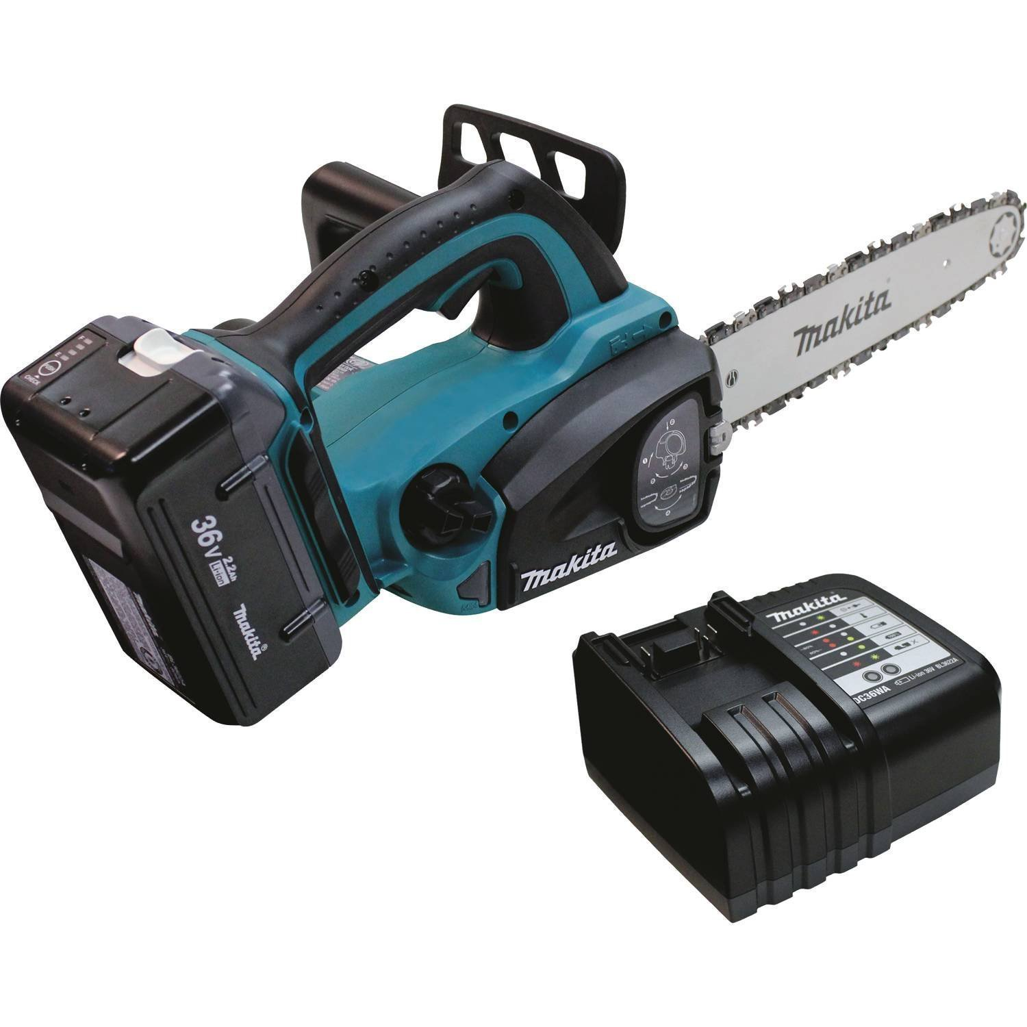

My Makita one takes two 18v batterys, which gets it to 36v. Quite old now, but still going strong.
Works well, it's narrow Kerf so moving less wood than a larger petrol one. Gets through most things but if I'm cutting thicker than 30cm I'll generally go for the petrol as that size will eat the batterys too quickly if you're doing a lot of cuts. If I carry that or the chainsaw on my back strapped to a pack it generally sits at an angle, so not upside down ever.
Electric is nicer as it's quieter, doesn't smell and it's slightly more convenient to keep picking up/putting down/putting away as you don't have to keep stopping and starting the engine. It has a high blade speed and more torque than a lot of petrol ones so cuts things just as fast, sometimes faster. You just need to make sure you respect it the same, not less because it's quiet !

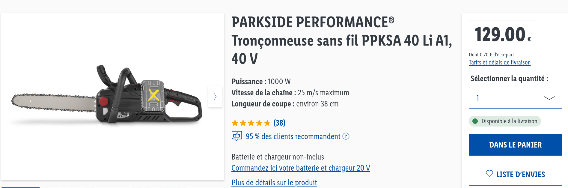

I think Lidl's do a twin battery one and a twin battery charger if you're only using it occasionally - you can buy it on the website.

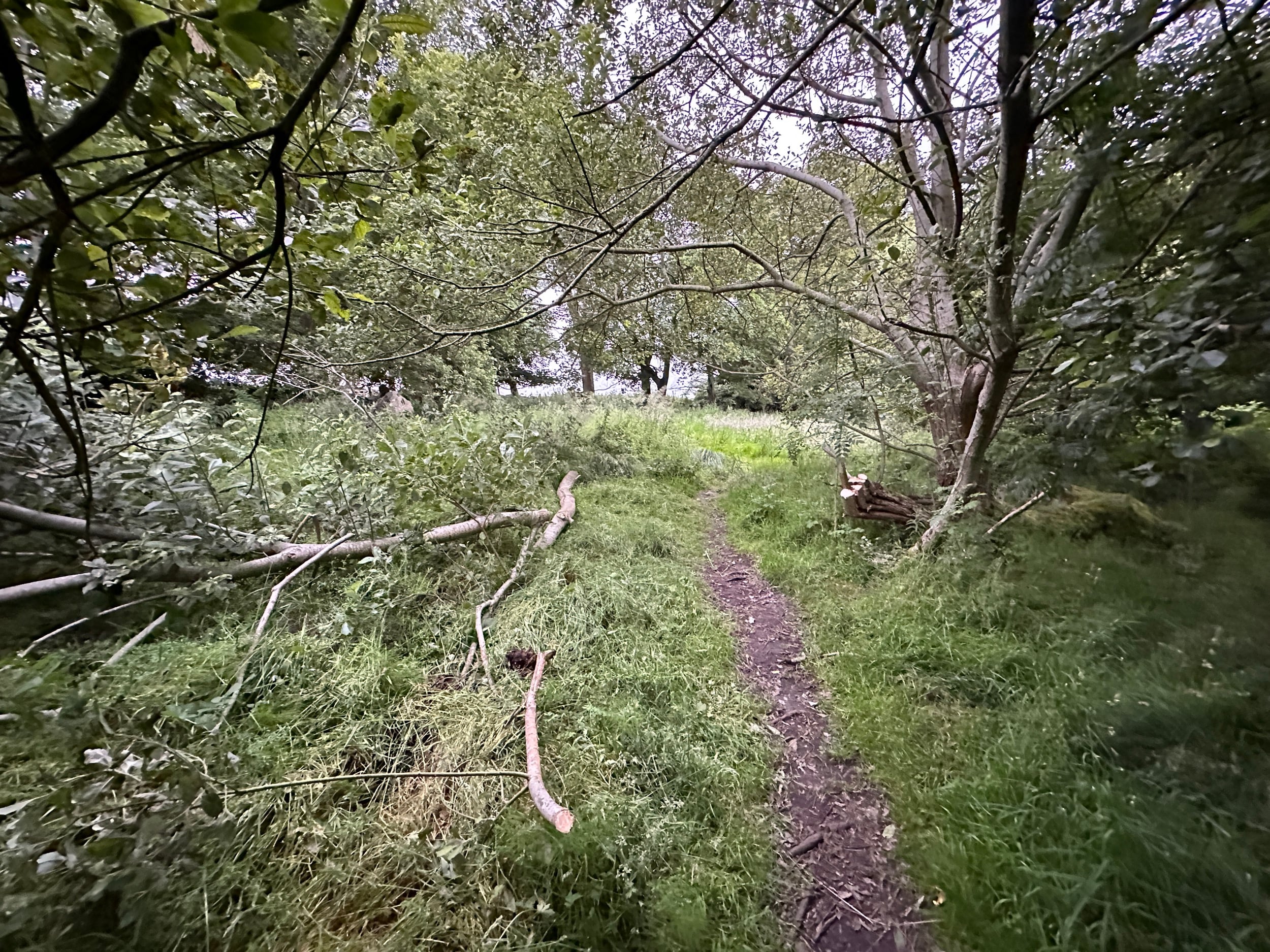

The UK is in the middle of storm Gerrit, and to be honest some of my local trails still haven’t recovered from Arwen over 2 years ago.
I often have to dismount and climb over fallen trees or get re-routed to avoid them.
Last summer, I ended up hacking some fallen trees up with a big wood saw and making the path passable. Whilst doing it, several walkers thanked me for taking the time to do that. It took ages and a LOT of sweat and effort!
When I’m back home after New Year,
I have a feeling the trails are going to be a mess again. I’m never going to manage to move some of the trees that have come down, but was considering getting a chainsaw to help clear up where I can.
Any recommendations for something that’s reasonably portable, and some sort of backpack for carrying it?
I’d prefer petrol for more range… but not sure how well a petrol tool travels in a backpack when getting thrown about?
I’m sure there’s plenty of trail clearing experts out there who can advise though?
Something decent, but it doesn’t need to be professional grade! 👍

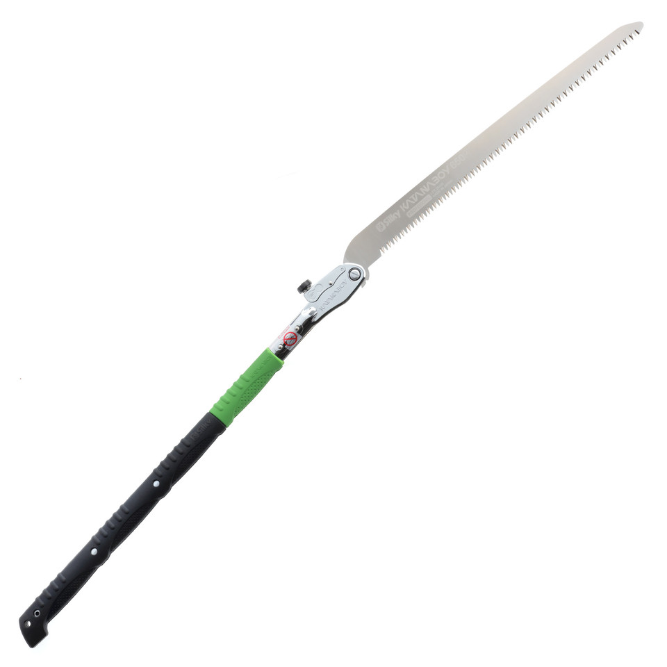

I’ve ordered a 14.2” Silky 2000R saw to chuck in my backpack for a start. Shouldn’t take up too much space and will be much lighter than a chainsaw.
Will see how I get on with that before heading down the chainsaw route… but I have a feeling the storm damage will be more than the folding handsaw can cope with.

Here’s the one I cut up with a wood saw. I had to chop it into various bits to be able to drag it off the path. It was well sprung - and was sitting at about 3ft in height across the path. I would slide my bike under it, and climb over it.
It must’ve taken me close to an hour in total, and was very hard work as the saw kept sticking as the tree unspringing itself.
There is another about 20m from it, but it had so many branches that it’d take a lot of time with a hand saw to get near it. People have now made a new path round it!

I have one of these Makita 36v saws for clearing trees as thick as your thigh. Anything bigger than that I use a petrol chainsaw.
