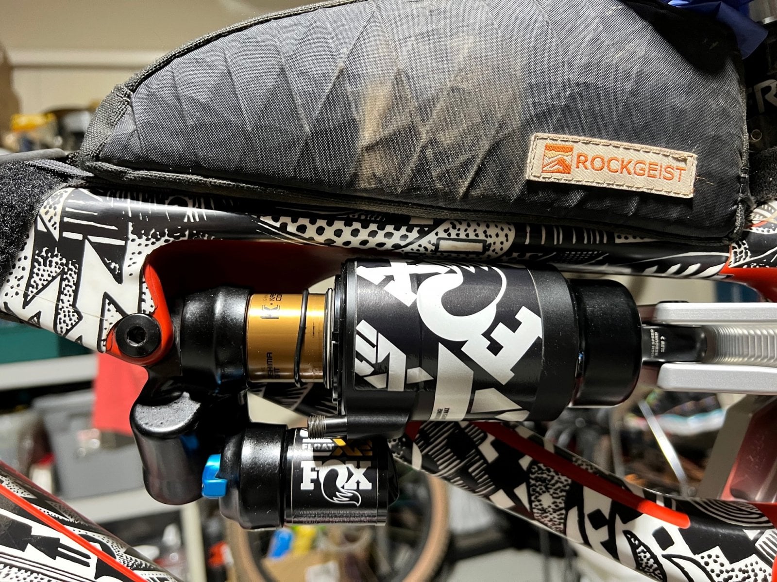

I’ve been riding the cascade long link with a Ohlins TTX22 230x65 with the Fox 38 extended to 170mm for the last few months. I’ve ridden BPW and more local trails and I’m very happy with it, slack at the front with high setting on the rear. Back end melts away out of mind now.
I’m on an S3 at 85kg.
we are heading to Morzine this weekend for week. I don’t do massive jumps, but doclear tables and do good size drops.
The bike feels really good, probably lost a bit of fund simply because it is so much more capable now - but that’s what I wanted to be able to soak up big landings.

I’m running an X2 on the long shock kit too, about 96kg kitted up, running about 255psi. I have a couple
If bands in there which do their job very well. I usually always ride coil, though I think an X2 really suits this bike.

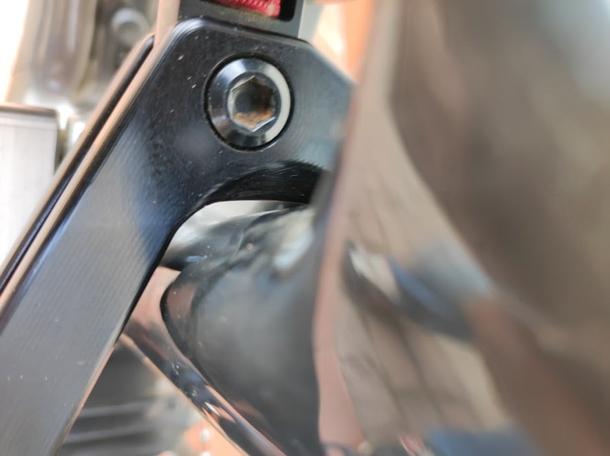

Tried the long link on my Levo Pro S2 - no go! No clearance on the seat tube and top tube.
Hi, I too have installed the long link on size S2 Levo Expert, but there are about 3/4 mm distance from the seat tube with fox dhx2 230x65, in static position and no problem with top tube
For my information, it seems that you're using the "original" shock, and not a longer version. Might this be the cause? I believe this is the original shock, as it has the "small piggyback", and not a long one as regular? Again, I might be wrong :D
it was installed at low rear position - never tried the high because of no tolerable clearance on the low. also the shock is 230x65.
Did you get the fitment figured out or is it just not going to work? I have the normal cascade link but have been looking at going with the long travel kit, I ride the S2 too. If it doesn’t fit then I’ll just stick with the regular link.
It does not fit on my specific frame - s2 levo pro. I returned it.
I have the same bike, Levo Pro in a S2. Guess I’ll have to spend my money on something else. Crazy that they don’t say anything about it not fitting the S2 on their site.

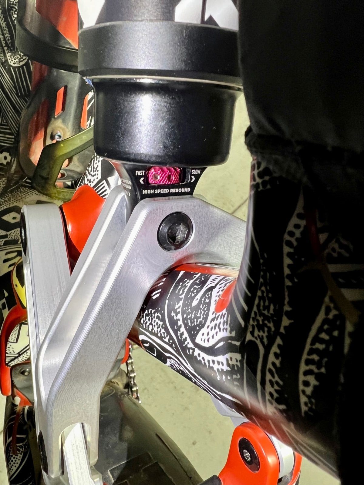

Just finished install. Excited to go for a ride and finish set up.
Stock 210x55 upgraded to 230x65
Will convert stock 150mm travel to 165mm
No more high pressures. Easy bottoming out gone
No clearance issuesView attachment 83400
side by side with a stock gen3 Levo
170mm travel up front. 165mm rear!
Will post the 210x55 for sale soon
** you can see the DU bushing on replaced shock (hole near HSR)View attachment 83403
*Took the 230x65 X2 from my Kenevo and serviced by Fox. Fitted the stock rockshox coil back on.
**i was lucky to already have a DU bushing for the shock. Saved me from dropping what i was doing and making a run to the bike shop. You can use the old bushing from the old shock if you have the tools. But I recommend having a new DU bushing. (Don’t know if this was mentioned on CL site as i did not read any of the instructions lol)
