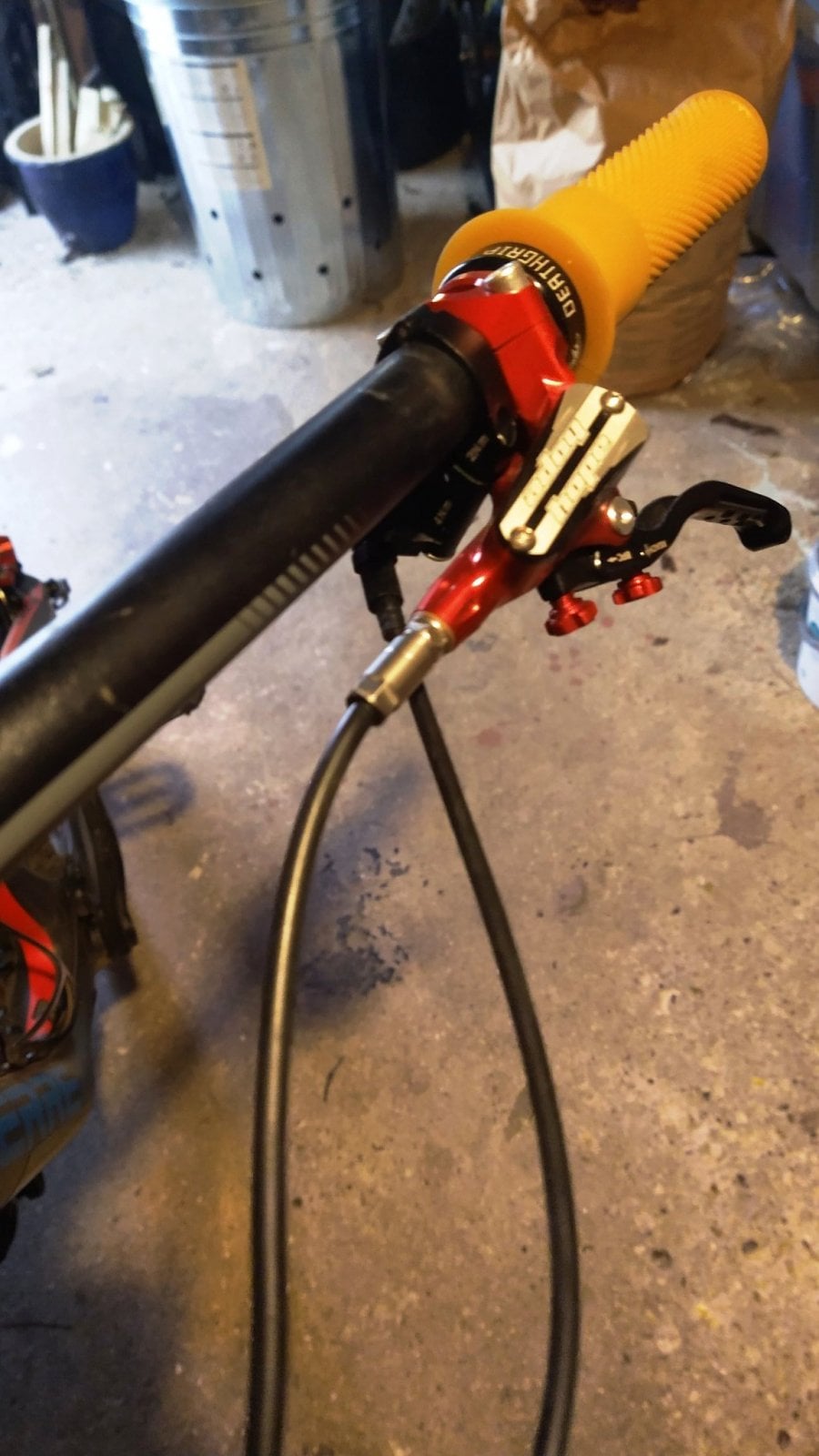

RustyMTB
Jul 22, 2020
2,969
7,166
Yes you can. The hose diameter is the same, more importantly, I've done exactly that with one of my bikes, V4's replacing Guides & kept the hoses for this exact reason.
