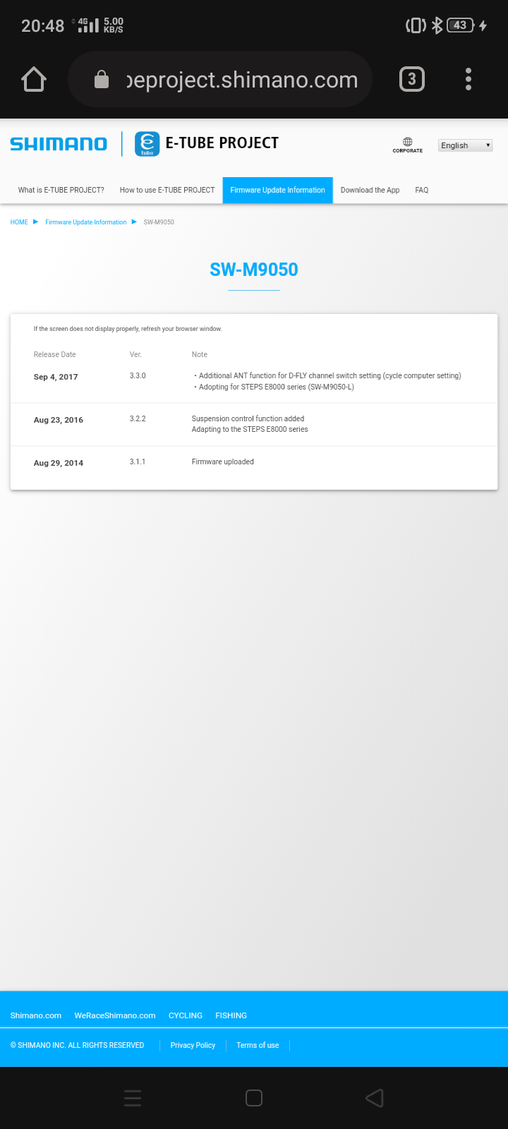

Any advice for me ?
When I plug a shifter xtr left m9050 for mode assist I loose display. It hors blank
Once I remove it. Display Come back
Motor Fw is 4.3.2
You probably need to update the firmware on the shifter - I had the same until I could connect it to a PC with the cable and use the PC e-tube software. I don't know if it's possible to update it using the mobile app now ...
Maybe by upgrading thé motor Fw ?
It will allow me to plug it with display ?
But I Lost 4.3.2 Fw file and do not want to be stuck on the 4.7.1 ....

For me it was the shifter firmware - the motor was fully up to date. But it was a year ago now when I tried it ...

i think i have a version priori to thé 3.3 ans it IS not possible to update with etube on mobile phone. Bref a computer for sure

Your switch firmware is separate of drive unit firmware and separate of display firmware. You can have the drive unit at 4.3.2 and everything else updated to latest.
"4.3.2/4.7.1" you are referring to is drive unit firmware.
If you can't update just your switch firmware with E-Tube app you'll need to go to your LBS and ask them to do it via PC link

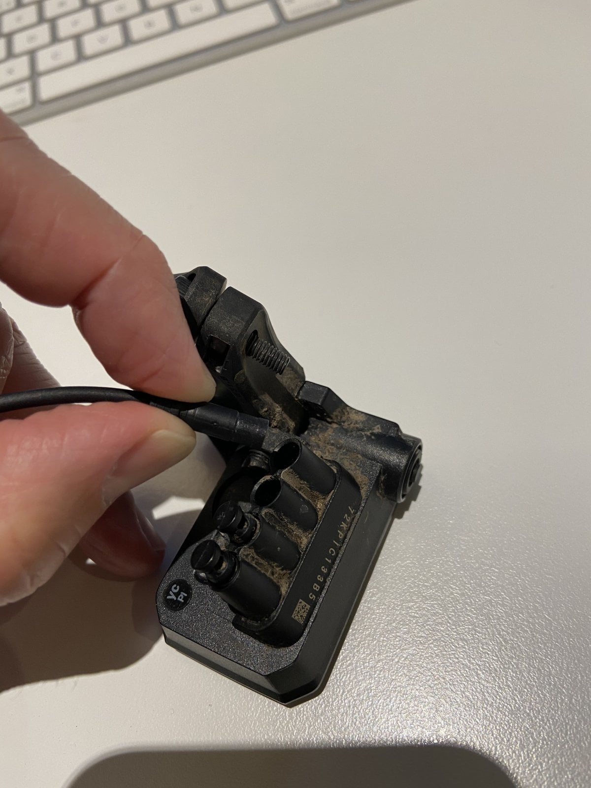

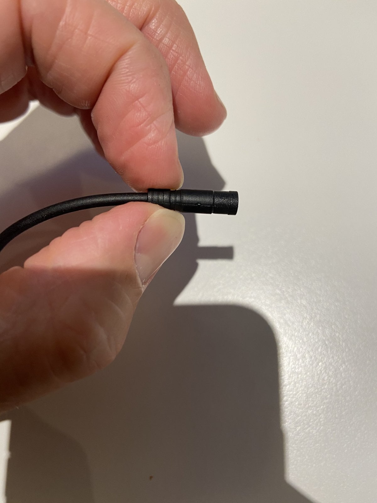

hi can somebody explain to me how how do i change the controller switch on my merida ebike the cables are running through the handlebar. I ve got the Shimanon E7000 and needs replacement, i ve tried but i dont want to pull out the cable to far
9,185
I am pretty sure you just unplug the cable from the display, and pull it back out through the bar? Not sure which bar the Merida uses, but on some of them the cable doubles back under the grips, do you may wan t to remove them
Can you take a picture of where the cable enters that bar and leaves the bar
juju
Apr 21, 2020
Faversham
Hello, ibhave remove the grip but the cable goes intobthe handlebar, how do you unplug the cable directly on he display, it looks like the cable is fixed to the display, i cannot see any videos online
9,185
you just pull it out, but grip it by the plug not the cable - there is a little tool for pulling them out which may have come with the bike, but you can just do it by hand.
