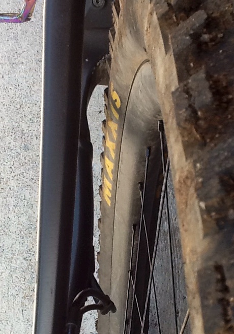

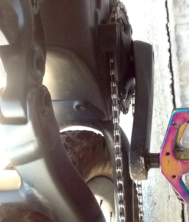

Hello
I went the 29" way with my Levo and I love the way it behaves but having a severe space issue, I'm running a Maxxis Ardent TR EXO 2.4 and I have about 2 mm of space up towards the engine. That is with 30 Psi and do I lift it to 40 Psi(for the seldom asphalt ride) it will make contact. My rims are 25 mm internal width and I guess that I could flatten it a bit with a 30 mm internal width but again, maybe I gain another 1 - 2 mm by doing so. Those of you that are running 29" what tires/internal width do you have and how much space do you have up against the engine(Lower triangle, front part)?
This it how it looks right now:

Oooops! That's close or too close

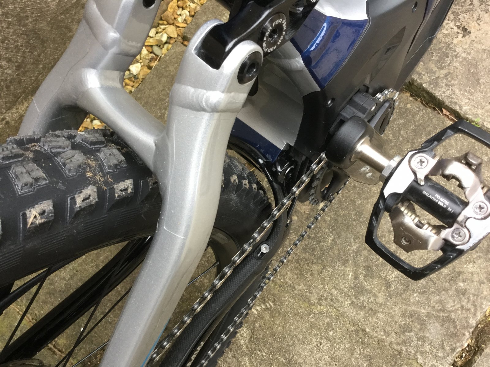

junglie69
Mar 22, 2018
52
48
Warminster
Not sure about frame/rear triangle differences, mines all alloy. I’ve gone 29er almost from the start. Running DT Swiss EX511 30mm rims and minion DHF 2.5 front and rear 22psi out back no clearance issues.

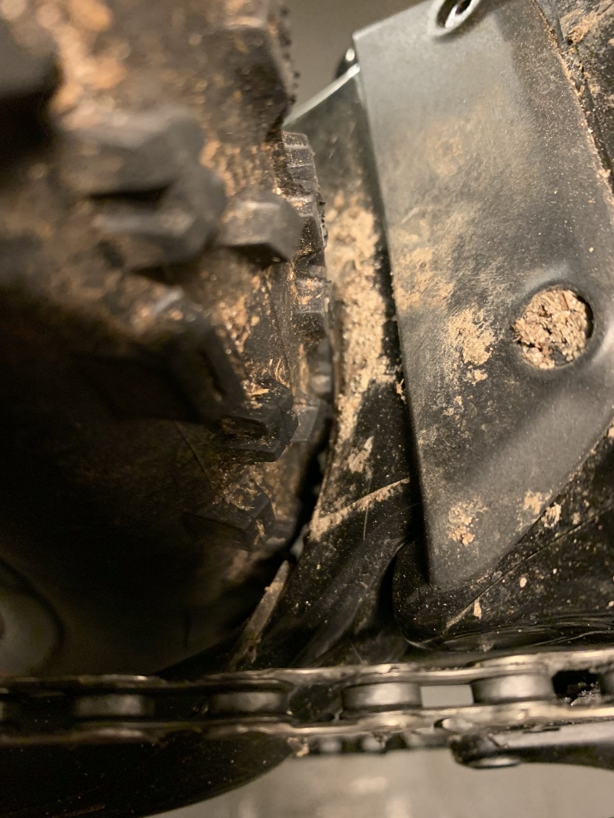

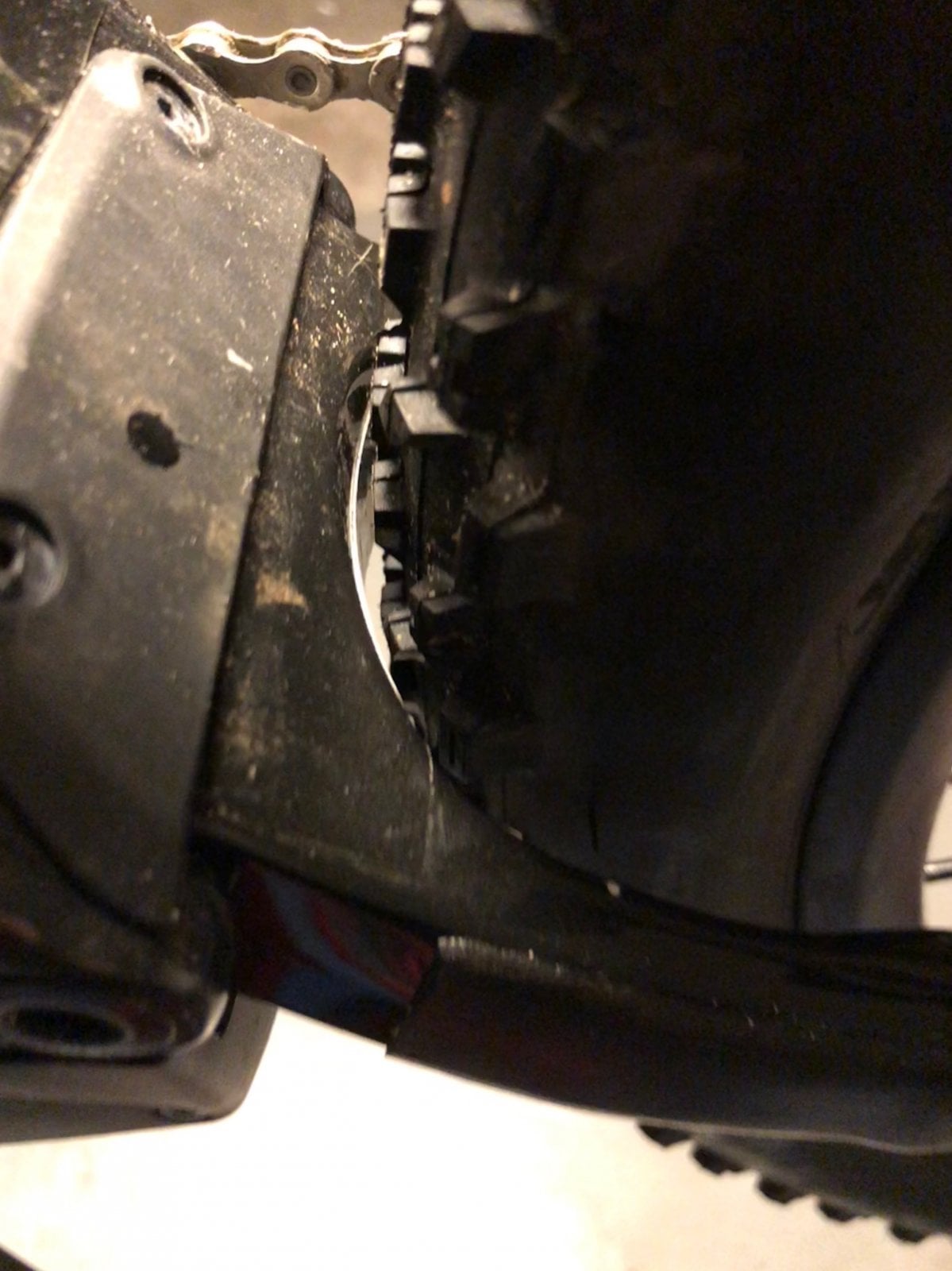

Jeff McD
Aug 5, 2018
335
356
Kona, Hawaii
Hey Karsten, here you go. 2018 levo carbon comp with specialized Roval traverse SL wheelset with 30 mm ID, Maxxix DHF 2.5 WT tires. Clearance between tire and motor near the bottom bracket measures 4.5 mm, and never seems to cause problems for me but I don't ride very muddy trails where it might pack up. Gap on the sides of the chain stays is much wider. Aspect ratio measures 58 mm on hookless rims but there is some wear on the knobs and is probably closer to 59 mm brand new. Hope this helps.
