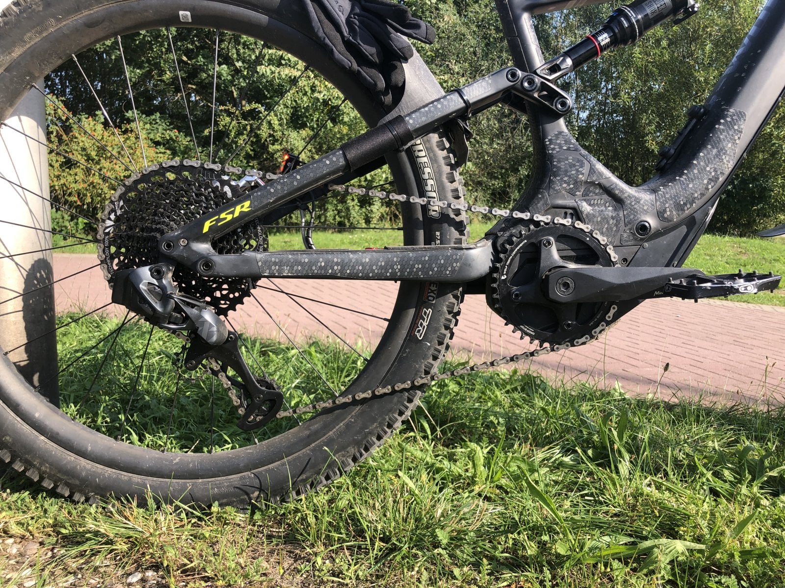

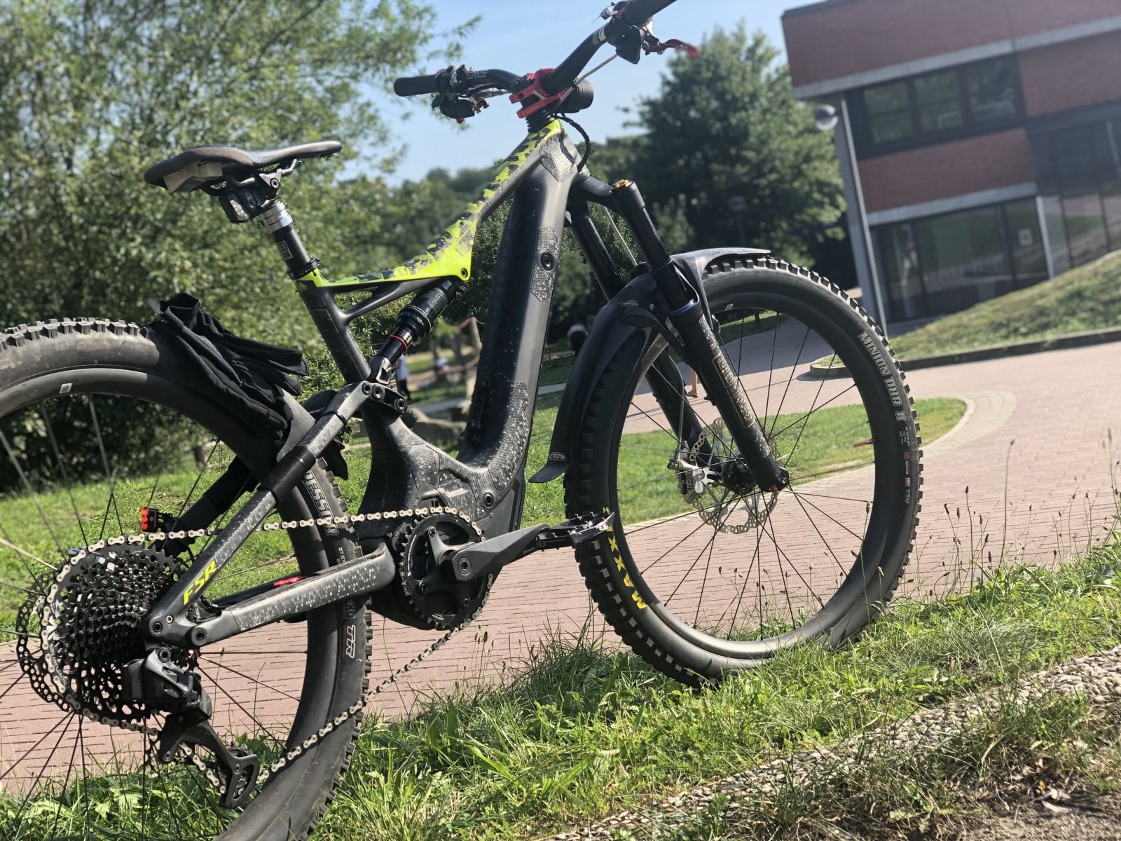

really Like it, I went xx1 derailleur with GX cassette and chain as fall and winter is coming.
As you have an expert too GX is also your way to go as NX got a shimano freewheel, you should have -like me- a xD, but check your cassette first (type is on the backside)
38t Front with 50t rear give you nearly the same spread (1.7 vs 1.6m) per turn as the Stock 32/42 but with a much higher end speed (I live in a relatively flat area with mostly flowtrails, which have to be pedaled hard at around 30kph to be real fun), which should be much better for the cassette as the usable Gears spread more to the middle and I dont stay on the small cogs all the time.

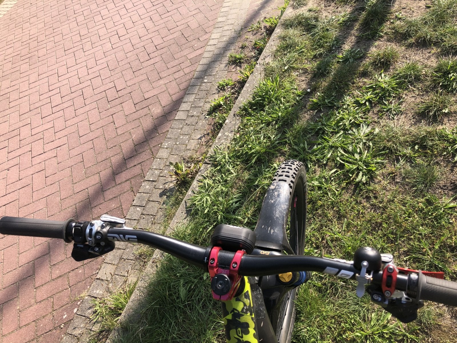

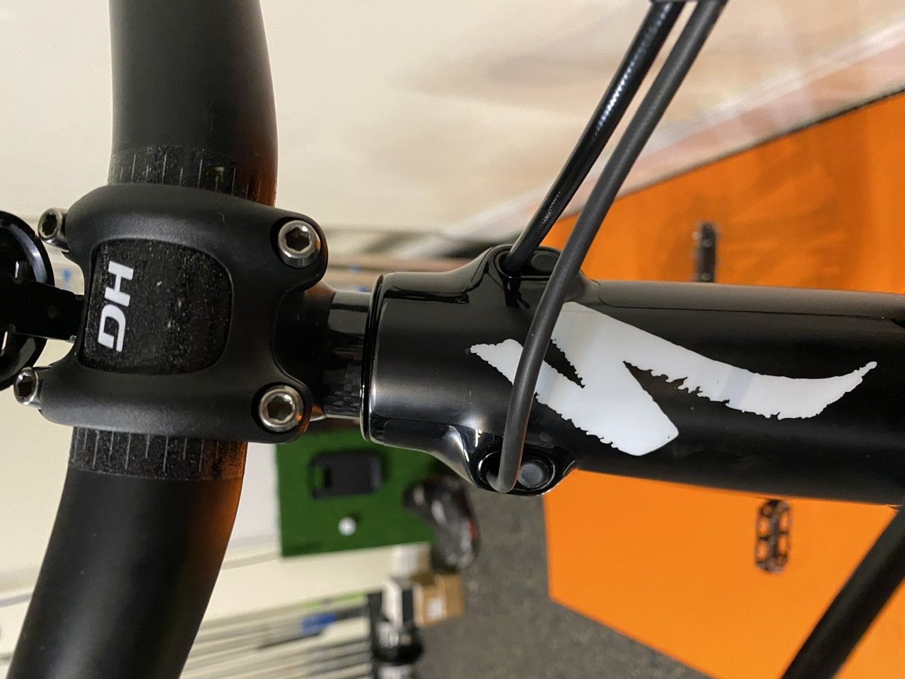

But one of the neatest things is the ultimate clean cockpit! Love it! Also really nice to configure shifting on the left/ right and fiddle round a bit with multishifts.

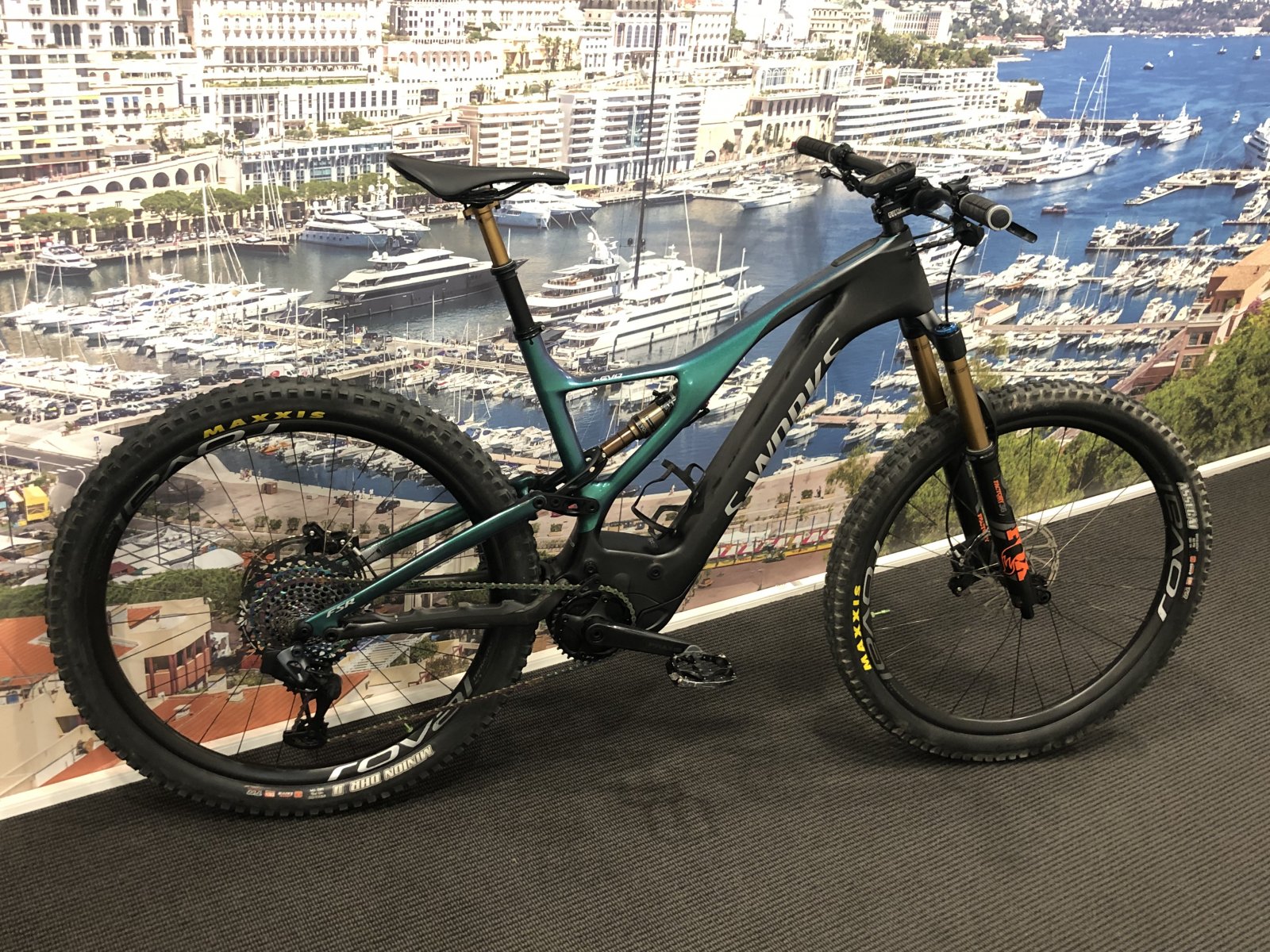

View attachment 17950 View attachment 17951

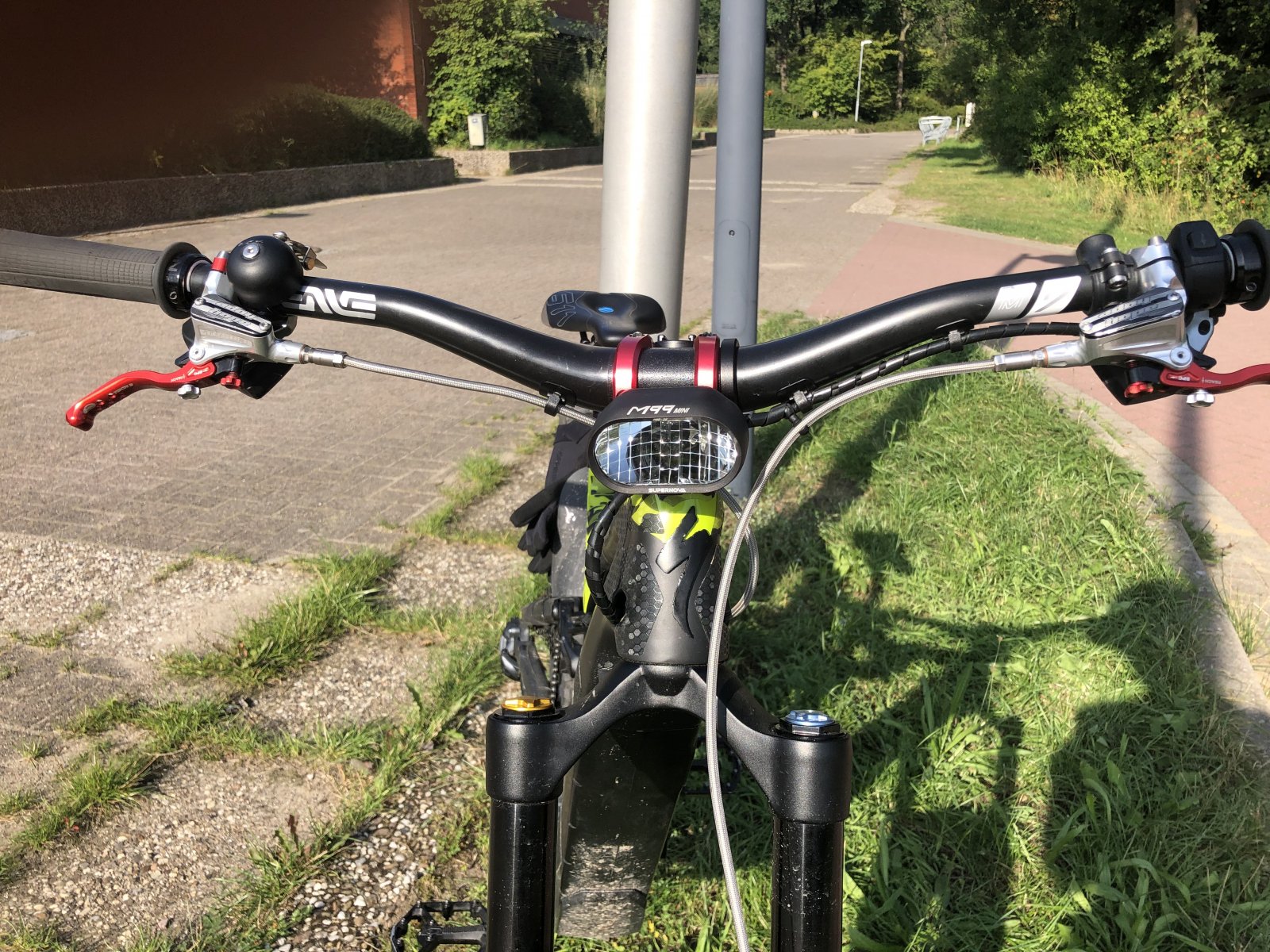

Hi, Thanks for the advice and great pic's. I think you may have sold the AXS eagle to me. I run Eagle on my other Full Suss Yeti so upgrading to AXS when I sell the Yeti is a definite option for me. Like you my Expert is moving further away from the stock model and I also run the ENVE M7 bars and stem. With HX1501 wheel (these come with both XD and Shimano free hubs so NX could be a cheap option) will be running a Hope 36T up front. One question on the cockpit what control do you use for the Levo and mine is the basic one with the floppy cable?

I got the standart remote with the cable, the remote is on the left hand side, between the grips and the brake. Further inside is the remote button for the supernova light.
the cables from the remote buttons (light and bike) are tied together with some kind of spiral cable wrap (mine is more Ike a matte one) and glued to the bar further inside with Jagwire Clips .

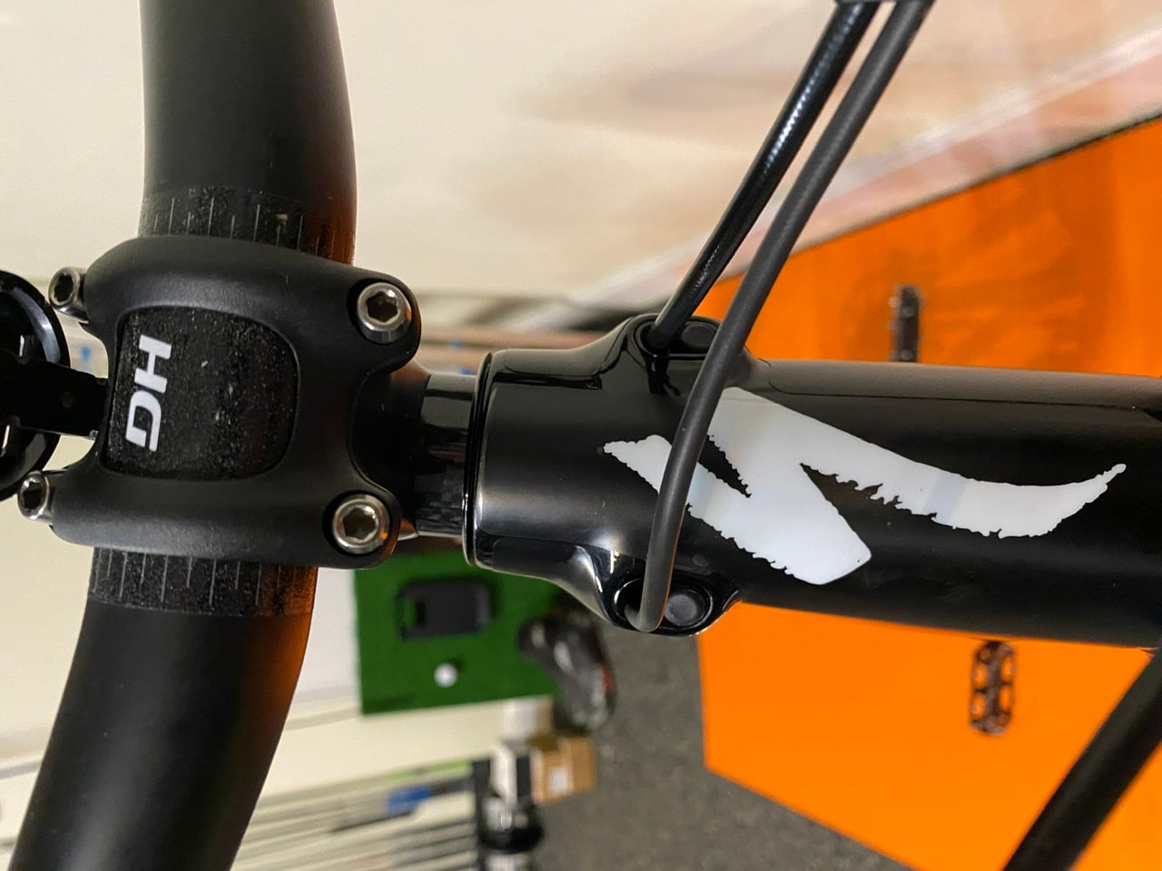

Am also looking on upgrading to the Eagle x01 axs. What did you guys do with the empty holes from the original cable routing? Isn't that prone for water and mud?
Thanks in advance
Thanks in advance
Just left mine tbh not had any issues running AXS rear mech and seat post works flawlessly.
p3eps
Dec 14, 2019
1,870
2,235
I got plugs sent to my LBS from Specialized to fill the gaps when I fitted the XX1 AXS and Reverb AXS. I put one at the rear gear cable hole too.

p3eps
Dec 14, 2019
1,870
2,235
That would be ideal, you know any reference or something? Would be highly appreciated ?
I asked my LBS what I could put in the holes, they asked Specialized, and Specialized sent them some plugs. No reference numbers or anything - just an unmarked bag of 4 plugs!
