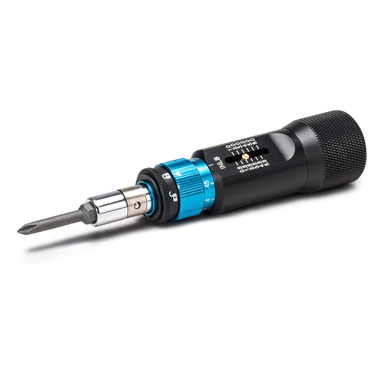

BTW, do you have an educated guess as to what causes the motor whine noise, especially when the motor itself is over 110 degrees Fahrenheit, and is it related to the belt tension or tensioner assembly? Also, do you know how Brose reduced most of the motor noise issues related to the first release of the 2019 Levo models?
Motor whine noise in a Brose motor is almost always to do with belt tension. The surface area of the pulley gears is massive compared to the belt, so even a small expansion here will alter the belt tension by quite a bit.

Do you know if the whine noise is caused by the belt being too tight and therefore the original adjustment was set too high? By the way I'm jealous of your shop set up and the array of specific tools...gotta get me one of those torque adjusting screwdrivers.(y) 0.25 to 0.3 Nm +\-

A quick question for those with the whine - can they adjust that when the motor is still on the bike ? (you loosen it at the start of the video) and should they loosen it or tighten it ?
The belt tension screw should be left well alone unless you have the right tool. The torque setting is critical. Some bikes it is accessable, but most it is not unless the motor is removed.
For better or for worse, the adjustment screw is on top of the motor and requires removal of the motor for access unless you want to guess at the screws location and drill a hole thru the frame motor housing...not suggested. The special torque screwdriver is a pricey little item at over $100 and the potential Loc-tite on the threads of the adjustment screw could alter the torque reading. Not sure if the screw can be removed, threads cleaned, new Loc-tite applied then adjust to the specification but this procedure would be risky for those with bikes still under warranty and not advised.

Does this mean the pulley increases in circumference thereby increasing belt tension? If that is the case then would backing off on the belt tension reduce the whine? As you can see in his video the belt adjustment seems quite finite so small adjustments increments could have a dramatic effect and the process of removing the motor, adjusting the tension, reinstallling the motor then testing could be an arduous chore...best left to the professionals or nerds like myself who have time on their hands. :geek: Maybe after the warranty expires.
The belt tension is already very low, backing it off even further could result in the belt slipping (jumping teeth). The belt is factory set to be quiet when hot or cold, and therefore should not need to be "experimented" with. Along with belts you also have bearings and gears that can whine. Personally, unless you are absolutely sure what is causing the noise, I would highly recommend proceeding with caution!
