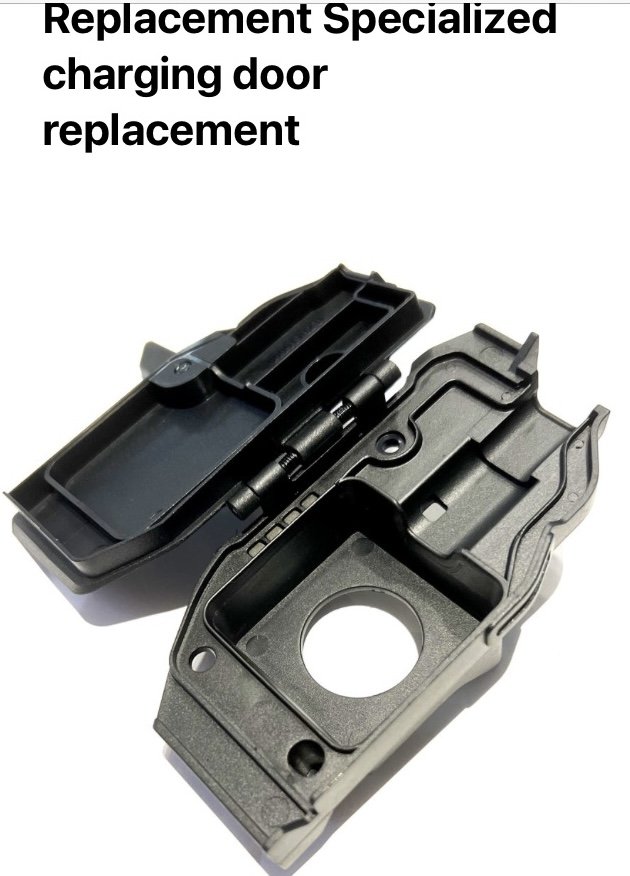

I didn’t ask for ‘iT’ specifically. Assuming the new door will be on my new bike. I don’t even know what the new door looks like . . .
Maybe thiz?

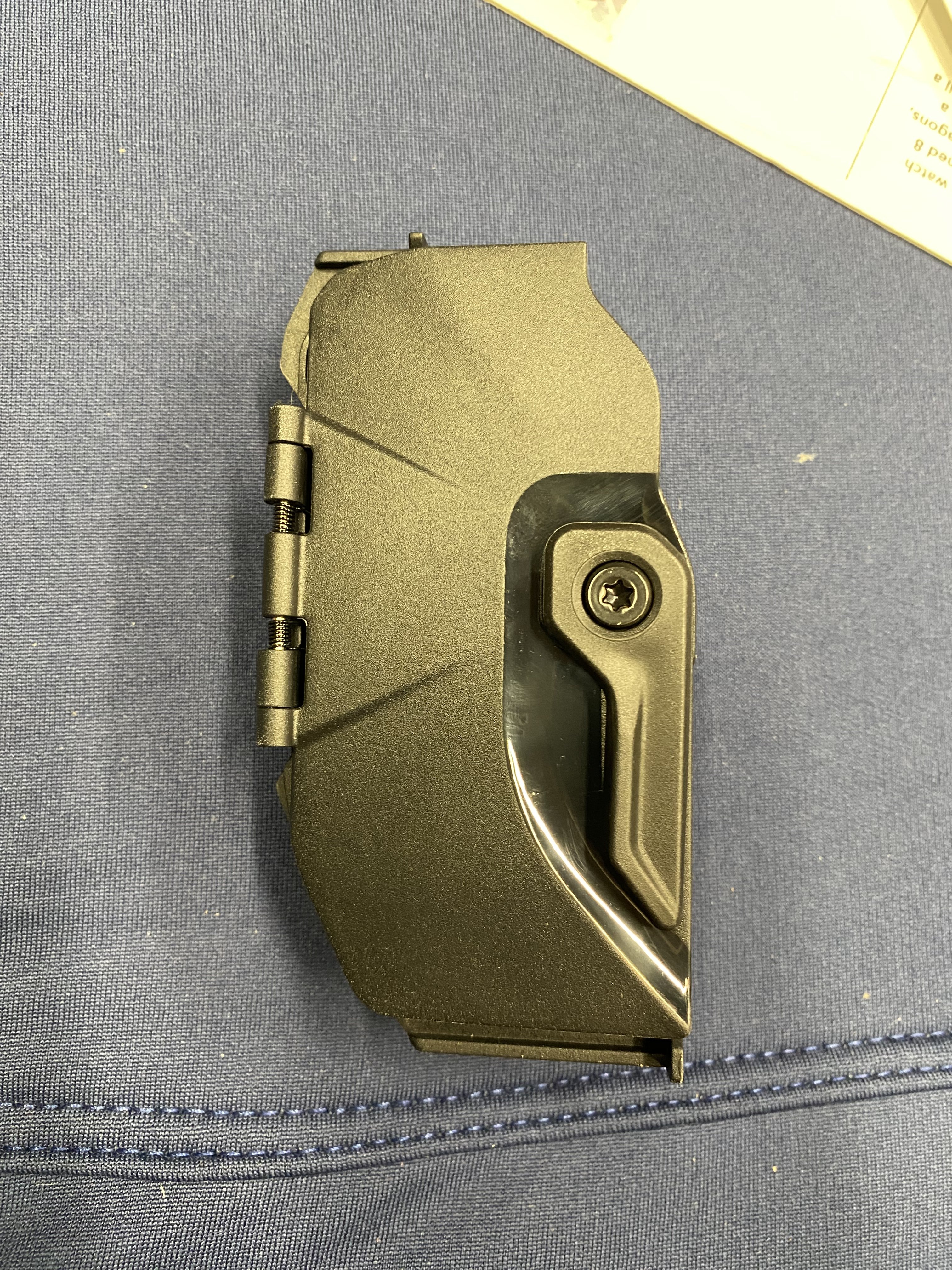

Just had my duct taped cracked stock charge port door replaced with the new spring hinge.
It's "better" but if you side swipe or graze a log / rock that hinge will immediately rip off.

The replacement door with hinge isn't winning any design awards either. It kind of fits and it makes the battery plug fit awkward and sometimes doesn't fully engage.
Good news is it doesn't fall off.
Have to agree, it is only better because its an actual hinge with a pin rather than bending over thin plastic.

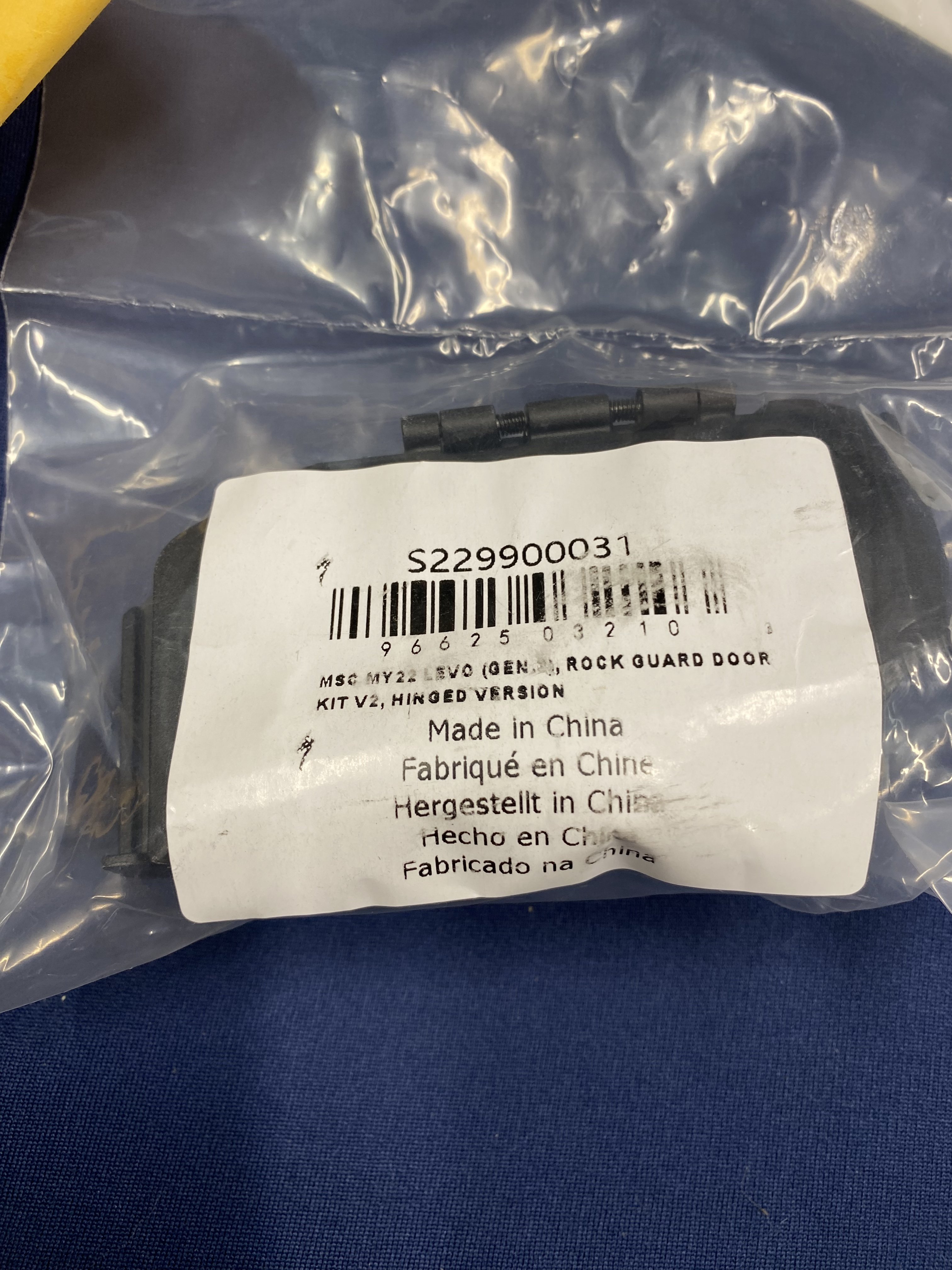

Just ordered the new hinges door from a semi-local LSB. Says it’s in stock. Will see when it shows up. My original hasn’t snapped yet but would just assume make the proactive fix
Did a google search and found a bike shop in California who had the new door in stock. Ordered for $40 as I recall and got in within a week. Installation was about 15 minutes including dropping the battery. Problem averted.
