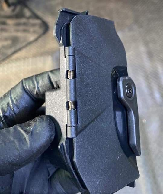

I dropped off my bike to have the new door installed. I watched the tech open the bag but I could tell that it was the original version - even though the tech was certain that it was the improved version. The new part had the exact thin plastic hinge. Maybe the spring-loaded hinge version that was shown in earlier posts is not a real part for the Levo. Has that been confirmed?

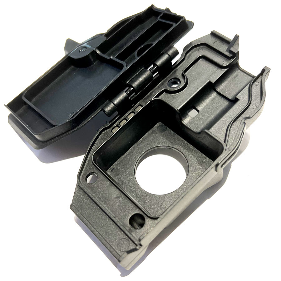

Spring loaded hinged version is official Spesh part.
V2 part number below. Does not appear to be available in the states yet. Found this on the same German site as RickBullotta - didn't know there were two posts on this topic until I found the part number. Thanks Rick.
Part number - S229900031
Salko - thank you for confirming. I'll be requesting that my LBS ask Spesh about this part and its availability in the states when I'm there picking up the bike today. It's only a matter of time before I'm back there to get this one installed :rolleyes:
Exactly, Ruppia. So I found out that the hinge version (V2) is not available in the US yet - according to my LBS. They must have looked into this because when I walked in they knew all about the V2 version this time. They told me that they would just order one of the new versions when they are available - very cool with that. The good news in all of this is that I rode mine for two months with the sealed plug exposed and it was very clean at the contacts each time I charged. I don't get too goopy with my rides so YMMV. Oh, and the new door came with a whole new rock guard assembly.
Confirmed!

I received from best bike the parts today and mounted immediately.
some thoughts:
the material is changed, from PP to PA+ABS. Such a strage blend, of course more strong but also less flexible.
the door is closing not perfectly, it needs some sort of final adjust cause the hinge is really thin and the door slide al little bit on that
the hinge is exposed to rock an dirt.
i really think that it may break down in a moment.
a little bit disappointed as you understand, in some months we can tell if this mods is enough
