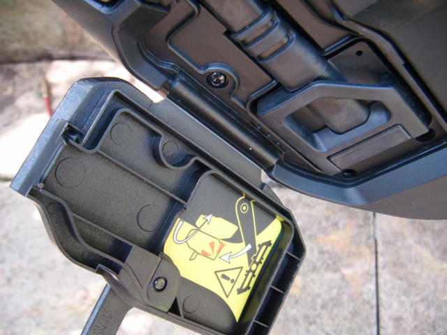

Did a google search and found a bike shop in California who had the new door in stock. Ordered for $40 as I recall and got in within a week. Installation was about 15 minutes including dropping the battery. Problem averted.
Looks good, just ordered mine. I’m trying to take the old one off but I’m not sure which screws release it. The two behind the door are out but it still doesn’t want to come out. Your thoughts?

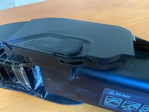

I have been VERY careful with mine. I am not even at 200km yet (4 or 5 charges, so door opened and closed 5 times) and it is already starting to split- maybe 8mm so far.

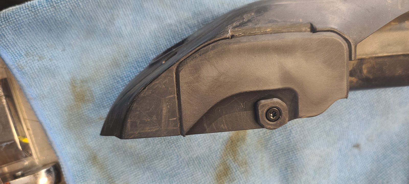

The hinge becomes weakened because it sits on the edge of the bash guard. Couple of hits on the side of bash guard and the hinge is toast.
I don't have a new one yet but if it's not inboard of the bash guard seems like the same things going to happen.
The crappy bash guard needed to be a bit wider.

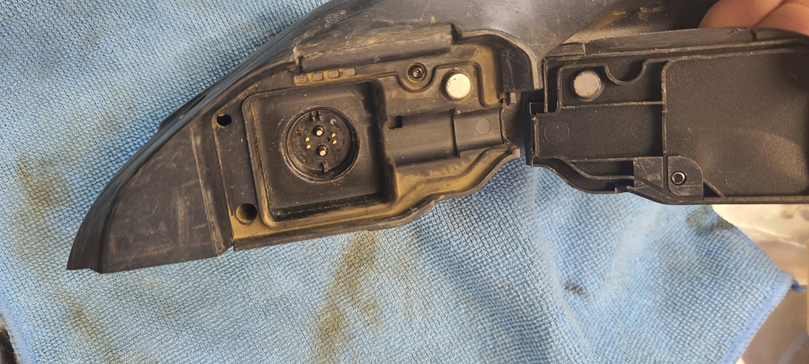

I am on my third cover. After the last one failed, I JB welded magnets to secure cover better, shortened the lever into a nub so it can't get easily be opened and beveled the door edges so they are inboard of bash guard. I have about 10 rides on it and it's been good so far with a few log strikes.

What thickness are those magnets and how is your door holding up.
I got the V2 door installed today and am looking to do something similar or put a Velcro strap across the latching arm to stop it from moving.

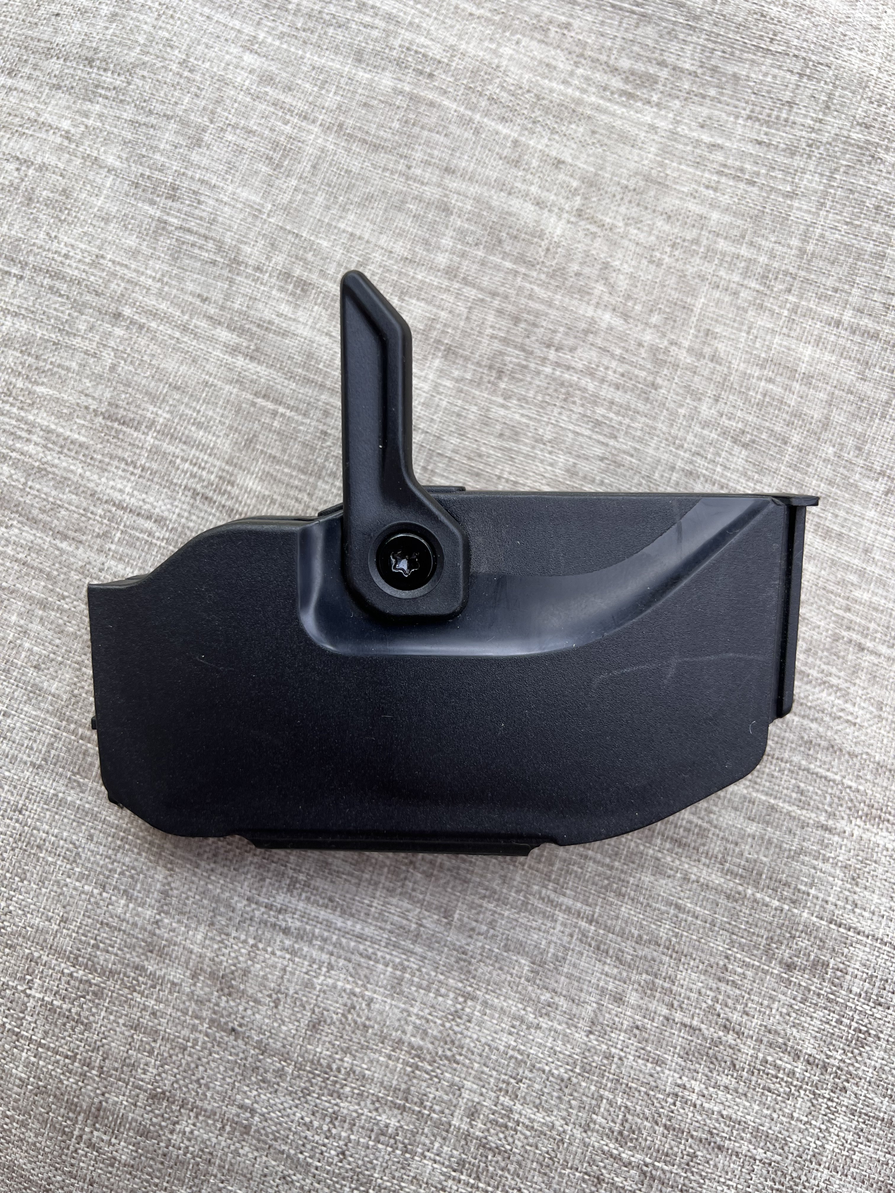

Hi I have one, it is a new warranty replacement but then I purchased the newer version from a different dealer so swapped it over myself, not sure what its worth though, any ideas?
Magnets are about 3mm thick and did work excellent for several months but did come loose and I lost it on the trail. Ive since upgraded to the new version which has been working excellent for over 6 months now.

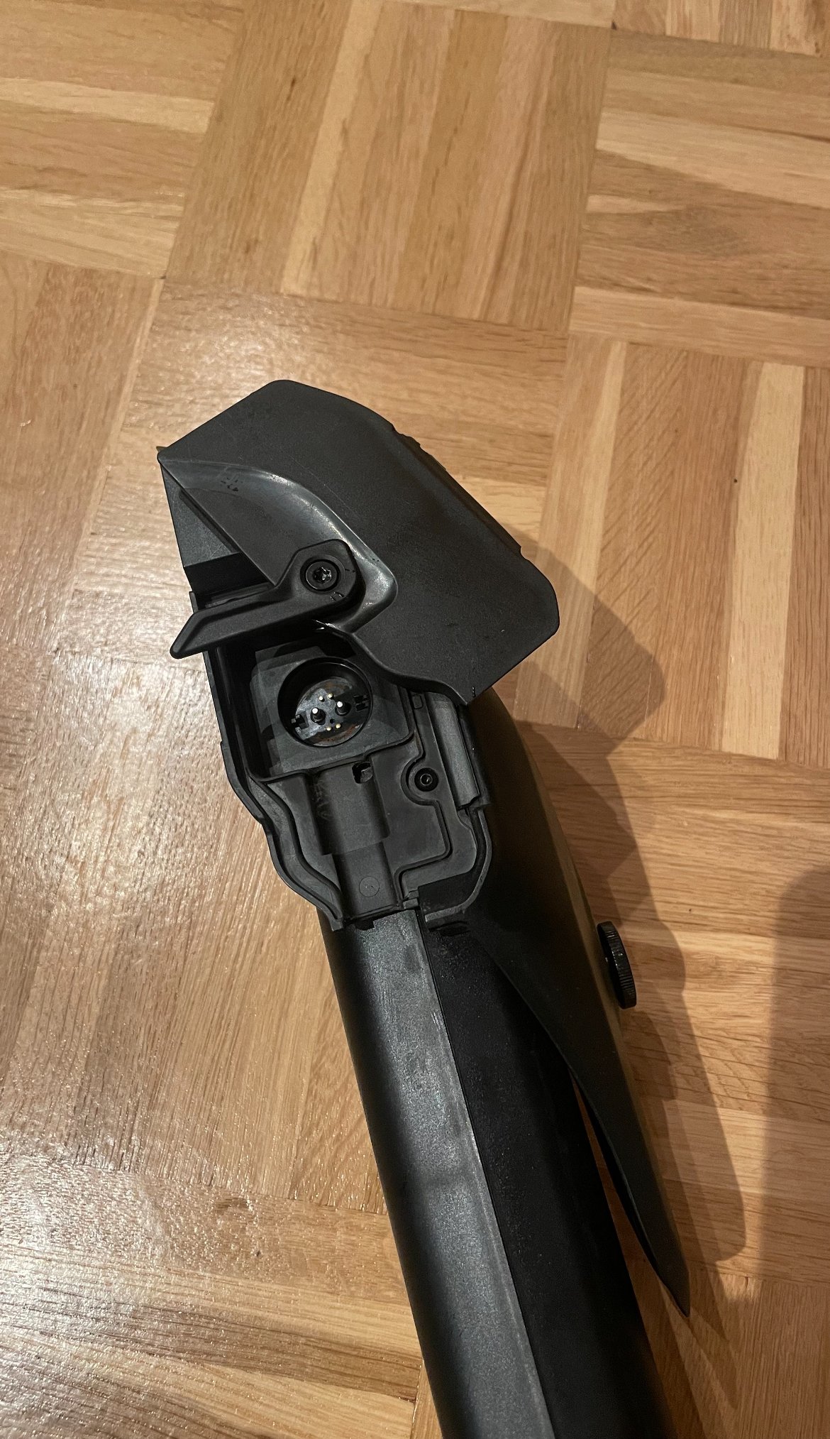

Dang, went on my 6th ride on my new Levo and i heard something really loud when going down a fairly rough rock garden. I got back to bottom and noticed some decent scratches on bottom of plastic battery guard. When I got home to plug in bike, I noticed that my door was totally gone. Not sure why I didn't notice it when done with ride, guess a rock hit it just right and broke it.

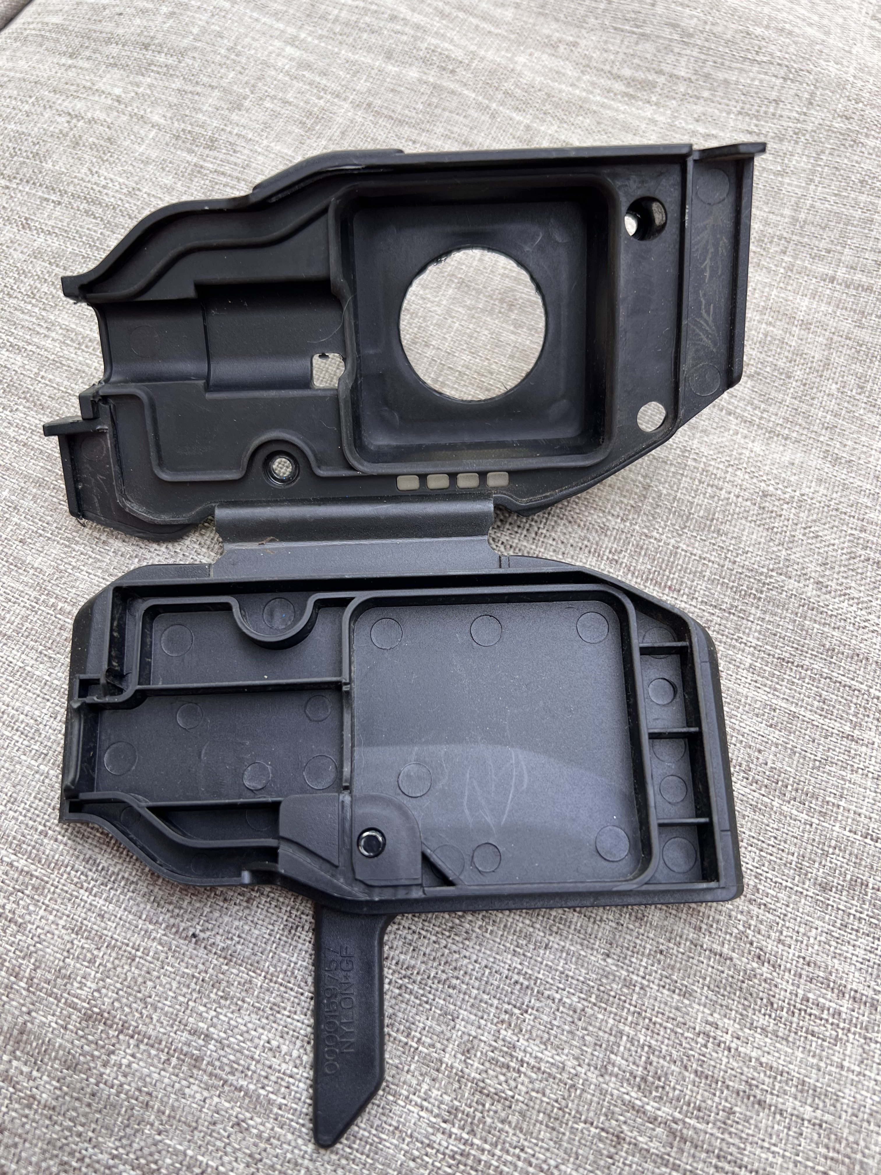

Good afternoon, here is another solution to the broken charging door.
Regards
